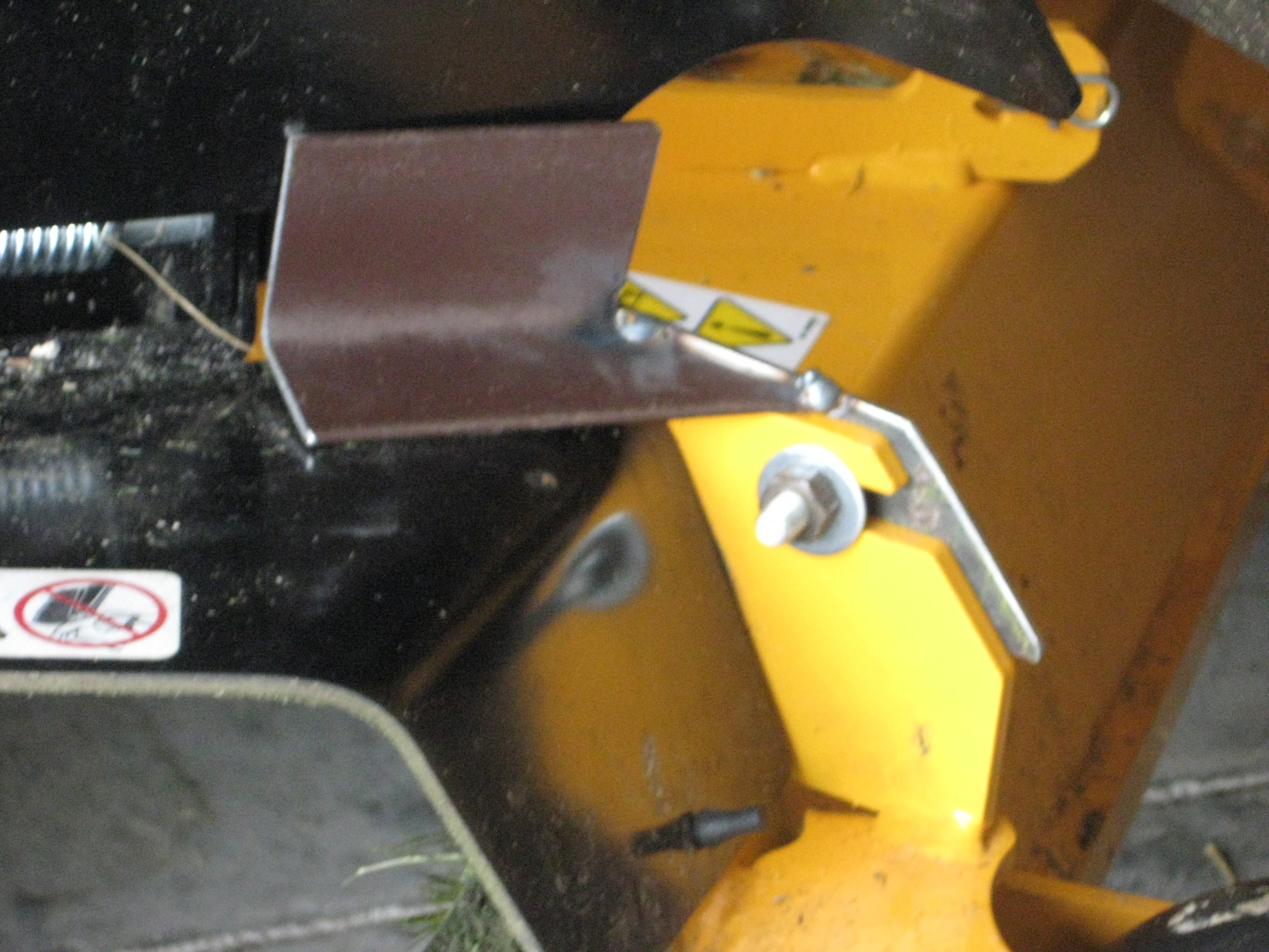

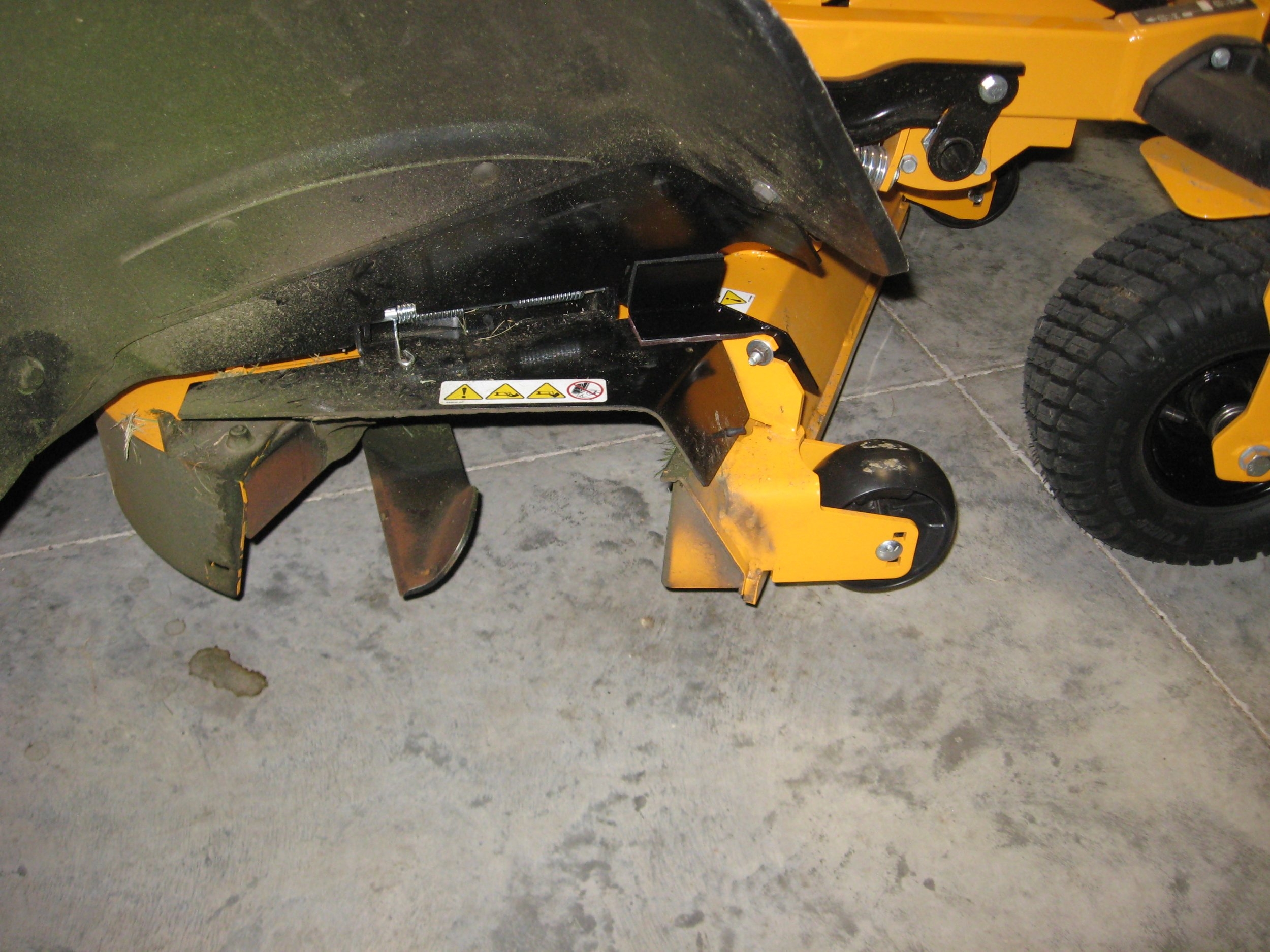

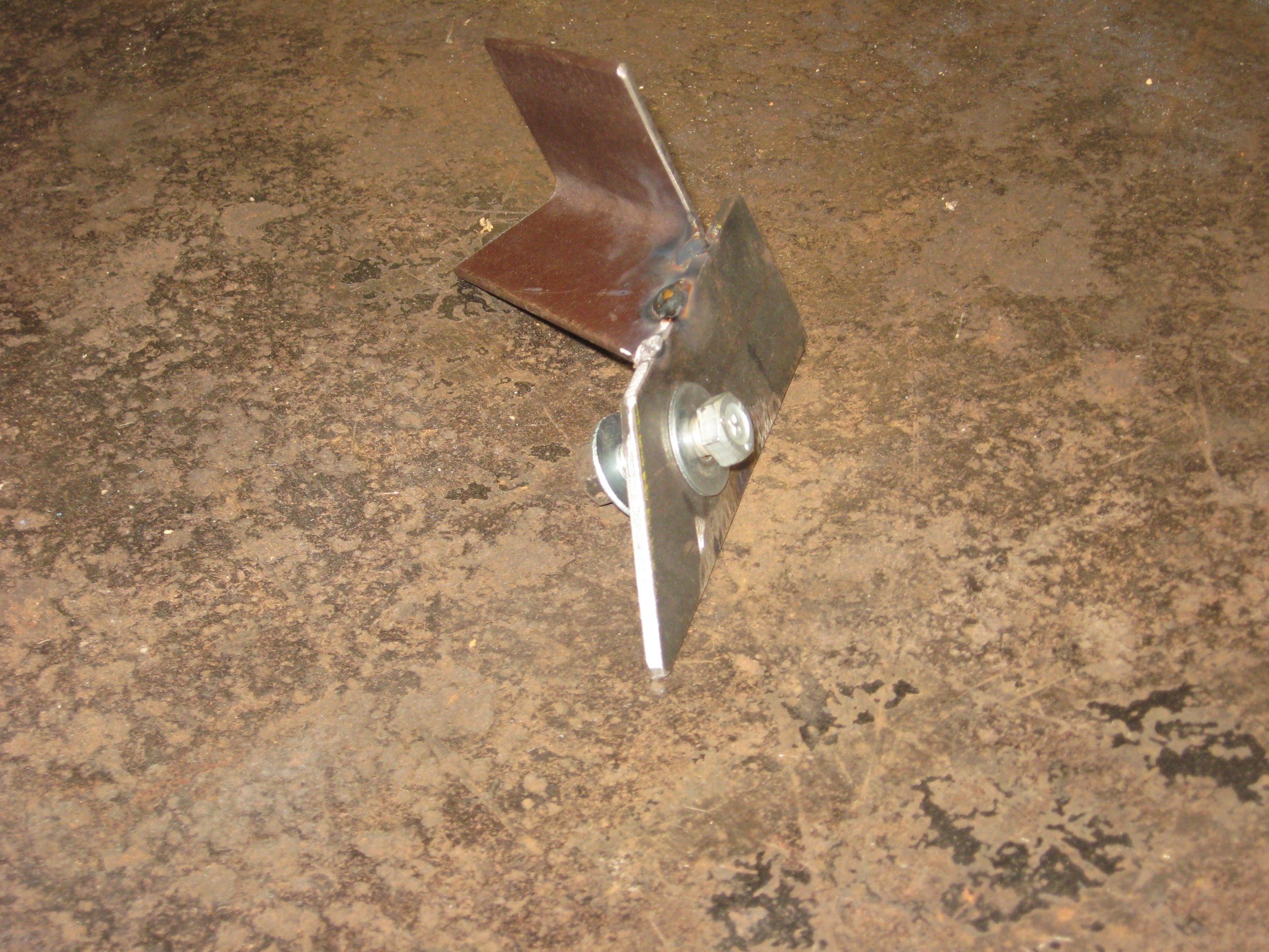

Since my dealer refuses to give me the mower chute stop bracket that I paid for, I went ahead and made my own. It just bolts into the existing lug on the mower deck that is normally used for attaching the bagger boot. Still need to paint and give it a shakedown run, but looks like it should do the trick.

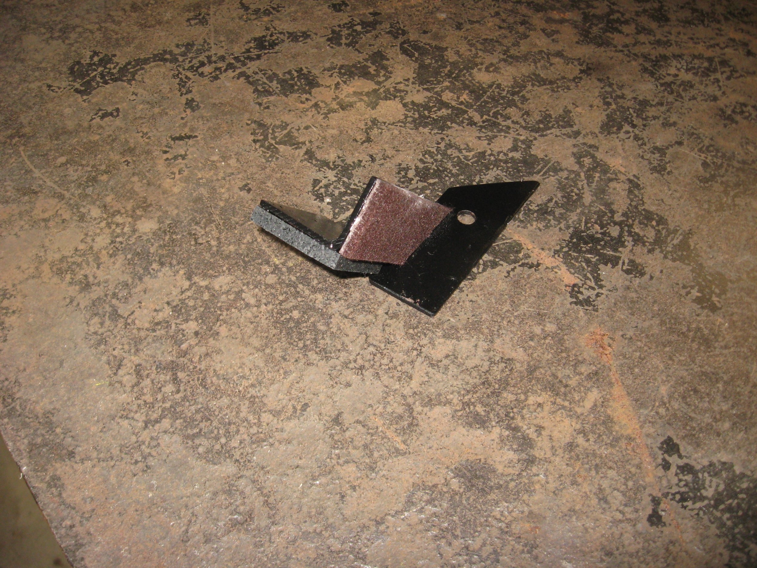

Final product on mower chute stop bracket. Added paint and rubber/felt pads where it touches the chute surfaces.
