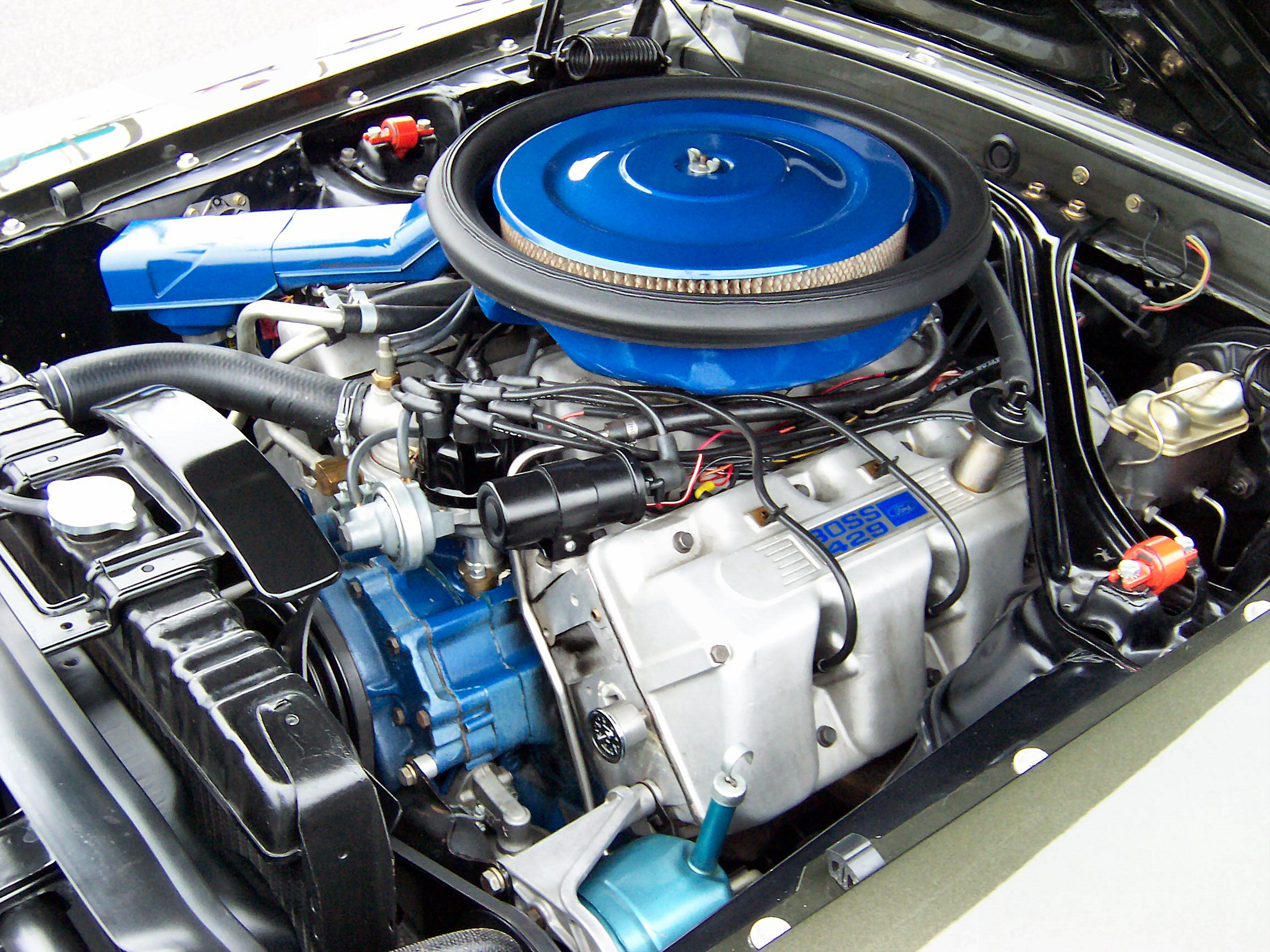

Had a Holley on one of these in 1969-70. Loved gas and needed wings.
