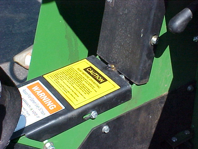

Not sure what your plates look like but mine have slotted sides on both plates so you ocan move them forward or backward which means that I do not have to remove either plate to grease. I will try and get picture this afternoon.

My center tunnel cover is slotted, but it is such a tight fit that I cannot slide it forward or backwards without a prybar. I could just slide it back and tighten down the blots and that would be that, but I still think I want to grind a hole there for greasing. Also, since I take it off every 8 hours, I find lots of grass clippings in there, so then is a good time to remove them.

Here is the pictures of the zerk fitting. I do like your idea for cleaning.

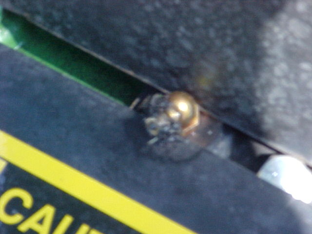

Another shot showing the zerk.
