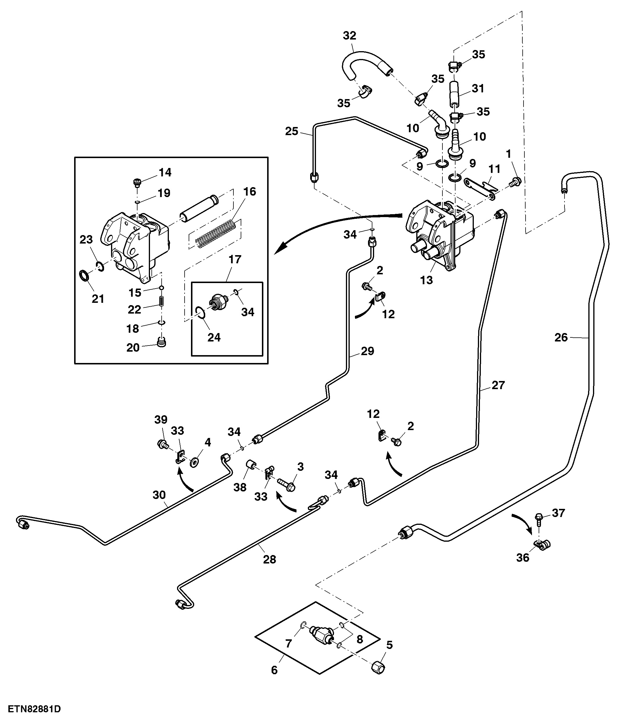

They have a substitute part for "AL181919" Spring Quantity 3, SUB FOR AL115253; which is the part which holds the compression disks against the friction disk and looks like the old star wheel adjusters from drum brakes based on the bad picture I'm seeing on JD's site.
What I can't figure out from their pictures is what pushes on the brake plates?

I asked the service guy about my lemon tractor. Said it was an adjustment under the dash that need to be ran almost all the way out? I don't agree since the second push is firm. New tractor is great except for constant caution lights. Dealer came out and looked it over. Ordered a new fuel pump and tightened the negative battery post.
Good luck to everyone else with problems. Loading and unloading can be tricky but when this new tractor was brand new I took it across the creek with 1/2 tank of fuel. It sucked air and died rights as I was at the top. Had it done it in the other tractor and died, it wouldve been nerve racking having to pump the brakes to get it stopped

Most JD utility tractors don't have "true power brakes" in the true sense of the words. The trans pump fills the brake valve but supplies "no pressure"(note the hose clamps) therefore in theory if brake disc pistons don't leak oil one could apply brake pedals many times without engine running and brakes would hold. JD hasn't changed the brake valve design much since the introduction of the 20 series so I wonder why the pedals on some newer models requires pumping? The following list of tractors utilizes the same brake valve.
