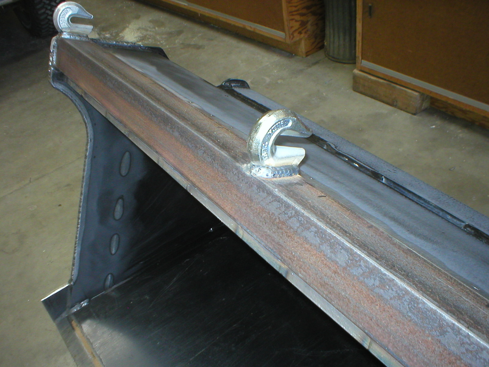

Sounds like you will be using your bucket a lot, you may want to put some extra support on it. Common is to put a piece of 3/8' angle on the top along with some chain hooks. Might want to put some 1/4" or 3/8" plate on the sides too. A tooth bar will add strength and make the bucket dig a lot better than stock. ;)

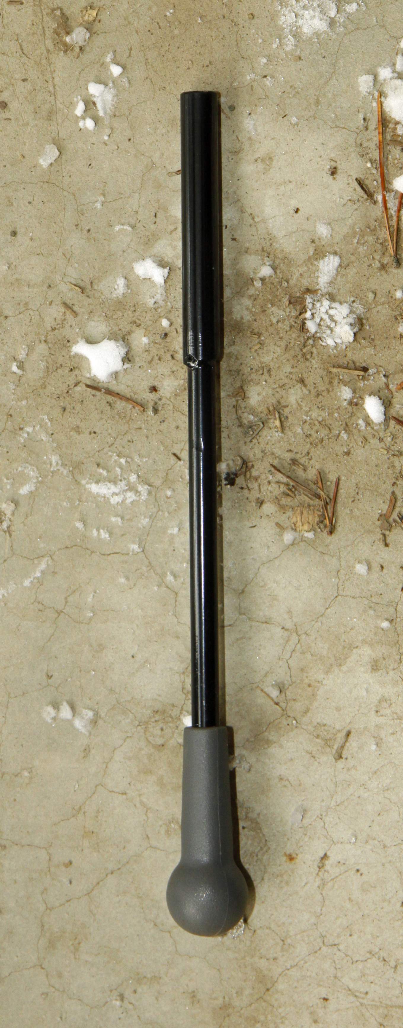

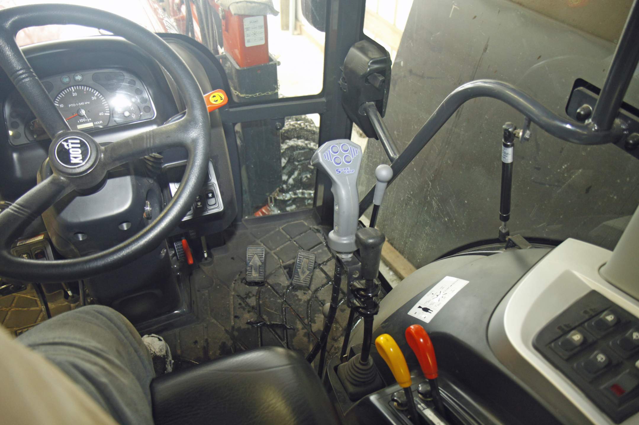

depends on how much you will use the grapple, but i put a set of hoses to the rear remotes and made a $1.00 extension on my non detente remote for a front plow and it really works slick. doesn't get in the way and removes in 1 second when not needed.
its also in the perfect position to use with a hand on the bucket controls. The control with the 4 buttons is the removable snowblower controls. Remember to add quick disconnects at the point where the loader connects to the tractor for easy loader removal.
