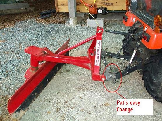

Here a pic of my rear blade with no skid shoes.
It works great up to 3". More than that, I recommend Front Snow blower. Long driway 900', you do not want it mounted on the rear.
The blade should float it's way around the driway & should not harm anything.
Henro, good to see you stop in /forums/images/graemlins/grin.gif, I was a bit worried. /forums/images/graemlins/shocked.gif
