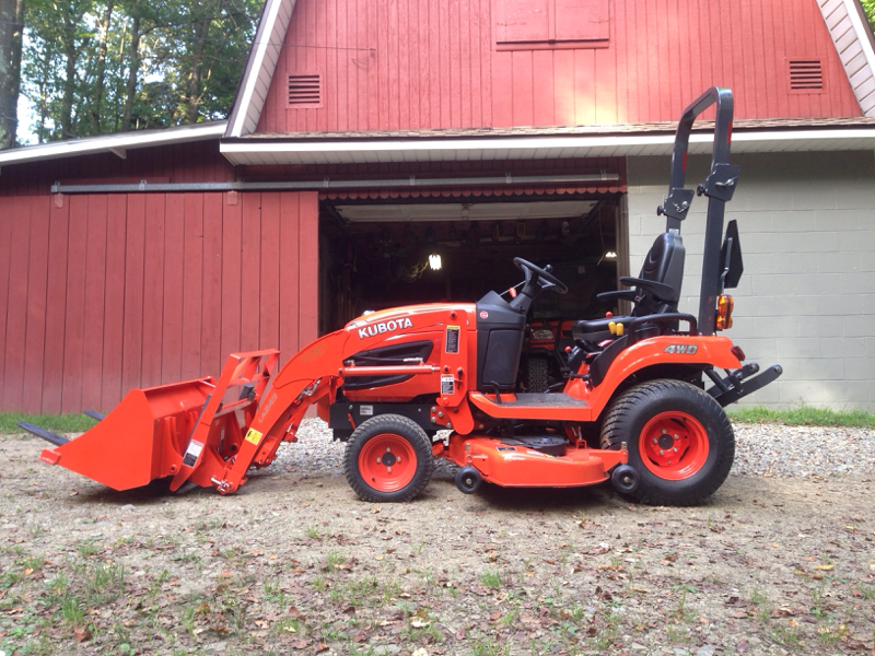

Our new BX2370-1 was delivered Thursday and we have about 6 hrs on it between my wife and I since Friday Eve. We have both found the ride to be extremely rough - jarring. The rear turf tires have rim guard in them and I have decreased the pressure to about 10 lbs each. I also put some different springs under the seat but neither or these seemed to have made much of a difference.
Any suggestions? Our old JD 425 and the Cub LoBoy we traded weren't as rough.
Would the $350 (yikes) Michigan suspension seat from Northern Tool be worth it?
We really want to like this machine...

This may be obvious but it helps to slow down. Maybe a box blade to smooth out rough spots. Not sure about alterations to the tractor though.

We found that using high range was definitely worse as every bump caused a brief speed increase then decrease giving a sort of whiplash type effect. Low range and/or cruise control helped that aspect.

I found that taking OFF the FEL when mowing helped a LOT. The extra weight up front seemed to cause a lot of bounce. I run 20 psi in ALL 4 tires. Have R4 tires front and rear for extra traction on my hills. Yes, it is a bit rough, but it still does a better job and is faster than anything else I have tried. If it is only rough while on gravel, try using box blade or back drag with bucket to smooth out.

I think you're going too fast. High range is only for transport on smooth roads. This is pretty universal among all tractors I have owned (and is probably mentioned in your user manual).
You should be operating in medium or low. For example, mowing is done in medium on Kubotas with a 3-range gearbox.

My neighbors yard is like that. Looks smooth but I curse everytime I mow it (BX24) for her as it throws me from side to side. Mine doesn't ratlle me at all so it might just be that you have ruts. My old JD 345 was much, much lighter overall and per contact patch area and the ride was smoother although it's a Chevy(JD) to Cadillac(Kubota) comparison in driveability. Do you mow with the loader on? That adds weight which can increase bounce and upset f-r balance. My ideal mowing speed is just faster than lo range. Loader off. BH off.

Most of your BX's suspension/shock absorption is the air in your tires.
Decrease the fluid. For the smoothest ride eliminate the fluid in your tires.
A longer wheelbase, wider stance, heavier, tractor with larger tires will certainly ride more comfortably.
Why filled Turf Tires on a BX?
