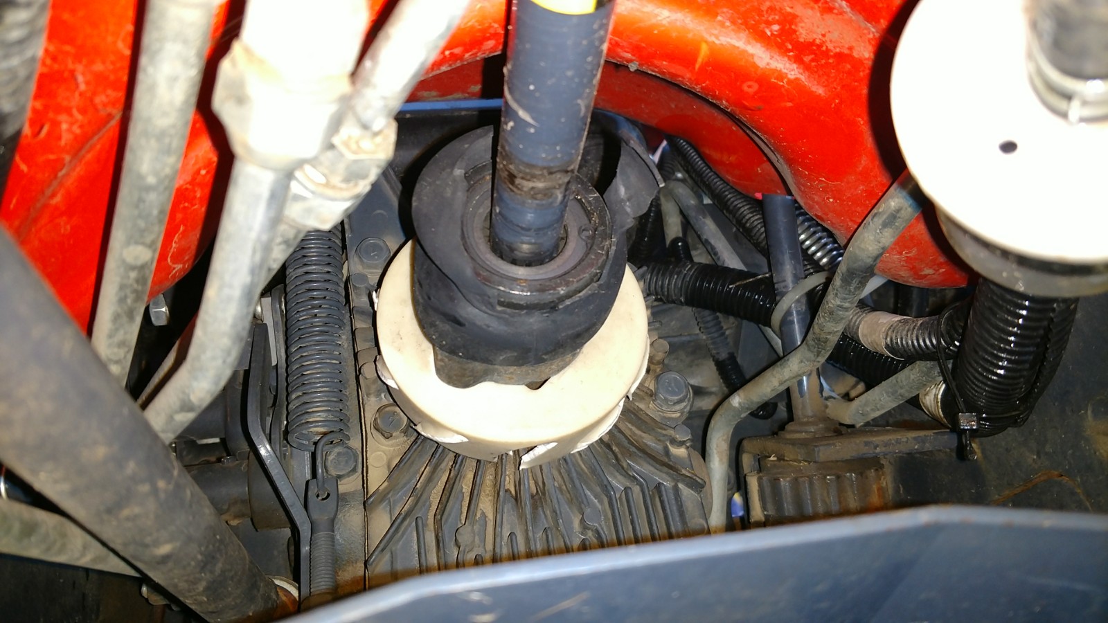

My buddy told me on day one to get a skid on it right away. Well, 4 days in and I cleaned the fan blades off of the HST fan. A stupid little stick went up and hit the blades and in less than a second I heard the fan hit and the blades went scattering around me. I need to get a skid! I have the old fan off, and it's waiting for new parts.

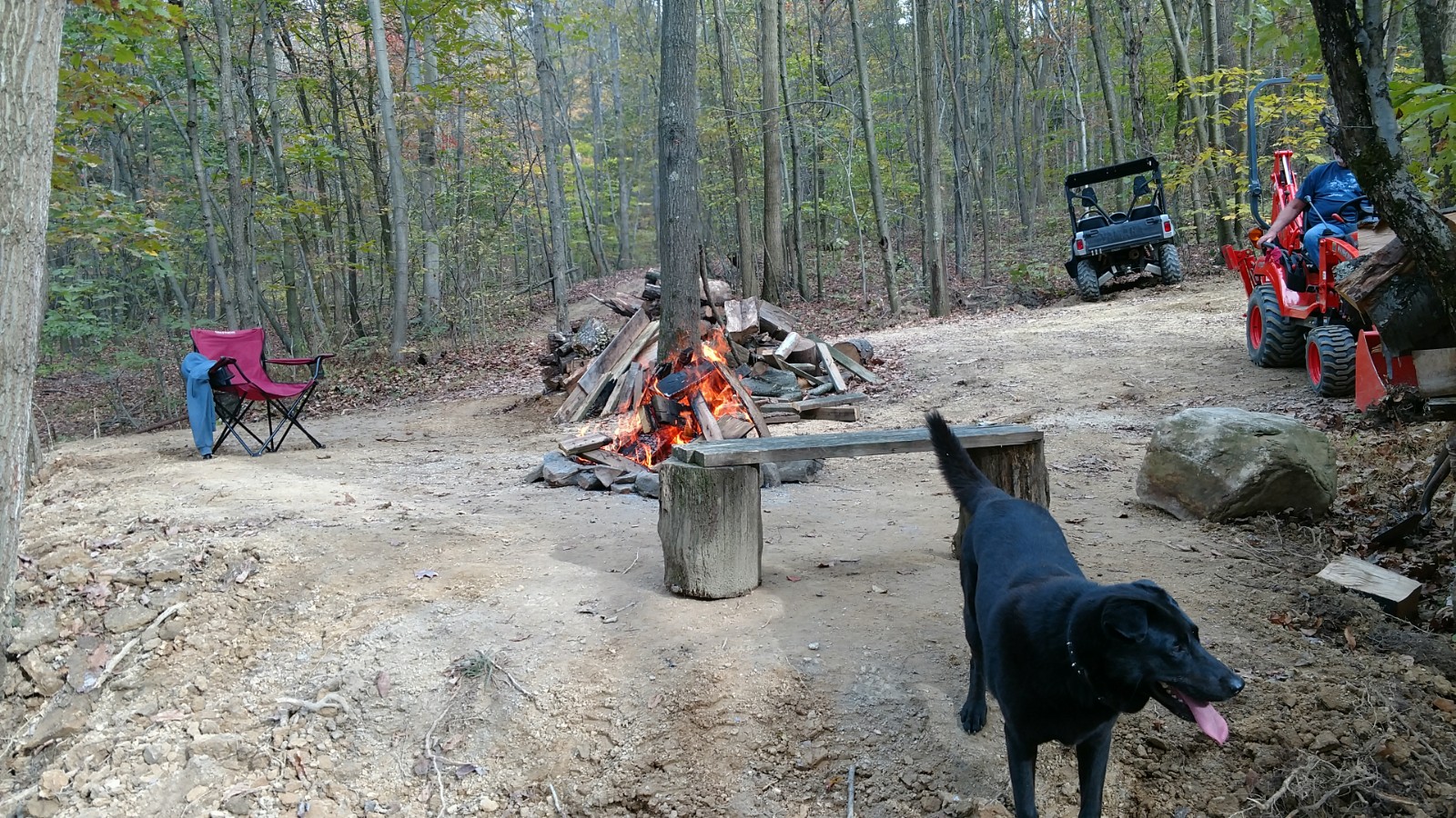

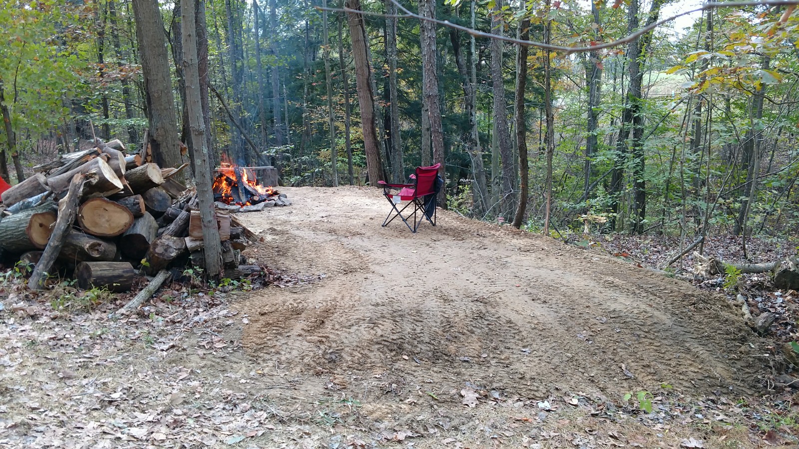

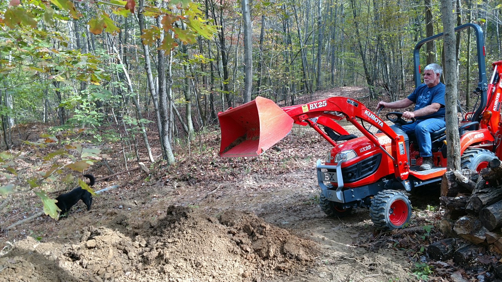

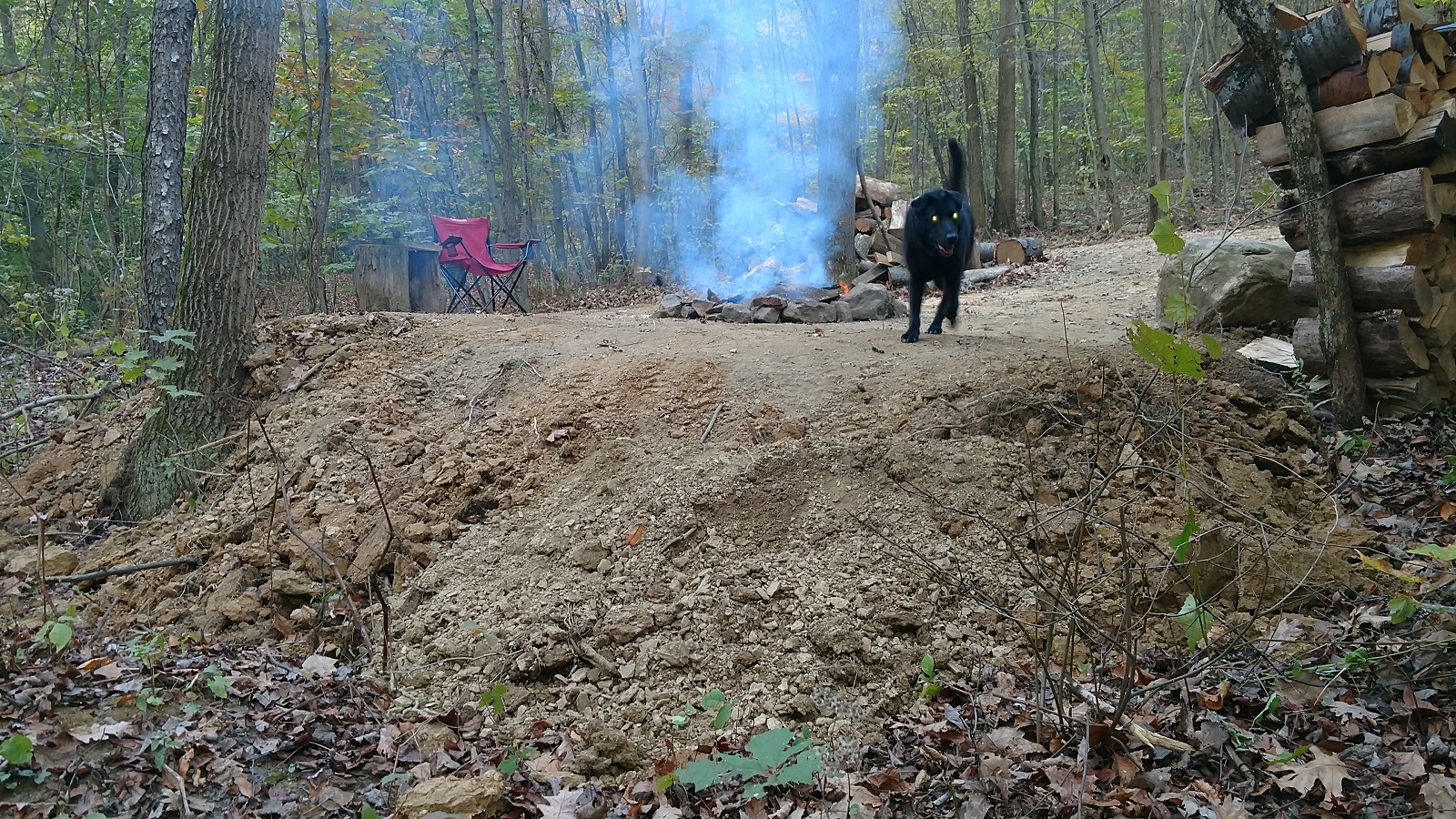

In 10 hours of engine time I was able to move a massive amount of dirt to level out our camp fire area, I used the loader to cut dirt from logging roads above the camp area and carry it down to dump, back drag and pack in layers until I built up around 3 feet to the low end of the fire pit area.

Back to the HST fan, I did not like the idea of stripping the seat, controls, removing the rear body, remove the hood and lift and pull the engine forward to get to the fan. That sounded painful. Instead, I pulled the front driveshaft CV from the crankshaft yoke. Removed the front CV from the shaft. Removed the crankshaft yoke. Removed the rear CV from the shaft. Spun the fan so that the half circle cut out was at obout the 8 o'clock position and removed one transmission bolt, then reached into that half circle cut out with a shallow 12mm socket on a 3/8" universal and a 6" extension and got the rear axle/driveshaft yoke clamp bolt out. At that point I was able slide the entire yoke forward and remove the 2 bolts holding the broken fan hub on. I plan to reassemble in reverse order. Total time to disassemble was about 1 hour and 10 minutes. Everything is being done with the tractor on jack stands and working from underneath. I do not want to make a habit of doing this, so I am ordering a skid plate pronto!

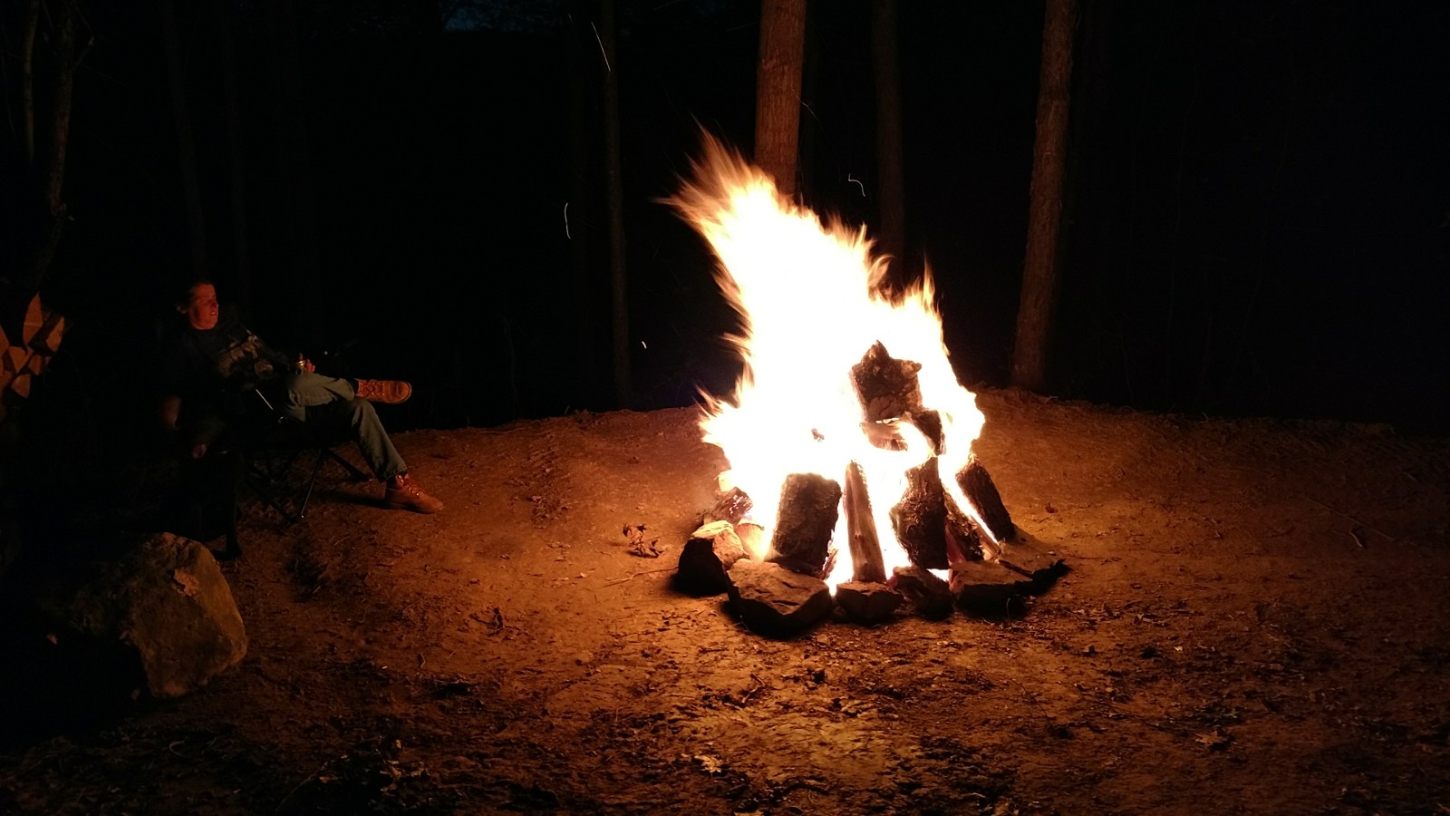

A picture of the celebratory camp fire after getting the fire area all leveled out and smooth. I like it!

Glad to see you are enjoying the little tractor. Just a suggestion I noticed in your pic's there is no tooth bar on the loader bucket. Most recommend the Bxpanded Piranha, you will find that the BX will dig more efficiently & with less effort. I have one on my BX24 & I noticed a major difference in digging. The subcompact's are not construction machines, but for around the property can't be beat.

Anthony, I do plan to get the BXpanded plate for the bottom, and the tooth bar. I also want to get a cheap Amazon weld on BH thumb. That is about all I think I'll need other than a LED bar hanging from the top of the ROPS. I hate that the headlights are perfectly placed to be blocked by the loader. Bad design.
My father ran to Kubota near us and got the CV boot for $3 and the new HST cooling fan for $7. Dirt cheap, but my... what a pain in the butt to change!

Have to agree on changing out the fan, biggest pain ever. My older BX2200 didn't need to move the engine to remove the drive shaft, somewhere there is a Kubota "eganeer" that got quite an atta boy for the new design, more labor charges. As for the other post i also leave the mower on for the summer grass cutting, too much trouble removing it. But in the cooler seasons I remove it & opt for the under armor because it makes it easier to maneuver through the trees cleaning up fallen limbs with the reduced width. The one thing you will start to realize with owning one of these machines they are worse than golf ,fishing, or hunting when it comes to buying accessories. Seems to always be something else you just can't live without.
