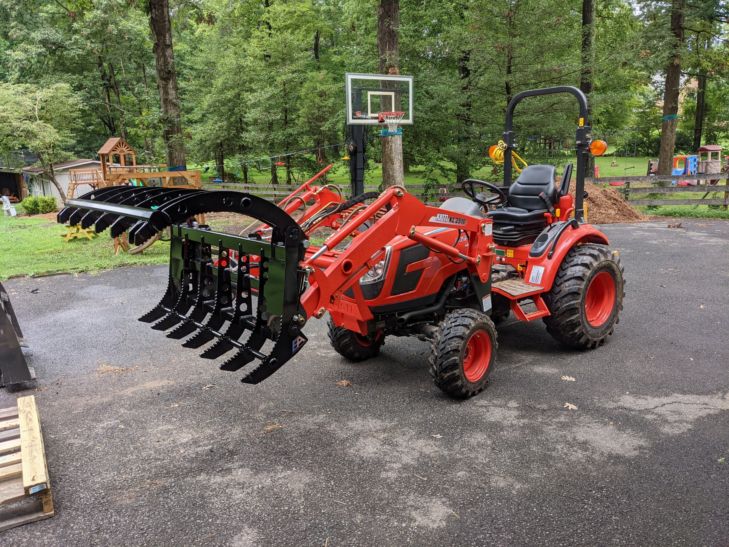

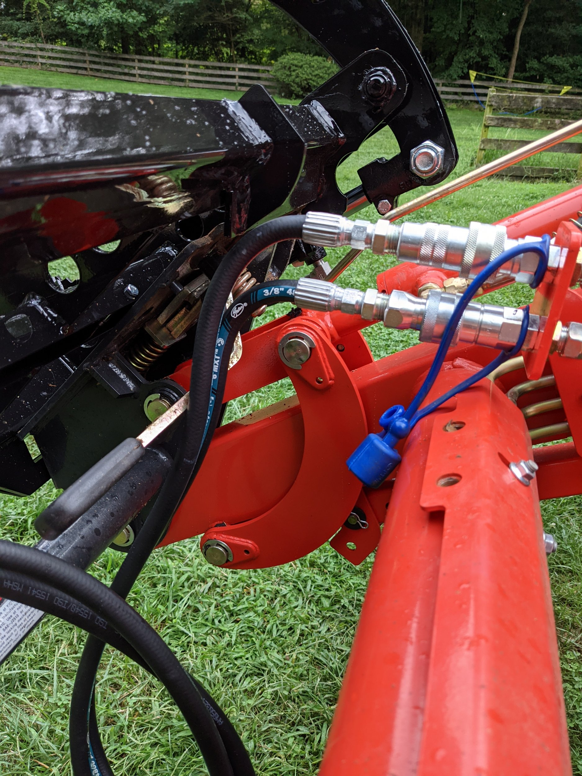

Got my EA Wicked tooth bar and promptly installed it. Good fit based on measurements I took using their instructions. If you order this for your CX buy a pair of 1 3/4 inch long 3/4 inch bolts to use instead of the 3 inch bolts they send you. Also, be prepared to totally use up a step drill bit to get through this bucket.

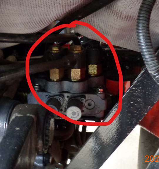

I just pulled my seat off, that thing is heavy. I think my plumbing is a bit different, here is a top picture of what mine look like. Or am I looking in the wrong place?

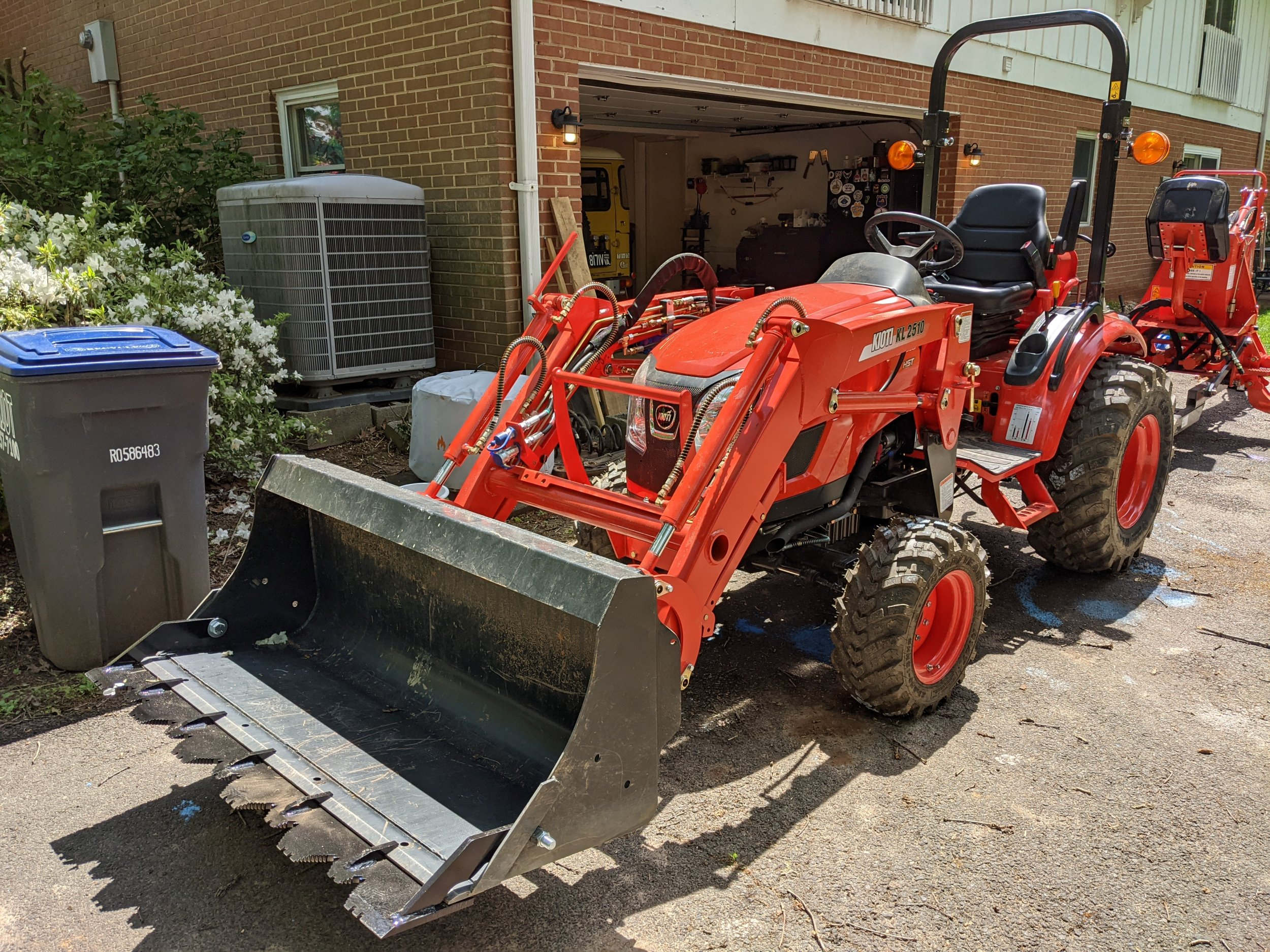

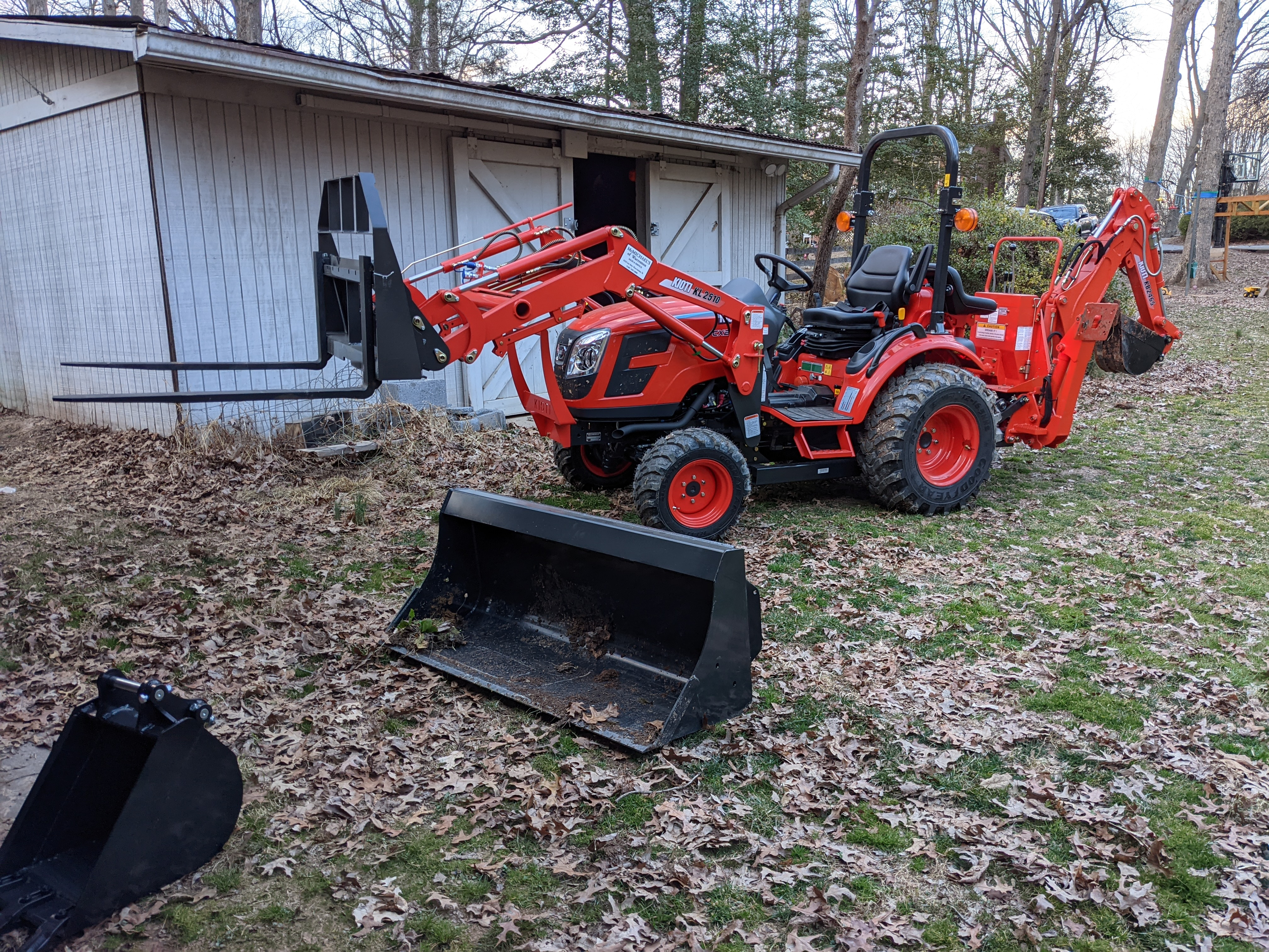

Just brought home my new tractor! CX2510 HST, R14s, loader w/ 3rd function, BH with 9 and 12 inch buckets, Titan 42" forks. $24,328 plus tax. Got about 5 hours on it already. Knocked out a lot of jobs I've been meaning to do for years. Got a lot more. The only thing I don't like is the non-retractable seatbelt but the dealer might have installed the wrong one b/c the manual says it should be retractable. I'll reach out Monday and see what's up with that. If it wasn't a mistake I'll just buy a retractable one and put it on myself.

I looked down best I could from the top and the valve block on mine is definitely different , maybe because it's for double remotes ?

The piping on the CX25 is completely different, the loader valve is located all the way up under the pedals, not the joystick. There is a long pipe that runs from the loader valve under the pedals power beyond output to your optional rear Aux valve.

I think I know what needs to be done. I found a copy of the service manual and figured out the piping from it.
There is a long adapter bolt fitting going into the rear Aux valve ass'y, where I have the red lines. If I remove the rigid line on it and connect my hose to it, place a 90 on the rear Aux valve ass'y. This would be the best place to tie in at, what do you think?

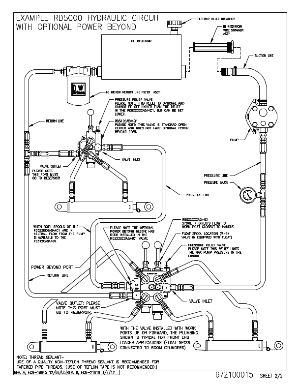

This might help a little with that.
Your third function is tied into your power beyond, so when your controls are in a neutral position fluid flow though the port and your third function can work, and all fluid your third functions not using and when your not using it continues back to the next spool. That is your rear aux, then hitch control valve, and then back into the return line.
I know how hydraulics work, I just didn't know where I should tie into on this tractor.
It’s in Iptman’s picture. Your HOSES replace the long pipe from the loader control valve to the transmission under the seat, the third function control valve is placed essentially in the middle of the old hard pipe. Hopefully this helps.
I can try to add more pics from what Iptman already added if it helps. Removing the long hard pipe was sort of a pain. I tried removing it without removing all the body of the tractor the instructions said to and I couldn’t get the pipe out till all the parts were removed.
