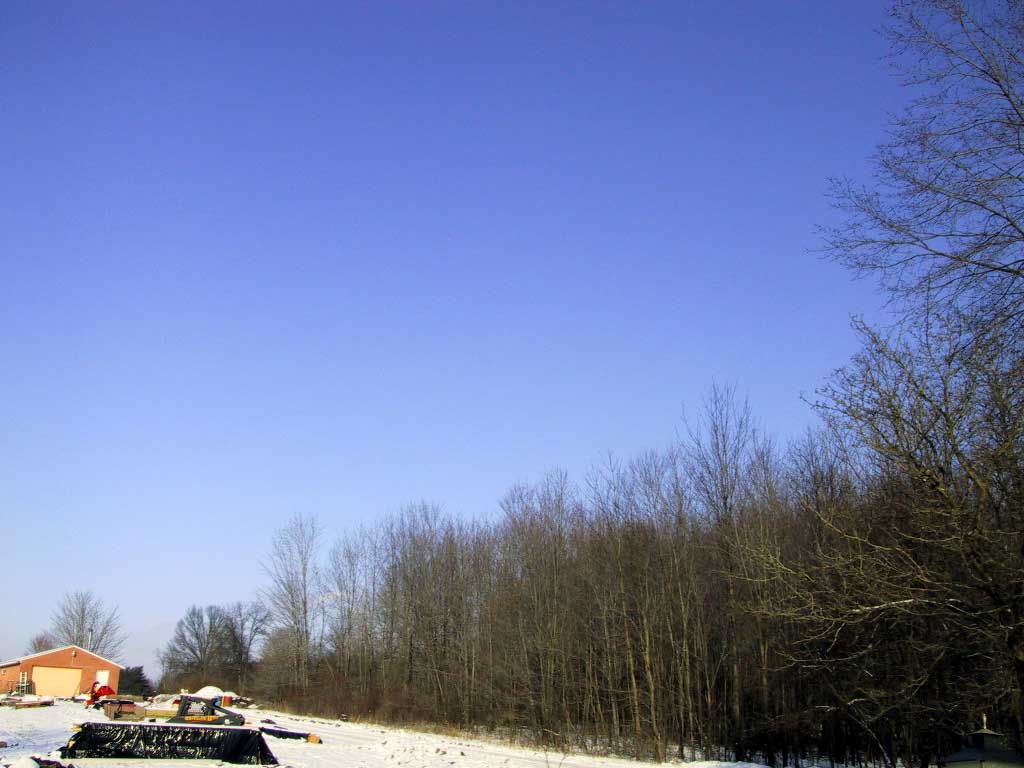

#101
Another view.

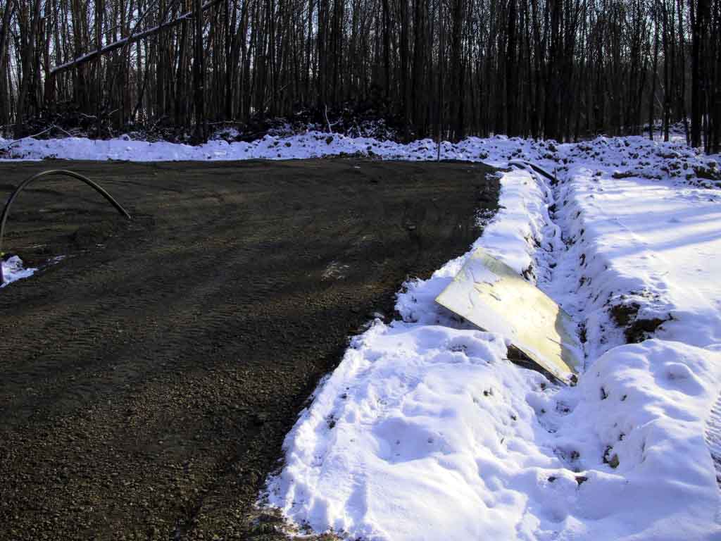

This is the north diversion ditch/french drain. It's about 20" or so deep and about 3' across at pad grade. Buck and I got the geotex, pipe, and gravel laid in it this afternoon just before dark in about an hour.

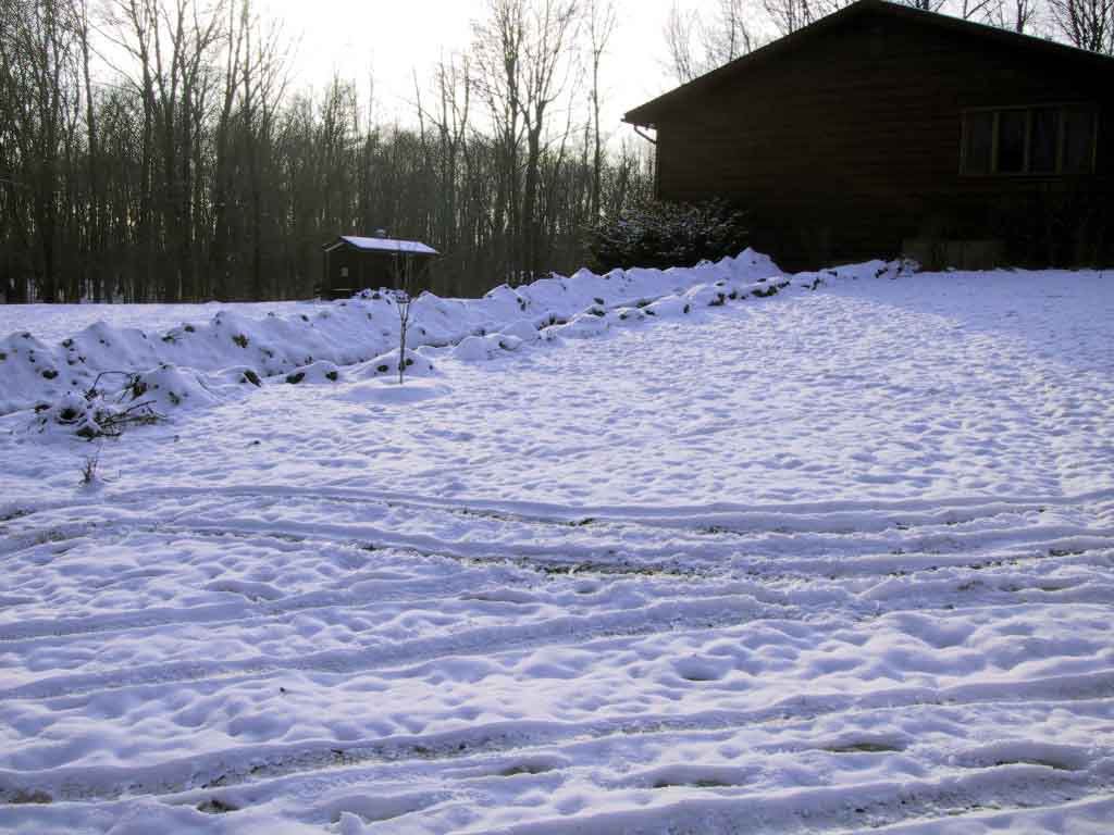

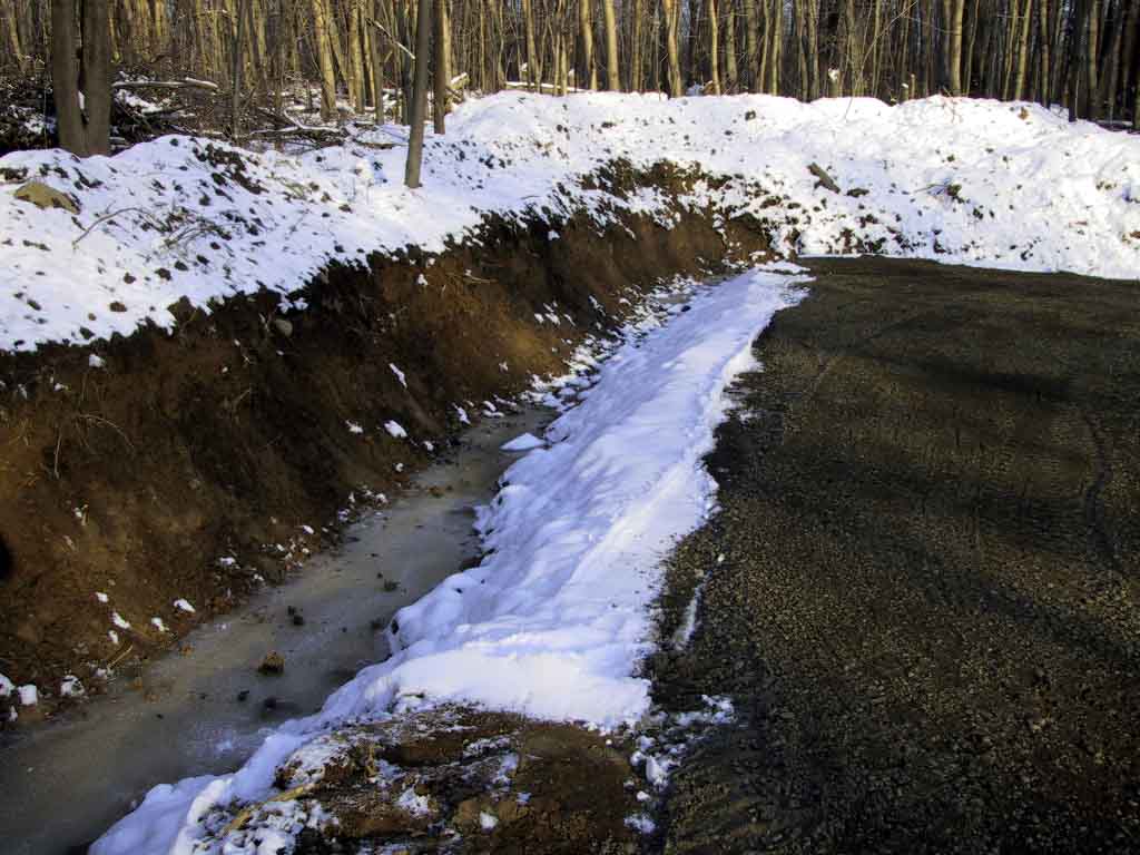

This is the east diversion which will be behind the building. It's at least twice as long - probably close to 100' - as the north ditch. We have to get it done before they put the sheetmetal up cause once that's done there won't any easy way to get the gravel back there. I figure we got two days at most .... if we are lucky.

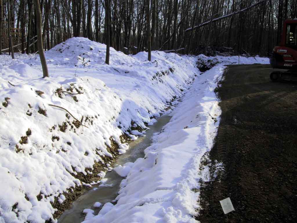

This is about where the front edge of the building will be (just to left of the center of the image .... you can see a corner stake in the middle rear of the image)

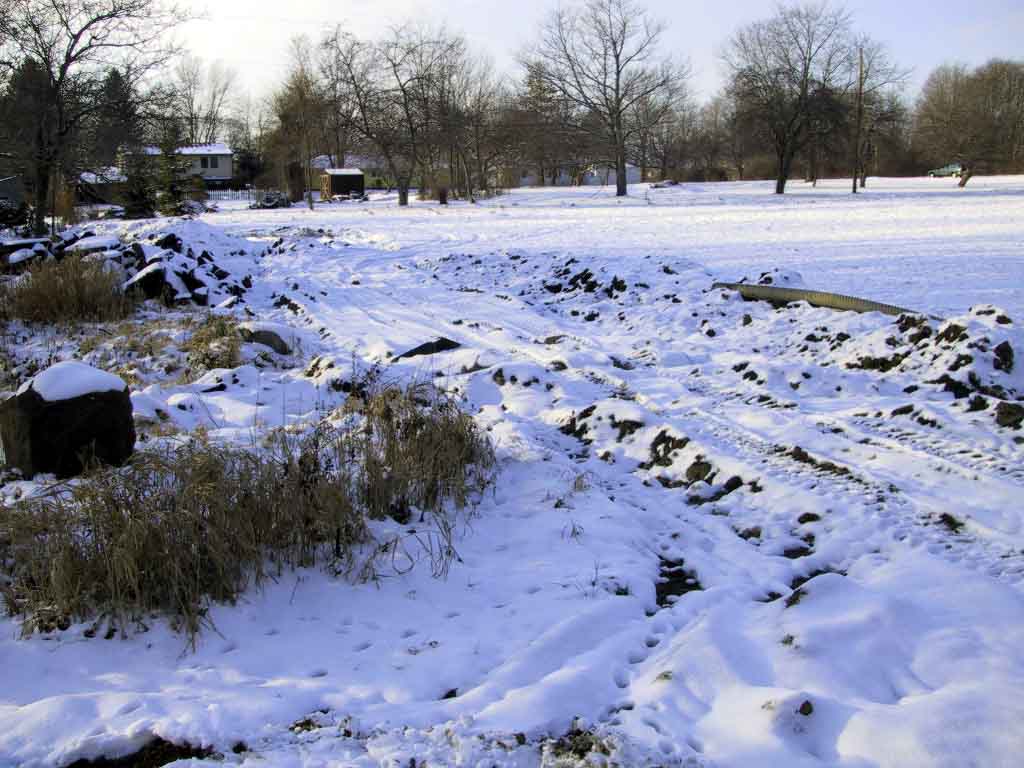

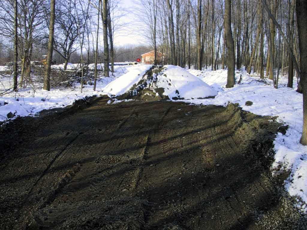

In about two days or so the crew will need to start bringing the materials down to the pad and I will have to have this 16 ton pile of sand moved. I had them stick it here .... it was about the best place available at the time but now it's in the way ..... /forums/images/graemlins/frown.gif
One thing I have learned about materials on this project - if you can have them spread it, do it. If you can't, have them place it as close to where you want it as possible.
I have the remainder of a load of washed No. 57 sitting up at the shed in the background of this image .... moving down to the pad doesn't excite me a whole lot ..... /forums/images/graemlins/frown.gif

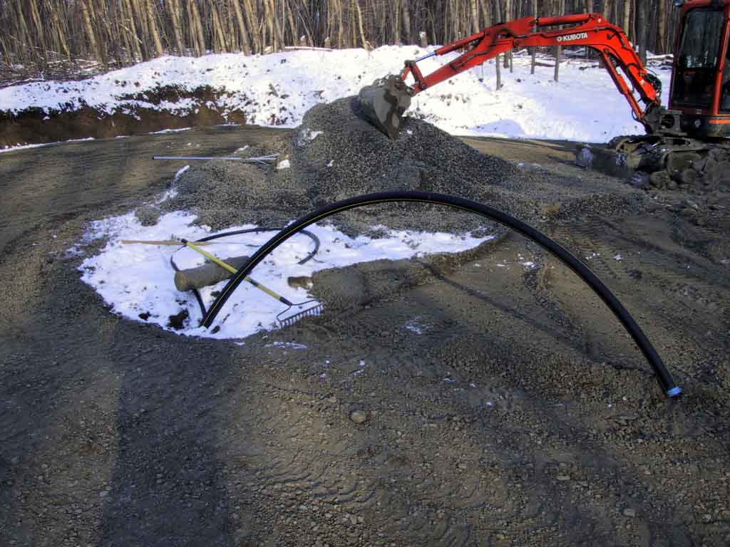

This is the current state of the turnaround ..... about half-done and pretty much worthless (as most half-done things are) ...... supposedly the weather is going to warm up a little in a week and I might be able to finish yet this year ....once the snow melts so I can see what the heck I'm doing.
