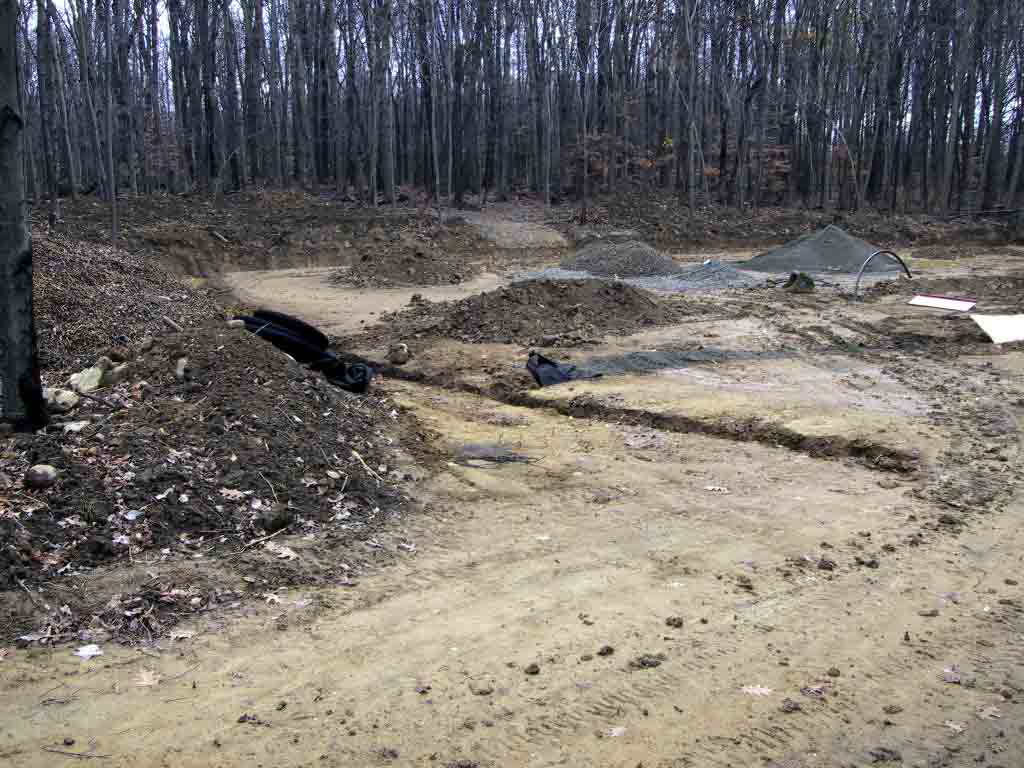

Well lately the weather put a little damper on things ..... these photos are from about 10 or so days ago. The building pad is bare clay .... when it gets wet it turns into a gooey, sticky mess so I try and stay off of it as much as possible until it dries .... unfortunately the necessary conditions to dry it out are few and far between this time of year.

#83
Looking east.

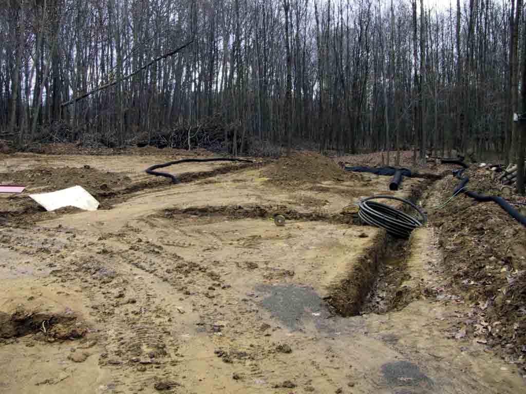

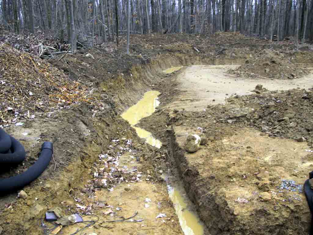

#84
I took out another tree and trimmed out a little bit of the north edge of the site to move the building up, onto more solid, undisturbed soil, away from the southwest .... where the soil is still pretty spongy. And I decided to do away with the french drain trenches (due to trench collapse), in favor of a diversion channel on the north end and back side of the building ... I'll still put 4" flex perf pipe in the diversion channels and tie them into the rest of the drain system .... and probably fill them with gravel.

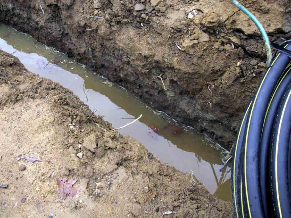

#85
This is the service trench for the gas and water lines ... it's probably 5' deep ..... you can see how much water ended up in it .... I've since pumped it out with a sump pump (immediately after the rain stopped) .... last time I looked it hadn't collapsed (.... but there is probably 6" of crud in the bottom of it), ...... alot of the other french drain trenches have had some collapse, particualrly the top edges. I may end up just filling the one open end on this one (at the edge of the pad) with sand and finishing it next year.

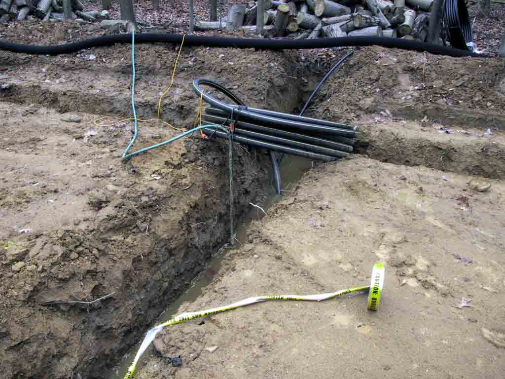

#86
Another shot. The moral of this story is: "Never dig more trench than you can backfill before it rains."
The woodpiles are no longer there - we split all of it last weekend and moved it up to the house. Unfortunately it was mostly all quaking aspen - which isn't the greatest for firewood ... but I'll burn it anyways.

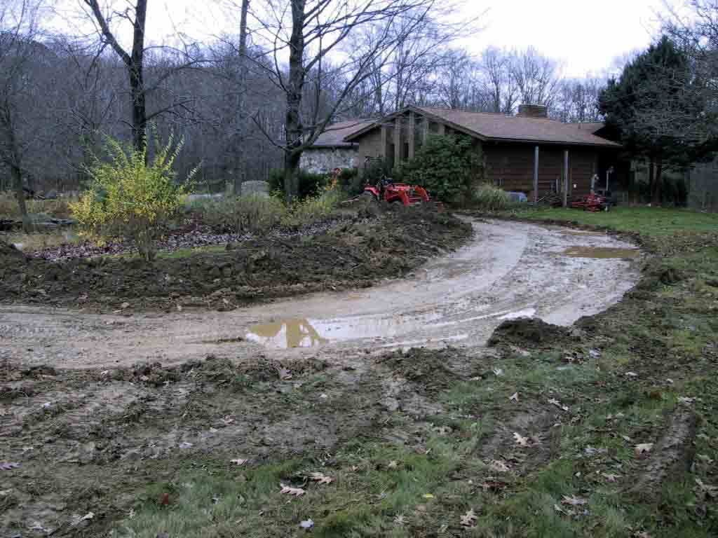

#87
Part of the reason for the lack of progress on the building pad is I've been trying to get the old driveway near the house tied into the new driveway before the weather gets really, really bad.
This is the new turn-around loop. close to the garage.
