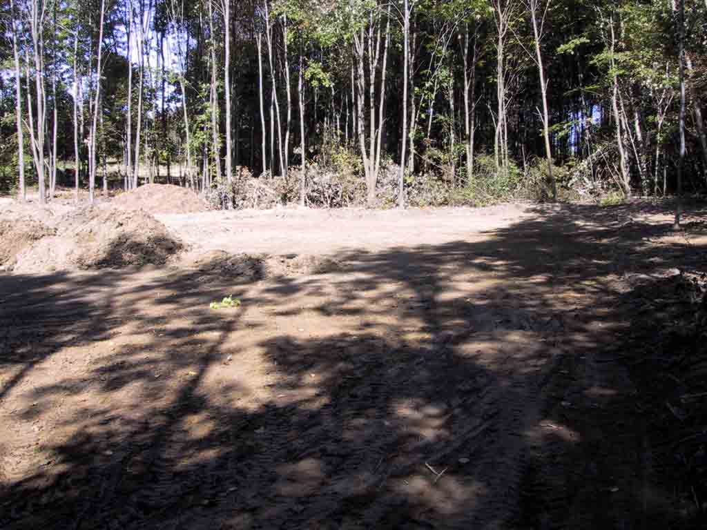

Looking North towards the top of the building pad. What's left of the original topsoil pile is on the middle left side of the image. There was a huge amount of it (10" 12'+ inches thick) - this area used to be a farm field where old man Combest grew field corn for his cattle, 30 years ago when my parents built here. My neighbor Jeff took out probably 15 to 20 loads with his son Stacy's 1-ton dump truck and then some more with the Bobcat. JASTN70D and Pineridge also moved alot more to the rear of the property with boxblades to create the path back to the stump pile. The woodchip pile is in the upper left corner of the picture.

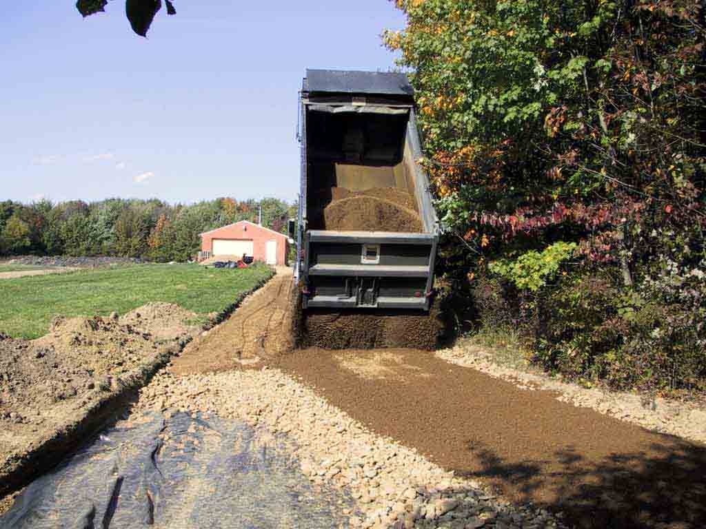

I had the gravel supplier tailgate spread the base gravel but I still had to spread it some to cover the edges of the driveway. The stuff that got pushed to the edges didn't have many fines in it so I had them bring 3 loads of "crusher run" to fill in the voids and stabilize the base.

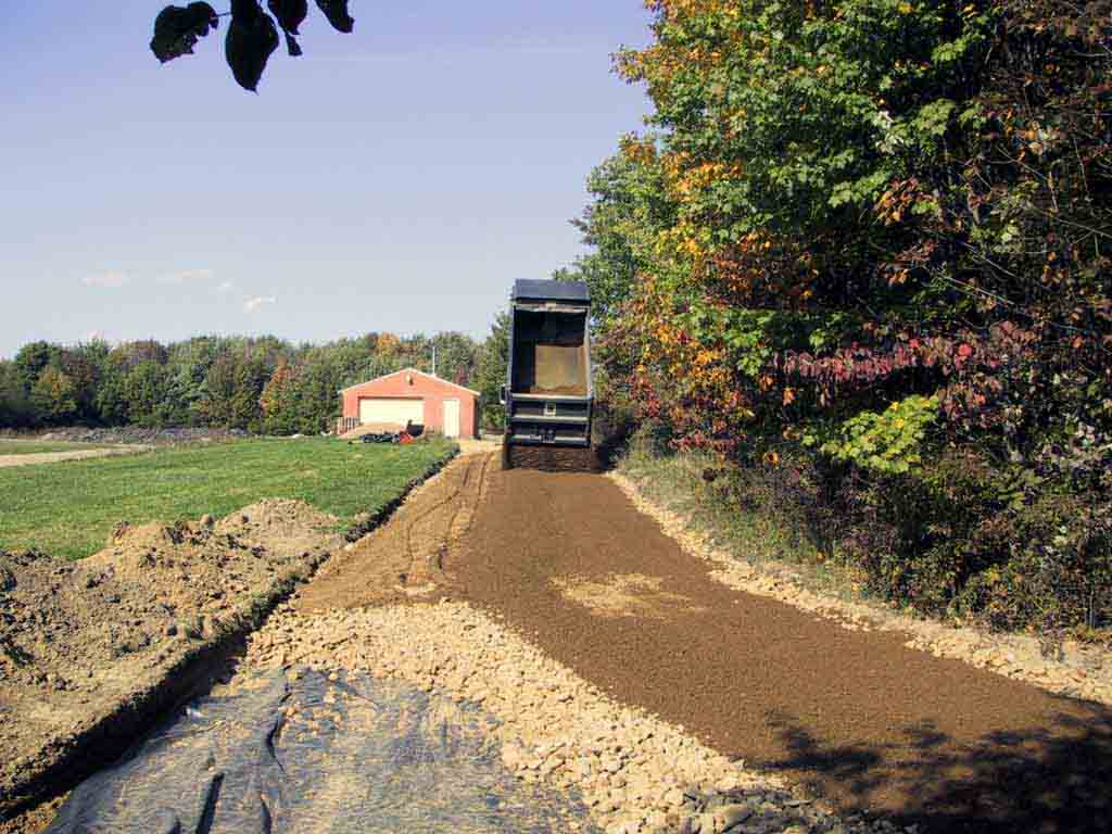

Almost empty. I'm spreading the crusher run by backdragging with an empty bucket and using a shovel and 3' dirt rake .... to avoid distrubing and bringing up any of the larger stones. Once we get a decent rain and the driveway gets driven over a little bit the fines from the crusher run should work their way down into the base and make it alot more solid.
