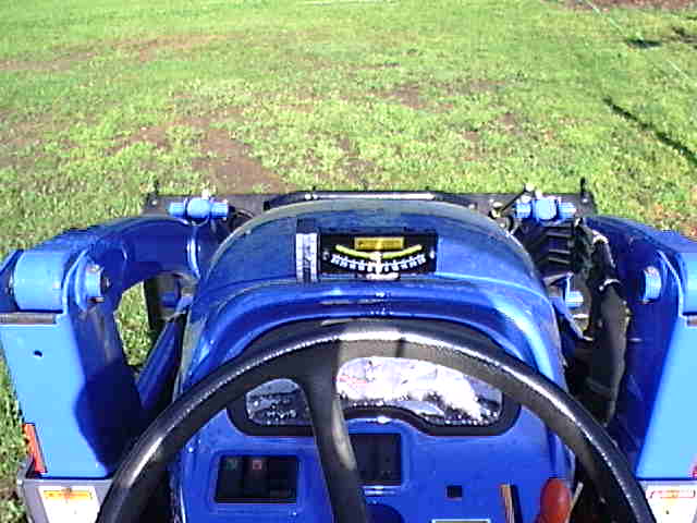

   / NEW DUAL AXIS SLOPE INDICATOR #44
For changing the mounting angle: how about a 10-15degree plastic wedge between the horizontal meter and the attaching bracket?
Attached is a picture from the seat.
Mark

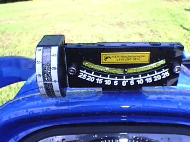

   / NEW DUAL AXIS SLOPE INDICATOR #45
Closeup attached.
Mark

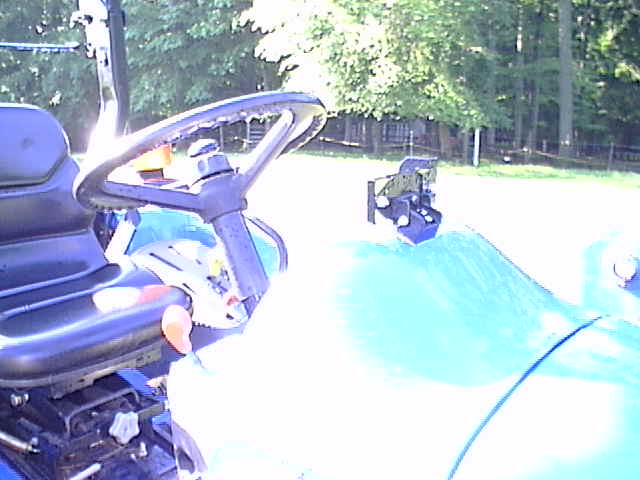

   / NEW DUAL AXIS SLOPE INDICATOR #46
Sideview mounting attached.
Mark
