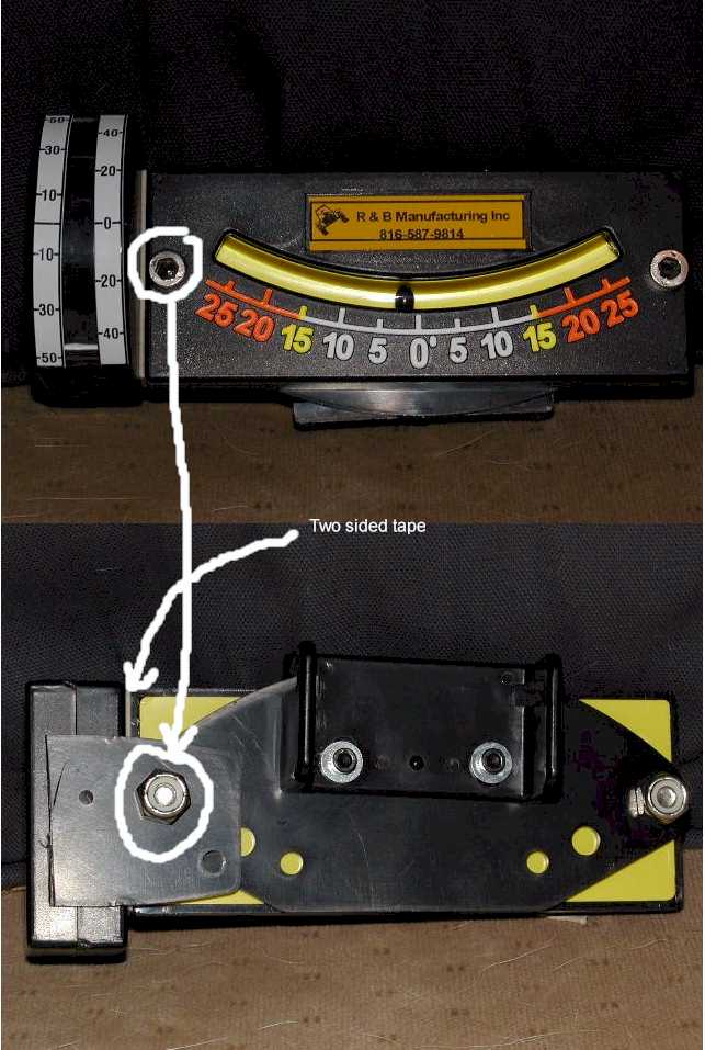

How do you attach the new part onto the larger meter?
   / NEW DUAL AXIS SLOPE INDICATOR #35
I'm not Rick, but I can show you how... /forums/images/graemlins/smile.gif

The hardest part was finding a place to mount it where I could adjust it to level AND see the indicators. While I decided on the top of the dashboard as close to the instruments as possible, this was made difficult by the NH design's lack of flat spaces (very swoopy...) I found a place where I can see 100% of the horizontal reading and 85% of the vertical. Going downhill, I can only see to about 25-30 degrees, but can see the entire 50 degree scale when going uphill. One other installation note: the horizontal guage had a big piece of two-sided tape (covering the greenish plastic on JMIII's picture) that caused the mounting bracket to warp. I just removed it and everything fit flat. I put that down to it being a prototype, since it seemed like it didn't belong.

MikePA,
Thanks for posting the pics. As you can see in the pics, the
little back brace is a proto-type piece of abs, used the
stiffen the mount of the dual axis part. Finished product
will be a finished piece. Very similar to proto-type, just better
looking. Most bolts are s.s. The intent of the fore aft indicator

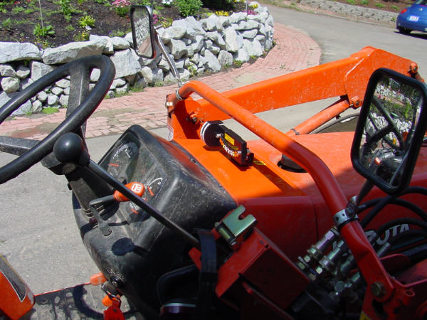

Rick,

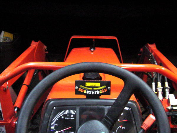

I just installed my test unit and took it for a test drive. First I want to thank you again for allowing us to test these units. You are doing some great work and I am sure your efforts will be responsible for saving some lives in the future. As a testor, I am assuming you are most interested in the negative feedback at this point, so here goes. The installation on my B7500 was a little difficult and I finally realized that there is a bit of a design issue that can be addressed. I have attached a photo you can refer to. I will also attach a photo of the original installation. My original tilt meter I attached to the top of my dashboard, which is angled, but it provided me with the best visibility. I was unable to attach it in the same location, because the fore and aft adjustment would not allow me to level it at that angle. Another issue is because the bottom mounting plate is so shallow, when going downhill it is very difficult to read the gauge because the needle moves to the diminishing area between the hood and the gauge. Perhaps a deeper mounting plate for this unit would allow for attachment on angled pieces and it would improve the visibility as well. Another thought, and I am sure this is cost prohibitive, would be to have the scale tied to the pointer, like a compass, and have the reference point be fixed on the housing. This would definitely eliminate the visiblity issue, however I am sure that would dramatically increase design and production costs. Just a thought though. I will continue to give feedback whenever I have any new observations.
Thanks again,
Greg

Here is my original installation.

Hi Greg,
Thanks for the feed back. If this is a problem to most others,
I will change it. Probably will anyway. ( I have been working
on a fix most of day.) Will slightly change mount if required,
and change label for easier viewing. What if dual axis part was
mounted on top with a brace? Would this help? /forums/images/graemlins/confused.gif Thanks for
your effort. Rick /forums/images/graemlins/confused.gif
