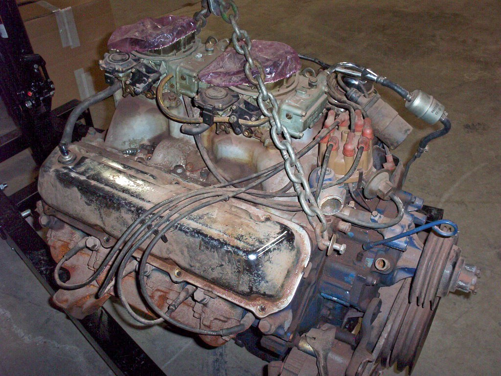

Oops, 366, I was thinking Chevy truck engine. Your engine is a Lima series Ford, similar to mine in the pic. It doesn't take much coolant at all to make a lot of smoke. But the oil, on all the plugs. Follow all of your vacuum lines, do they go anywhere where there is ATF or power steering fluid, or any other type of oil? I have seen modulators leak ATF into an engine's intake and make white smoke, this is common on Chevys with automatic trannys. I'm going to go back thru the posts and see what info I can find.
What Iron Horse says makes sense and is worth a shot. If your air filter was plugged, vacuum would be high. Usually if a diaphragm type fuel pump is going to leak, it will leak fuel into the oil, not the other way around.
I would also check the vacuum line to the distributor's advance diaphragm. Usually if there is oil in the intake passages, there will also be oil there.

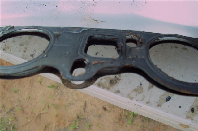

I think you figured it out when you mentioned the intake manifold. I took it off today and every intake port is full of oil. The gasket has three layers. One is the sivler pan that conects both sides of the engine. Then at the haed, there is another metal gasket on either side of the silver one.
When I installed it, I put silicone on either side of the gasket, but not bewtween the layers. I couldn't find an obvious leak, but this migth be where it's at. I'm debating on not even using the gasket and just using silicone. Has anybody done this before?
While cleaning off the old silicone, I noted that there was oil in the very middle port. I thought this was for water, but it's full of oil. The water ports at the beginning and end of the mainfold have water in them, but this one has oil, as you can see in the picture. It connects to both heads and has a large cavity right under the carburator. Why? What does it do?
I'm not sure if the gasket is leaking, there is one or two places where it might be, but with that big pan underneath the intake manifold, I'm not so sure it's coming through the gaskets. The vacume test says the gasket wasn't leaking, I can't find any sing of leakage, so now what?

The one in the middle is the exhaust crossover port i spoke of . It is there to heat the intake charge . That's what i meant about if one muffler was blocked on a twin system the gases have to travel through this port to be able to exit the other exhaust pipe . If the gasket is blown at these ports it will presurise the engine with exhaust gases . The tin pan stops the hot oil being flung at the underside of the intake manifold by the camshaft . Make sure to replace all gaskets (Felpro would be my choice) re-use the tin plate shield . Use Neutral cure Silicone on the valley ends but not on the intake ports . Petrol vapour travelling past the Silicone will make it fail in short order (use Permatex or simillar). Scrunch up a handfull of Aluminium foil and lightly hammer it into a plug shape and force it into the center exhaust crossover ports in the heads , use the wooden handle of a hammer to make it a flush fit . This will stop the exhaust over heating the carb and causing vapour lock on hot days . Make sure to check the mufflers for mud before starting the engine . I think your engine is fine , just check the things mentioned and put it back together .

Were the heads surfaced? And if so, do you know how much was removed? Reason being is that if they were done in then past by a previous owner and then again by you, there may be a mismatch with the angle between then intake and cyl heads, which could allow oil to be sucked up from the lifter valley. Usually with worse cases, you will have driveability issues right from start up of the fresh overhaul. This might not be the cause and may be a long shot, but was worth mentioning.
A more likely cause would be the silicone sealer on the gasket. All intake gskts should be installed dry, no sealer. And NO do not use just a sealer in place of a gskt. Only the end rails should have a sealant applied. What may have happened is since the intake is alum, the expansion/contraction between the intake and iron cyl heads caused the silicone seal to break which again could suck up oil from the valley or even past the threads from the intake bolts. Are the holes in the cyl head for the intake bolts blind or open? If open, oil could be sucked up past the threads.
Here's what I would do as long as the heads haven't been surfaced multiple times. Replace the intake gskts including the valley pan with new. It should be part of an intake gskt kit anyway. Unless your having specific vapor lock issues, I wouldn't block off the exh crossover ports. Majority of the time that tin valley plate is sufficient to keep hot oil off the bottom of the intake and keep the temperature within limits. If you are having vapor lock problems, they make a gskt kit...last time I checked...that has those ports blocked off for that purpose. Only use an RTV sealer on the end rails and around the coolant ports. If the intake bolt holes are open and not blind, use a teflon sealer on the bolt threads. DON"T use the teflon tape, use the sealer in a tube.

Iron Horse is right on. The aluminum tub below the intake is called a turkey tray. You can re-use it. Use Fel-pro gaskets, they are made to be used without any sealer. Just put a dab of silicone in the corners where the intake, heads, and block meet. The exhaust crossover can be blocked. This is there to help the engine warm up faster in colder climates. I don't think this is necessary in Texas. Head surfacing will not create an angular mismatch. Port mismatch yes, but on a truck engine, nothing to worry about. If you look up Summit or Jeg's you can find heat riser block-off's to block those exhaust passages. I've never tried the aluminum foil trick. I don't know about the oil in the intake manifold crossover. You naturally get some builup of carbon or if you are burning oil, some sludge buildup, but oil? Weird. If every intake port is full of oil, I believe you are sucking it in thru the vacuum system somewhere. That's where I think your problem is. There are no oil passages thru the intake gaskets to leak. All the oil goes to the top of the engine thru the pushrods.
