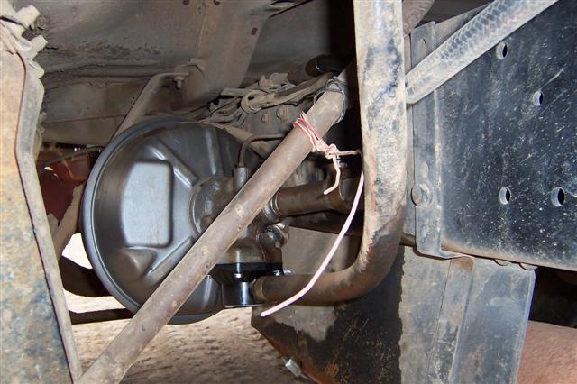

The replacement Vacuum Booster came in the other day. It's a simple install, but bleeding the air out of the lines was unlike any other vehicle I've ever done.
First, you do it with the engine off.
The booster has it's own valve for bleeding and you start there first. I had my Dad pump the pedal and I'd bleed it. We went through two bottles of brake fluid to get it all done!!!
Now I have a new engine, an amazing level of power and working brakes!!!
First picture is of the Vacuum Booster installed.

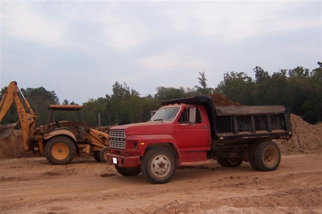

Second picture is of the dump truck in my lake site with a load of dirt.

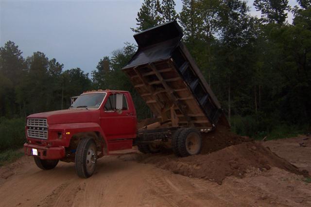

Third picture is of the dump truck dumping a load of dirt.

The power difference is just amazing. It was gutless before, but geared low enough that I was able to get around my place with it. Now I load it up full with 6 yards and climb up out of the lakesite in second gear!!!!
Fuel consumption is way down, the oil looks as clear and clean as the day it was put in and it fires up every time I go to use it!!! I'm hopefull that it will get me through the next couple of years of work I need it for, than I can sell it for what I have into it. Even if I gave it away, I'd be money ahead with what I've been able to do with it compared to hiring it out, so that's a good thing too.
