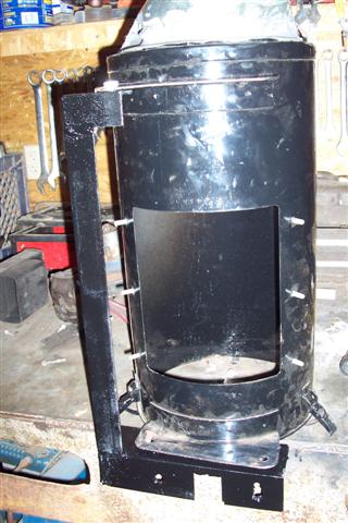

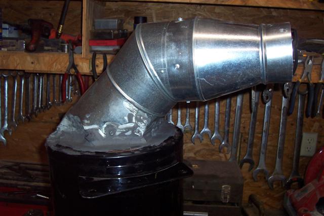

After trying just about every location possible for the air cleaner, I chose teh space behind the headlight, beside the radiator and where part of the inner fenderwell is located. I cut out part of the fenderwell so that I would have room. The frame already has some holes in it that I can bolt to, so that seems like the perfect location.
I cut apiece of angle iron, notches and drilled it for the holes. Then I welded on another smaller piece of angle iron for a support and another attachement at the top of the filter. I will have three points to attach the filter housing to my bracket. The bracket has two bolts that will hold it to the frame. I'd like to make it stronger, but ran out of ideas where to go with it, so I'm going to give it a try and see what happens.
The canister is going in upside down. I will be able to removed the lid, which will allow the filter and dust that settles in around the outside of the filter to fall downwards and away from the path to the carburator. This filter is easily five times larger then my factory one, so it should work REALLY well to pre-filter the air before it gets to the factor filter, which I'm keeping.
The ductwork is from Lowes and for AC lines. I screwed on a square vent end with a six inch 90 to the end of the filter canister. I also used a full tube of duct silicone type caulking sealer to fill in the air gaps around the two pieces. Then I smoothed it all out with my fingers to get the look that you see in the picture. I added a 6inch to 4inch reducer with screws to the end so that I can fit on a standare air line to my factory air filter. After the caulking type stuff dries, I'm going to wrap all of it with HVAC foil tape. I think it's better then regular duct tape, but if it starts to peel off, I'll try something different.
It rained over 3 inches today with more expected. The mud is absolute and it will be a couple of day until I can do anything, so I'm just letting the caulking type stuff dry. When I mount it, I'll take a few pictures and post them here.
Thank you,
Eddie
