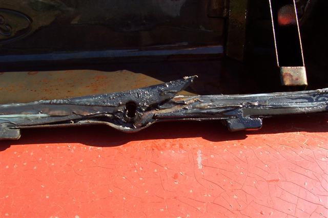

On my first load, I noticed that it was smoking real bad from under the hood. The valve cover gasket was leaking oil onto the exhaust manifold. I took it off and saw that the gasket was broken. I had a brand new tube of gasket sealant, so I just put it on real thick. Then when I went to put the air cleaner back on, the threaded part that goes into the carburator broke off about halfway in. I taped up the carb to keep it clean, then drilled a hole into the broken part and pulled it out with an easy out. One load of dirt moved and it was already noon.
We moved a dozen more loads of dirt when the smoke returned. I figured it was the same problem, so my dad volunteered to go to town and get a new gasket. I pulled off the cover and found that it had broke in a new place. I might be a little slow, but two breaks on a valve cover gasket just seems a little odd.

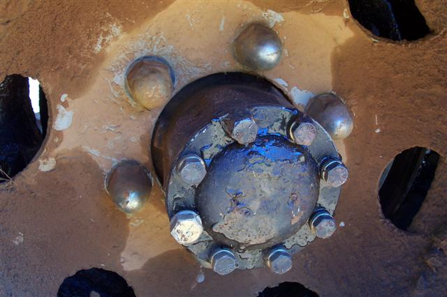

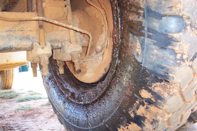

The axle is leaking oil again too. It leaked when I bought it, but the new seal didn't hold. Another seal failed, and then the third. This is seal number four, and all four seals are from different stores. Obviously it's either a bad axle or a lousy mechanic. Probably the mechanic. :(

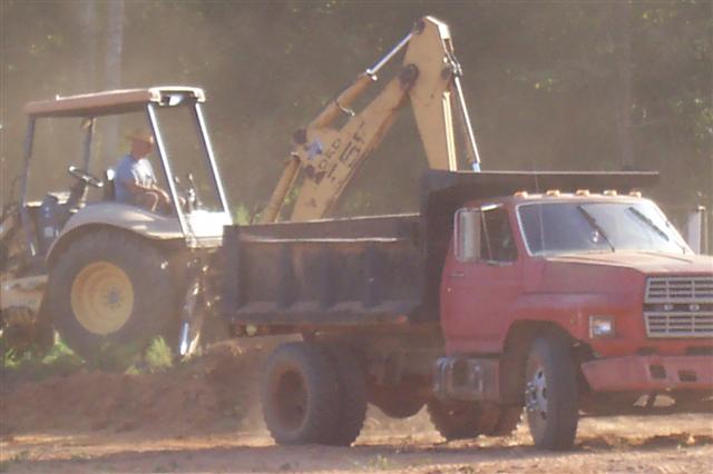

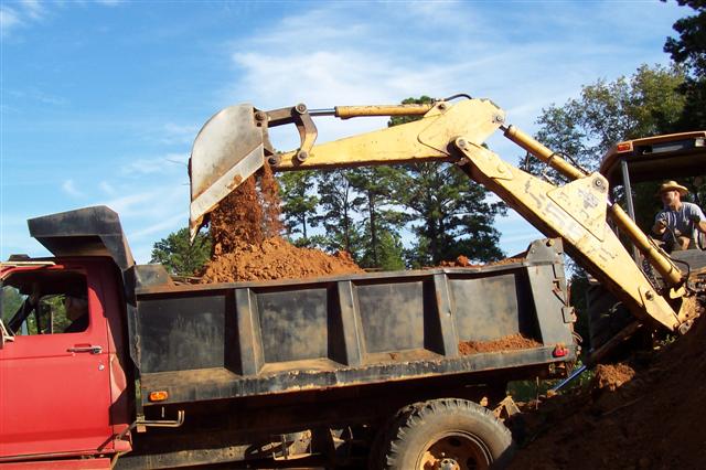

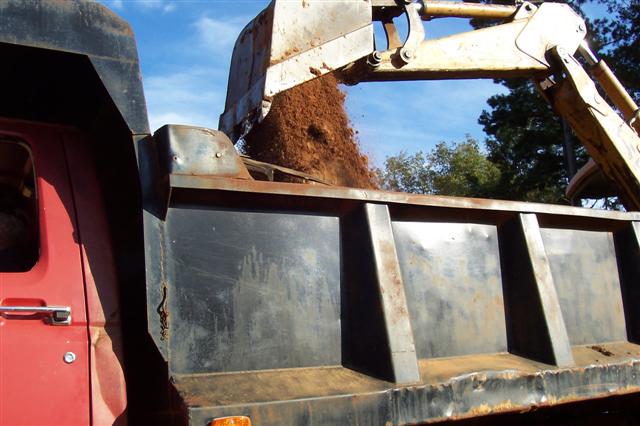

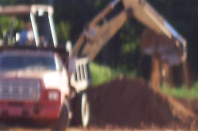

While loading dirt, I gave my 7 year old the camera, and told him to take some pics. He really likes the zoom and I have allot of closeup pics of the backhoe bucket now, but he also got a few that show we were actually moving dirt today, and not just wrenching all the time.
Eddie
