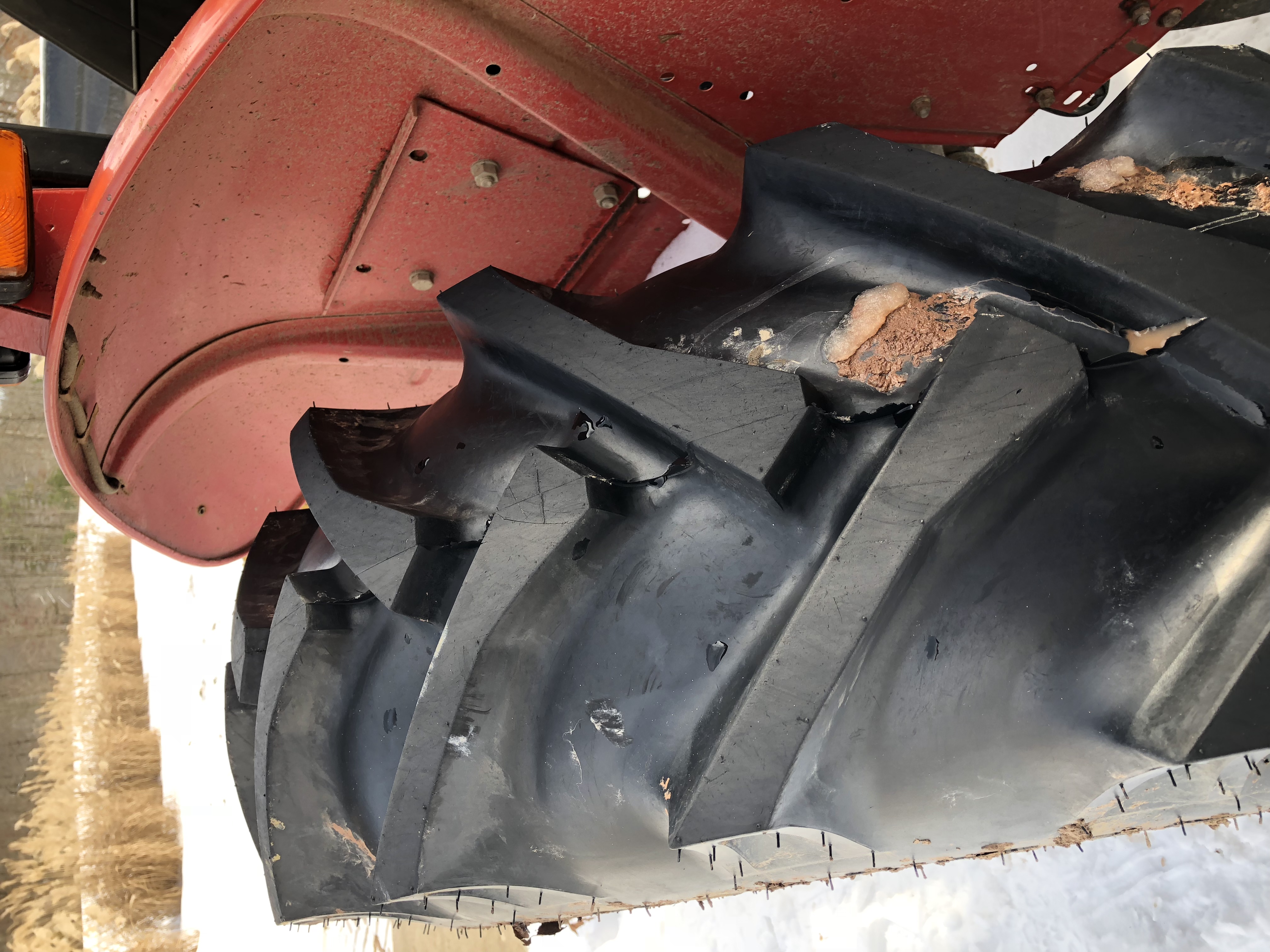

I have a lot of black locust logs froze up so I needed the tractor to break them up so i could cut them for firewood. It wasn’t the work that was the issue, it was the terrain i drove on to get there and I didnt feel the tractor was the most stable.

I will start another thread inquiring on that information as well. With that being said, I did want to post this up here as well. I just went snd checked the tires and there are two different tires on it. One looks somewhat new, at least compared to the other....maybe this has something to do with what I have been experiencing?
Width of tires outside to oustide is 76”. The data sheet says it should be 76” so probably no spacers?
Also, i will say this, i would not be surprised the least if these tires are not filled...

76" will be the 'standard' spread with R1/ag tires, not the widest posible. It is a tractor data convention that tire spreads are always given with R1/ag tires.
Air in the tires, rather than liquid, will decrease feel of stability on slopes, as will having a rear tire on one side with more grip than the rear tire on the other side. Sometimes there can be enough difference in tire wear to cause a tractor to cant to one side, which throws off weight distribution putting more weight on the poor tire and less weight on the good tire, decreasing traction. In your second photo it appears tread differential is at least 1". Old, hard tire rubber does not grip as well as more pliant tire rubber. Low temperatures increase rubber stiffness.
LINK: tractor rear wheel spreads - Google Search
Few 5,000 pound tractors have wheel spacers because this category is primarily used in flat fields.
I was in the expansive Palouse wheat country of eastern Washington state recently. I speculate most 5,000++ pound tractors in the Palouse have wheels spacers installed in order to operate grain drills and combines on the knobs and precipitous hills there, every inch of which is planted.

I did create the new thread but it appears we have the answer as far as spacing goes..
I can’t really change or do anything to this tractor (spacers, filling tires, etc.) so i will have to just assume that this tractor could get more stable but how much more and would it be sufficient (or rather, best) for my situation is still the question.
