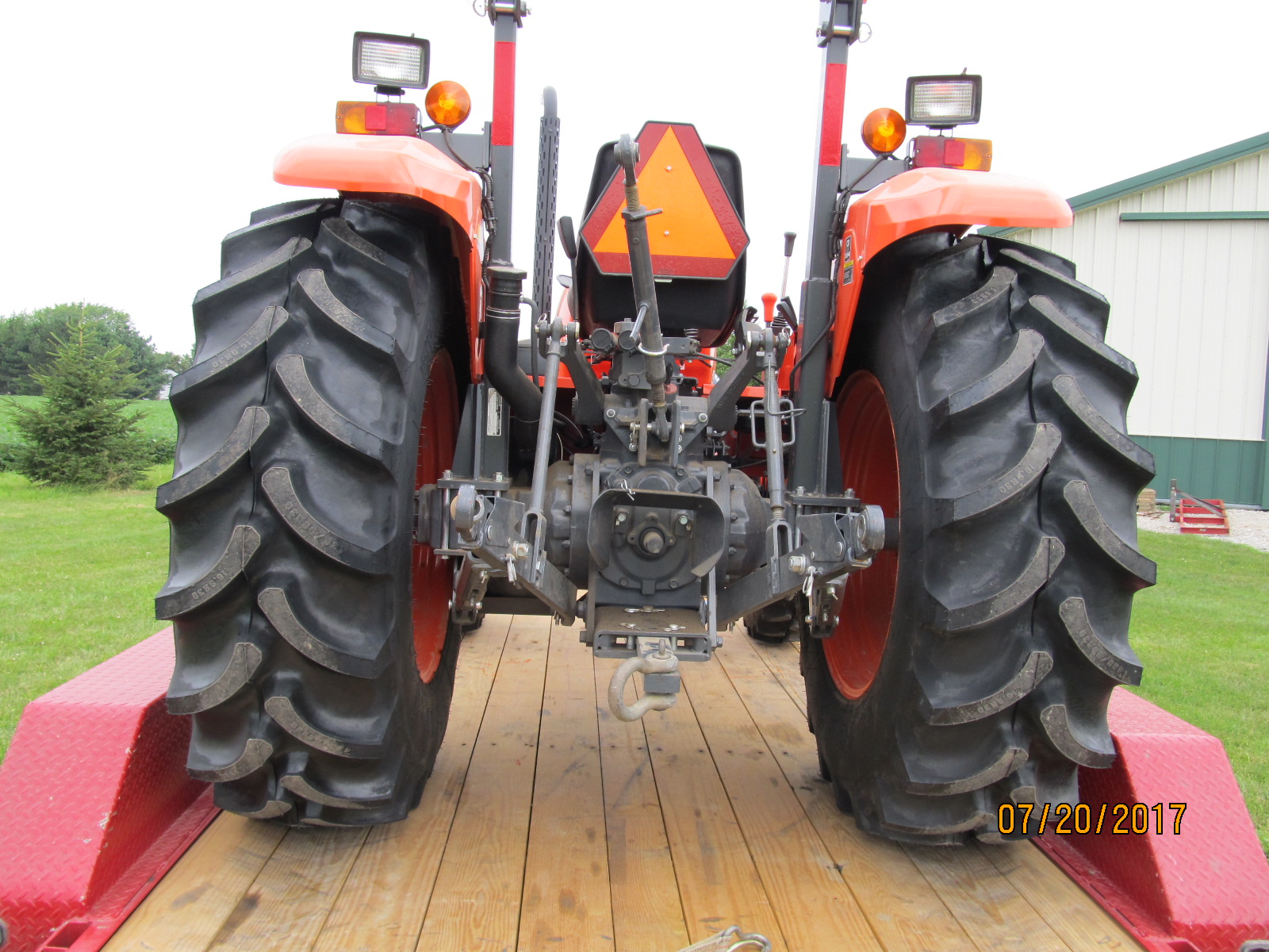

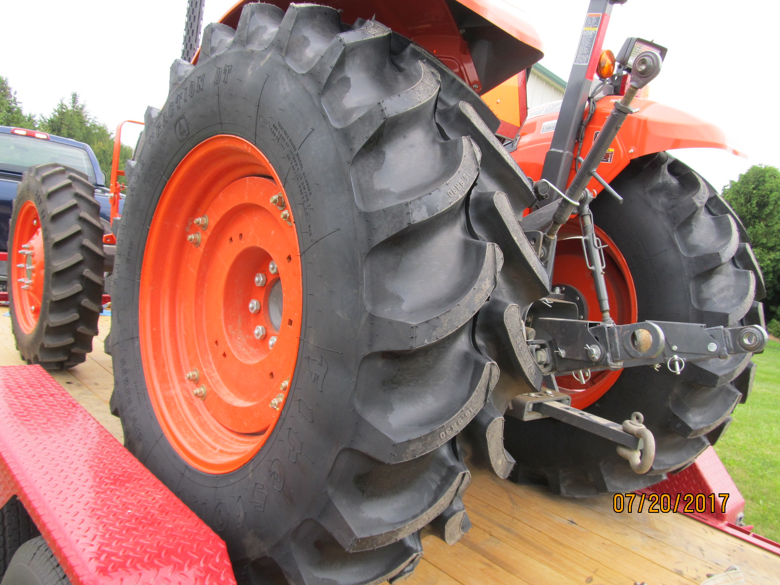

Here on some pics of new radials on the rear of my M7040. I would have bought front as well but can't get the 9.5x24 in radial. Maybe later. These are Firestone "All Traction DT" and I like that pattern better than the "Performer 85" radial series that has a slightly shallower tread and different shaped bars. There is so much rubber they almost look like an agricultural R-4 tire.
Radials work for me because I have to trailer things with limited weight totals yet sometimes need to pull an 8 ft chisel plow. With a bigger tractor, the weight is too much for the truck. With the lighter weight M7040, radials give me a dramatic increase in pulling power. In addition, I often drive over septic systems or lawns and the radial @6 psi barely leaves a mark. Radials are just perfect for this, or really any agricultural work.
Out with the old Firestone SAT 23
In with the new.

They look over aired. Should be some squat to those radials. You will love the radial.

Those look so much better than the originals! Let us know how you like them.

They sure are over-inflated. I do that for a few days to make sure they seat. I've had them leak at the bead when new. They will go to 6 PSI but have 20 psi in now.
Michelin makes a great car/truck tire and a great ag tire as well. I just like Firestone ag tires and I think Michelin owns Firestone anyway.
I have a set of four of these All Traction DT Firestone radials on a 90 HP Deere and they are impressive and then some. I can seriously out pull a similar tractor with bias tires and the difference is like a 1960's car tire and a modern Michelin radial. Plus in clay ground compaction is way reduced. You are right and they sure do look better.

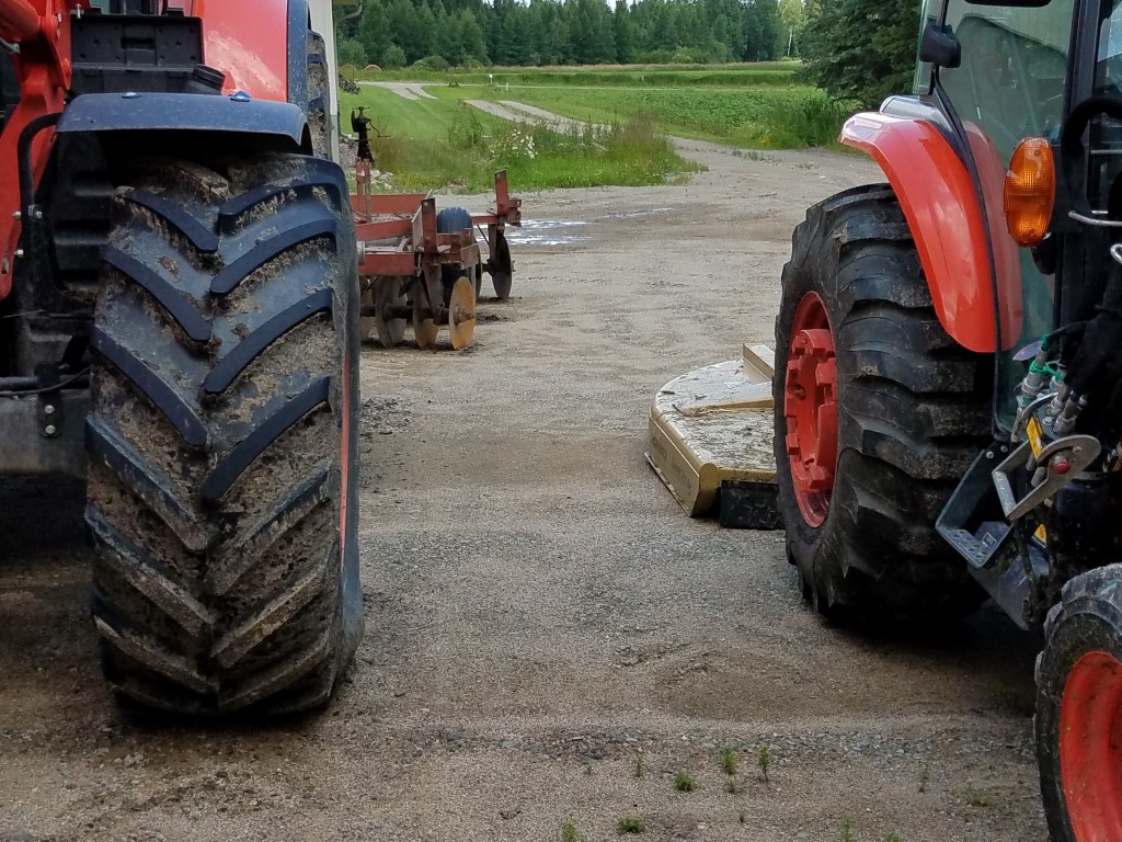

My L6060 happened to be parked next to my M7, steering tire (540/65R28 Michelin R1-W) alongside the driver (17.5 x 24) on the L6060. There is room to put that large tire on the L6060 but no room for a larger front tire on the CUT to match speed ratios. The R1W tires have a 35% taller lug than a standard R1 ag tire. They also rip up the ground a lot worse than R4s and standard R1s when turning but the traction is great.

I'll bet you have a dramatic increase in pulling power with those Michelins on that tractor.

It's fantastic. That little 14' disk behind it isn't normal. My nephew is trying to sell it, wanted the rust worn off the blades, but it started raining while I was disking a week ago. It has rained every day since so it's rusted up again.
