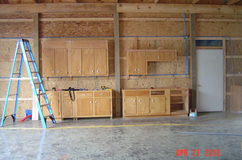

   / New Garage Pole Barn 40 x 64 x 12
#135
Framing done over the weekend. $35.00 per hour - carpenter and an assistant.
I had them frame out the inside for 16" centers. Ceilings are 12' and I am keeping them high since the rooms are not that big. 2 16 x 10 BR, 1 16 x 20 Kitchen/Den and the Bathroom is 8 x 14.
Pipes/Vent Stacks did fall in the walls so that was a nice moment.
