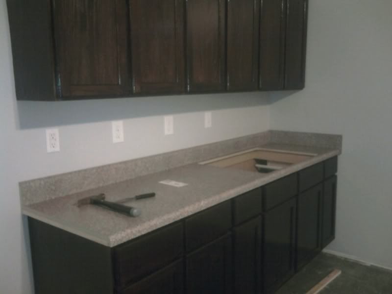

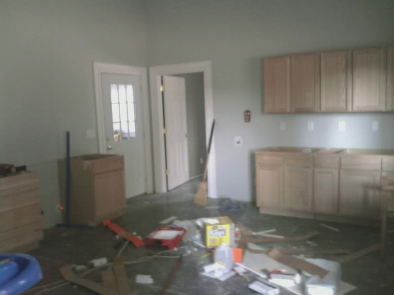

Kitchen Cabinets installed.

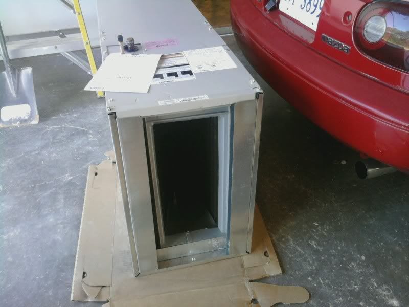

I picked up my 2 Ton Air Handler and outside unit. Gibson Brand. 16 Seer so I will get back $1500 off the installation or 30% of the total cost on my 2010 tax return. The unit was about $1600.00 out the door. I am going to change the duct lines changed from flex to hard HDG ducts with the flex duct only covering about 4 - 5 feet. This is going to heat and cool about 780 square feet but I have 12' ceilings so it is properly sized.
The unit inside only weighs about 80 pounds so it will not be an issue mounted up high as planned.

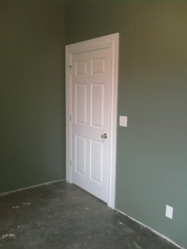

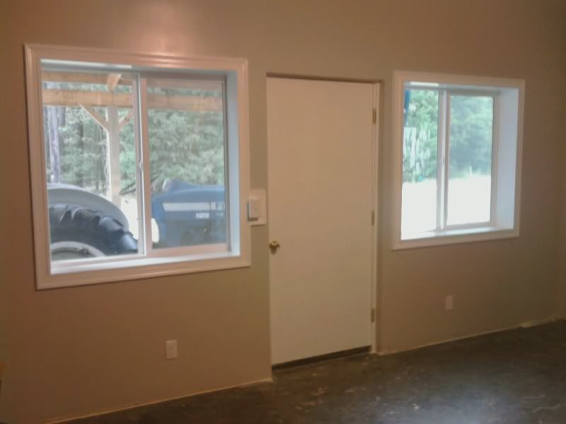

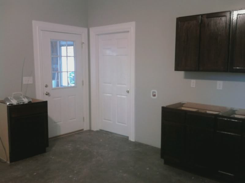

Paint is complete. All doors and windows are finished. Baseboard will be installed after the carpet and vinyl goes in next week. Kitchen Cabinets are stained and clear coated.
Nice to have that behind me. My dad came into town and finished putting the second coat on everything. He is a painting machine.
With 6"-9" walls, triming out the windows was not an easy job. Not quite the way a trim carpenter would do it, but they worked out as best as I could expect. The window sills give a nice shelf in the rooms. Each room has outlets about every 4-6'. At least 3-4 outlets on each wall. Cheap to install and I will never not have enough places to plug in.

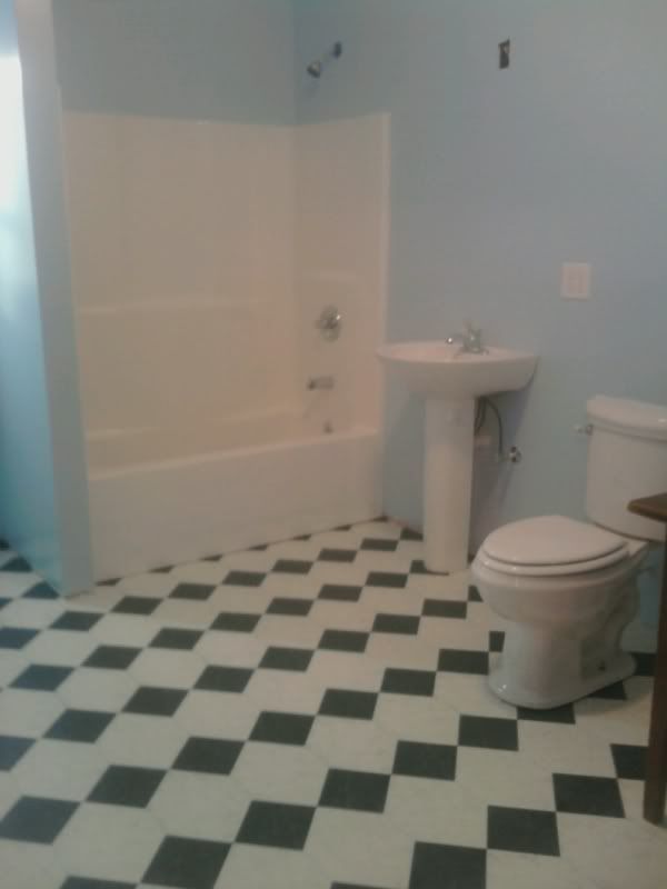

Carpet and Bathroom flooring going in on Friday.
I have a really nice Kohler Cast Iron sink my wife has been saving for her own Kitchen makeover. It has been sitting for over a year so I felt it is fair game.

The last of the flooring is installed.
Floor is Dark Blue and White.
I am going to do the baseboards over the winter months. The carpet came out
pretty nice, I will try to find some shots.
