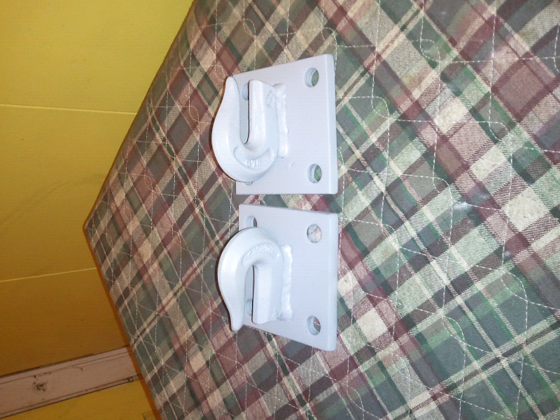

Thank you. As far as bucket hooks, on my B3030 HSTCC I frenched in a 2" receiver tube flush with the top middle of the bucket where I was able to pin in a hook, trailer hitch, winch etc. I'll probably do the same to the L5740. It is very handy. It is hard to take a plasma cutter and welder to the nice new orange paint, but it always turns out well with some new paint.
Heres a bucket hook suggestion, just made them up and installed the other day. Simple easy and didnt have to weld on the bucket. Just drill few holes and bolt on.
I like the looks of those. Nice work! I think I'll use your design when I get the time to make some for mine. It is probably actually stronger being welded to the plate and bolted on, especially if you use grade 8 hardware. Is that 3/8" plate?
