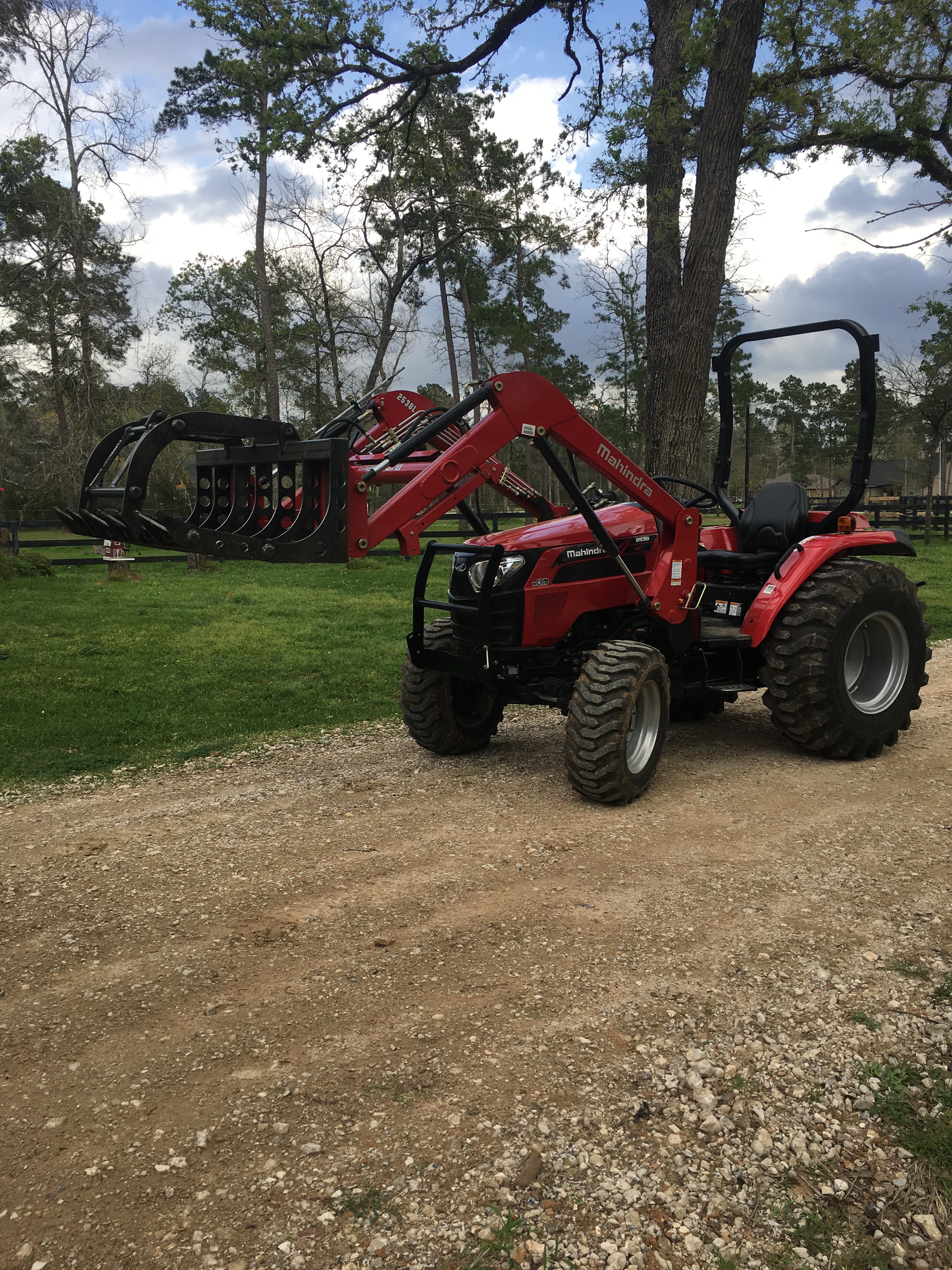

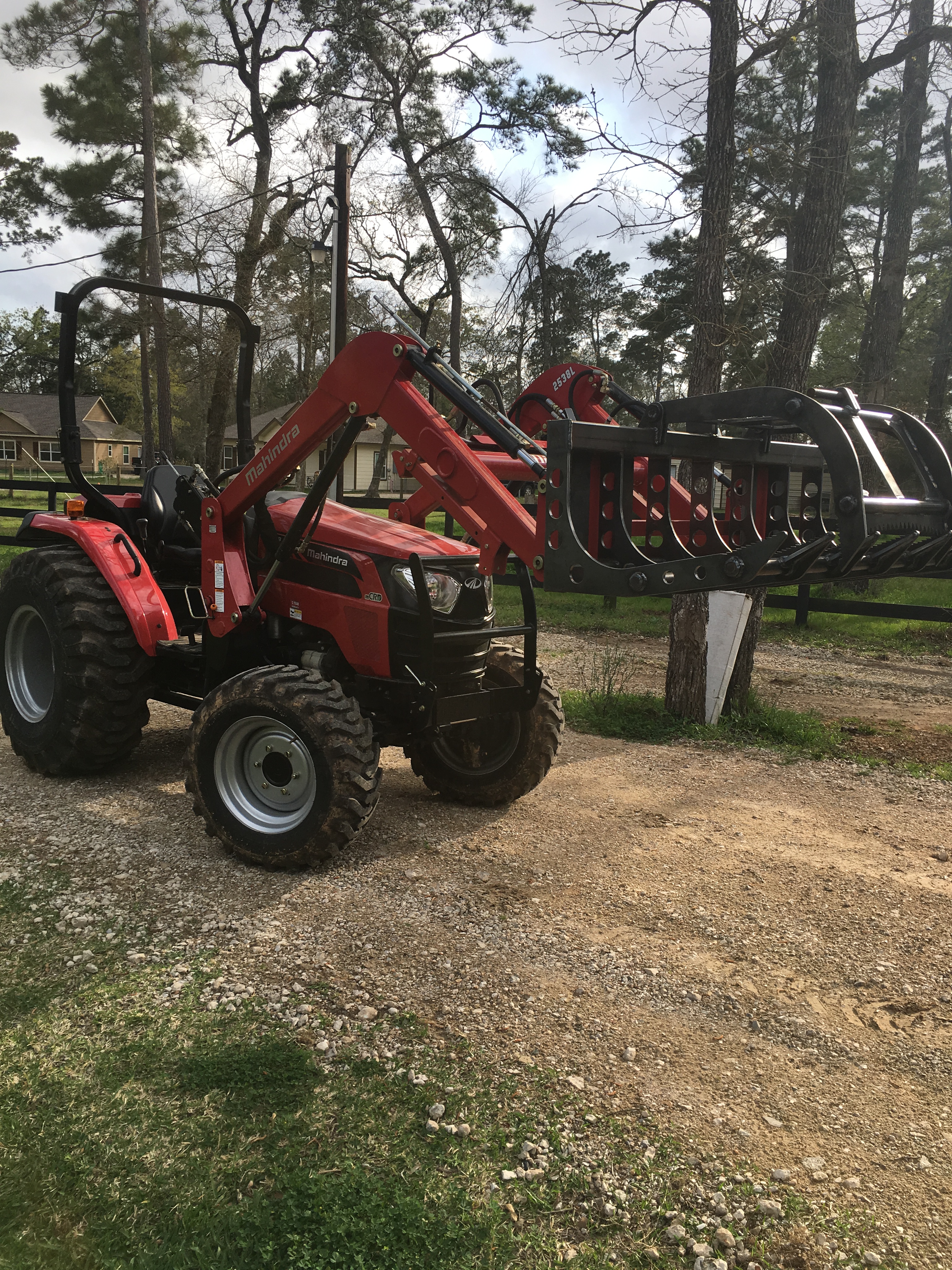

Well, Almost done!
Got my grapple dry fit for extra assurance. Now it's off to paint and then patiently ( :( )waiting for hydraulics and 3rd function kit.

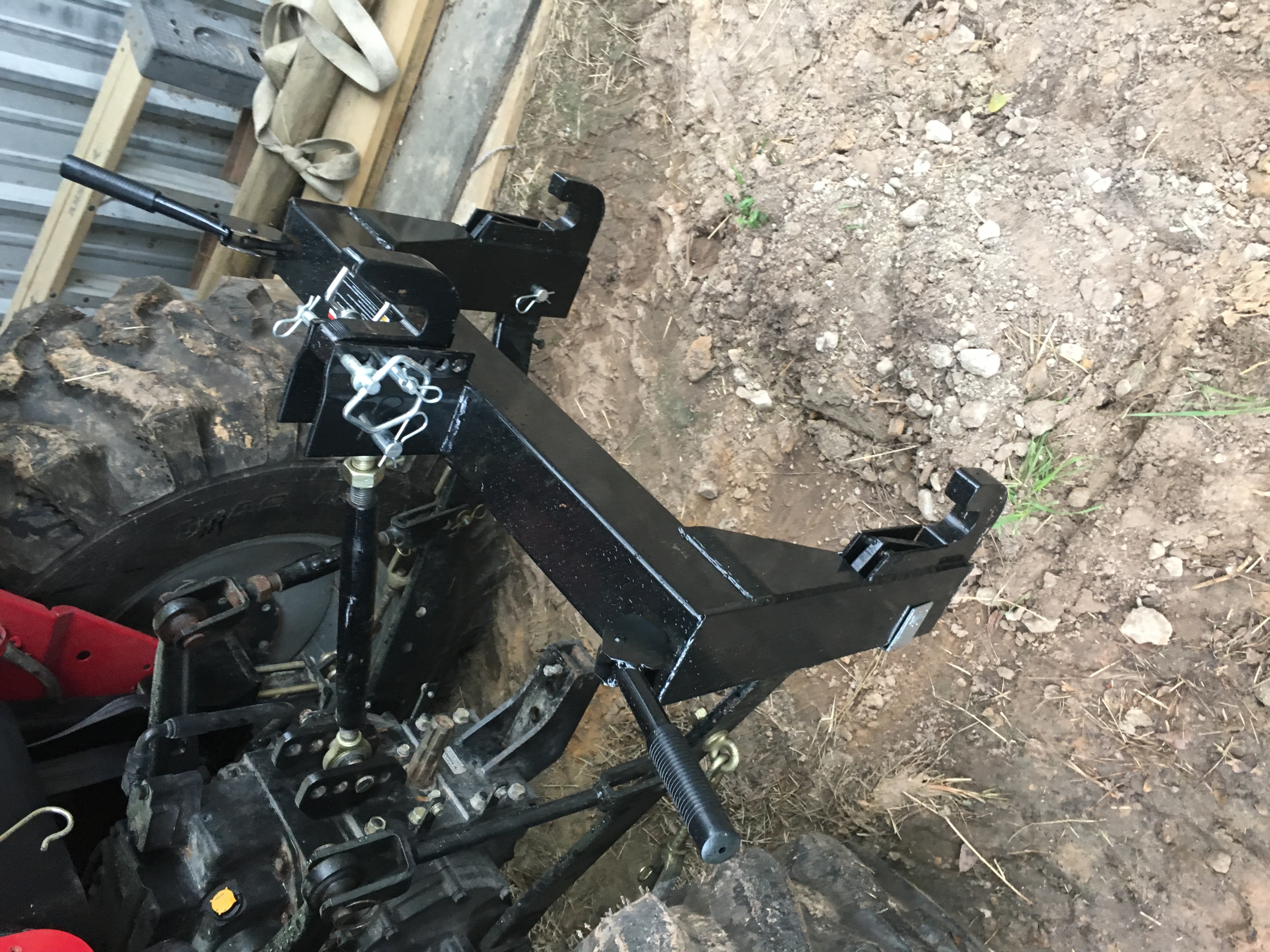

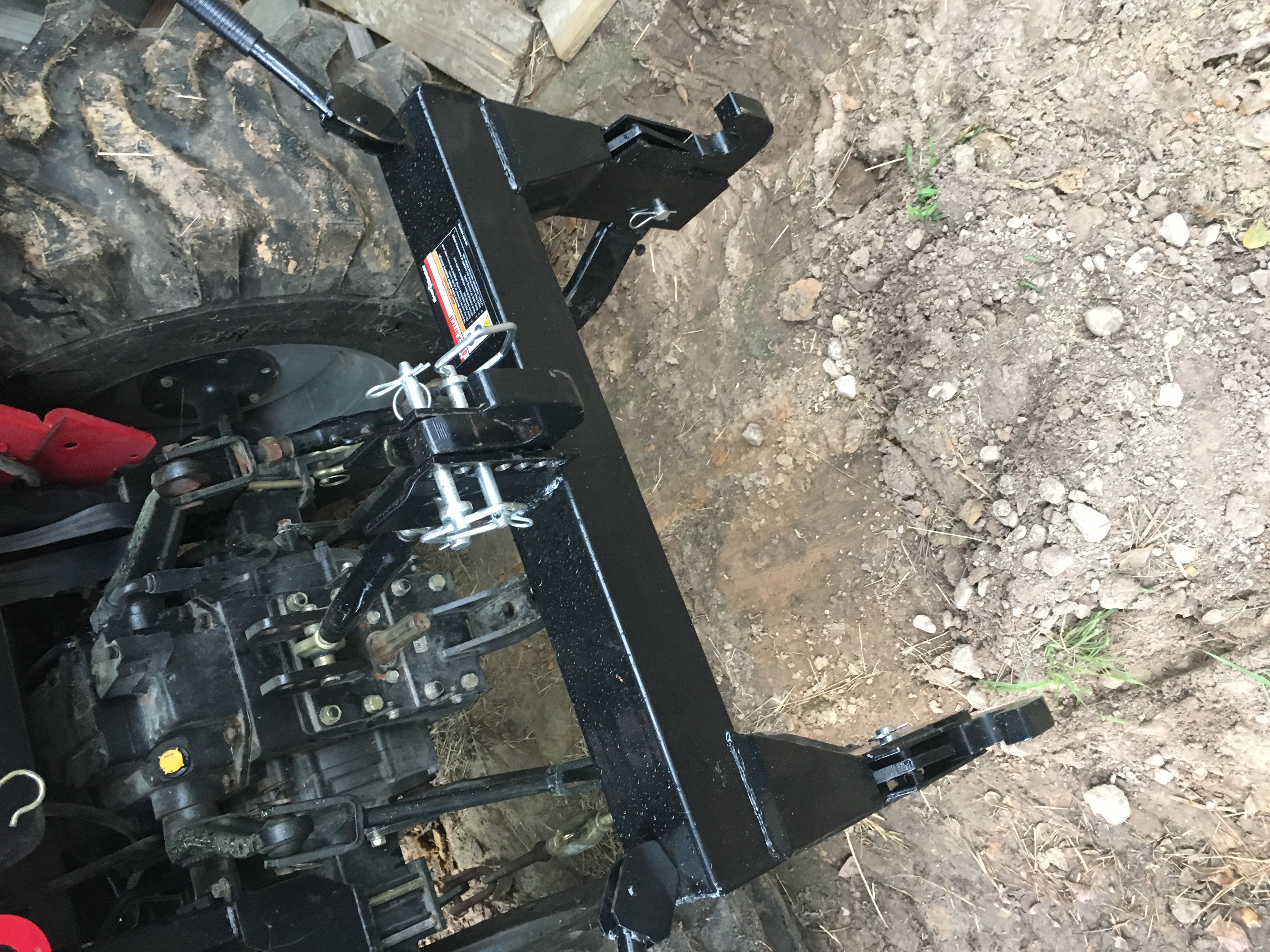

Also got my Quick Attach on and my two most used implements set up for it, my box blade and my rotary cutter; I still need to set up my landscape rake, trencher, fertilize spreader and my 55 year old disc.

Say - what type of quick hitch is that and how far back do the rear hooks extend beyond the tip of three point arms? (From back of arm to back of hook on hitch?) I'm limited for space in my current shed and that might push me just beyond available length. Thanks.

Snowback,
I measured it when I got it install, it added just under 4" center to center of three point holes to QA center of hooks.
I will measure today when I get off work to see how much total real estate it adds from the original end of three point to the farthest point on QA and let you know.

Snowback,
I measured it and from the center of the pin hole on the 3ph it is 6 1/2" overall to the back far edge of the hitch.
I got the hitch by the way at Harbor Freight - if you want one they have two more at the Jersey Village location.
The manager told me they are discontinuing them so if you want one of theirs you might want to jump on it.
$86 and some change with the 20% coupon which i got on there site with my phone right in the check-out line.
The only thing I see different from the others I have looked at is the tabs that hold the implement in the lower hooks is a bit thinner but looks substantial enough at 3/8" thick, at least for our tractors.
Hope it fits the shed because I really like the idea of not getting off the tractor to hook up - at least not until I have to hook up the PTO on something.
