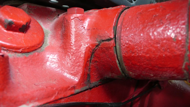

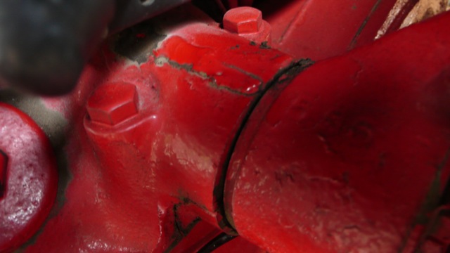

Well, the PTO cover went on without a hitch---easy. But while working there I noticed the lift cover had a crack. Want to get your opinion soundguy---it lifts only at last half of quadrant and leaks down fairly quick under heavy load, so I know I'm going to have to work on it at some point. Do you think the cover is weldable? It looks like there's two cracks---one that was welded on top (and may have recracked under the weld), and one on the side that looks newer. I don't know what kind of work that area gets. Maybe a replacement cover is necessary?

the leaking down under load is usually a lift piston oring. might need to hone the cyl as well. lift cover kit with gaskets and a handfull of orings is about 15$.. has all the orings for under the cy; and option cover.. etc.. only lifiting at the end of travel is usually indicative of a worn cam follower pin and / or worn cam and linkage out of adjustment. there are alternate adjustment instructions in the service manual to adjust the lift without using the special nuday tools.
the cam pin can be pressed out at home using a socket and pin punch/drift.. and a ne wone mad of a broken drill bit stem.. or a real dowel pin.. cam usually wears in profile so you have part of a surface as a witnes to weld back up to then grind and file to correct profile.
the area of that damage is outside the hyd ports.. so it COULD be welded.. but.. it's in a spot that carries all the weight.
if I did weld it I'd do it witht he cover off and the rockshaft out. weld from outside and underside.. and inside the bore.. then hone out. would have to vcut the cracks and clean oil out of them with a torch.. would have to pretty much pull all the hyds components. might be easier to find a good lift cover.. though it is for sure weldable with a lil technique and patience. I've seen a factory weld patch on an 8n lift cover that came out of ford factory.. so i know it can be done...
i know a guy that sells surplus parts.. he has a cover for 80$ plus shipping. might be easier to go that route.
fair guy to deal with. I've bought tons of parts from him over the years. all good results.
best of luck either way.. you got options..

Thanks for the link. I think that's the way to go. I'll let him know you sent me...
