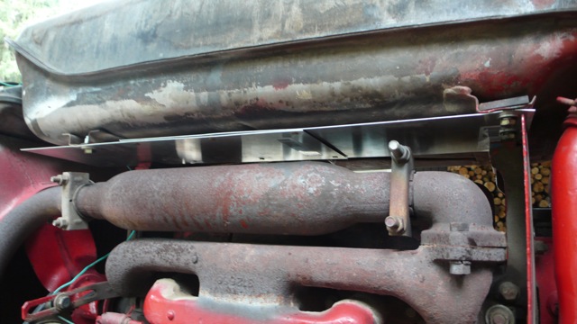

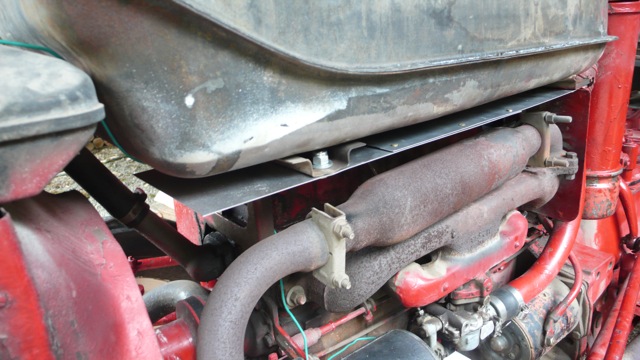

Found some marks on the flywheel, but nothing like the manual. Looking back through the hole---top to bottom S (in a circle)-4-X-3-1. My guess was the S was TDC, and the X was were I set it at idle. Runs much better with new points and rotor too. Pretty much humming now, starts easier too. Need a heat shield. Thanks again soundguy!
Made this shield today---2 pieces of riveted aluminum, nice and reflective...

   / New here w/ Ford 861 #83
yep.. diffinately needed the heat shield...

Wasn't a lack of heat shield causing the surging. Just went to mow and after about an hour it started again---idled it down and let it rest, checked the tank and gas---cool, no boil. Seemed to stabilize a bit, so I finished mowing at reduced power. Still rough---but finished and brought it back, and it was moving between 900 and 1500 rpm when I shut it down. I'm going to rebuild the carb and check the linkages first, then get into the governor if it doesn't improve. Anyone know where I can get a rebuild kit for a Zenith 3 99 / 13877 / B6 NN A ?
