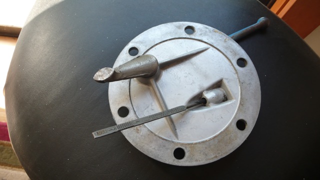

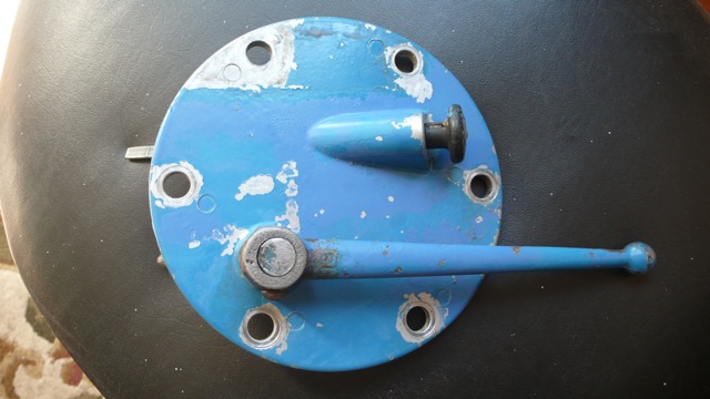

Soundguy, will this early 2000 PTO cover match up to my 57 860 PTO cover? The one on the tractor has a messed up (loose) lever and I want to sap these out if possible. Outside looks the same, but I haven't taken off the cover to check if the inside is the same and thought you might know. Don't know exact year of the 2000---just said it's "early".
