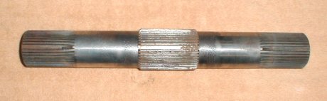

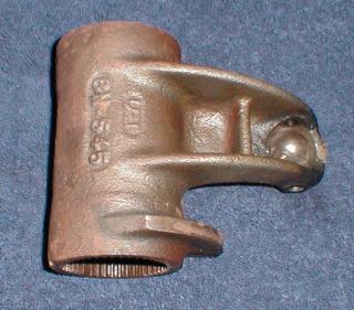

I think a good salvage cover is the real good fix for your issue. in a pinch if parts or $ were tight you could weld.. but a swap is better.
plus.. you may get lucky and the cam may not be badly worn. if it is.. you can weld it up BEFORE you assemble the cover with all your good parts.. plus.. since your cover is damaged.. you have less to worry about when taking the rockshaft and arms off as some people have busted them taking them off.. no pressure here though as yours is ALREADY busted... so almost a win win...
best of luck.. you got some wrench turning ahead of you... ( but nothing difficult... the hyds on the 55-64 machines are pretty straightforward.. just a bit tedious...

the long rockshaft goes thru a rocker that has the cam on it.. I don't know if the cover you are buying has the rockshaft in it or not.. so you may be stuk with your old cam.
there aren't pics of the over for sale.
you can email JS and he'll let you know though.
the pin is in the linkage.. all covered in the service manual..

ok.. further looking.. looks like you will just get the blank cover.
here is the rockshaft I speak oc. the outer splines are for the lift arms.. the middle spline is for the lift ram arm that has the 'cam' surface on it that the follower pin rides.
here a pic of both. notice the raised ridge on the ram arm
