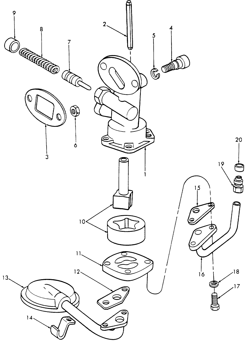

Going to pull the pan due to a leaky gasket. Any chance of checking that relief valve while the pan is off? First thing I did when the pressure spiked was to put the old filter back on---no difference, so I don't think it was the filter coming apart. New gauge is in the mail, with a drain pan plug and the screen which was missing.

parts list and pic for the gear pump commonly used up till 1960 or so:
1 NLS No Longer Serviced Pump Assy., L/Screw & Cover, Replaced by P/N D1NL6600A Rotor Type Pump, Refer to Engine 6C2, When replacing Gear Type Pump W/D1NL6600A, you must also replace P/N EAF6615A with D1NL6622A, EAA6626C with C0AE662

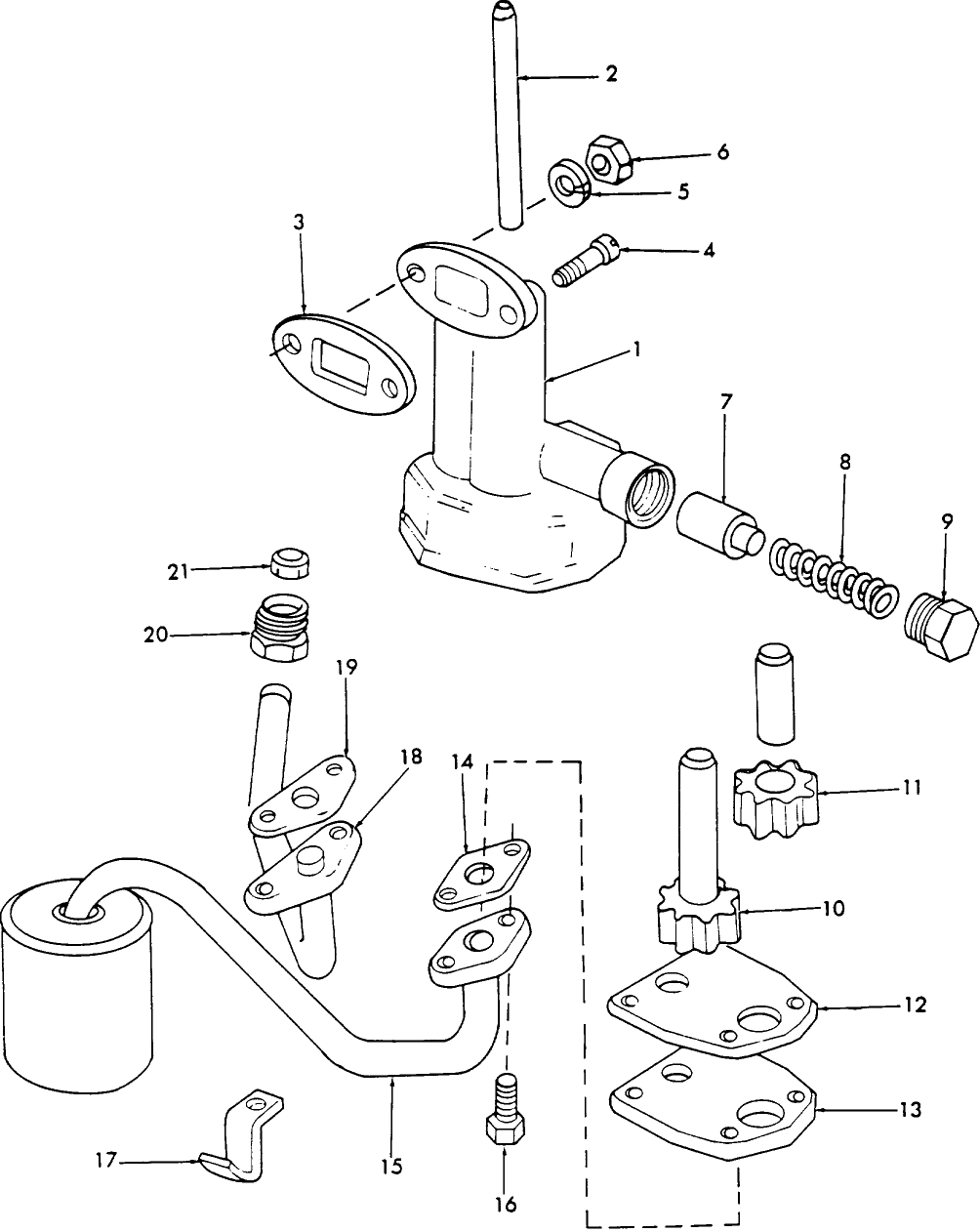

parts list and diagram for rotor style oil pump used till 64.. also called a g-rotor:
AR D1NL6600A HYDRAULIC PUMP Pump Assy., Oil, L/Screen & Cover, This part is a direct replacement for C3NN6621B, When Replacing C3NN6621A, Also Use (1) D1NL6622A Cover & Inlet Tube and (1) B9NN6730A Plug, When replacing Gear Type Pump W/

once you have the pan off.. you can work it.
here's a tip.. the front 2 bolts on the pan are a PITA!! but can be loosened enough with a tool that you can finger them out... same going back in..
and as you likely already know.. overtightening the pan bolts just leads to a warped pan sealing flange, and extruded and riply gasket, and a bunch of oil leaks. it should be a pretty beefy cork gasket they send.. razor blade top and bottom well and use solvent of choice to clean.. I prever brake cleaner.. I also like applying a smear of permatex to the gasket... not a bead.. but a smear... helps glue it in place.. keep it from sliding all around...
   / New here w/ Ford 861
#36
Thanks! Got the pan off---looks like it's the first pump assembly you posted---the earlier one. Started pulling it apart, but I don't know what to look for. It looks reasonably sound. Got the valve spring out and noticed some slight wear on the side of the spring. Filter inlet tube looks like it was pinched at some point and bent back. That's as far as I got. Moving beyond my pay-grade. Do yoe think I should remove and inspect the pump as per the book, which calls for a spring tension measure which I'm not set-up for. It seems like most problems come from low pressure, not high.
