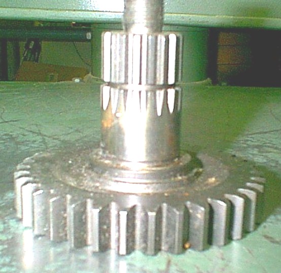

Here is a picture that shows the groove cut in the vertical pinion shaft of the Fort disc mower. This precut groove allows the pinion to shear off at the groove before damage has been done inside the cutter bar. Pull out 4 bolts and 30 minutes you are back in the field. If a person wanted no down time, he could also keep a extra pod in his tractor tool box. I know of no other company that has such a fool proof and unique design. (8 ft $6495) Ken Sweet
NH, Deere, Kuhn, and probably everyone else in the industry have a similarly designed failure point.
