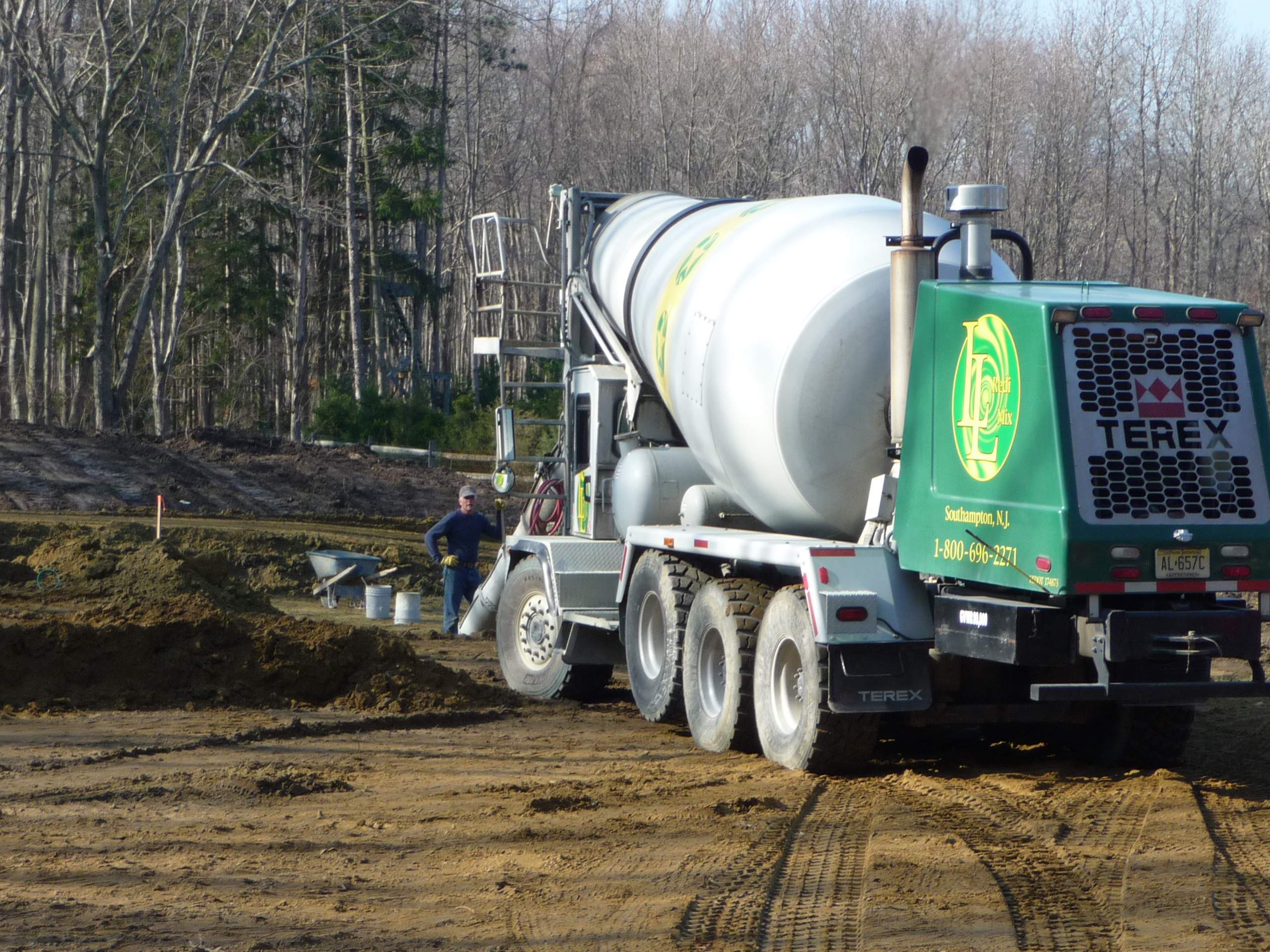

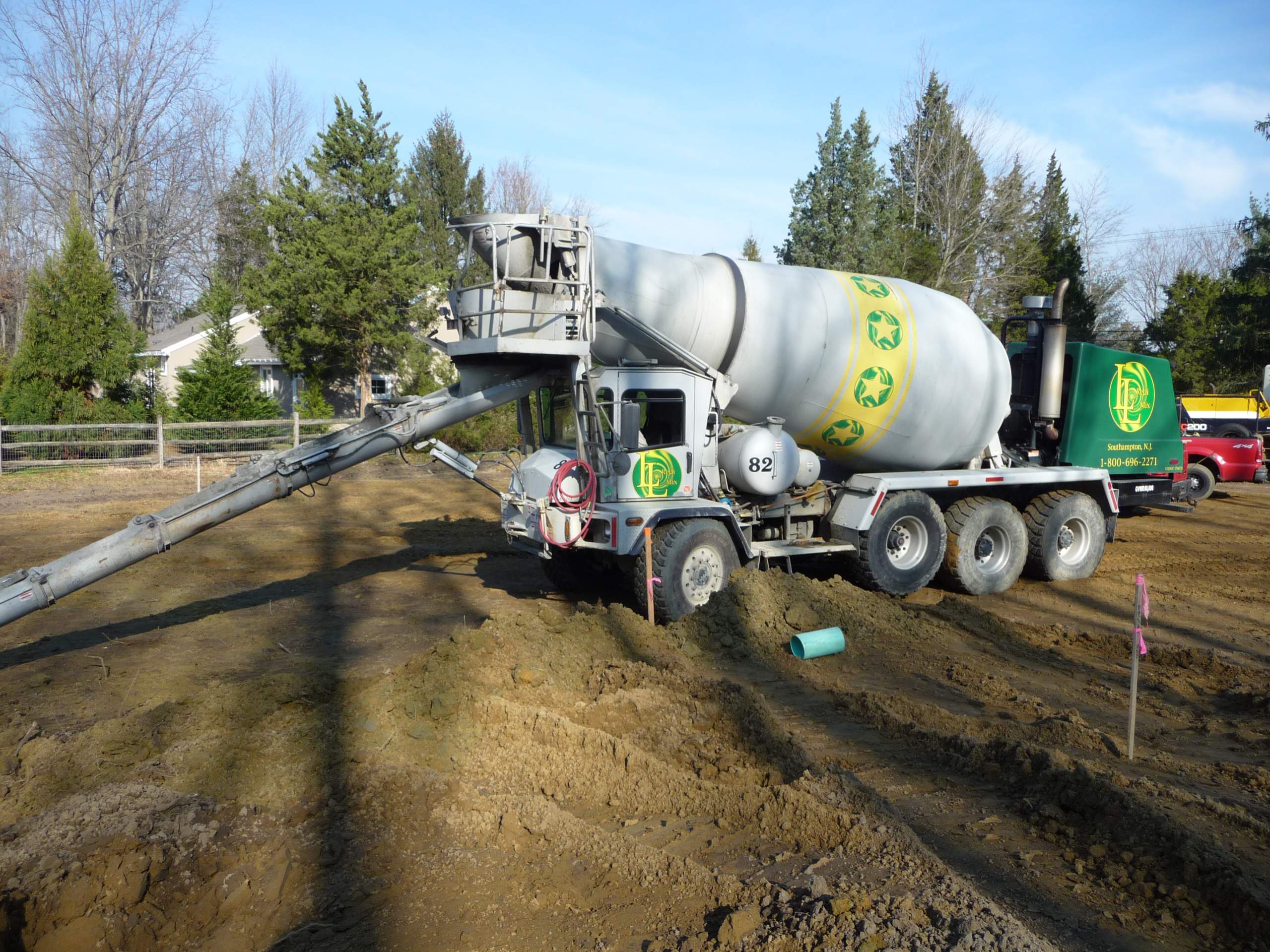

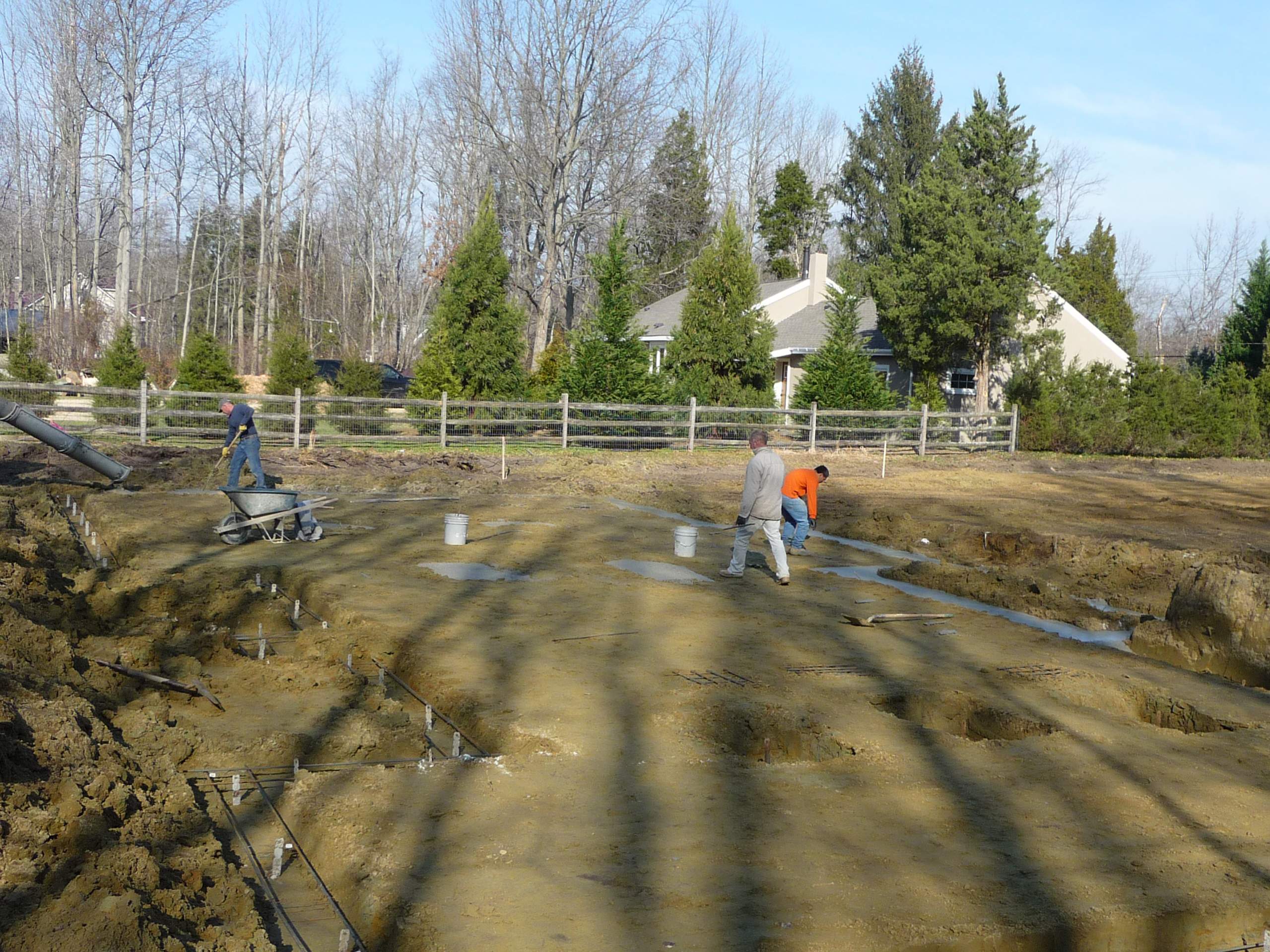

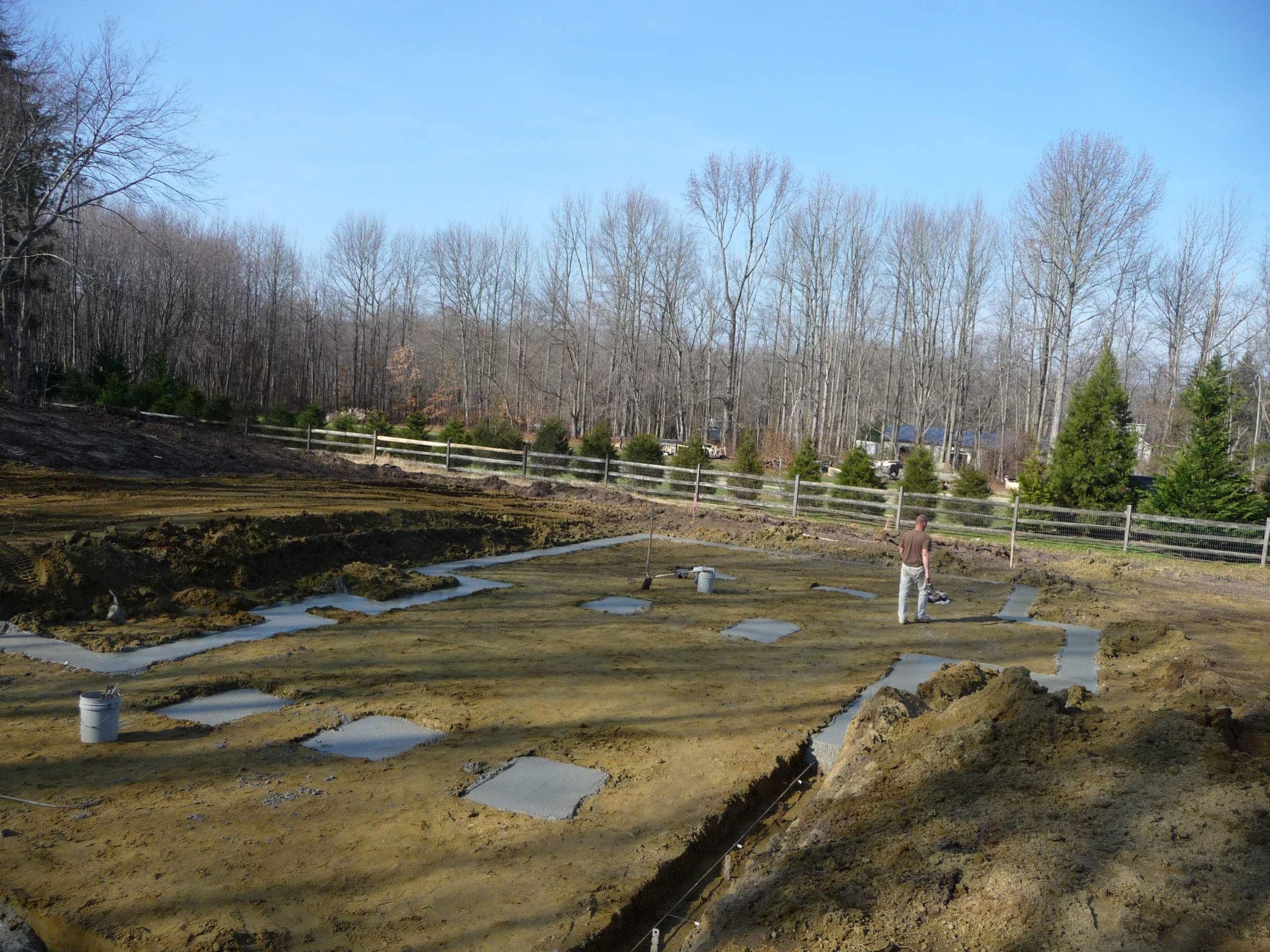

We now have footings!! Forty eight tons of 3/4" stone was brought in and the a good portion has been piled in the basement by the excavator today and will be spread around on Wednesday when the footings have cured sufficiently to drive the tractor over to spread it out. The garage portion of the house will in fact use the gravel foundation method as the architect was OK with that. That gravel will be delivered tomorrow and placed tomorrow or Wednesday.
Great weather for concrete. 60's today and no frost over the next few days.
Basement walls will be installed on Thursday.
