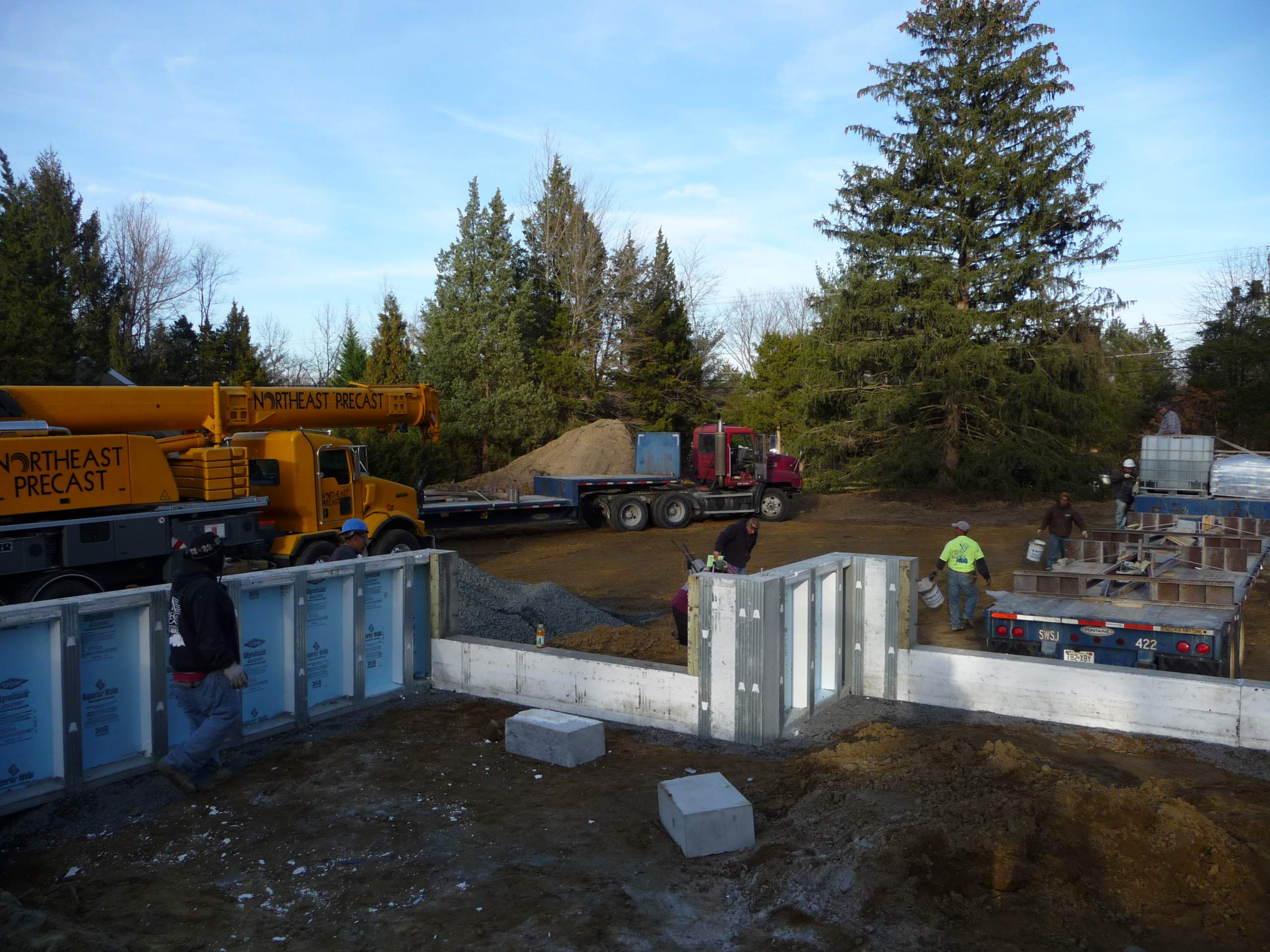

Here is a picture of the garage walls, 4' tall sitting on 10" of gravel, 8" above the current grade. There will be an additional 2'8" of fill up the 4' walls.

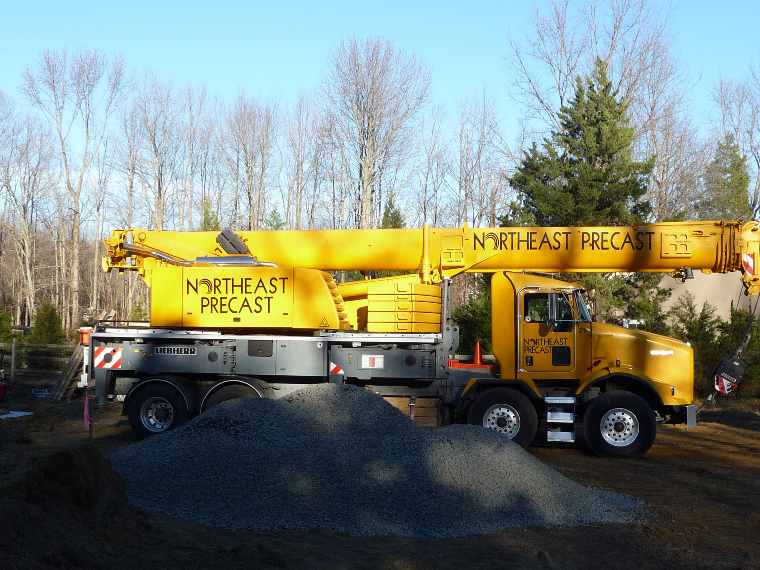

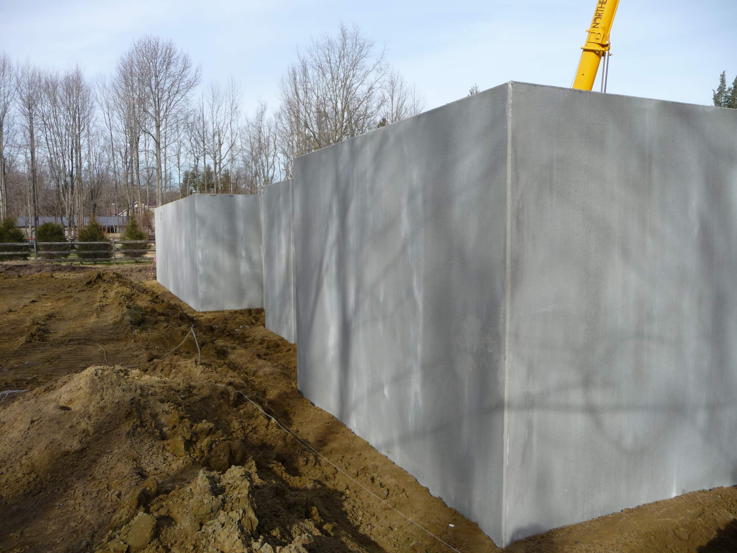

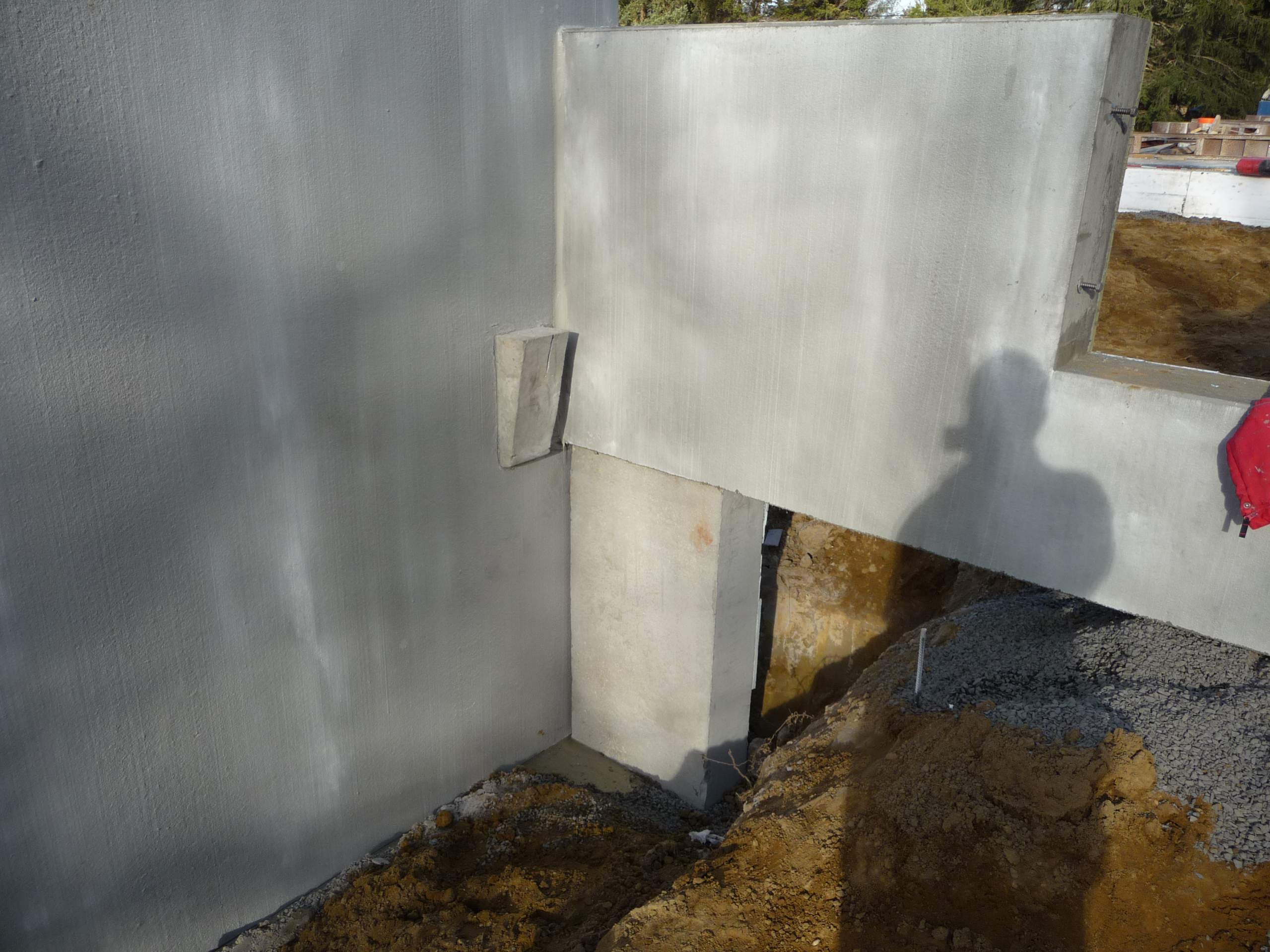

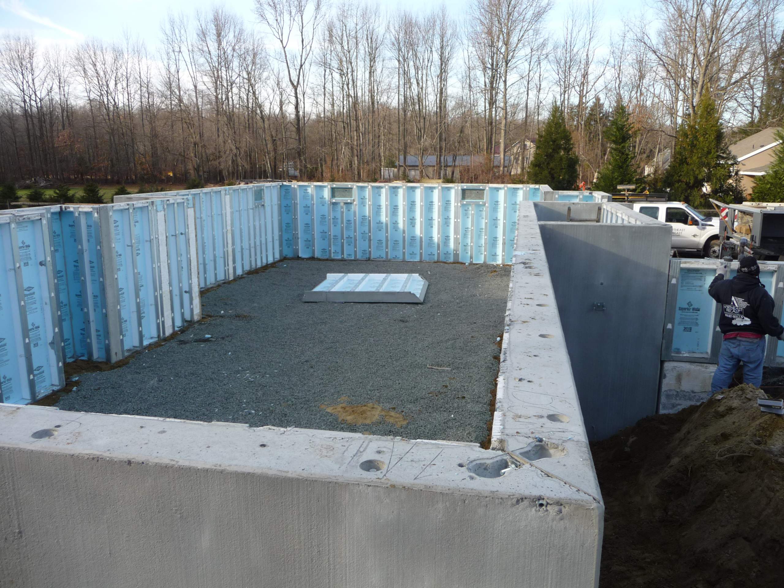

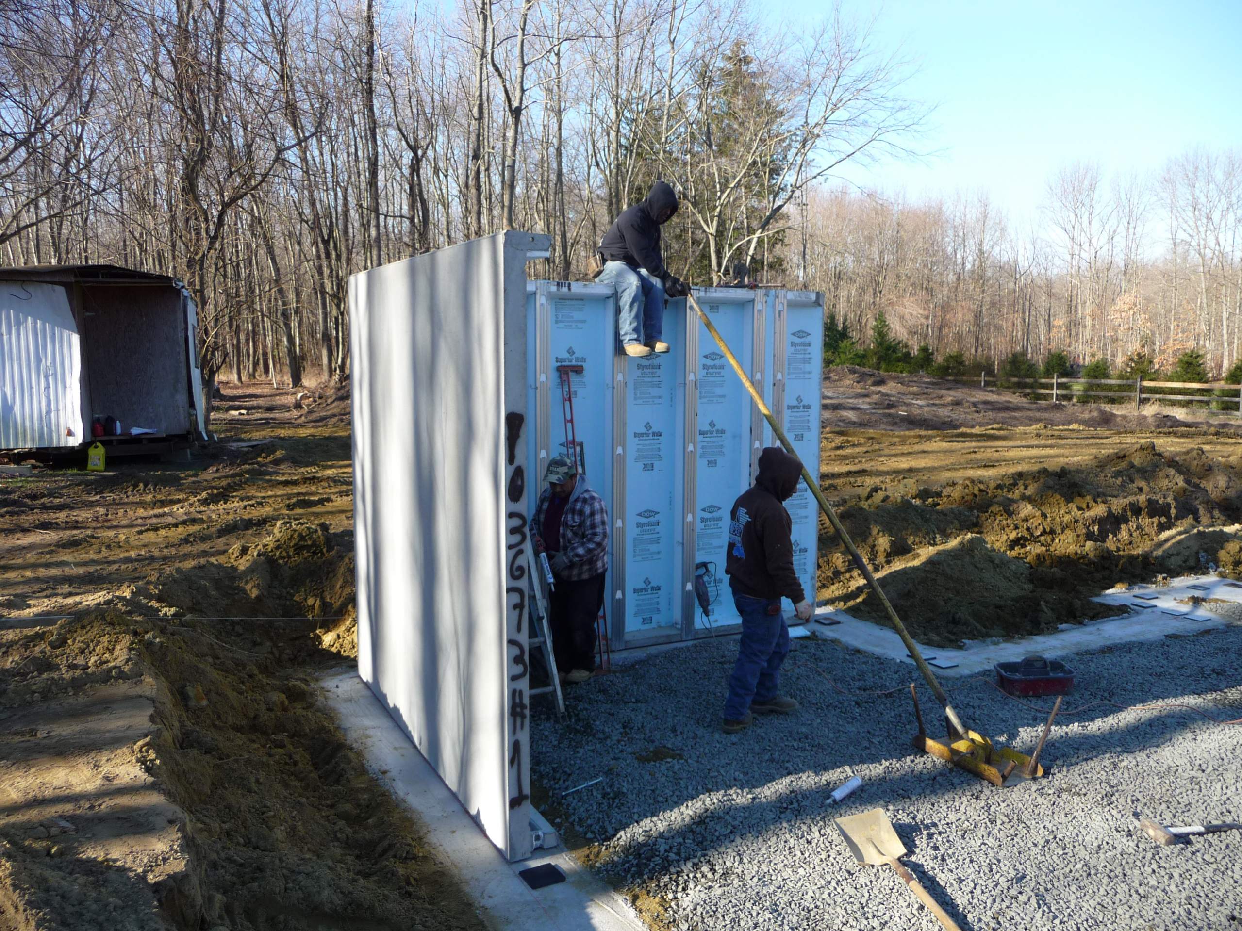

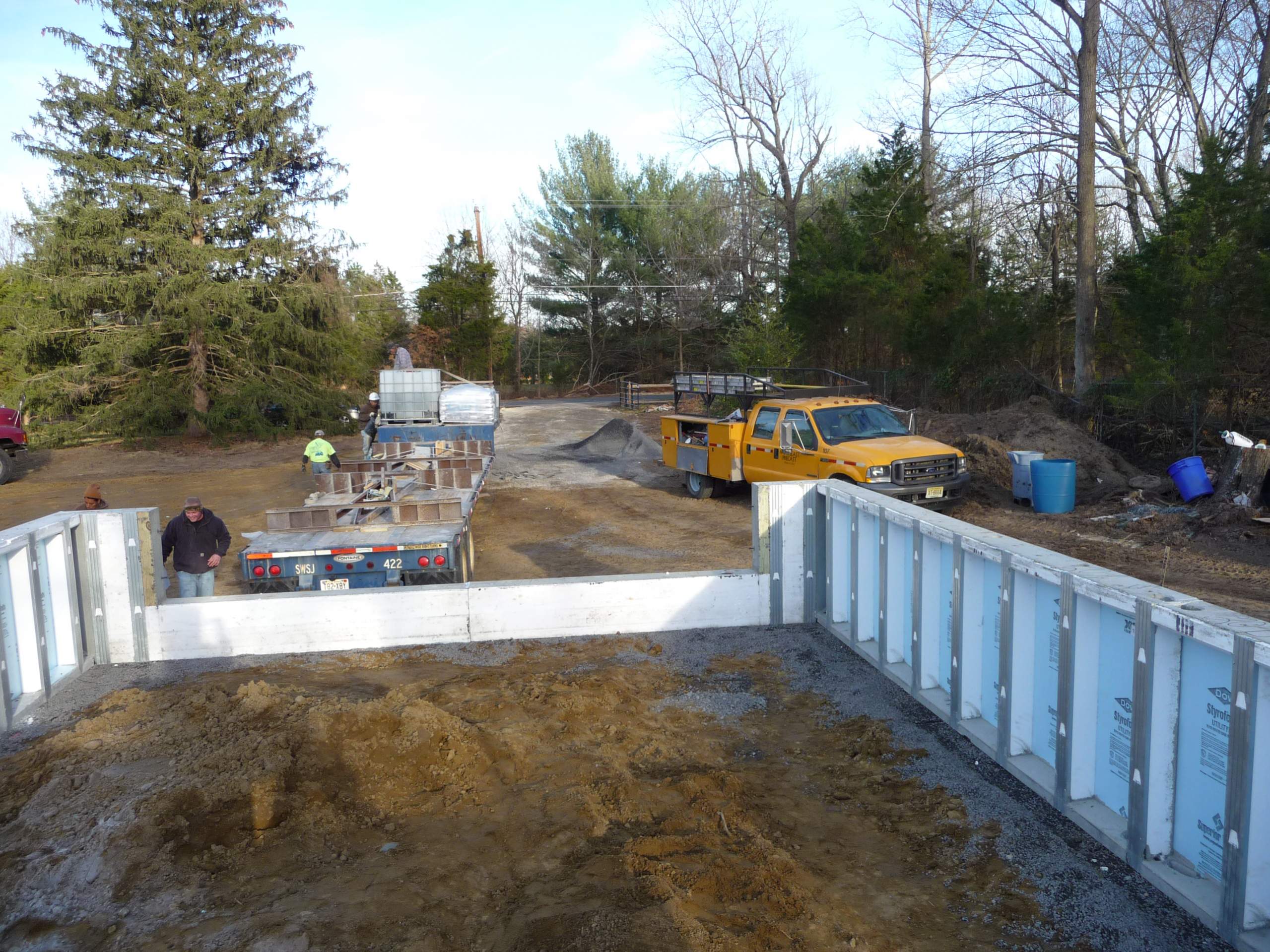

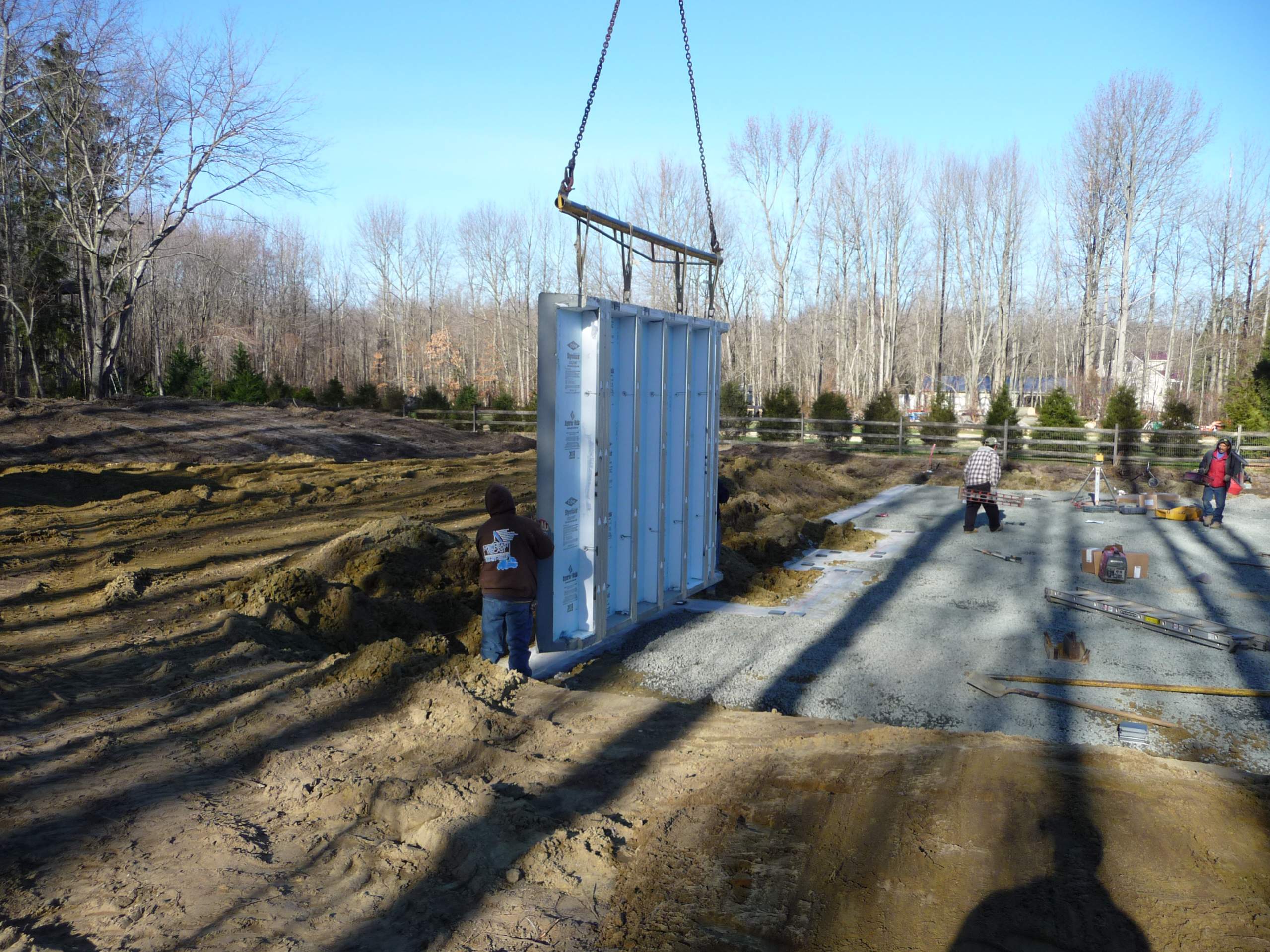

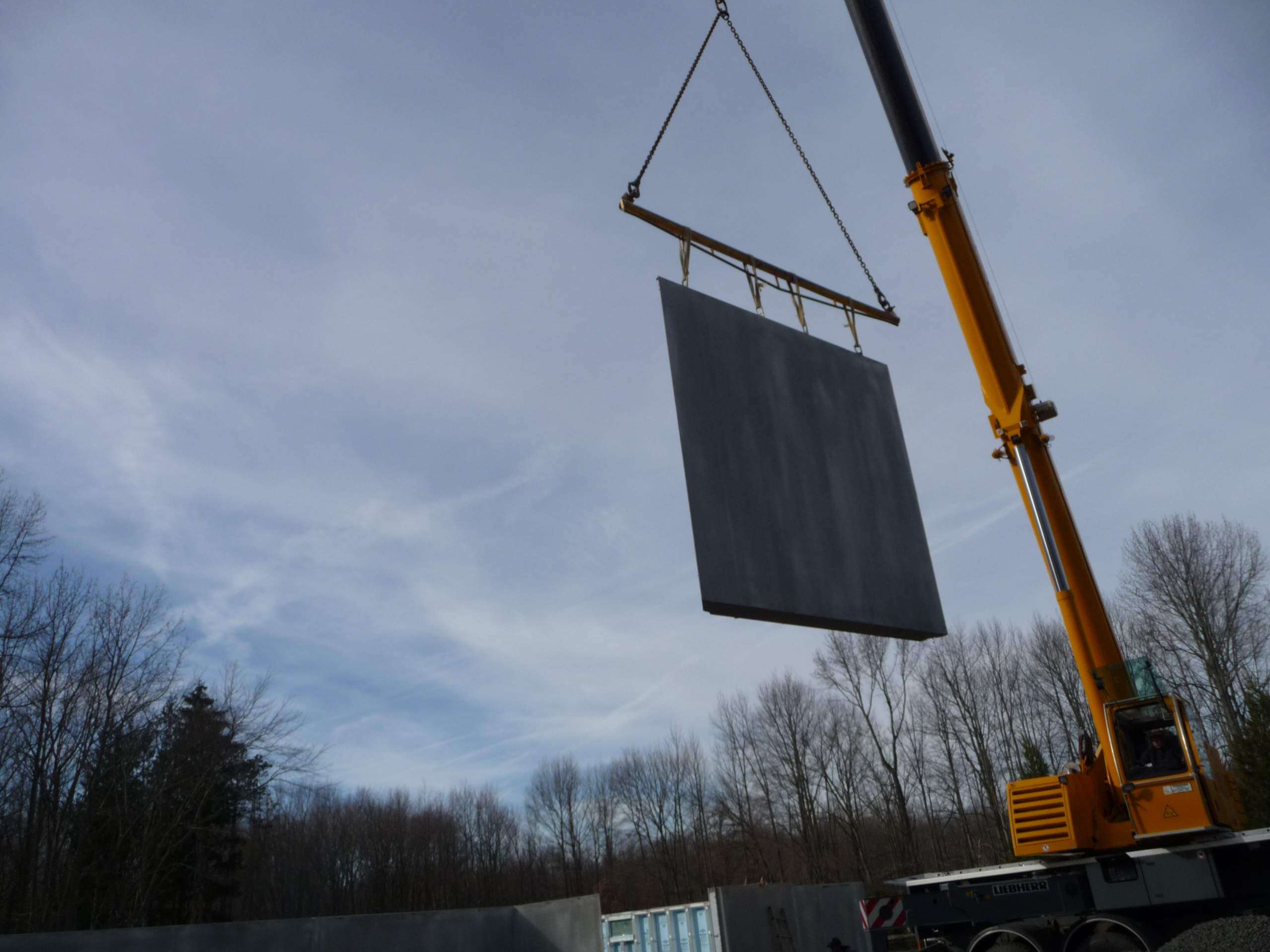

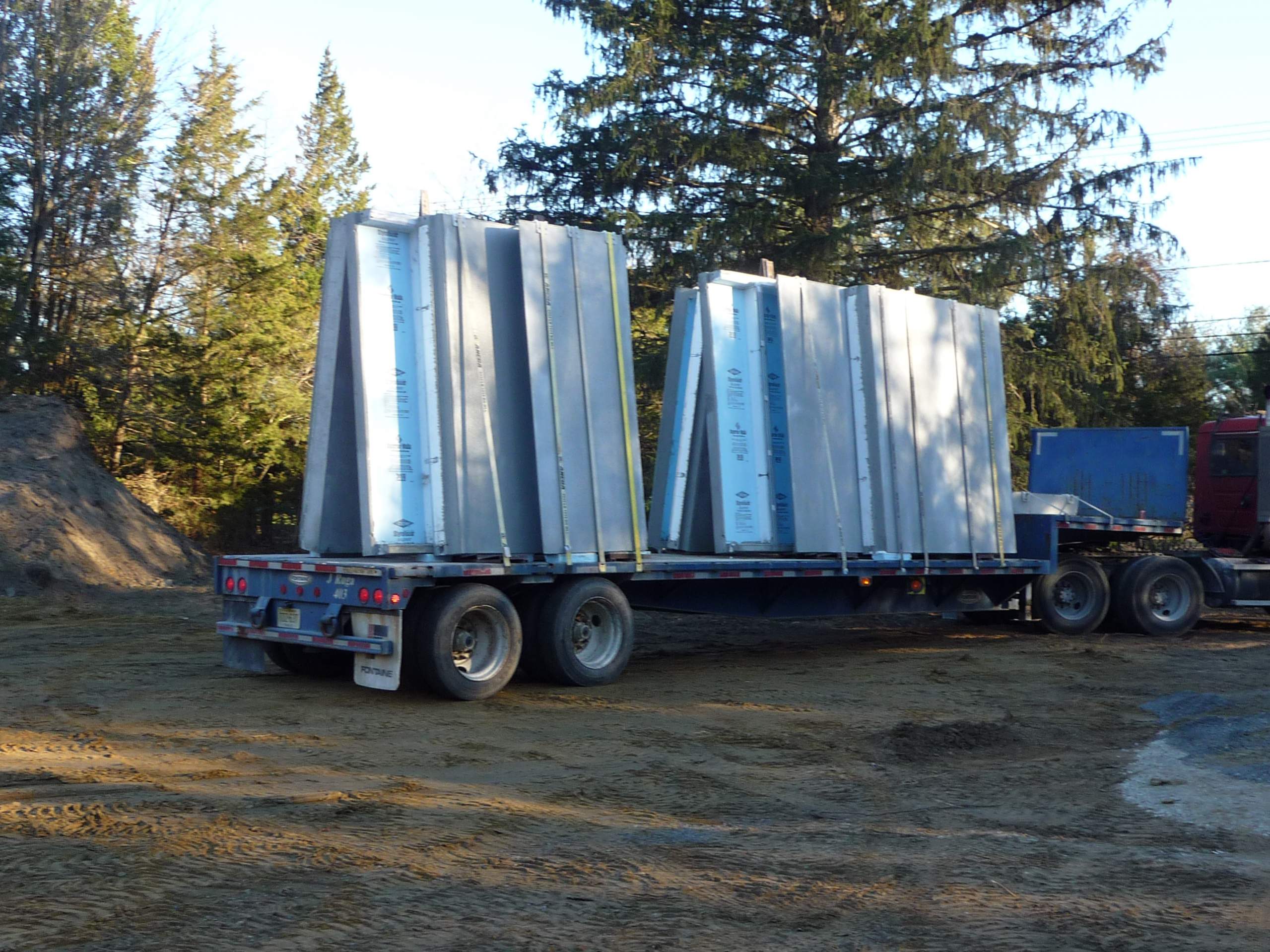

Today was the day we were looking forward to. The basement walls were set!! We were one of two jobs being done today, however; the crane's pump broke at the other job site, so that crew came here to help out. They were like a well oiled and orchestrated machine.
Three tractor trailer's worth of 9500 psi panels. There are a lot more pictures but here is a sampling!

Thanks for the pictures, but now I'm really confused. From the look of your lot, and your neighbors lot, it looks like you have a fairly flat building site. Are you building a basement above grade? Are you going to add dirt to the sides of the basement and create a hill?
WHY?
Eddie
   / New Home Begins
#165
Eddie,
Yes, the lot is relatively flat. The county has defined the seasonal high water table at a mere 41". The "rule of thumb" is to have finished basement floor 24" above seasonal high water table. As a result, we need to really build higher out of the ground. The garage was lowered to minimize the amount of fill to get into the garage. We will need to bring in a whole lot of fill. On the front, the garage openings will be about 3' higher than current grade. Raising 3' over the 137' from the street is pretty gradual.
As for the sides, we will add fill and a retaining wall(s) to step it down. I already discussed a few pages back about the water runoff containment.

I sure like the concept of dropping precast panels in place, especially since the panels are made in a factory under controlled conditions. However I have no idea how cost effective they are compared to traditional foundation construction techniques.
