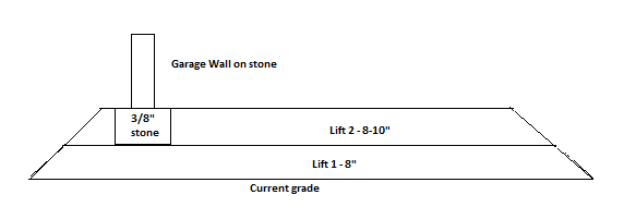

It is difficult, if not impossible, to achieve a minimum of 95% compaction with a smooth drum roller on soil in 8" lifts. If they have a sheeps foor drum that is different but an 8" lift is still difficult and usually ends up as a 12" lift. I would pay for a geotechnical firm to take some soil density tests. I know I will get the poo, poo but this is my expertise and you will experience future settlement if adequate density is not achieved. Maybe 10% of contractors actually understand what compacting soils mean because they have had to do it on Federal, State, or Local projects where it was required and tested. The rest have zero clue.
I do not know the science of smooth vs sheeps foot compaction but I have to go by the people doing the work.
Only a single 8" lift was necessary to get to the required height of the stone footing. Going higher simply allowed the excavator to dig out the trench to put the stone in. Although superior walls and the architect only required a minimum of 6" of 3/8" stone above the single 8" lift, we have a 10" stone base. The garage walls are only about 200# per linear foot and the loads on that will be pretty minimal ... walls, trusses, sheathing, shingles for the garage.
Here is a rough drawing of the garage buildup.
The excavator has been in business 30+ years and has the utmost reputation and experience.

If it was just the stone footing the roller would be fine. I thought they bagan filling and compacting the surrounding grade. A smooth drum roller on rock is the right compaction equipment. I must had read things wrong...sorry. I love the idea of precast basement walls.

You did not misunderstand. They used a flat roller for a single 8" lift for the entire garage area. This is the level that the gravel would begin. They brought in a second lift and repeated with the roller. They then dug out the trench for the gravel to go in. The depth of the trench brought it down to the height of the first lift. This was filled with gravel and re-compacted.

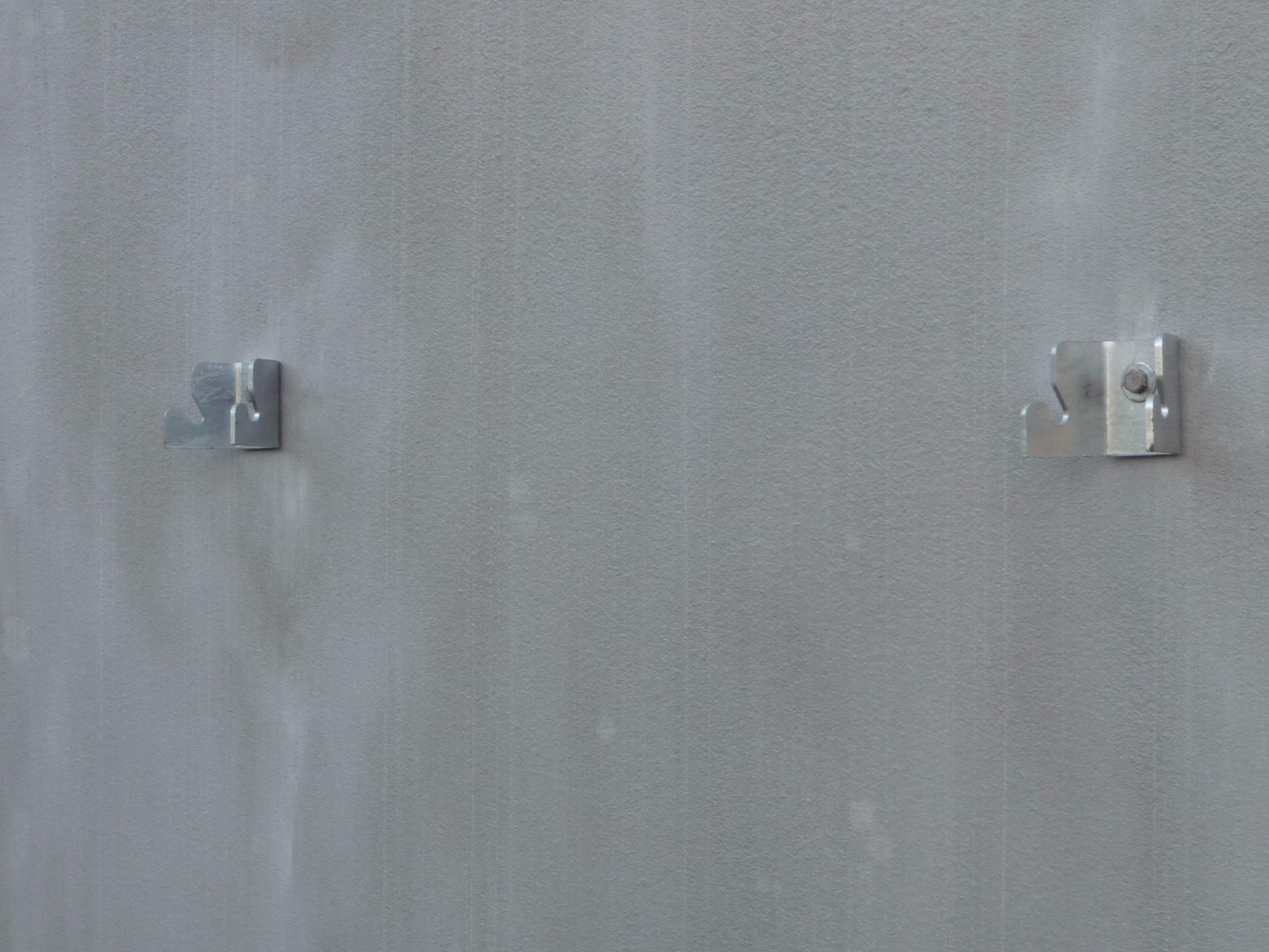

Anything else above this will be done with a small roller (I will inquire about a sheep's foot roller) and jumping jack. Rebar will be attached to the brackets on the back wall (see photo below) and bent out. This gives more rebar embedded in the slab to keep it from sinking.
Are you saying the garage slab will be tied to the foundation walls? Does your soil conditions permit that? Did the structural engineer say that is OK to do? The reason I ask is that if that were done here with our expansive (hot) soils; you would more than likely end up with major damage down the road. Yesterday my wife and I toured a neighbor's house built by the same clown who built our place. Their problems make ours look minor. Besides shoddy workmanship by the builder, our hot soils finished wrecking their house. From what I saw of it, at a bare minimum the finished basement has to be gutted and the concrete floor blown out and redone; but based on additional damage caused to the main floor and exterior by the heaving soils it would be better to scrape the house off and start over. Be careful tying slabs to the foundation is my only advice, especially since you have such a high water table.
