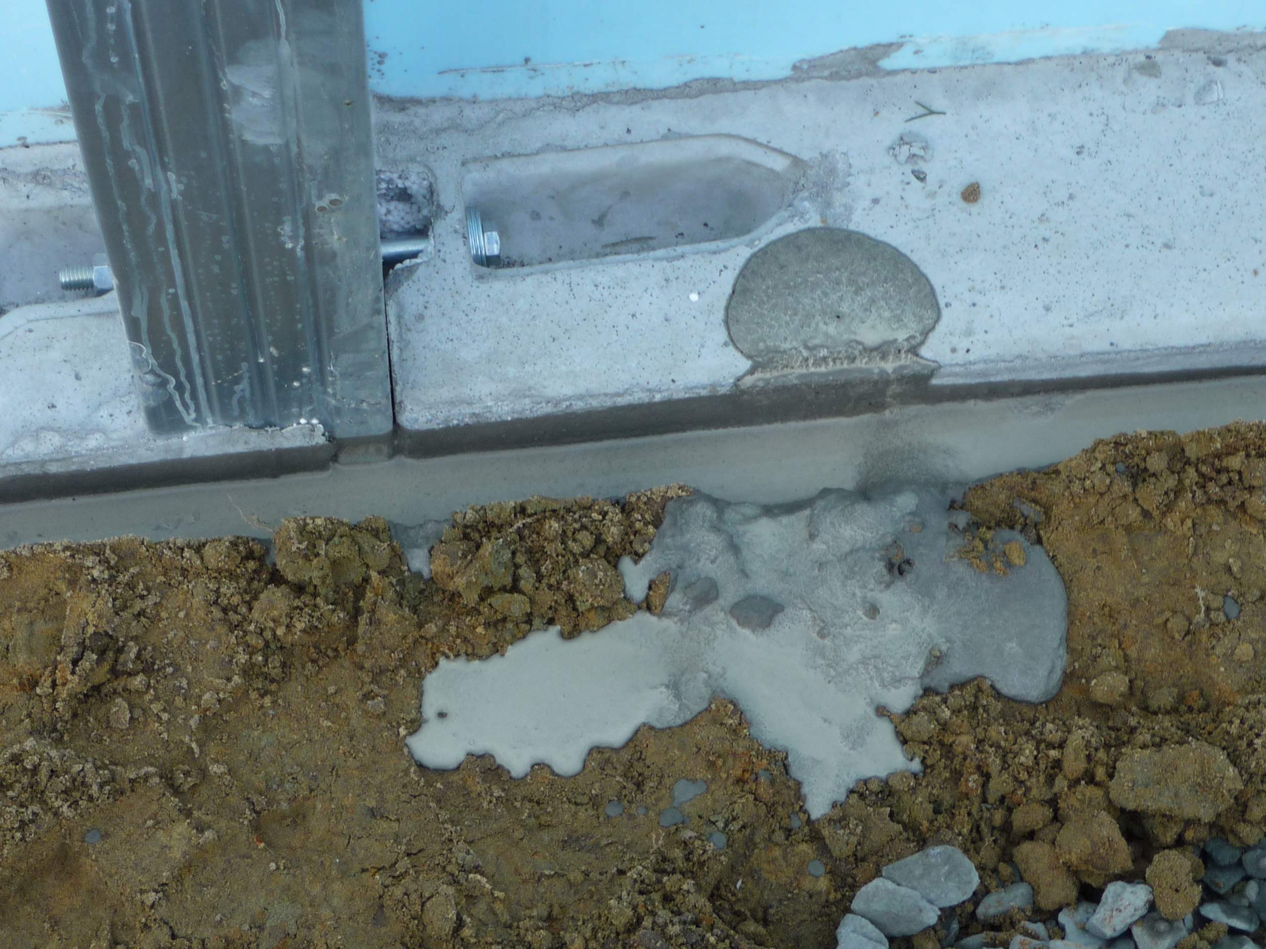

What was the purpose of the little square pads they set the walls on? Are they still under there and how do they seal the bottom joint?
   / New Home Begins
#179
The pads are dense ABS and are shims as no footing is ever exactly level. They do not use steel as it will eventually rust In fact, they take the high point and still add shims under there. They want a small gap. When it is done, they build a little dam both inside and out and pour a 5000 psi non shrinking grout into all around and let it come out the other side, insuring that the gap is completely filled.
Here is a picture showing the gap and they have poured the grout in. The depth of the grout is about 2". After they completed the inside, they inspected the outside to make sure it was completely filled and added more where necessary.
Keep in mind that if this was a gravel footing, water would flow through to the drain anyway. This gap is 8" under finished floor ... 4" slab and 4" stone.
