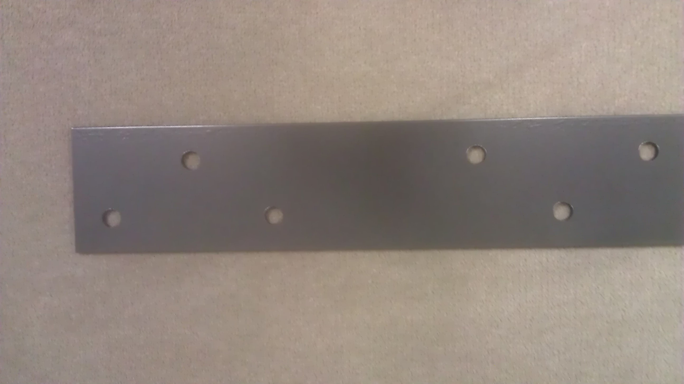

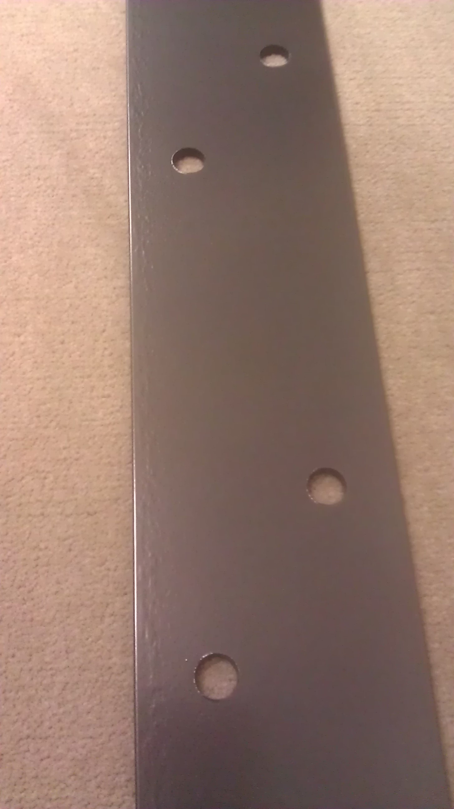

Sill and french drain inspections tomorrow.
Got the collar ties and ridge plates back from being powder coated. Collar ties are 5" x 24" x 1/4" and the ridge plates are 4" x 4" x 10" x 1/4" angle. There are 20 of each and it only cost $185 to have them sandblasted, primed and powder coated. Sweet. :cool:
Before:
After:
