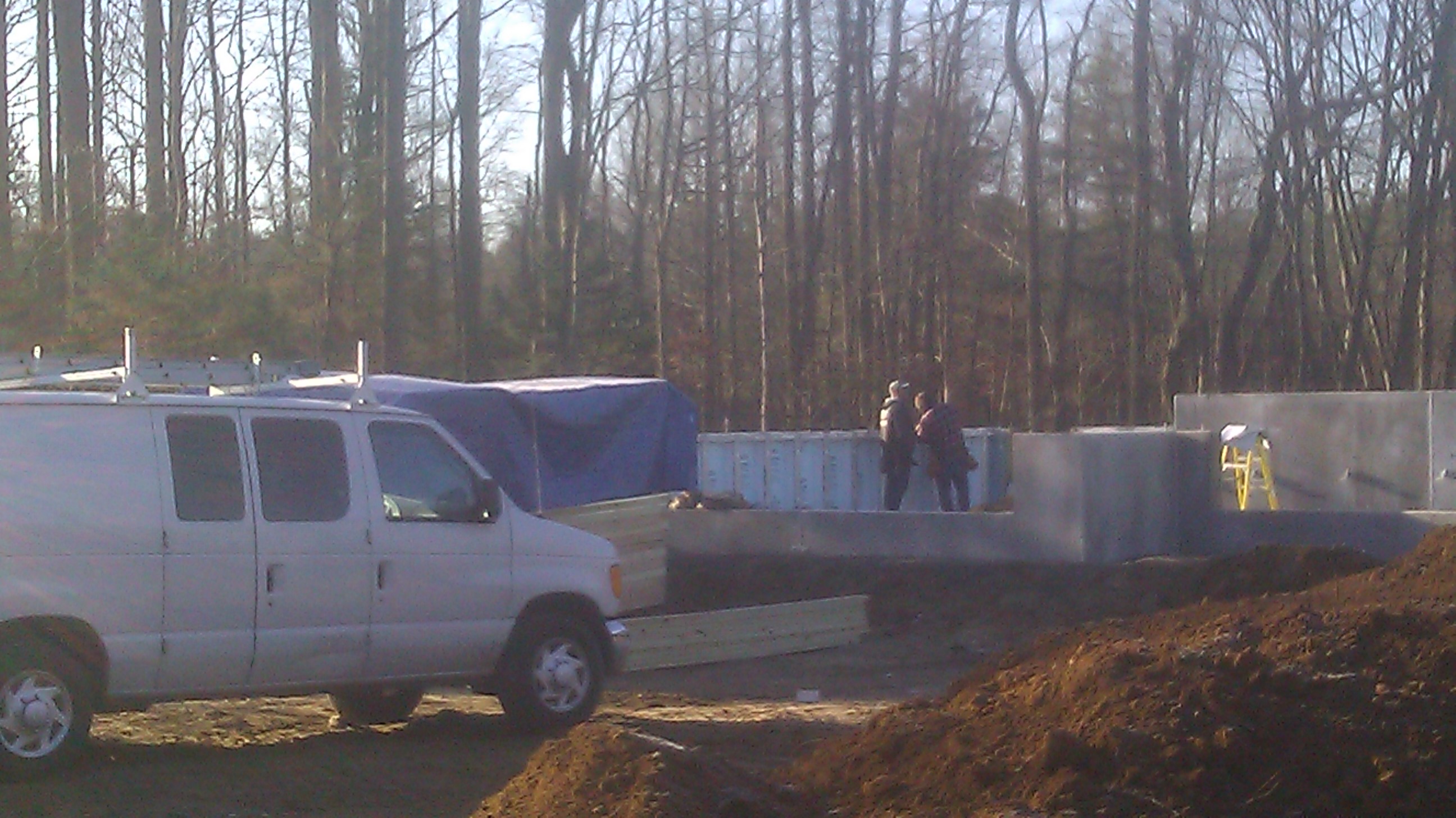

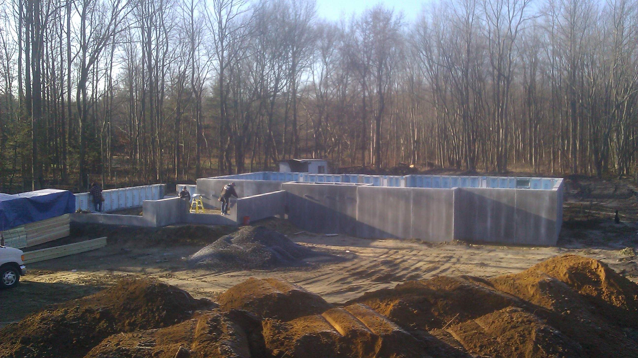

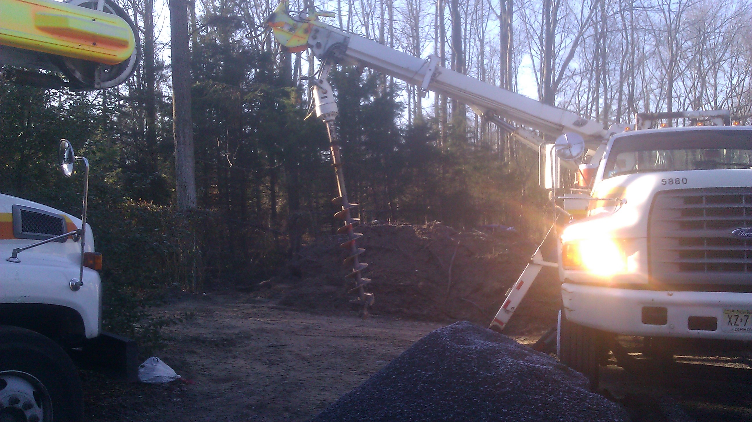

Nice morning! Framers are here and snapping lines and prepping for sills. Sill inspection will be scheduled for the start of the week. PSE&G (local electric company) had been scheduled to put up the new pole sometime in the next two weeks. They arrived without notice this morning and will have the pole and secondary run over this morning.
Go figure ... a roughly 200' run for electric. If I do overhead, the entire cost is $0 to me, including pole, wire, installation, etc is truly free to me. Unfortunately, this would mean I would have to put up a mast to get the service up high enough. If I do underground, then the entire cost of trenching, conduit, wire, etc is all on me. So we came up with a compromise. PSE&G will set an intermediate pole since they can only go about 100' between supports and the cost of that and wire is on them. I will do underground from this pole. It's a win-win. Their costs are reduced since distance is less. Mine are reduced since the amount of underground is reduced and no mast!
Here are some pics.
IMAG0619.jpg IMAG0620.jpg IMAG0621.jpg IMAG0622.jpg IMAG0623.jpg IMAG0627.jpg IMAG0628.jpg

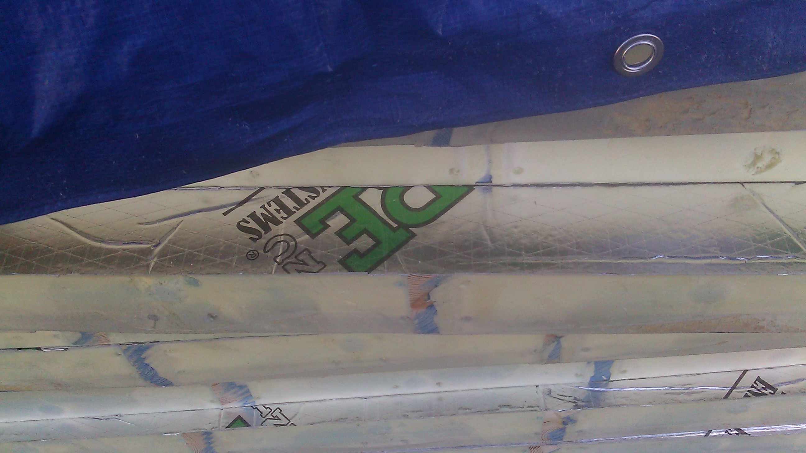

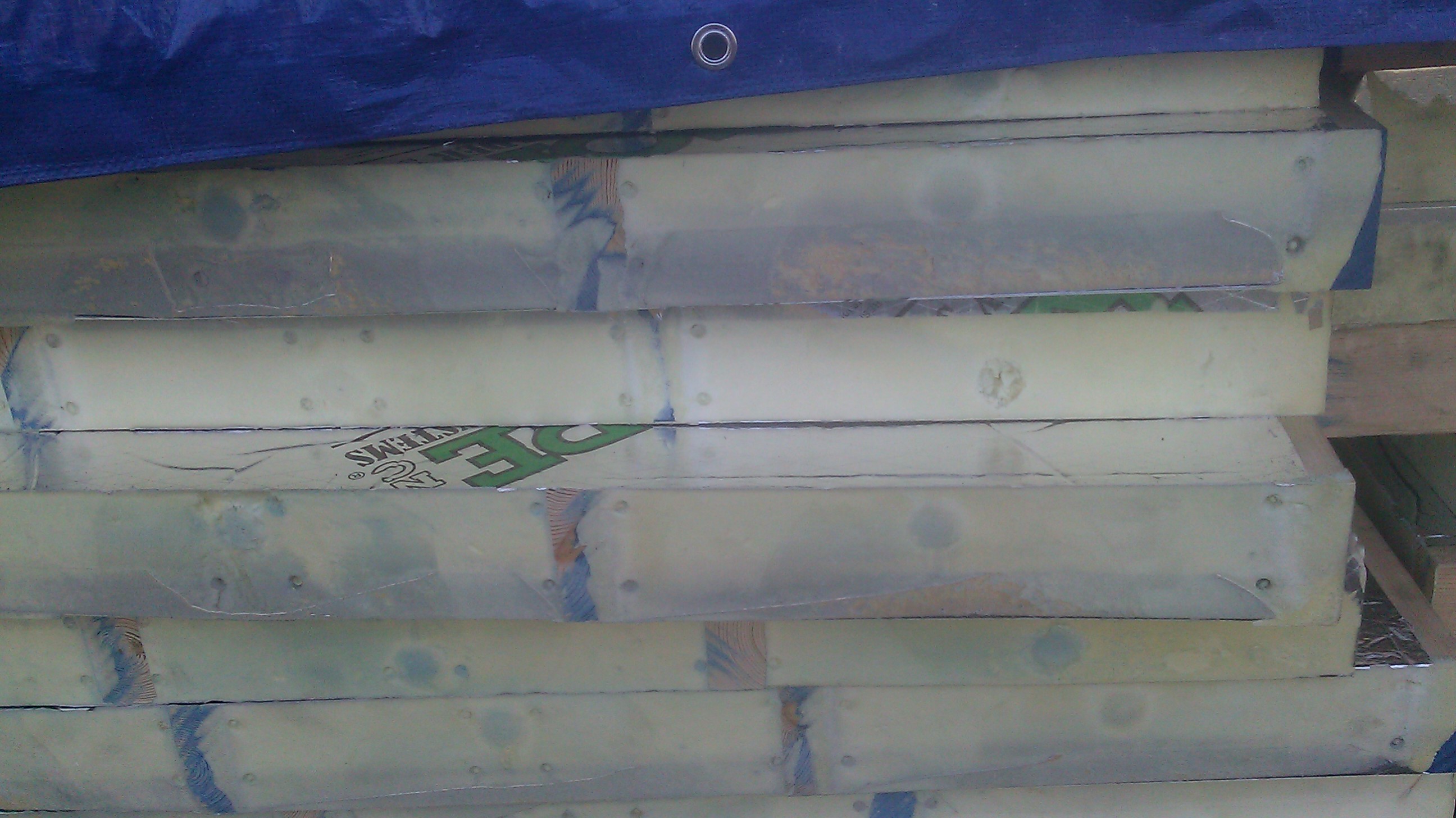

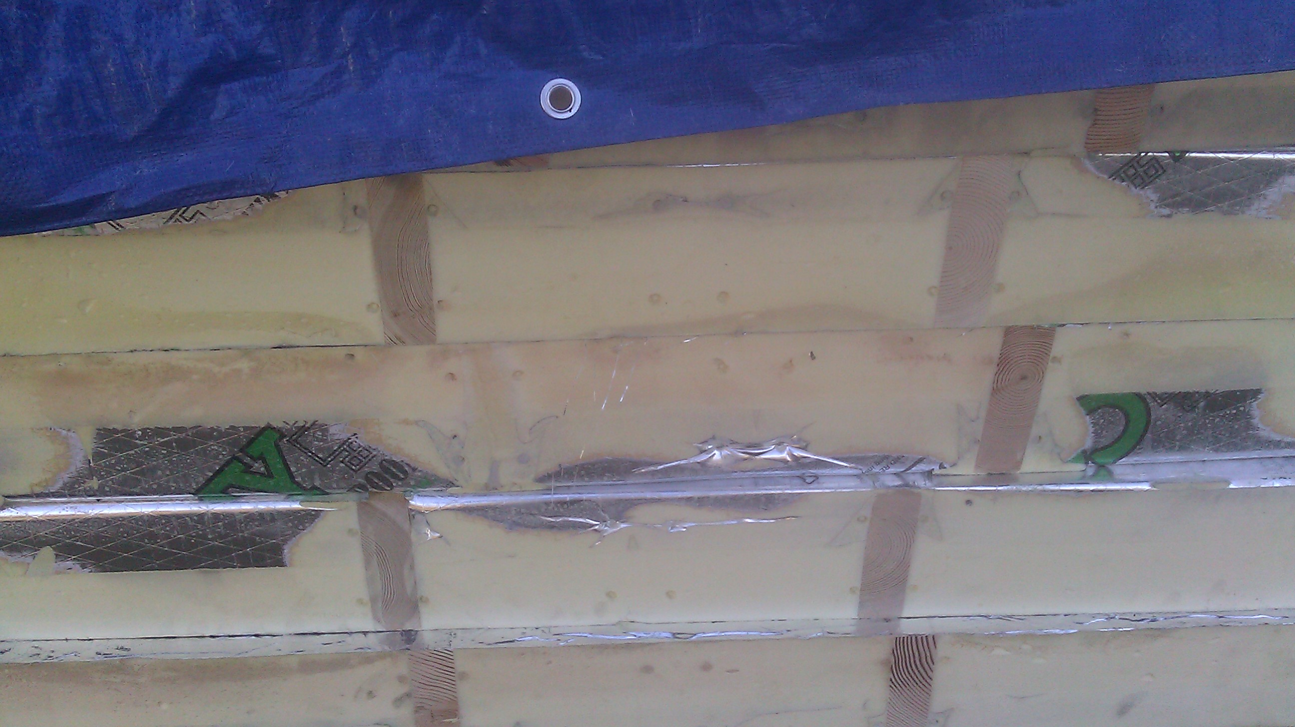

Here are some pics of the raycore wall panels. Notice the studs cast directly into them. I am very impressed so far. Framers checked them out on line and excited to use them as well.
