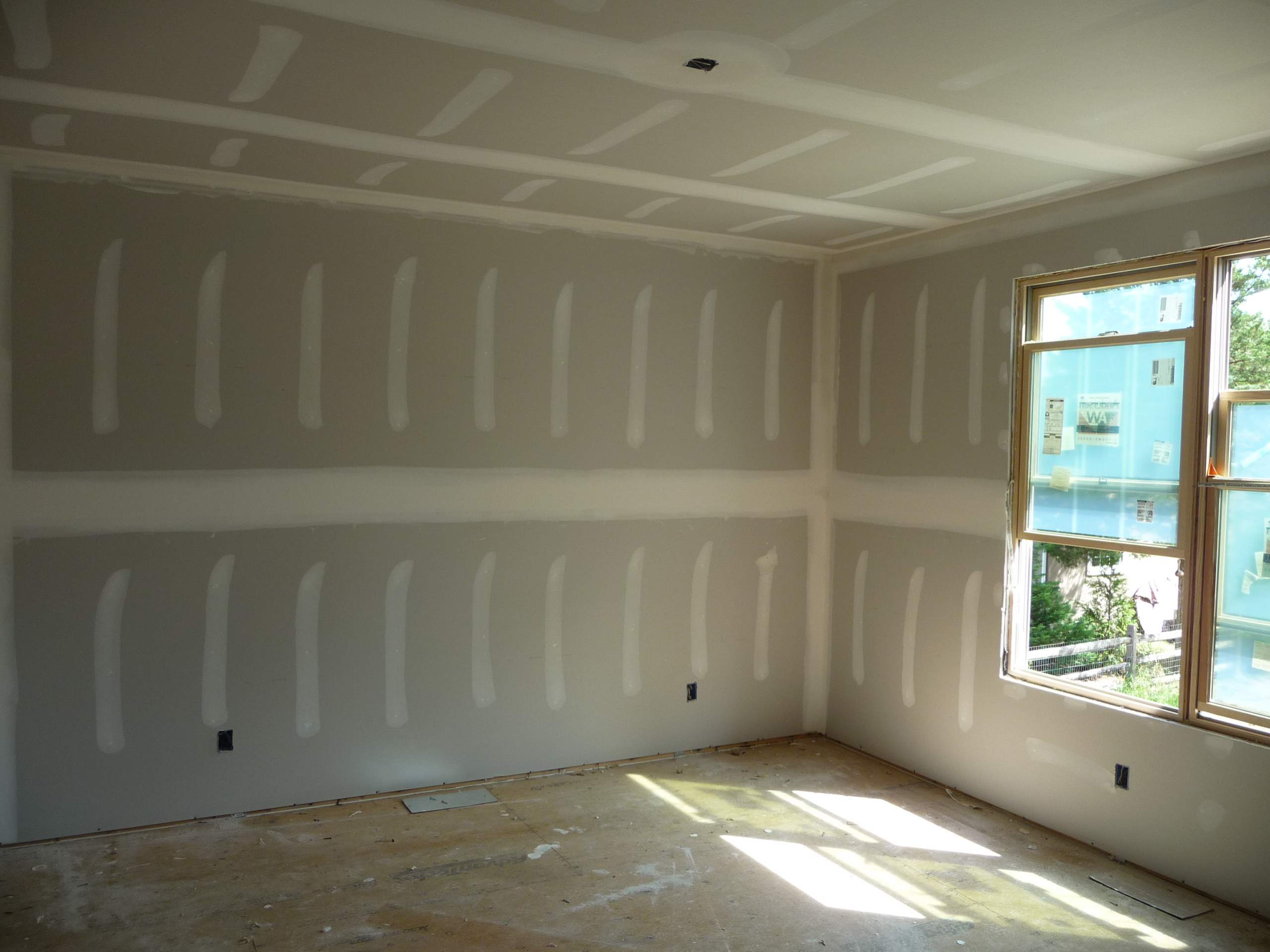

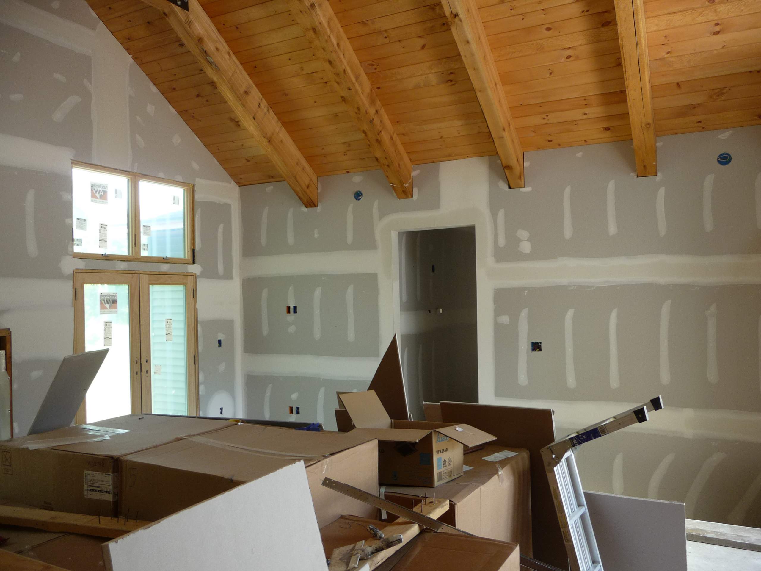

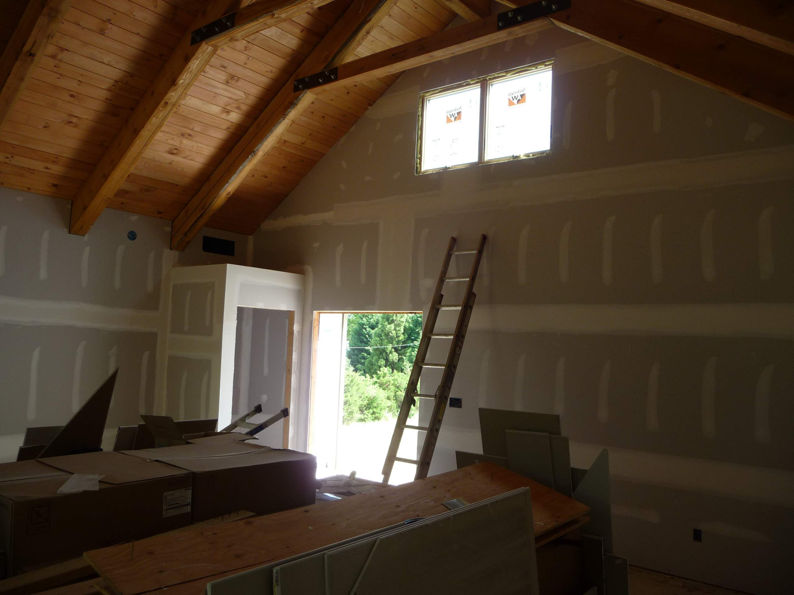

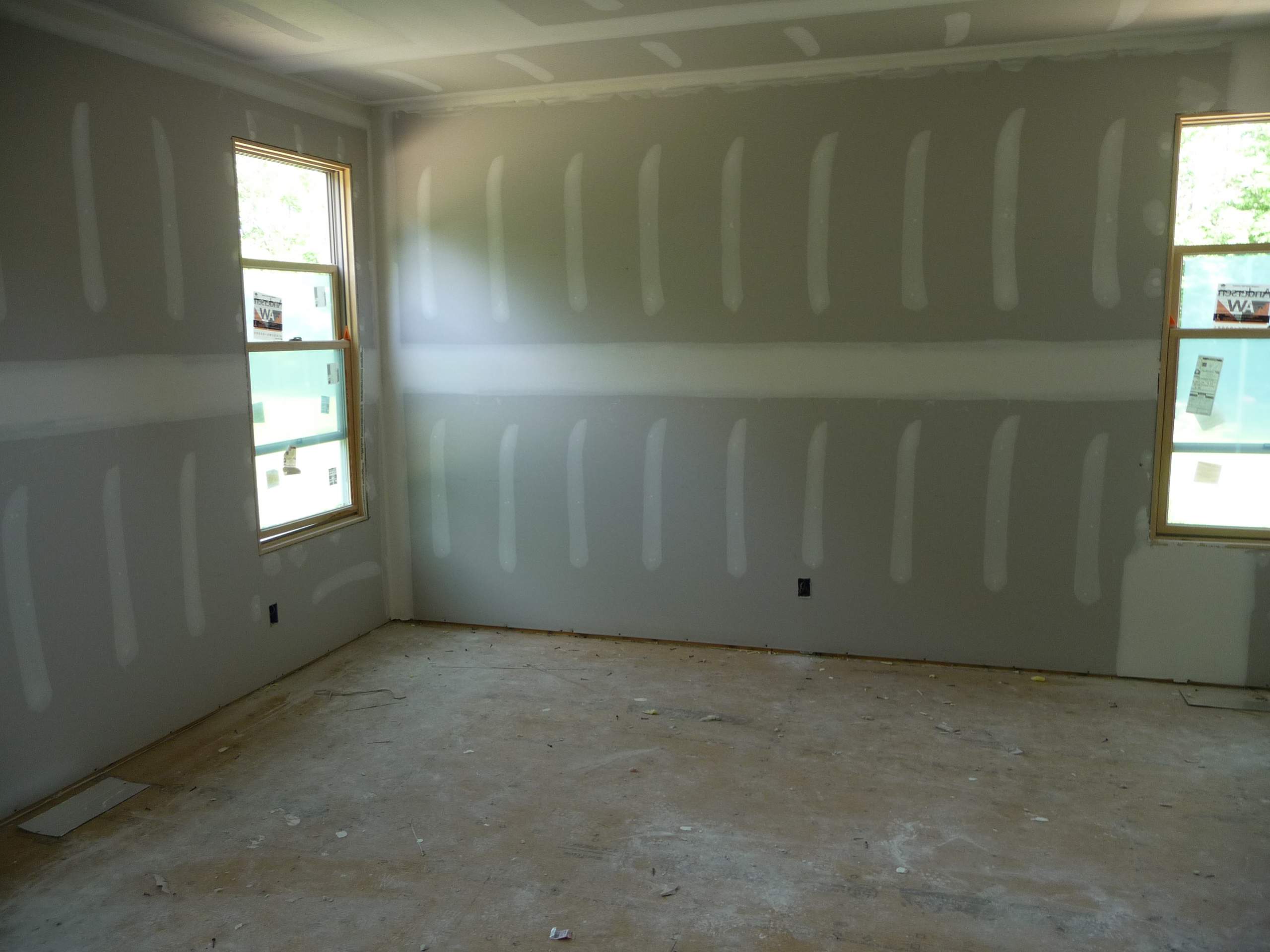

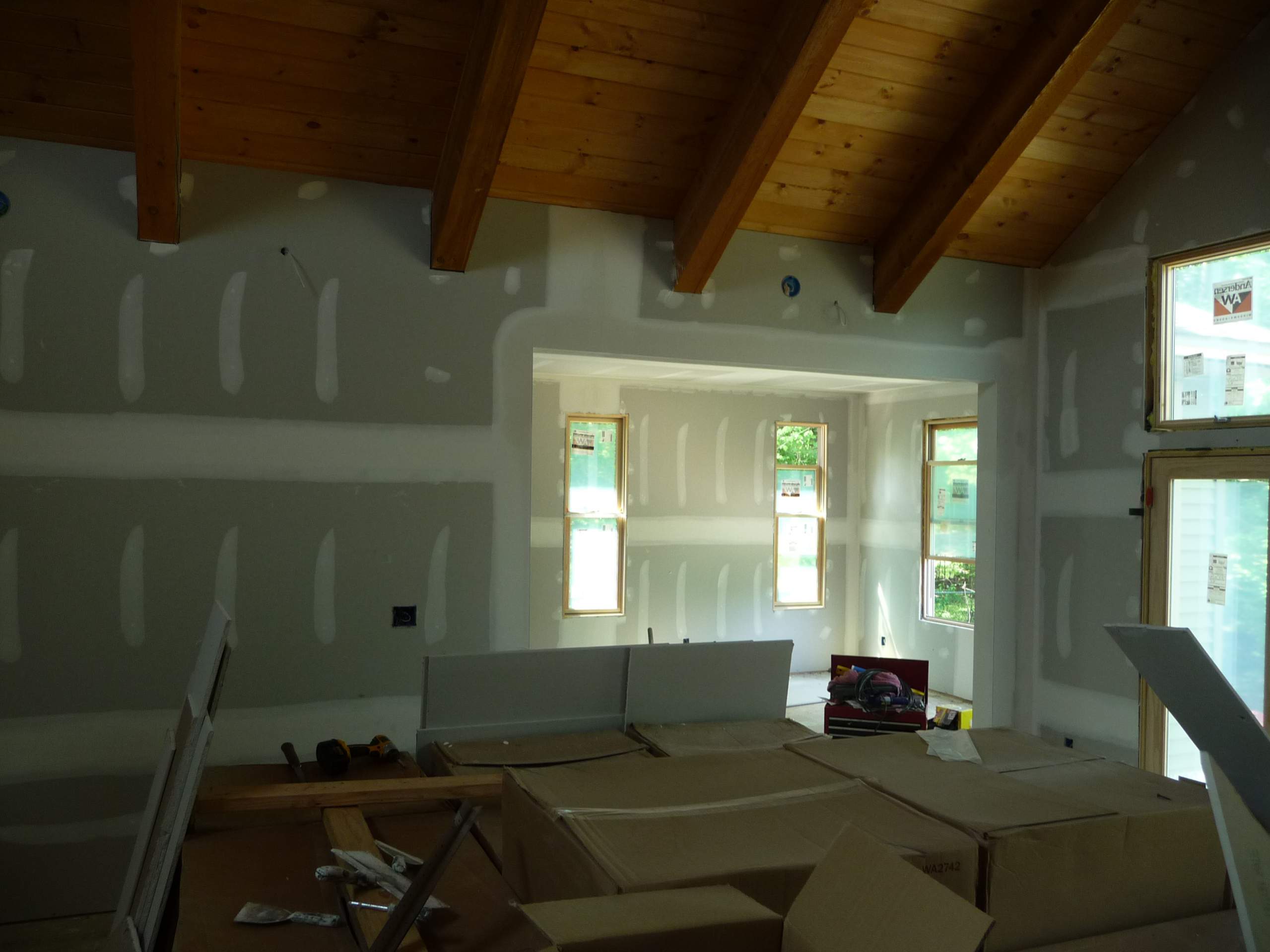

Day two of drywall. All ceilings are done as well as walls in all rooms except the great room. They expect to wrap up hanging the rock inside on Monday. I also expect them to finish the 5/8" on the garage wall common to the house.

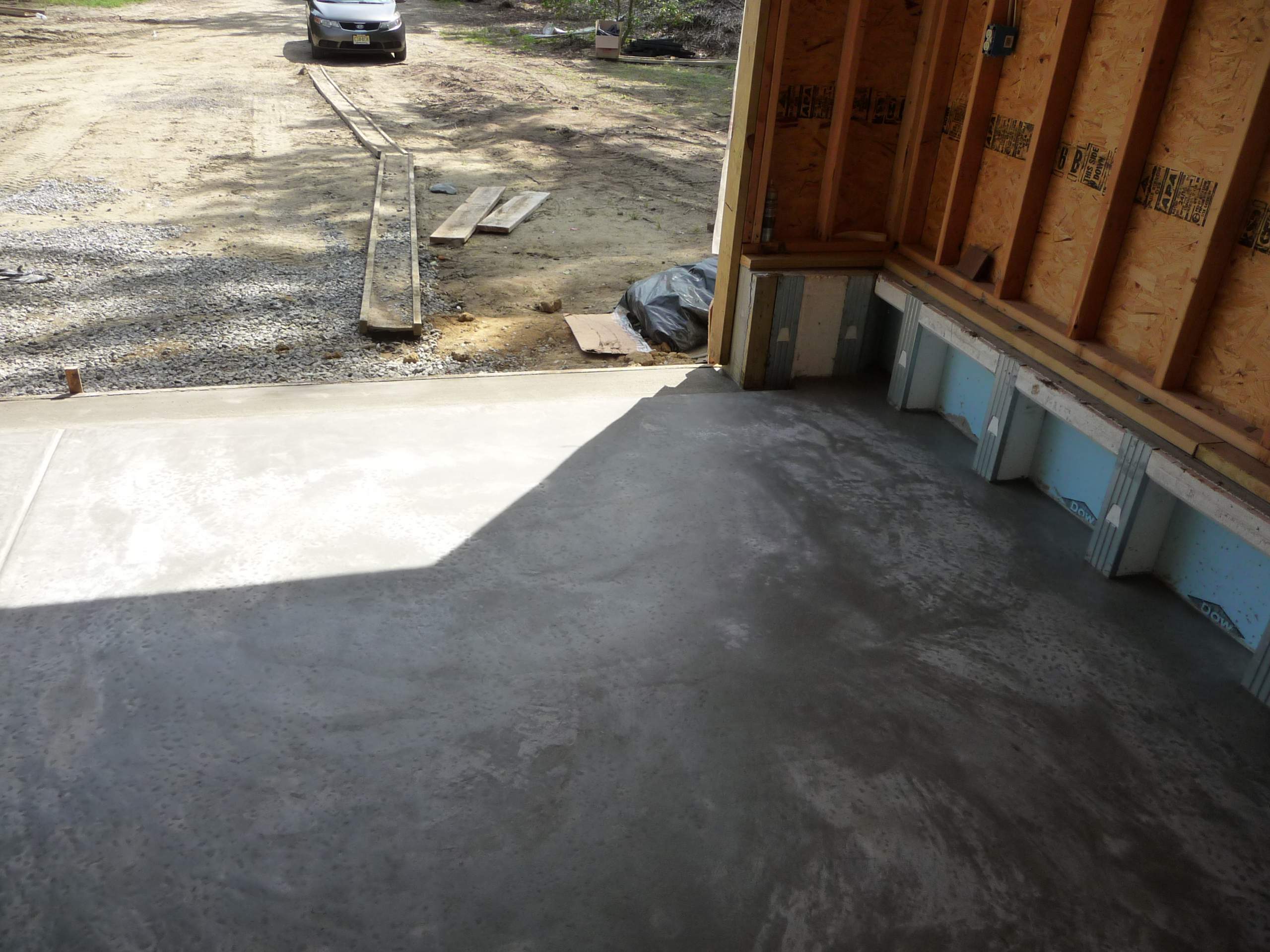

The concrete guy is supposed to finally show up Monday to prep the floor so we can have the slab inspection for Tuesday.
My wife is now charged with picking colors, but especially the kitchen so we can get the cabinets hung.
We are seriously considering doing our own concrete counter tops. Anyone have experience here? Especially with staining?
Thanks.

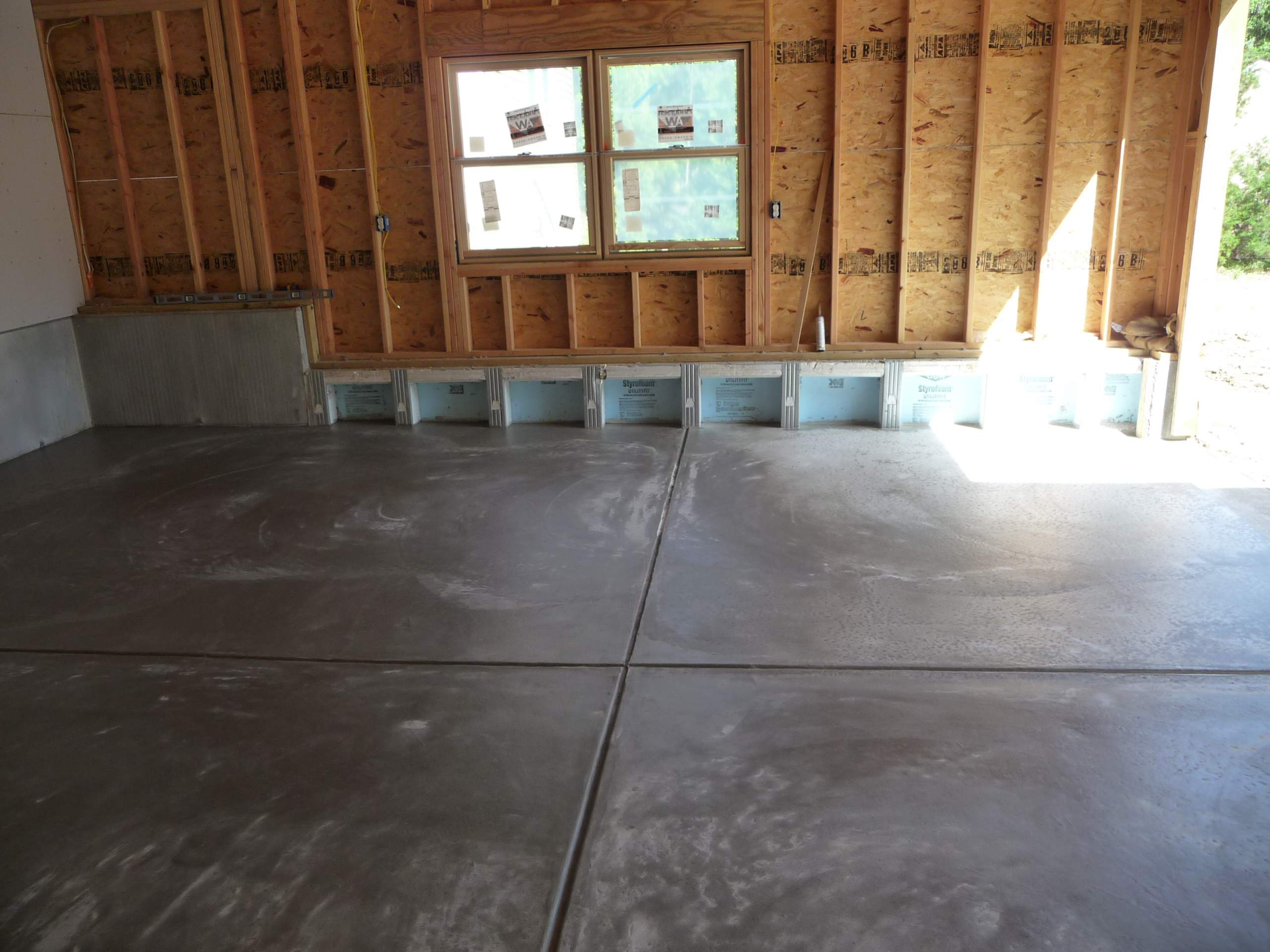

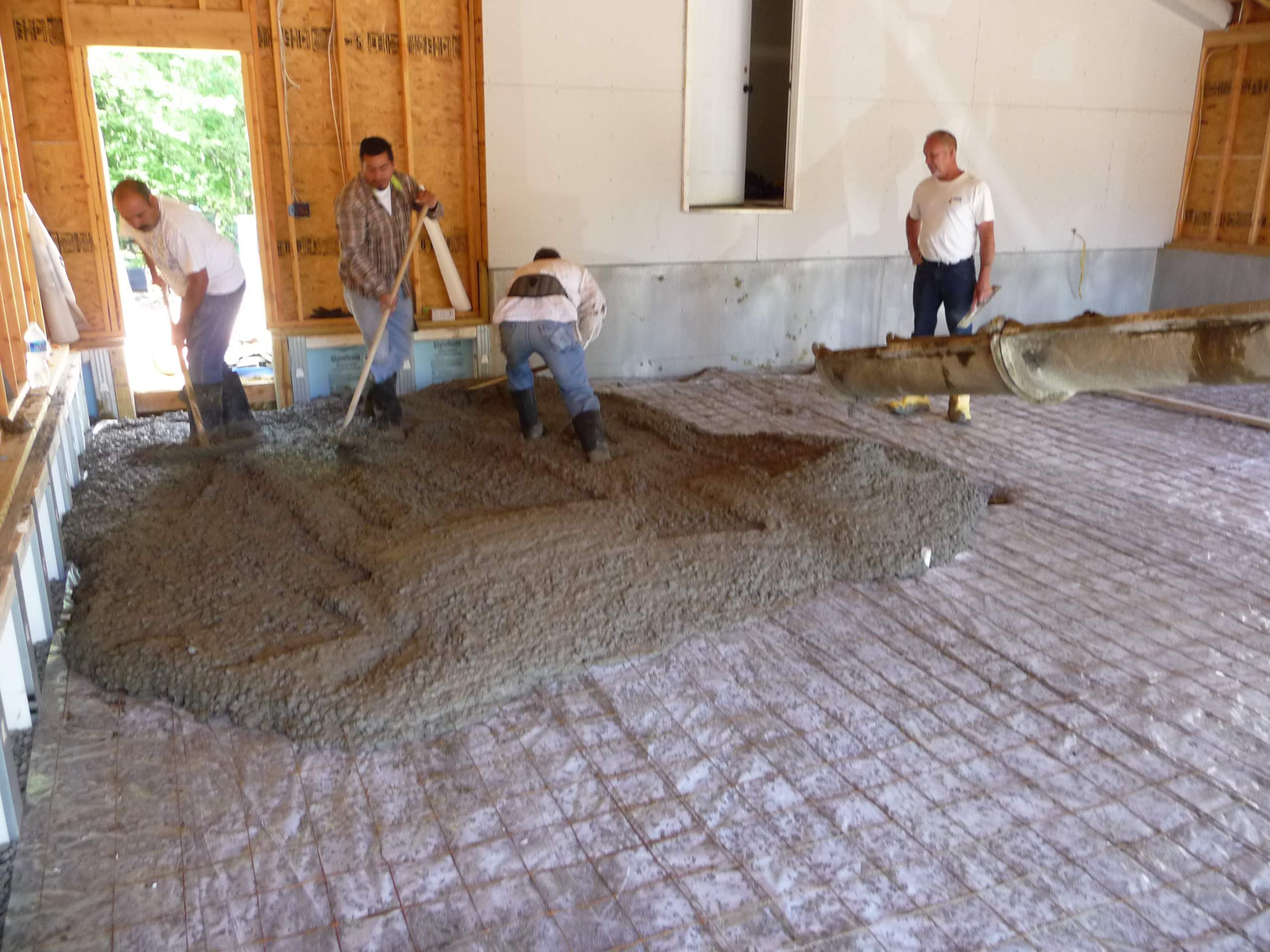

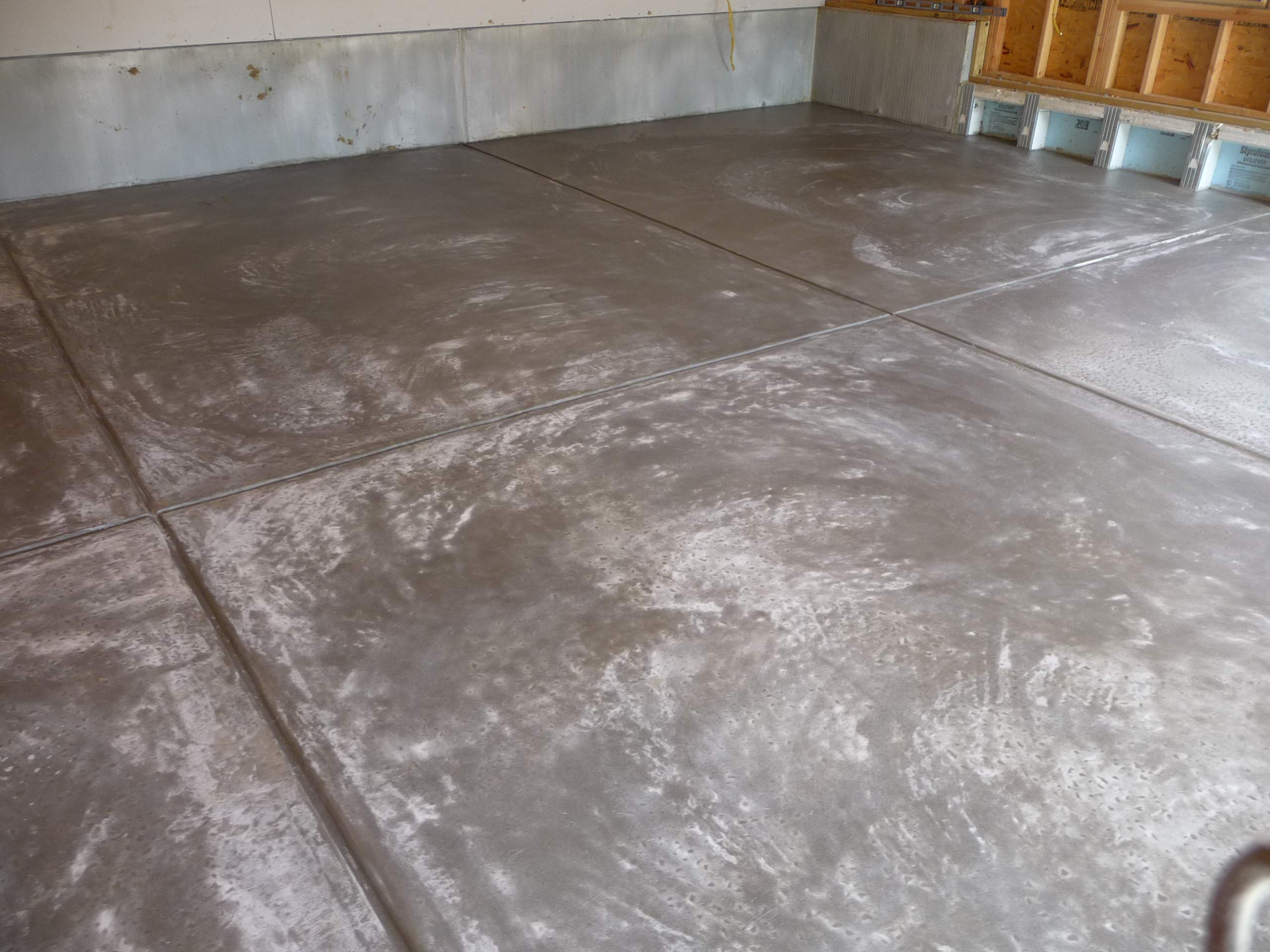

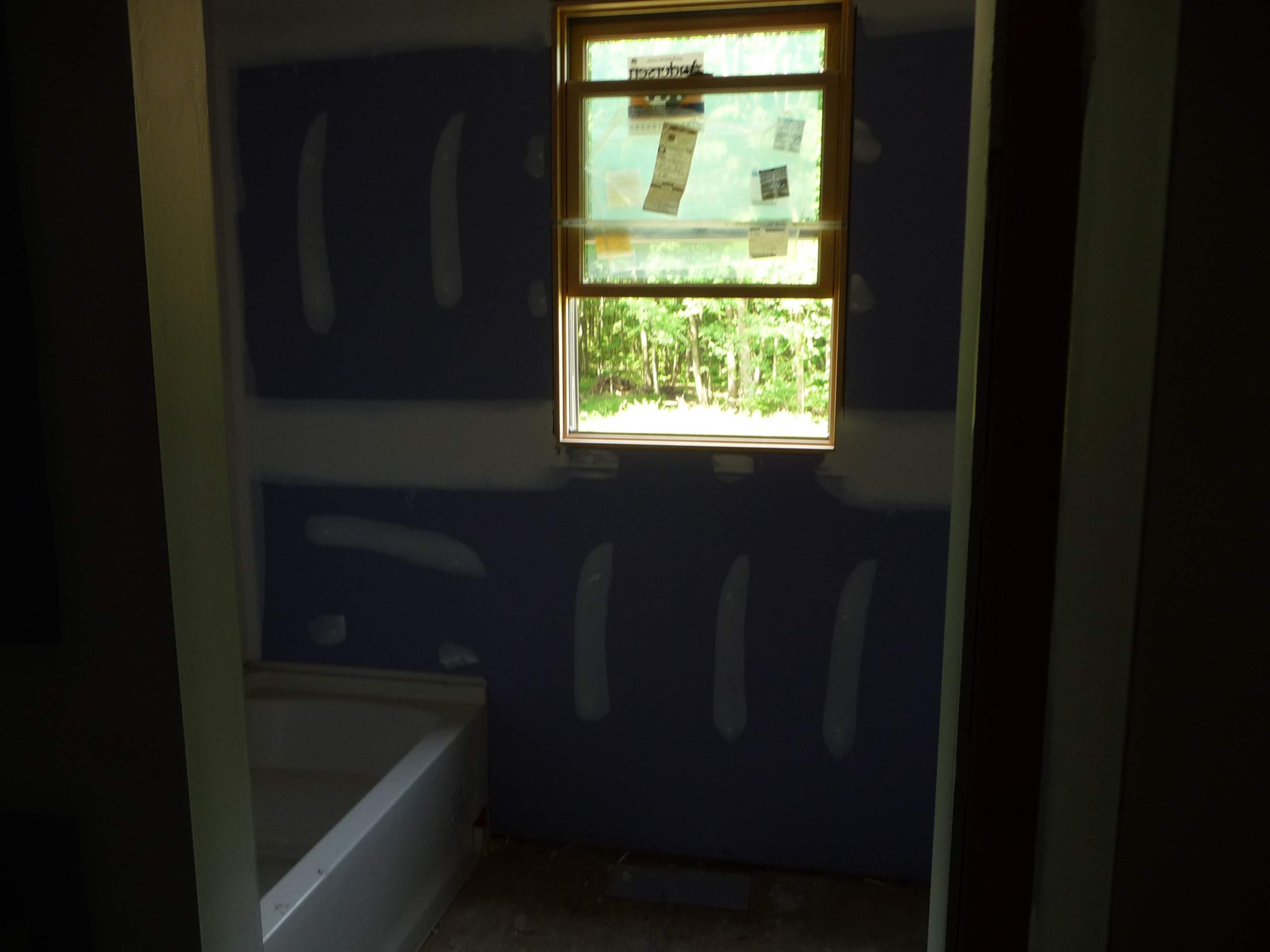

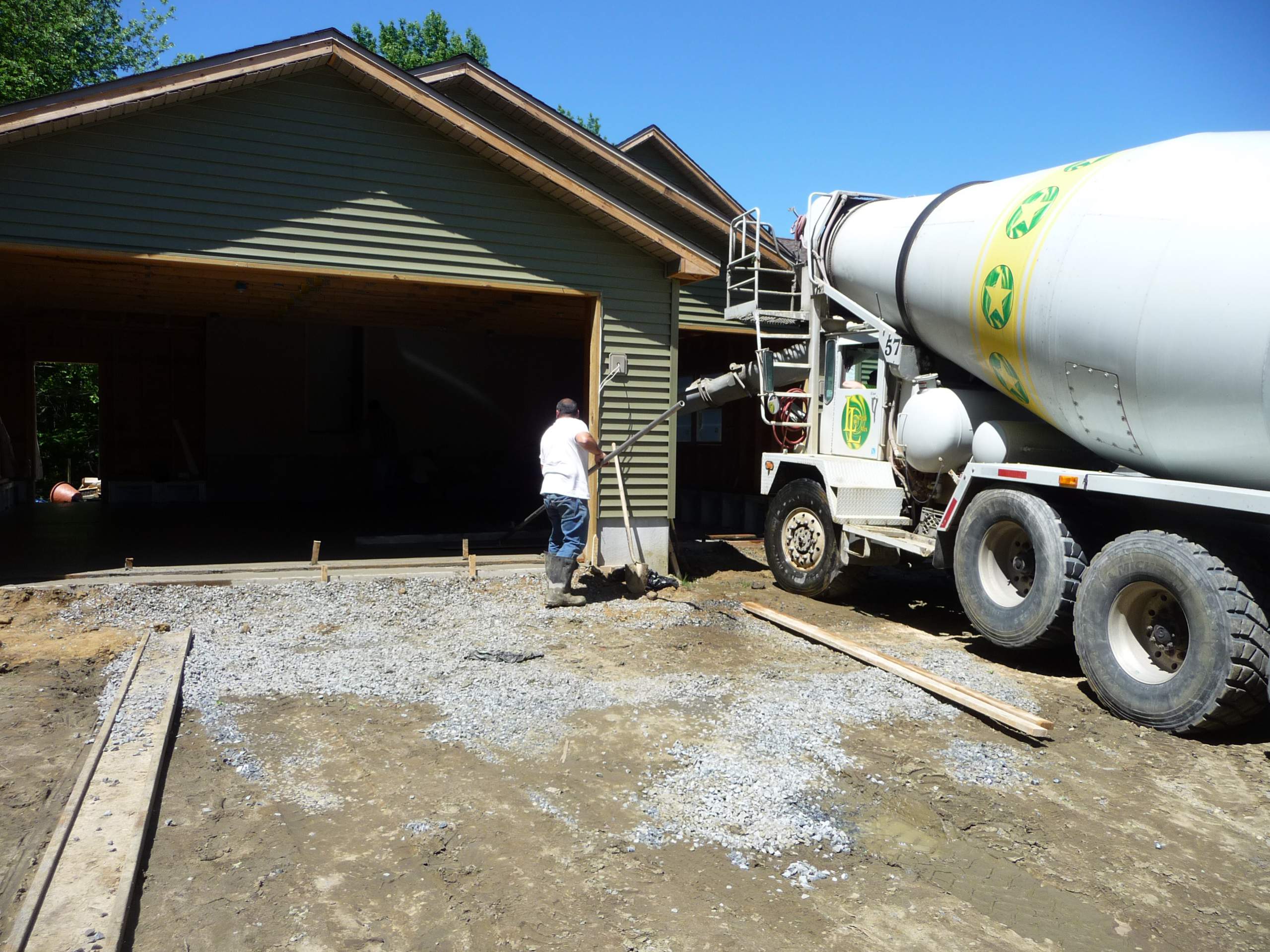

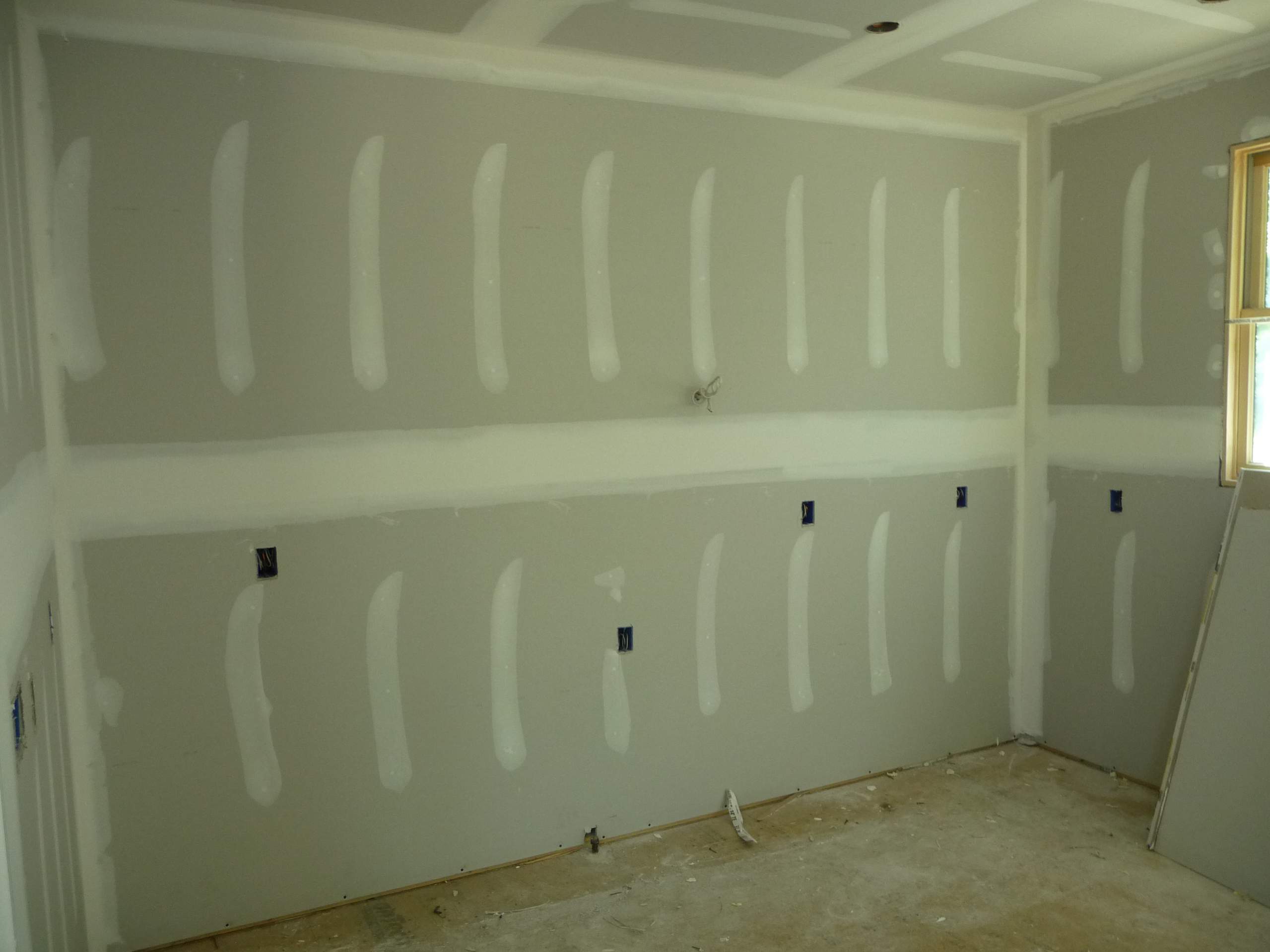

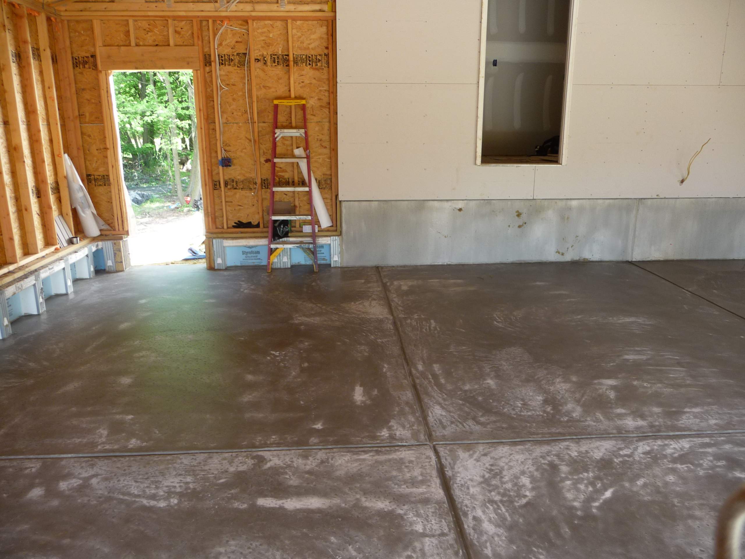

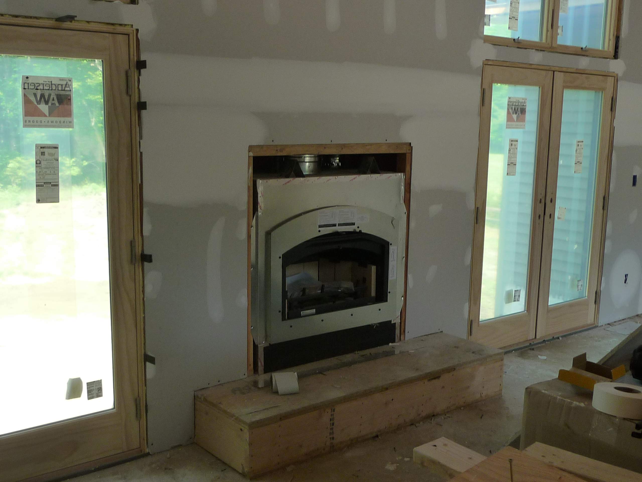

The garage floor and porch were poured yesterday. The sheetrock is all up and first coat of mud is done. Second coat tomorrow and he hopes to touch up/sand Friday. Upcoming plans are:
siding when the weather is good. Looks like rain Friday and into Saturday, so I can work on the steps into the laundry room then. We also hope to paint the kitchen this weekend so we can begin to put the cabinets up ASAP. We will using some of our leftover 1x6 tongue and groove under the cabinets as spacers to raise the cabinets up so the hardwood can just slip under the toekick edge by 1/2" or so. We can then shim as needed to the T&G.

If I may be so bold as to suggest renting an Airless Paint Sprayer for the painting this weekend. Putting the primer coat and then the base coat on new walls is a time consuming job with rollers or a brush. One can do in hours with a airless sprayer what can take days using a roller. New construction areas are nice for airless spraying, no molding, door frames, floors etc to worry about getting paint on.
I have a airless sprayer which I purchased at the Home or Lowes several years ago on sale. When I have a paint project planned I stop at U-Haul, purchase a couple of movers boxes and cut them into barrier strips. I hold the strip in my left hand and press it up against the area I don't want painted. No fuss, mess or clean up. The cardboard catches the over spray and only leaves a small thin area to be touched up with a brush. A metal cheater bar is available for this. Even professional painters use them.
