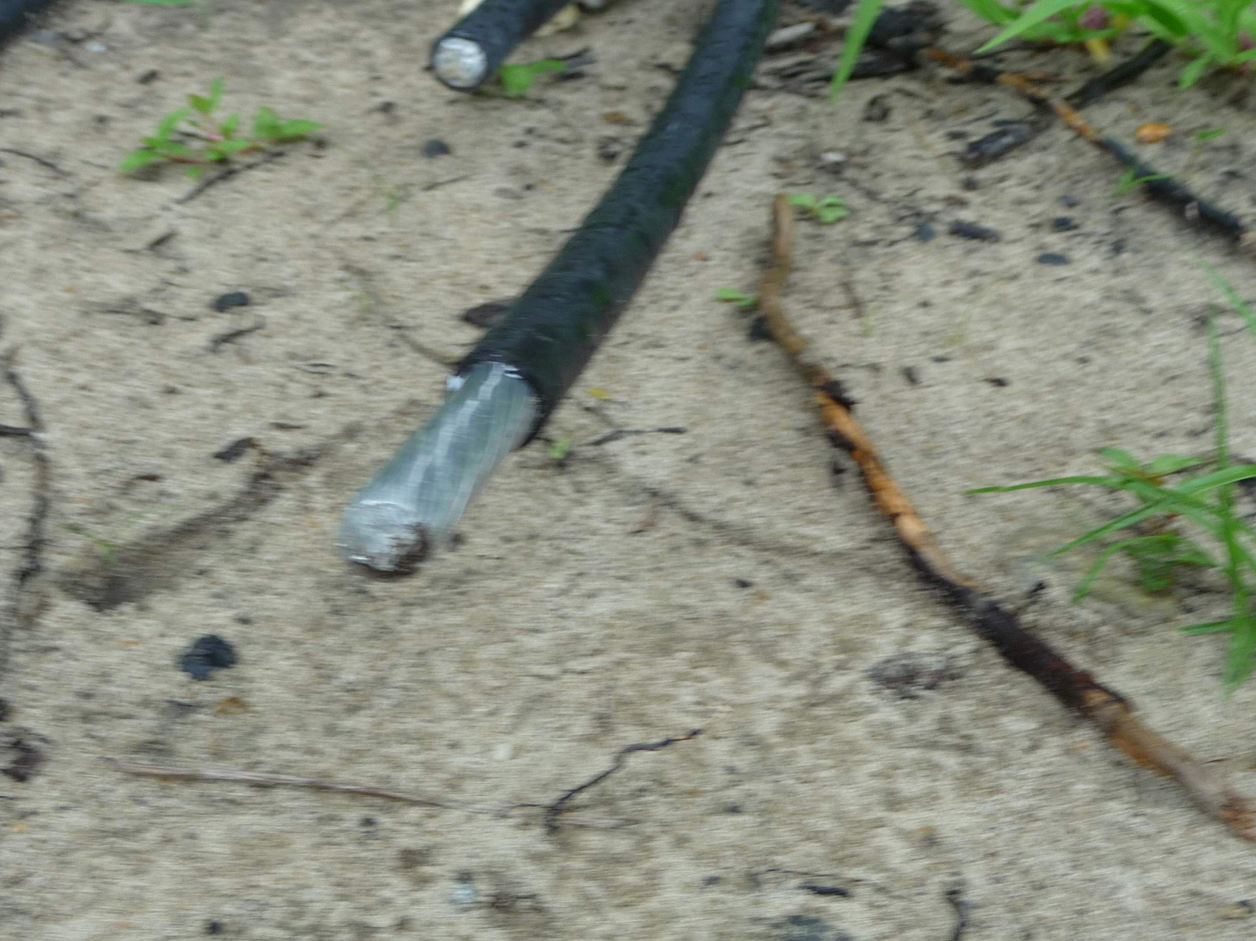

1) electric service trench, 2.5" conduit, three 250 MCM lines with a 130' pull all complete, inspected and approved. I am waiting on the utility to now come put the meter in and cut it in.

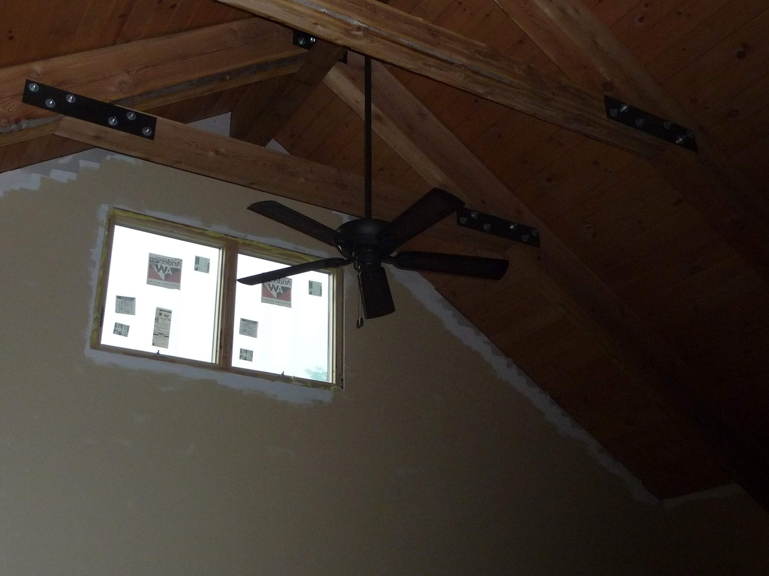

4) Ceiling fans are installed.

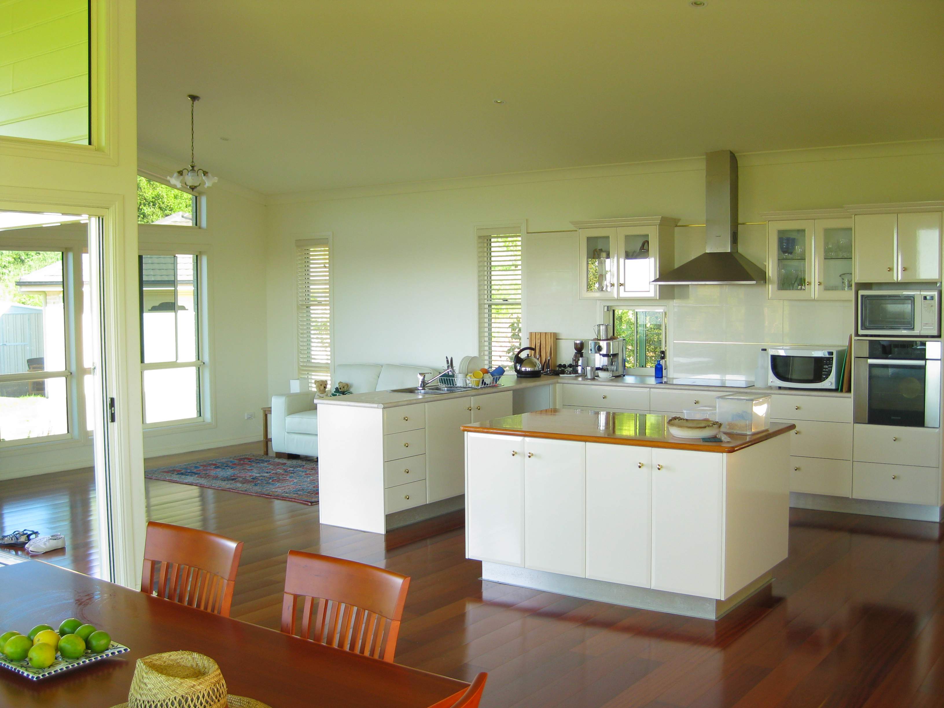

Watching this build is terrific . Thanks for taking the trouble to show us over the months :thumbsup: We're looking into replacing a combination of carpets and wood floor ( wood in the kitchen-diner ) with 8" oak premium grade
throughout ( 3000 feet excluding stairs and bathrooms/laundry/storage etc ) , but it's very expensive at USD45k all-up . I thought the oak looked better than the maple , but it is softer . This stuff is some sort of rosewood
laminate pre-cut lengths and fades badly .

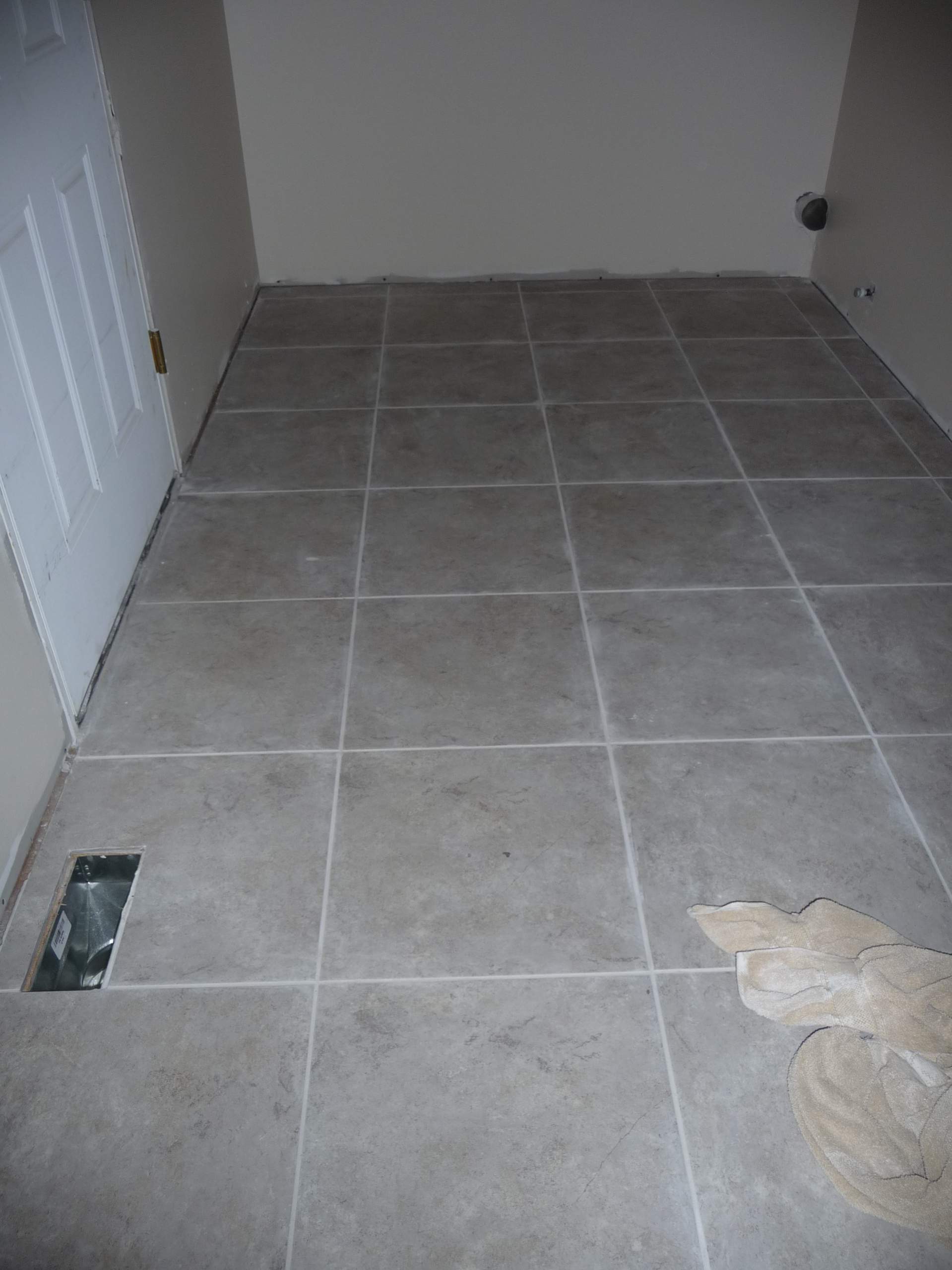

Tile for the laundry room. I will have to drill for the washer overflow but I picked up a 1 3/8" lennox diamond hole saw that goes through tile like butter.

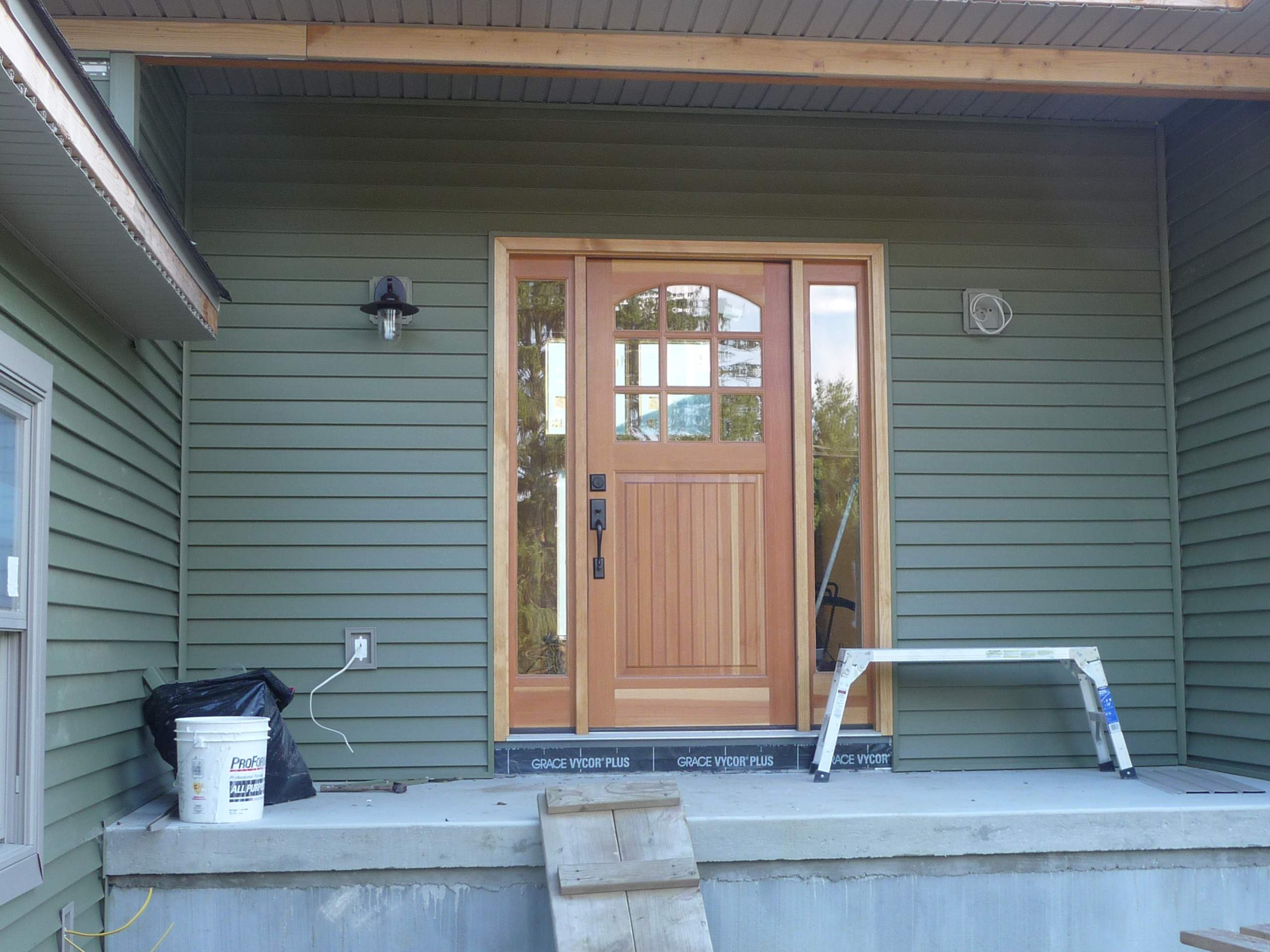

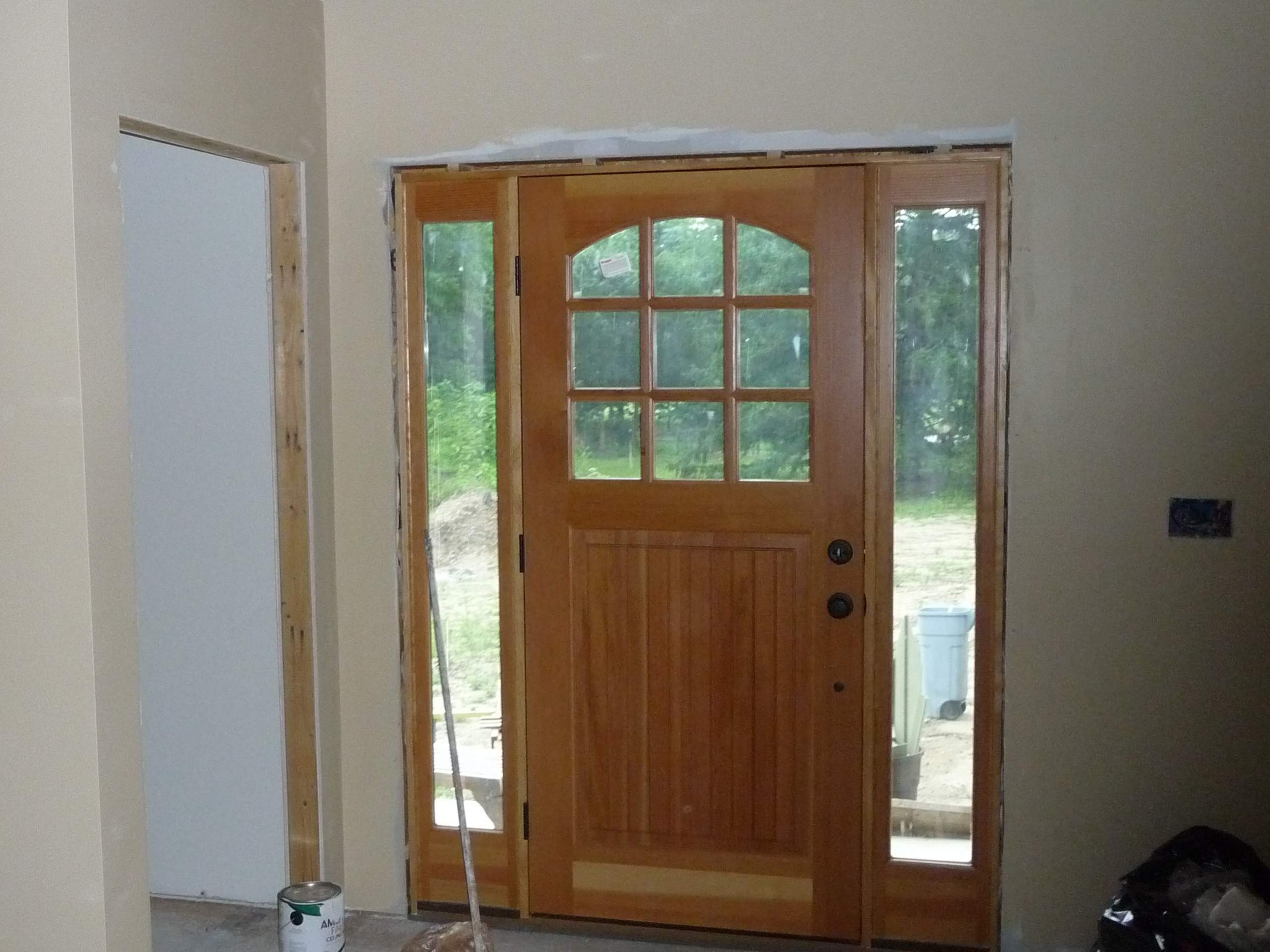

Front door, inside and out. We do not like the color in the great room and it is now a green.

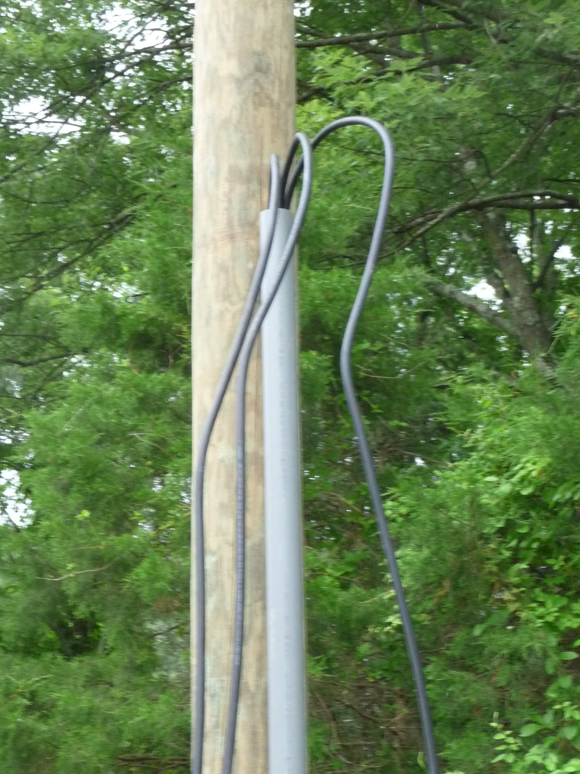

The electric service ready for the utility to connect it. I called them yesterday and they are going to connect next week. 250MCM, the biggest I have worked with.

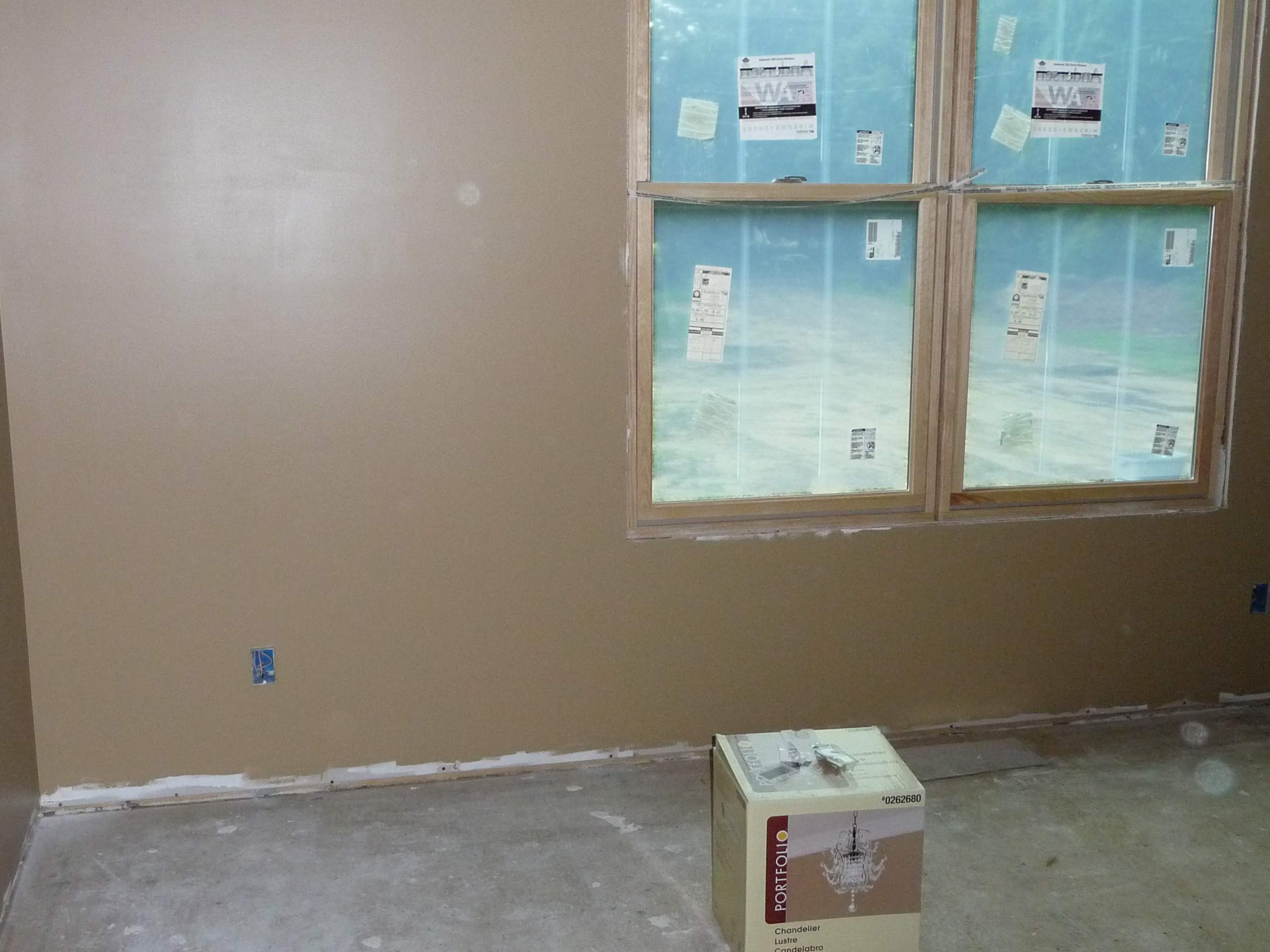

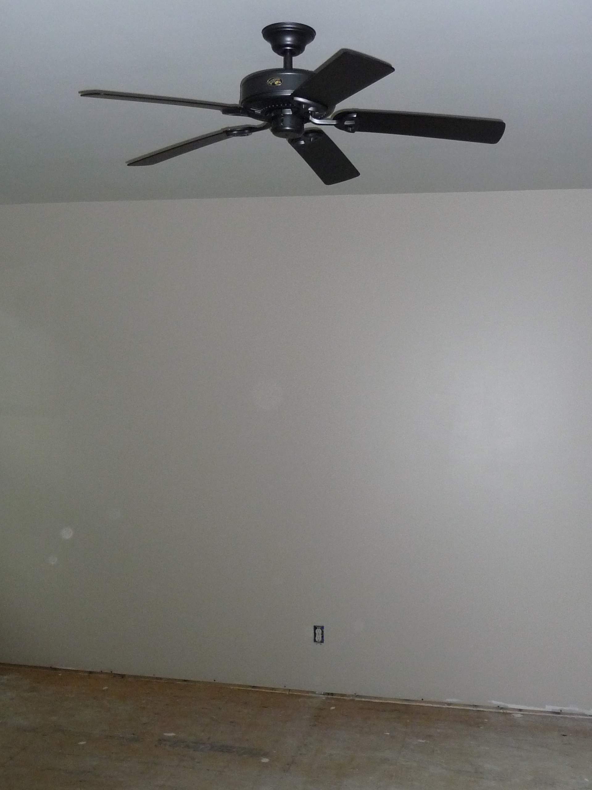

Miscellaneous rooms

That is one seriously heavyweight power cable :-0 How many kilowatts do you think you'll ever get the need for ?
It's not the kilowatts. I had to upgrade from 4/0 due to the 160' distance from the utility connection. They required I upgrade due to voltage drop beyond the typical 3%. I asked the inspector why I had to use 250 MCM and the 125' utility lead from the transformer was about a 2/0. He said that the utility uses steel, not aluminum, and does not incur the losses like aluminum.
   / New Home Begins #568
:laughing:That is about the funniest thing I have ever heard. Steel is a far worse conductor than aluminum. I have never heard of steel being used for electrical wire. If that is what he actually said, he is either clueless or making stuff up. Now the utilities will use cables with names like ACSR (aluminum conductor/steel reinforcement) to handle the stresses of long spans on poles, but note the name indicating that alum is the conductor...
I believe the reality is simply that the utility gets to operate under a different section of the code up to the meter, so they can get away with things you cannot on the house side of the meter... I also don't think you really needed to upsize for 160' run. I've been all through the calculations for my house, and I will be going with 250MCM for my run , but it is another 100' longer than yours. I just ran the calc for 160' and it gives a 5.44 V drop for 200A at 240V on Alum 250MCM (2.3%) and a 6.4V drop for 4/0 Alum (2.7%). Both are under the 3% recommendation. So your inspector appears to be full of it, but then that really doesn't matter in the end as you can't fight city hall...and it's too late now.
   / New Home Begins
#569
Yeah, it did not sound right to me either but you are right, you can't fight city hall. The inspector was not the one requiring it. It was the utility. It added $0.15 per foot to the cost. 170' (to be sure I was not short) * 3 conductors.

Lookin' good Tom, that front door is beautiful. :thumbsup: What size are those tiles in your laundry room, 16"?
