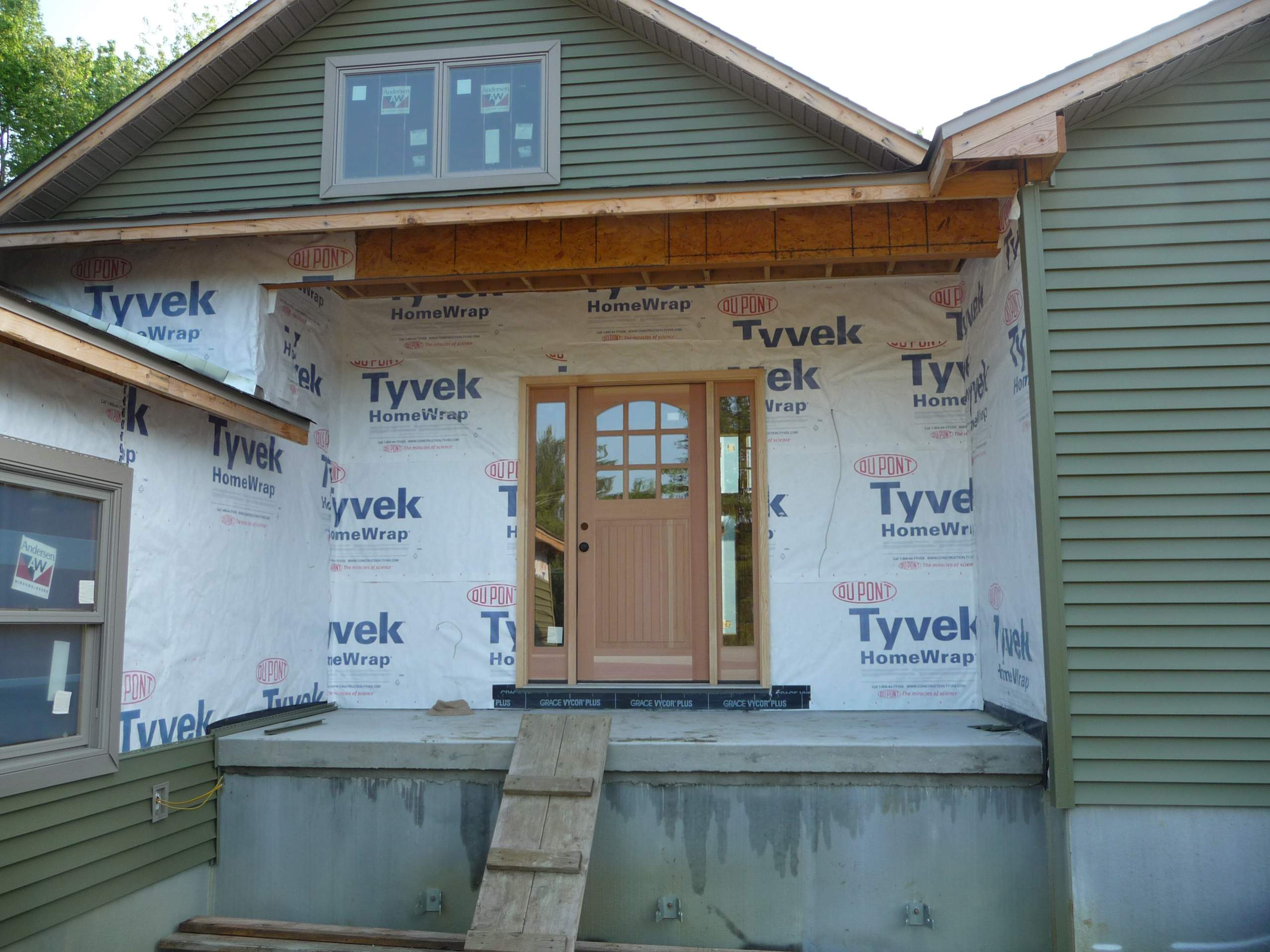

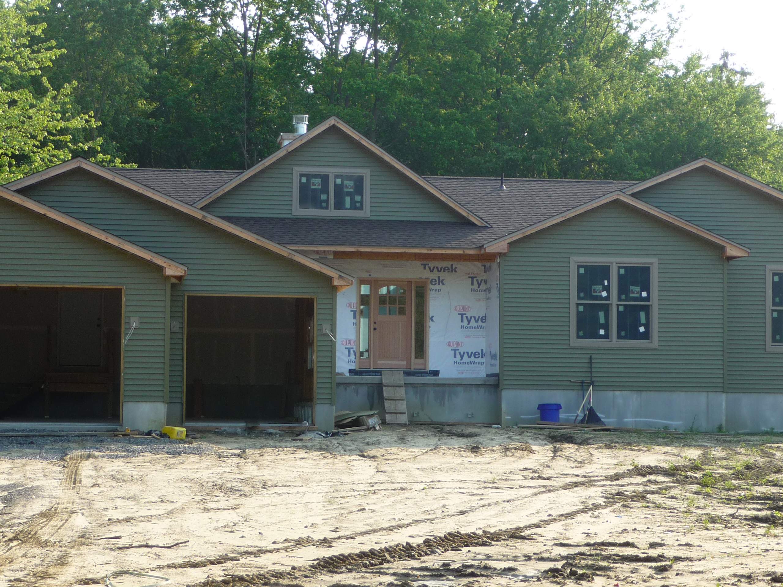

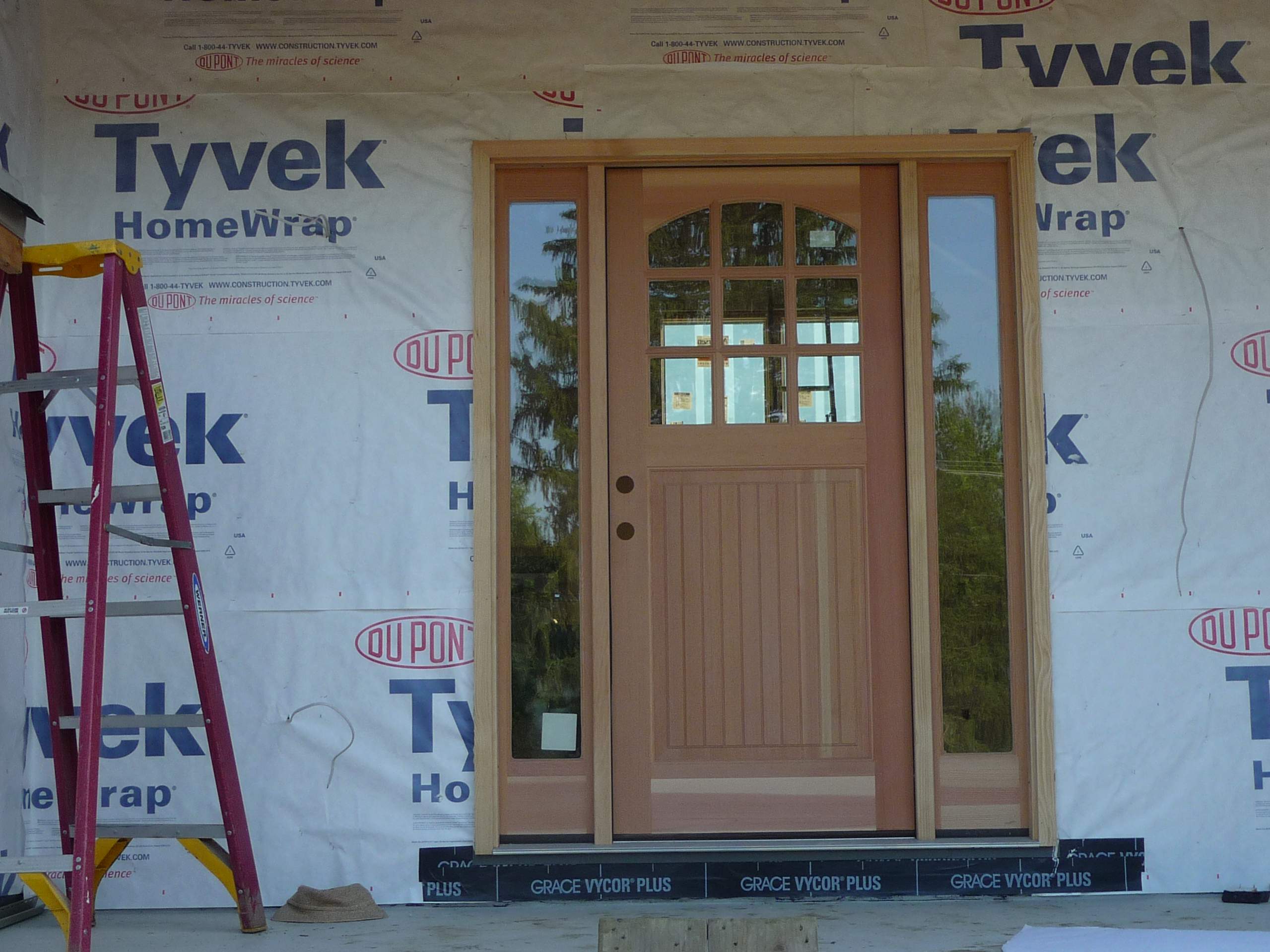

We have been able to get a lot done over the past few days.
We have been able to get the front door in. Since these pictures were taken, my wife has stained it and put one coat of varnish on. Two or three more coats to go. Now that school ends tomorrow for her, she can spend more time there to knock it out.
Now that the porch slab is done and since the above pictures were taken, we have almost finished the siding around the door. Maybe two hours to finish that but I have to wait for some more J-channel to come in.

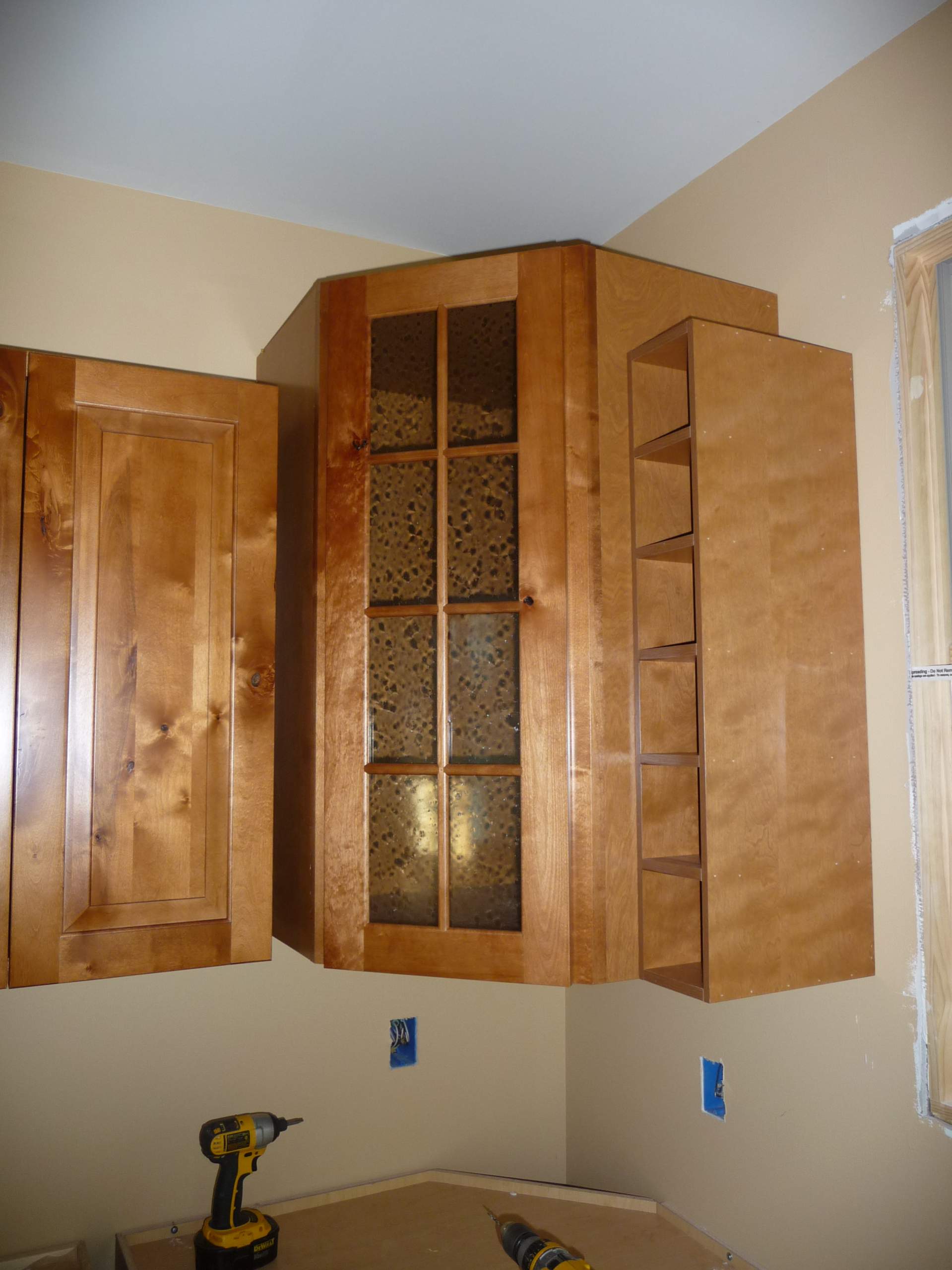

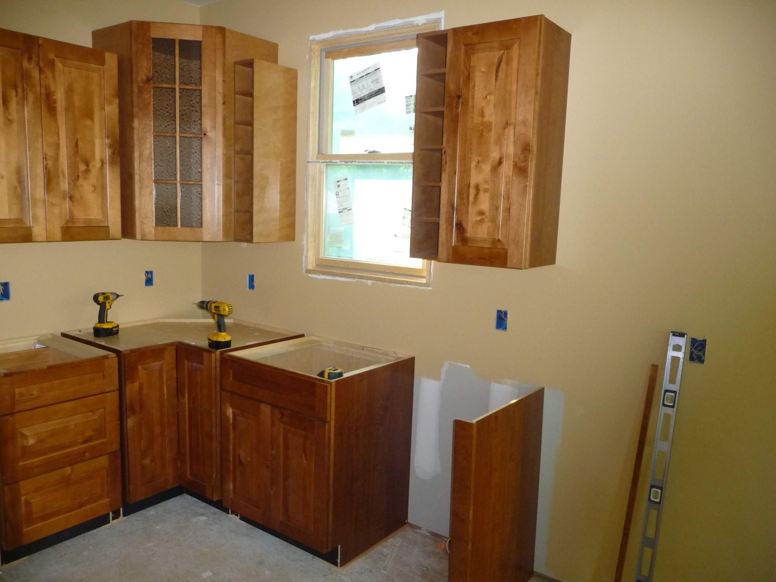

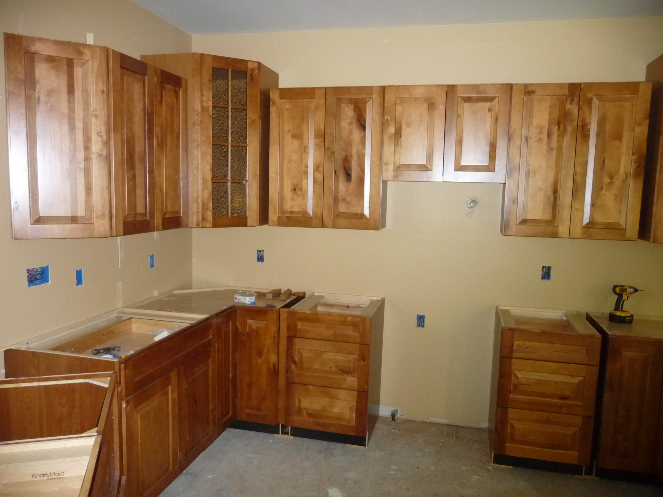

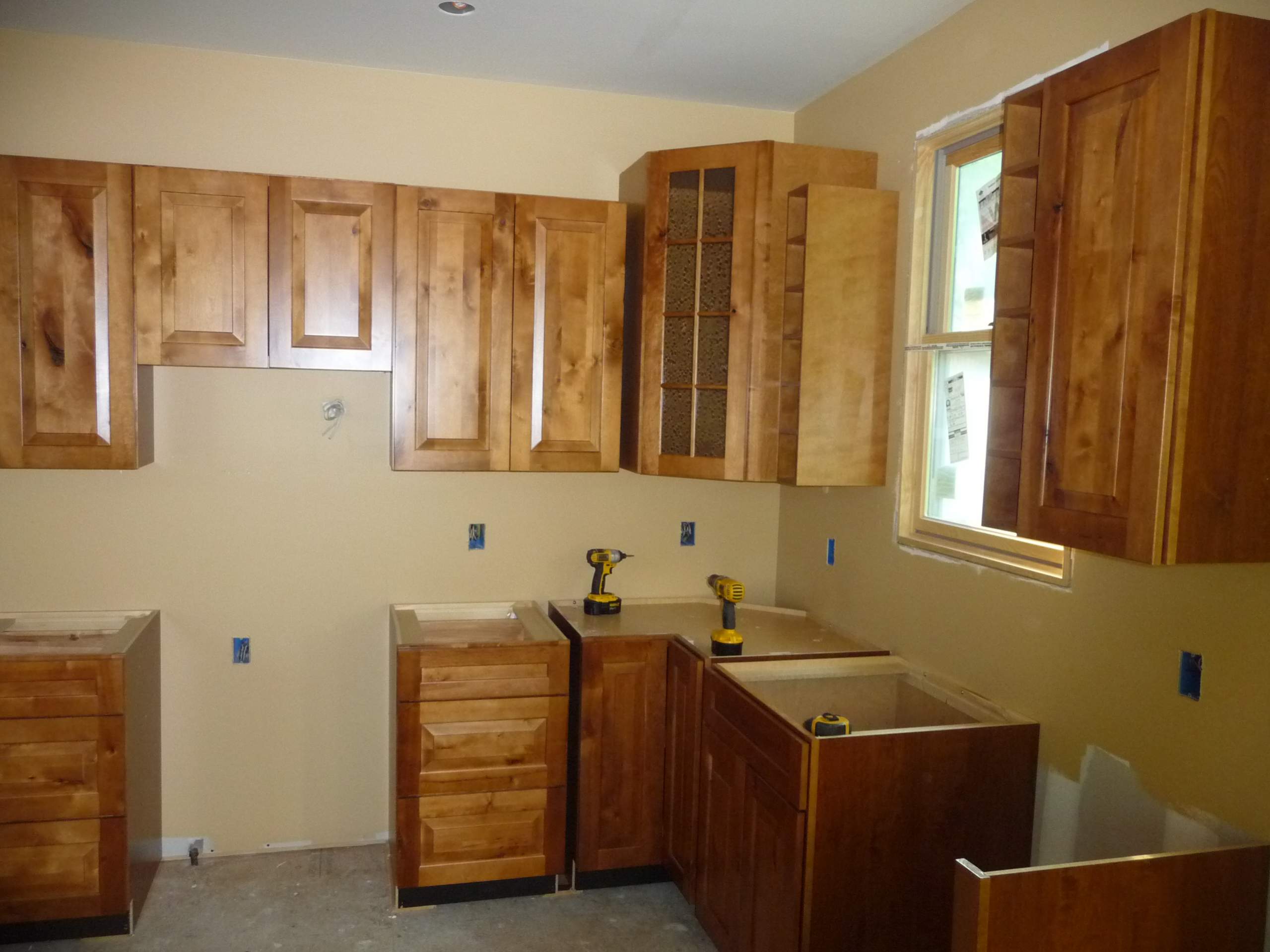

We have primed and painted the kitchen and installed the cabinets. I still need to put the refrigerator panels and over-ref cabinet in. I have to trim down some filler strips between some of the cabinets but my big tools are still in storage, so I will have to go the cabinet shop I help out in sometimes to cut them down. Living like a gypsy sucks :mad:
