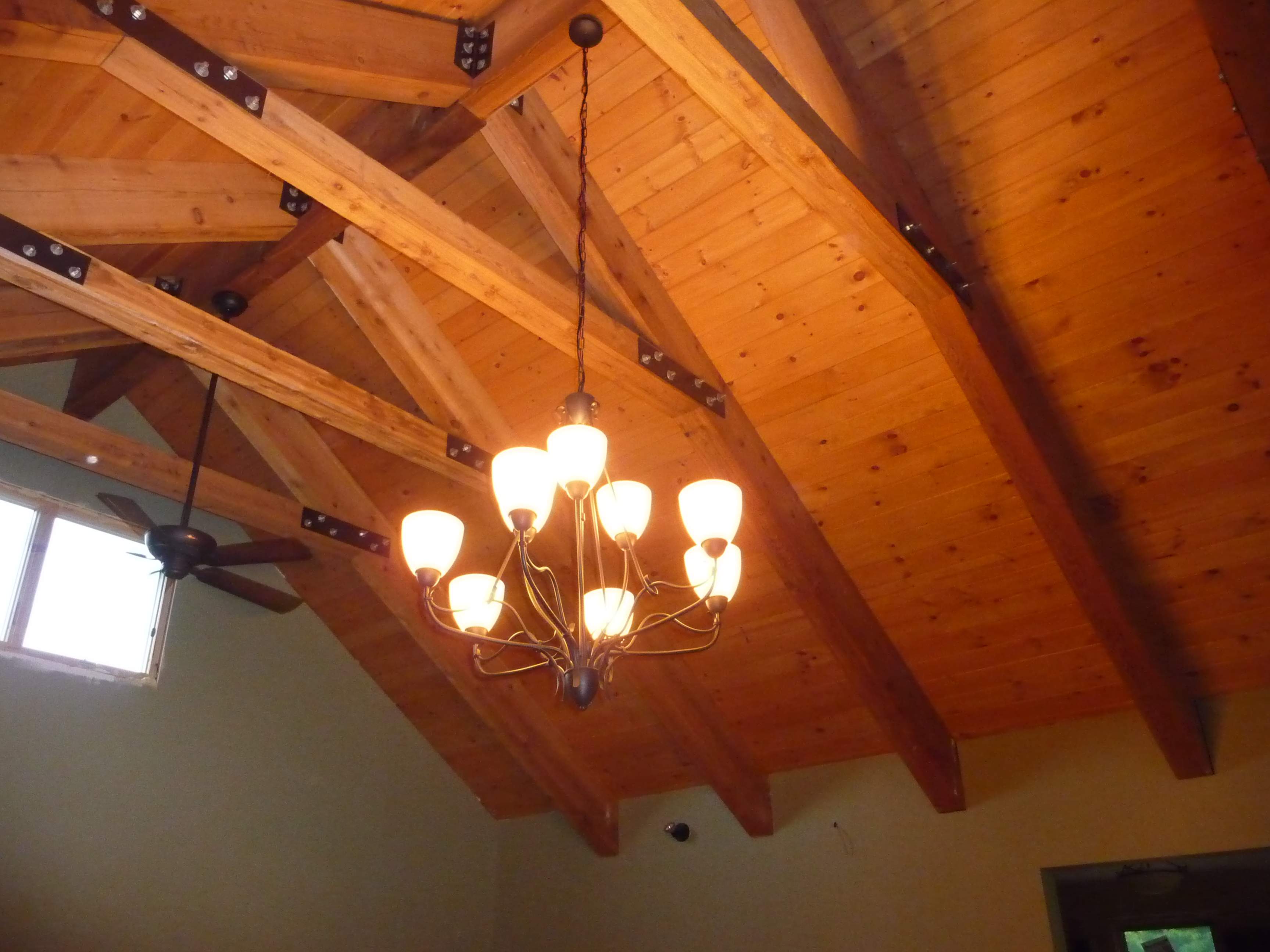

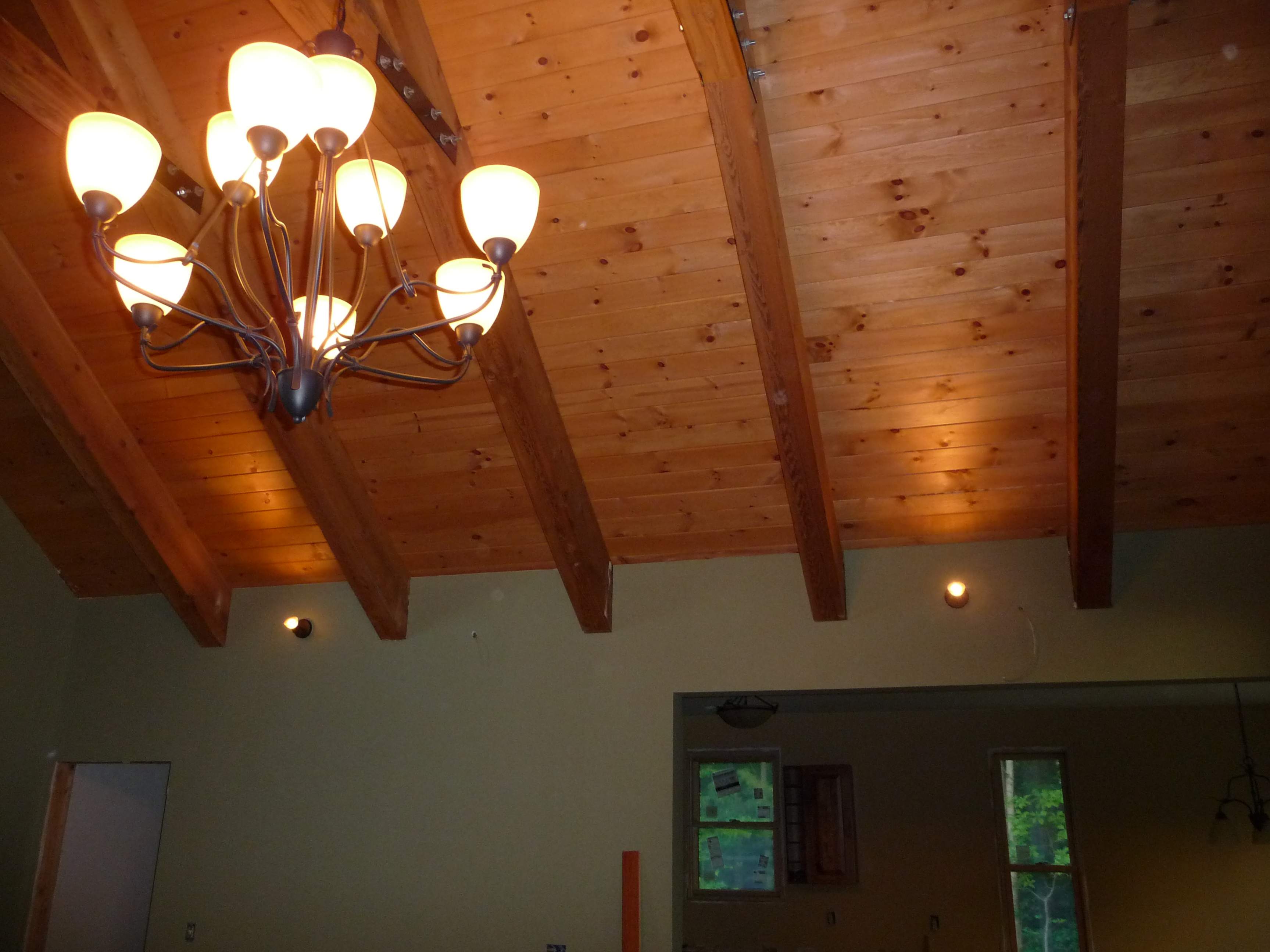

We have been very busy. The electric is finally hooked up. No more generator!! :cool2: And that means AC and lighting and fans! We have been putting up the lighting and turning circuits on as we go.

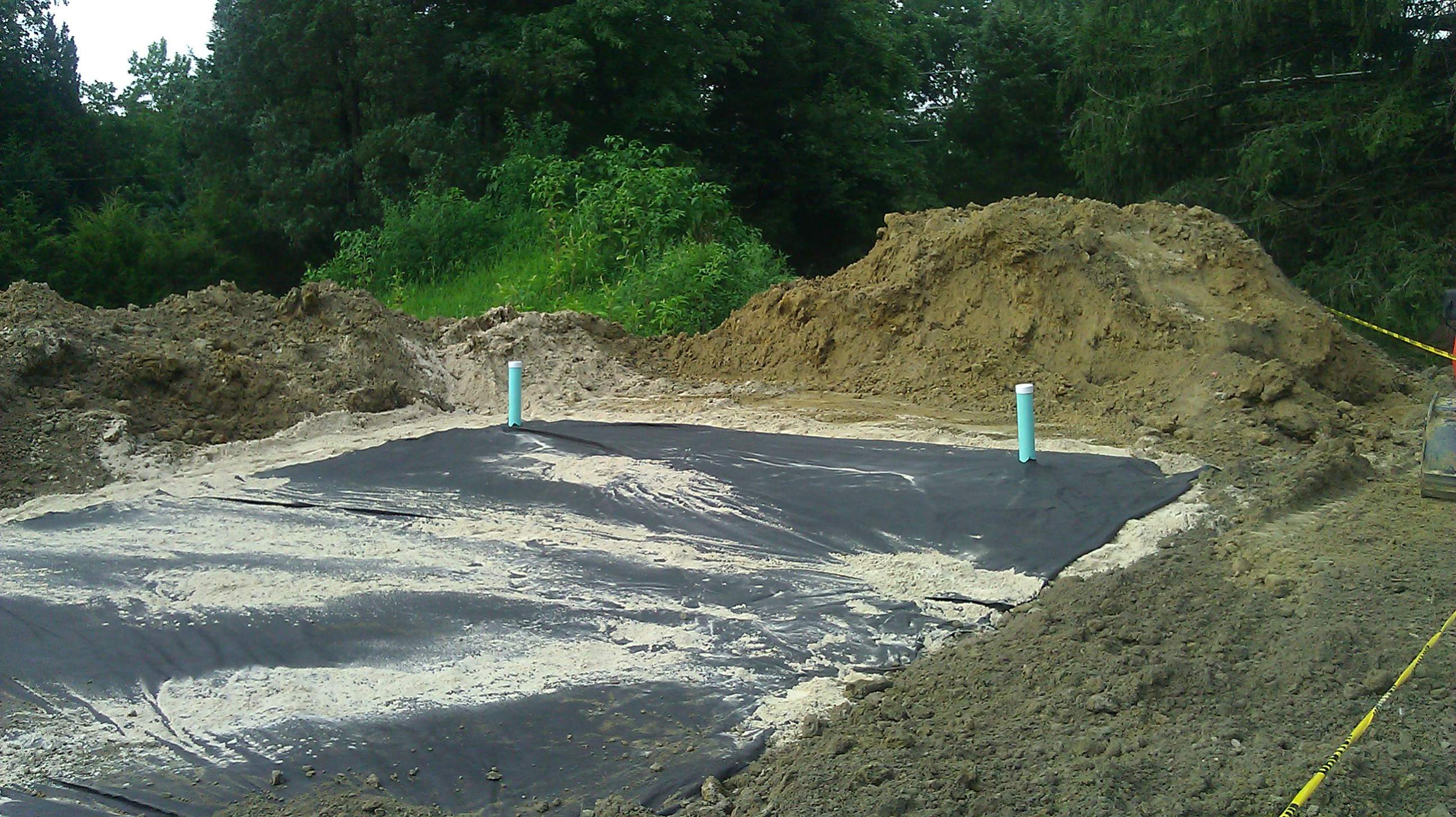

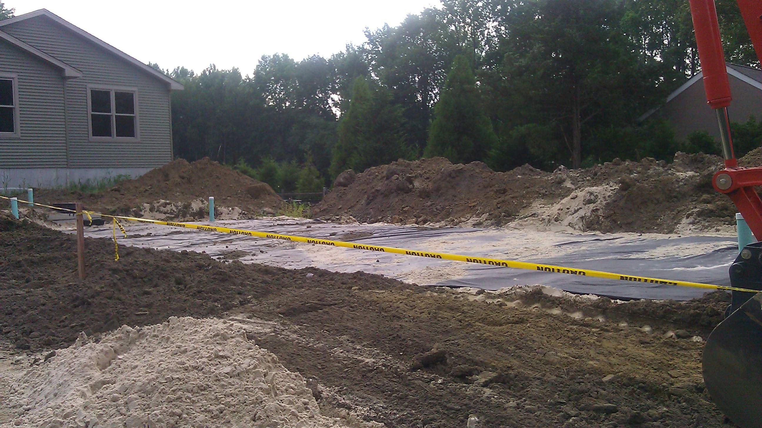

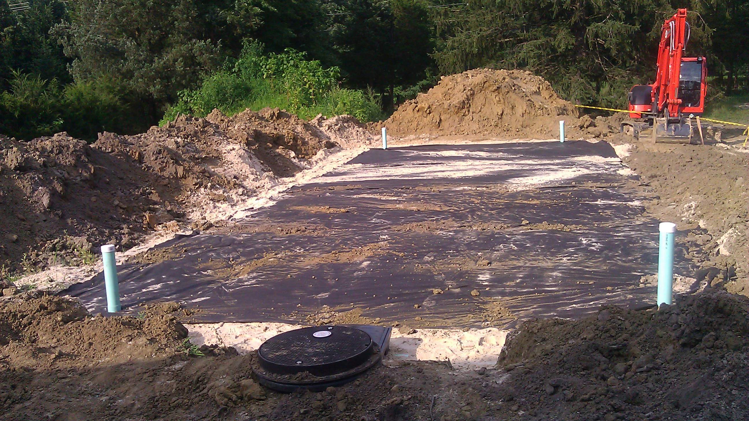

The septic went in over the past few days:

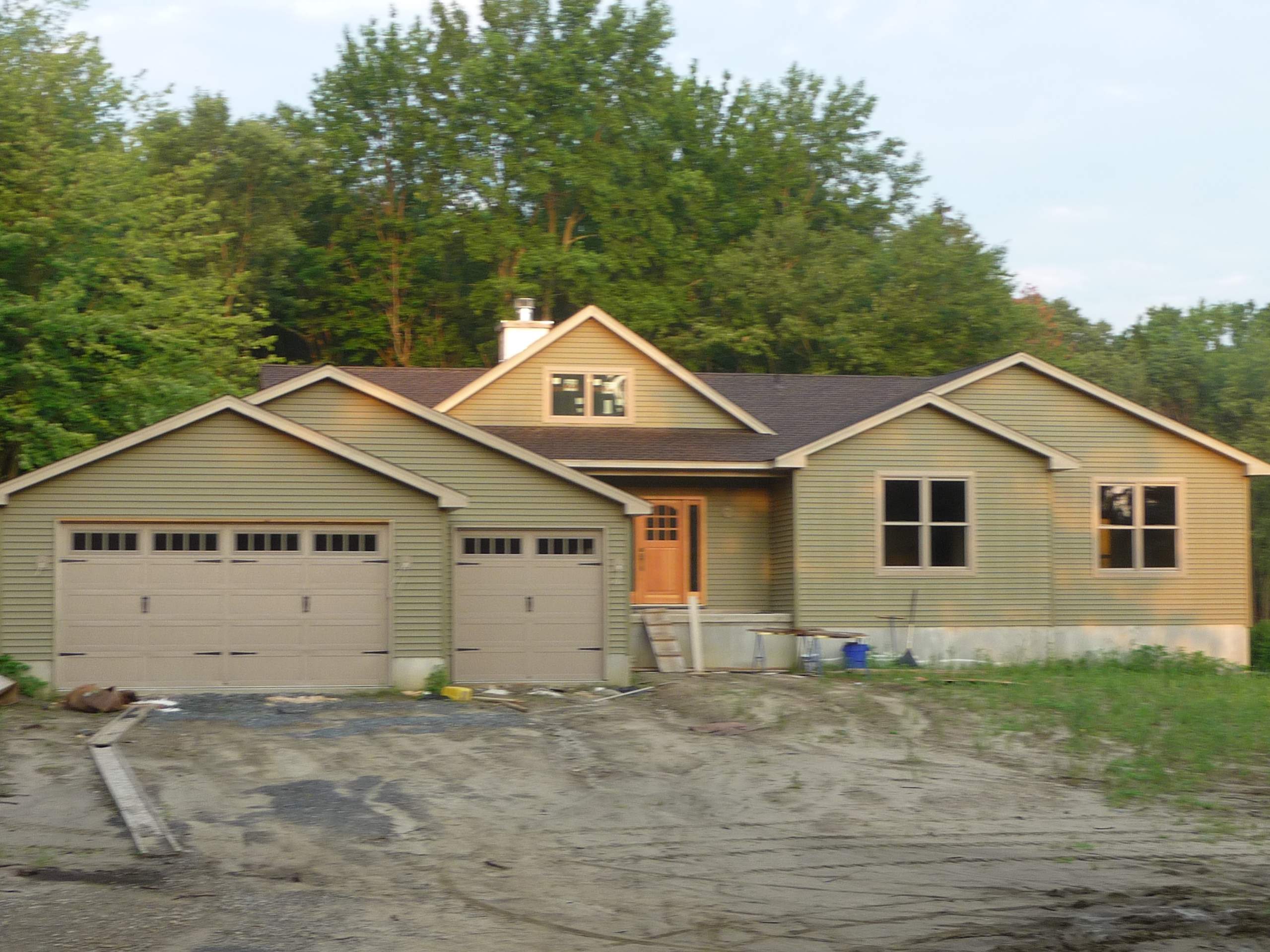

I finished the exterior trim work during the last heat wave.

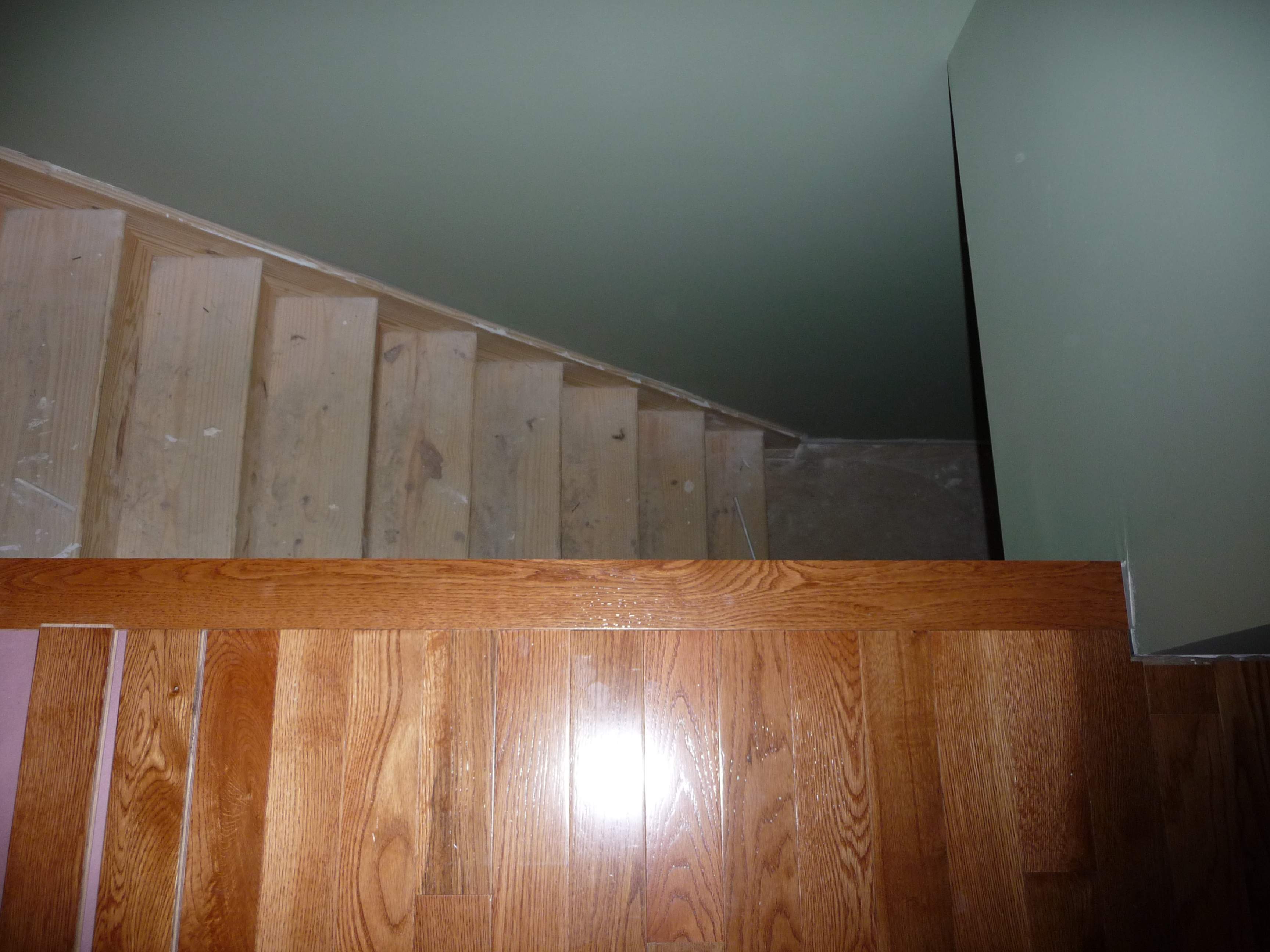

And we have started on the flooring installation.

Things are looking great, the septic system is unique, what type of system is it?
Dave
   / New Home Begins
#577
Dave

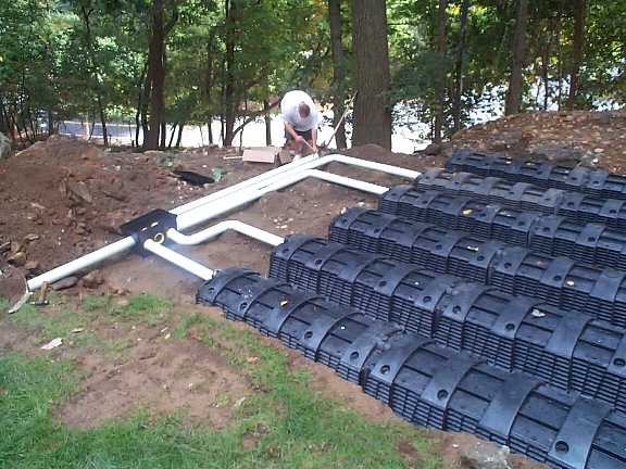

It is a sand mound. 1000 gallon tank leading to a 22' x 49' field. The field is comprised of 6 rows of accumulators. Something like this picture (not ours). It just so happens that we had to have so much fill brought in that they were able to keep the "mound" pretty level with the rest of the ground.
Sorry, I do not have any pictures of the "during" process as I was at work.
   / New Home Begins #578
I was wondering about that. I saw the sand, but no mound. I have never seen one where it did not look like a submarine was buried in the yard. I have always wondered why they don't allow the removal of a large area of original soil and replacing it with sand. That type of system has become very popular in our area. The standards to meet the perc tests have gotten so restrictive that it is often the only way to get a system. It also happens in our area when it is time to replace an existing system. There are people have been in their house for 40 years and suddenly end up with the unsightly mound in their front yard. Do you have any idea how much more that system costs than a conventional drain field? We have had pumped fields at the last 2 houses so that the system can exist in the highest and driest part of the yard. I wondered if the premium (short and long term) of the pumped system is the same or higher than the sand mound. I think our pumped system cost us a $5500 premium!

Tom, don't put anything at the entrance to your great room that people can stumble over. I can tell you from experience that when folks enter that room, they will be lookin' up and not where they are walkin'. That's a beautiful loft ceiling.:thumbsup:

They use that type of drainage tunnels around here, in single trenches.
Are you required to have a filter before the drain feild?
Dave
