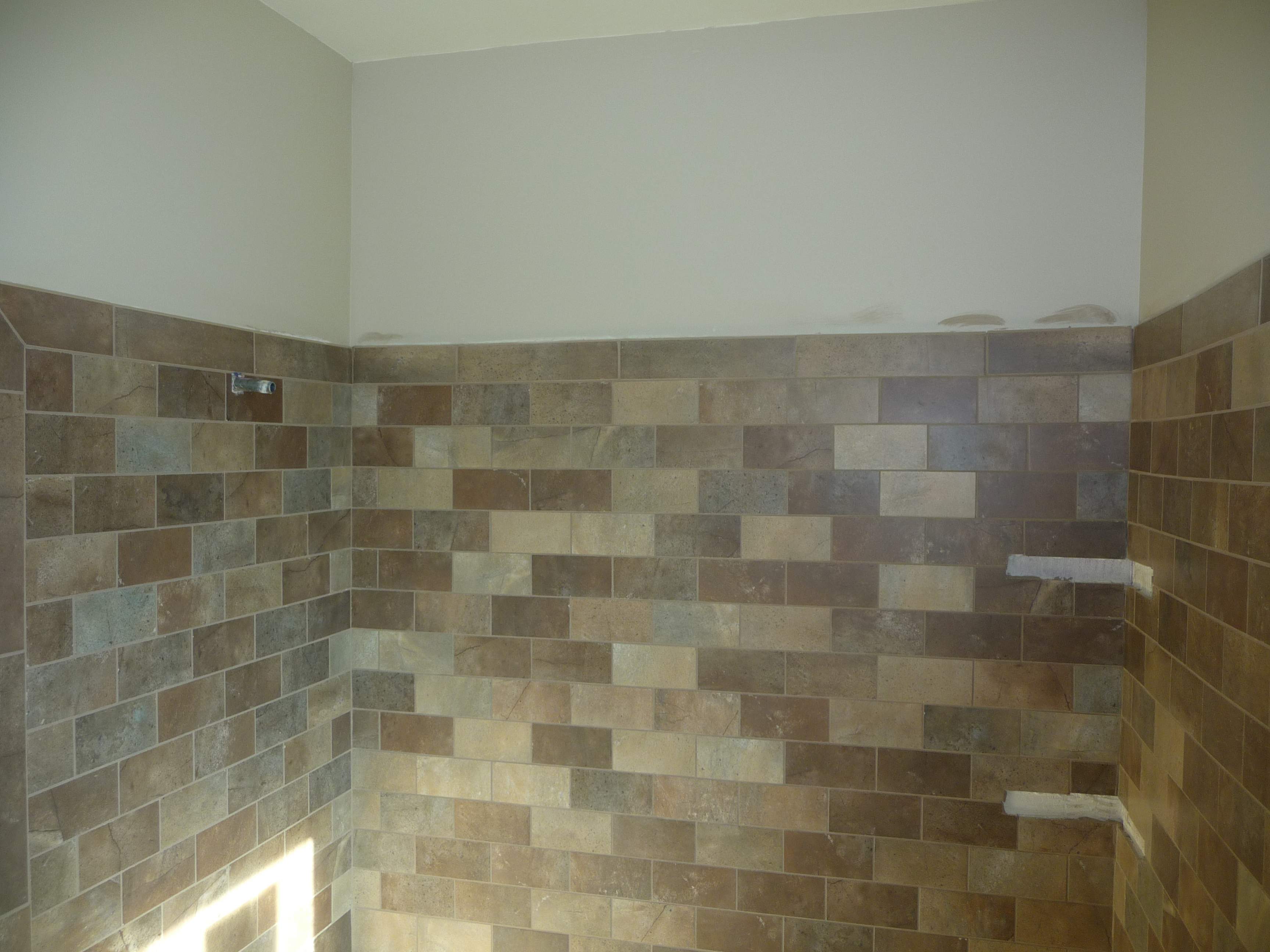

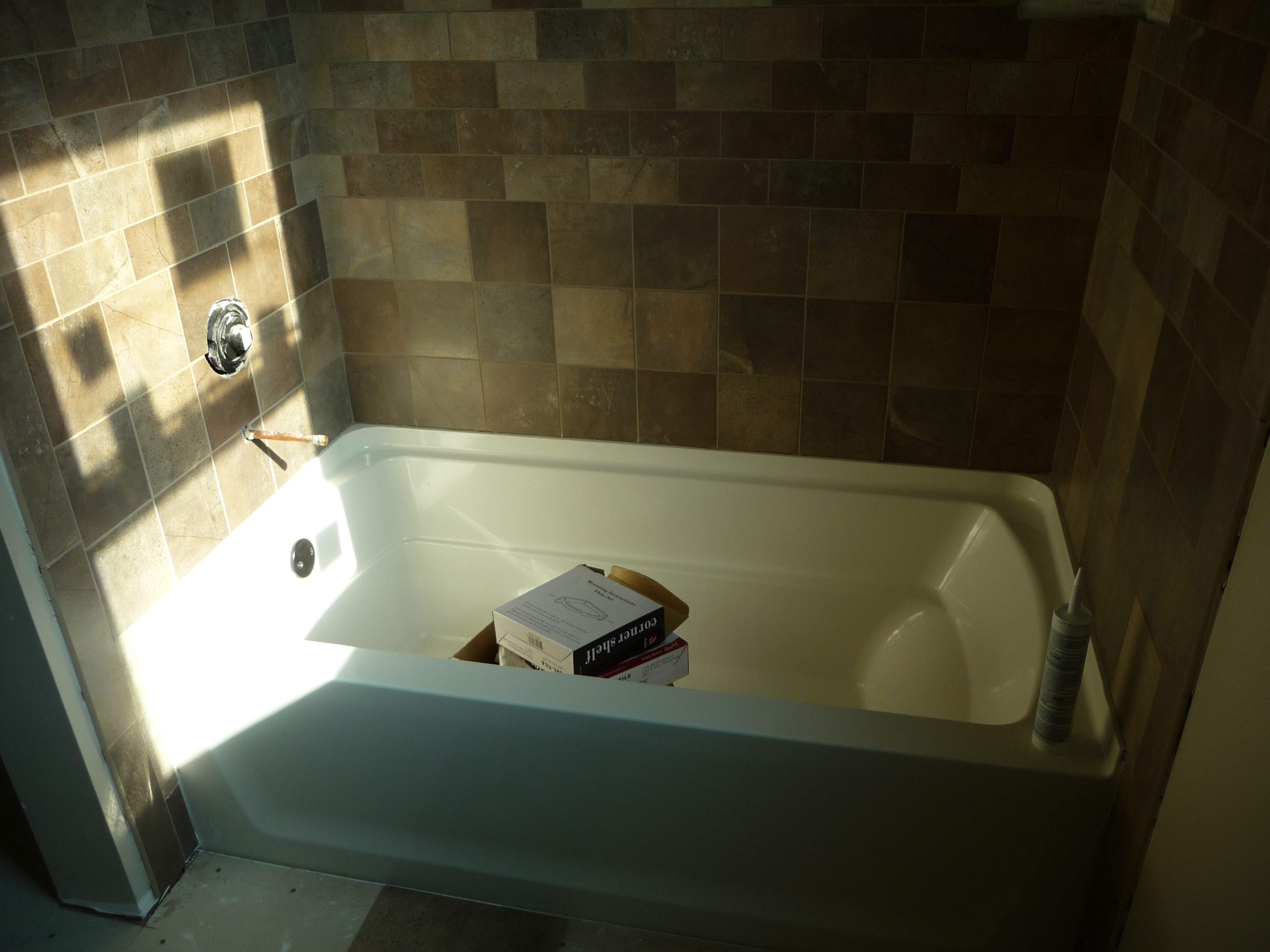

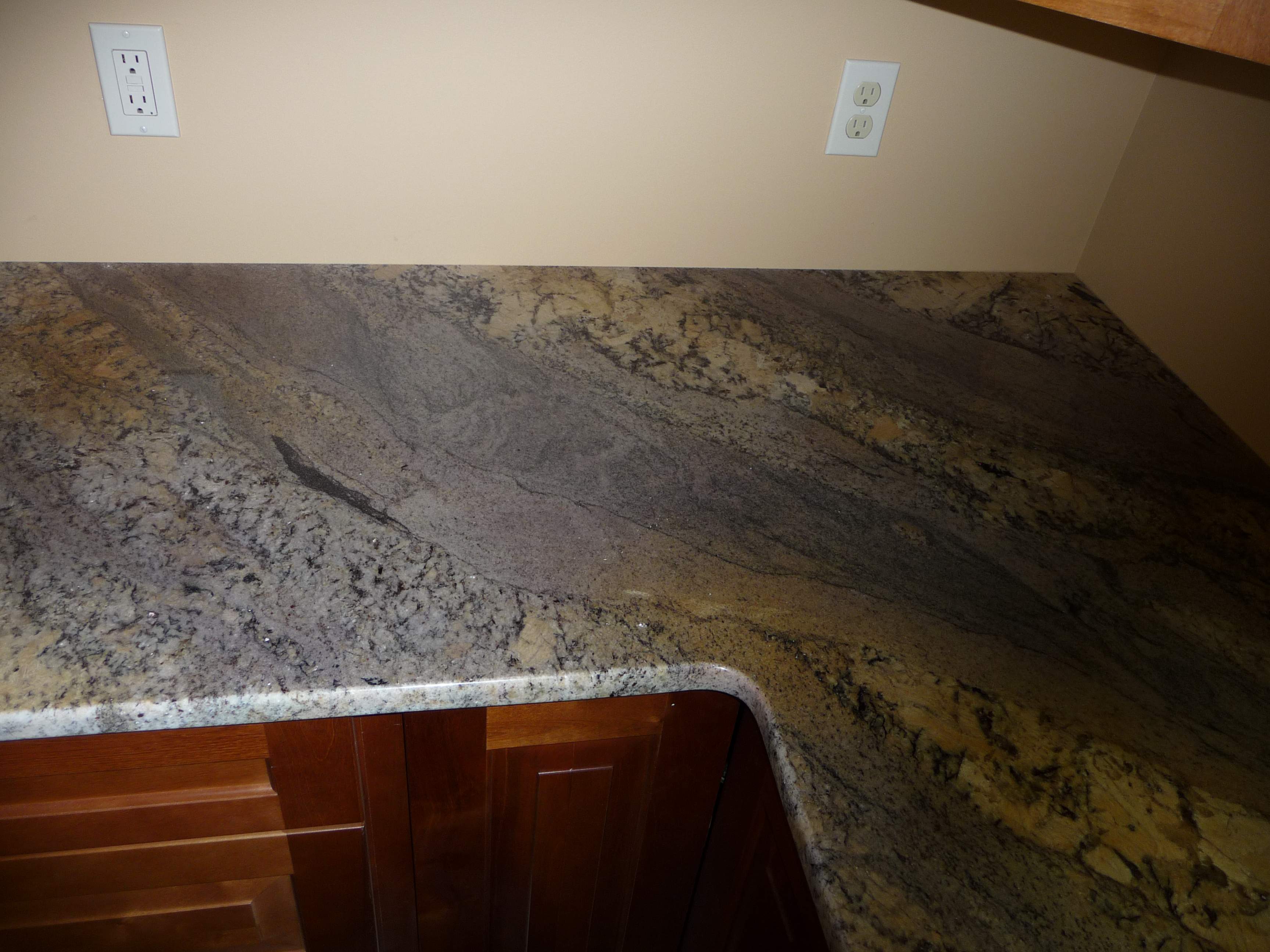

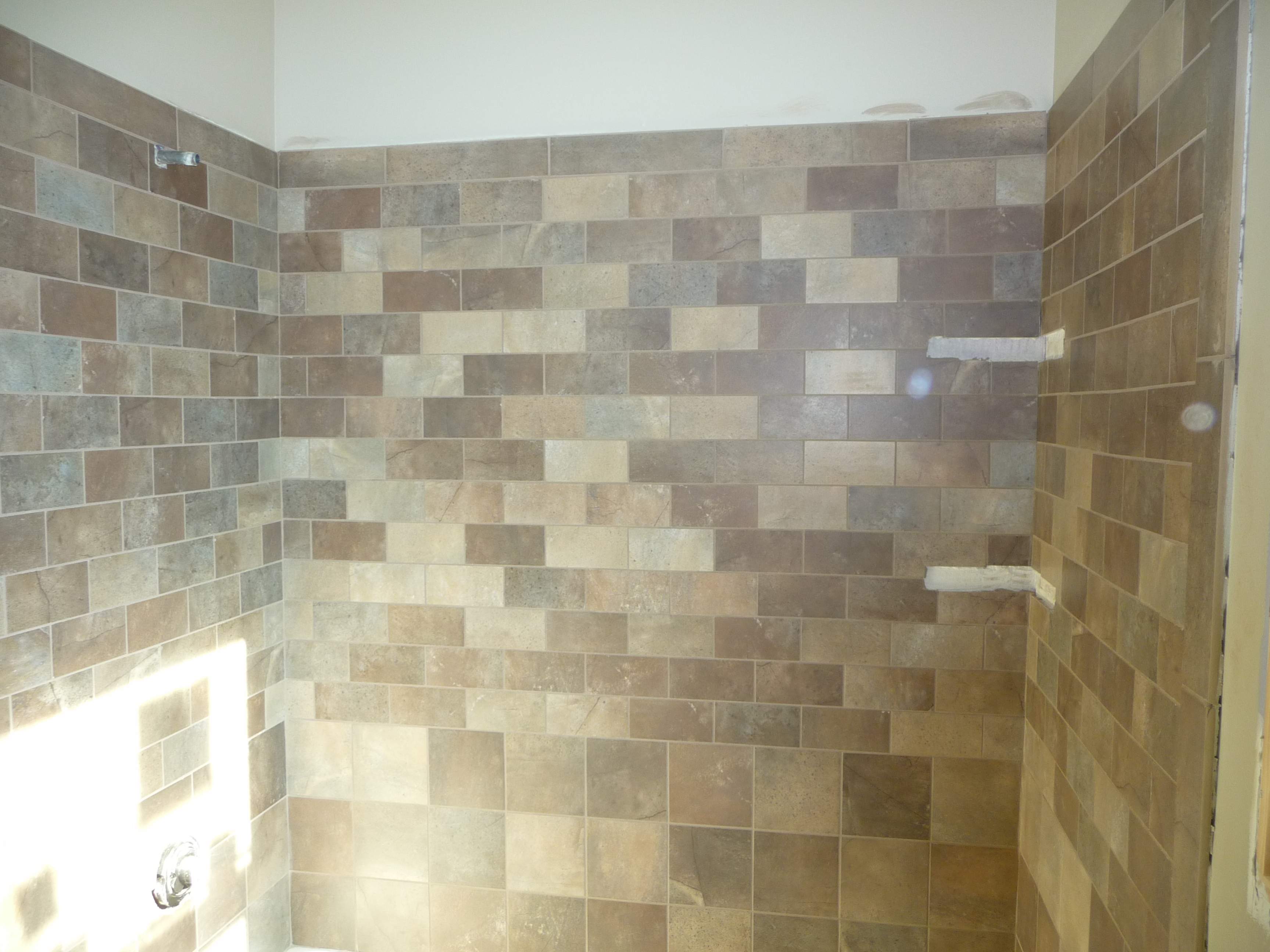

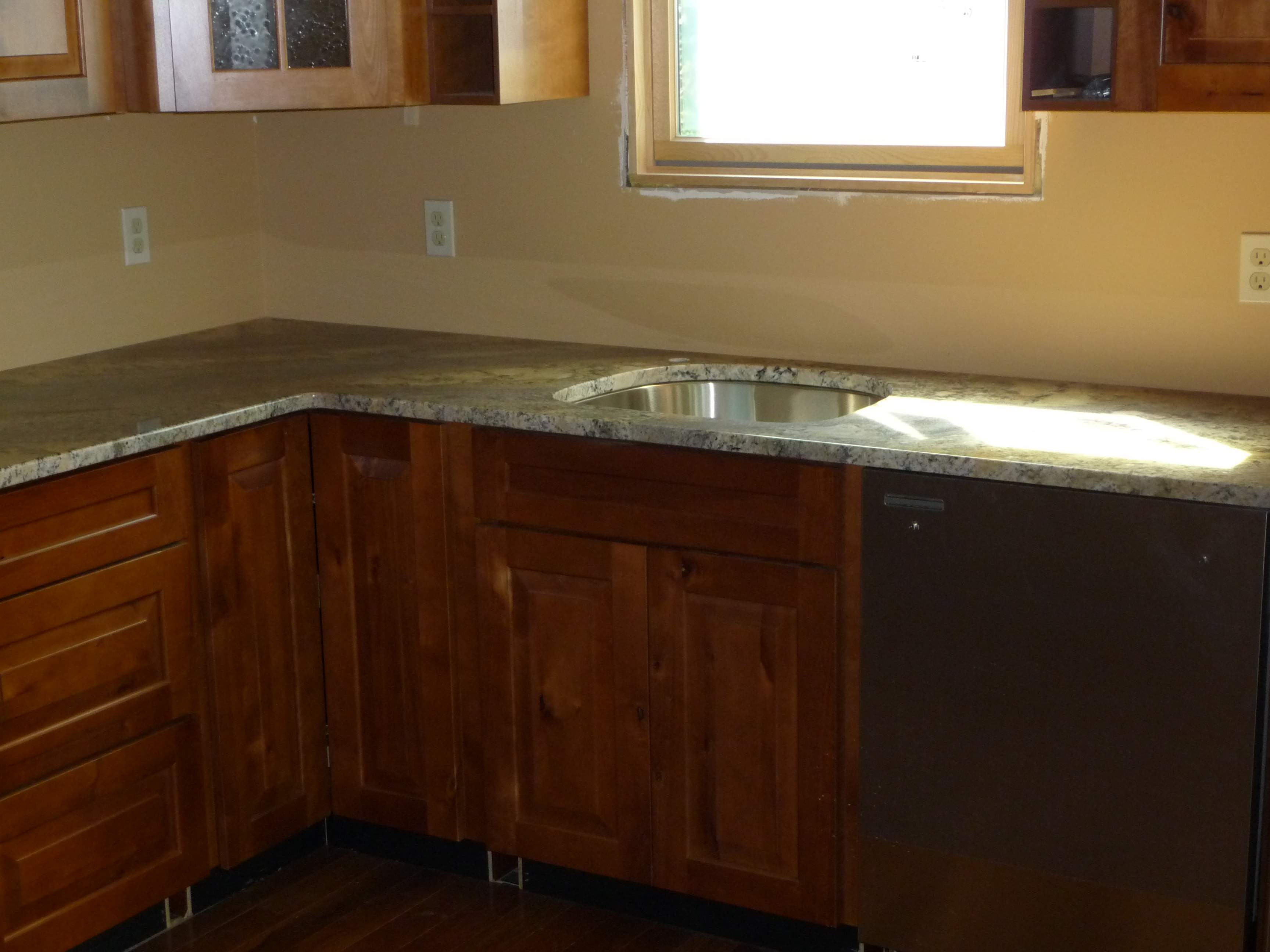

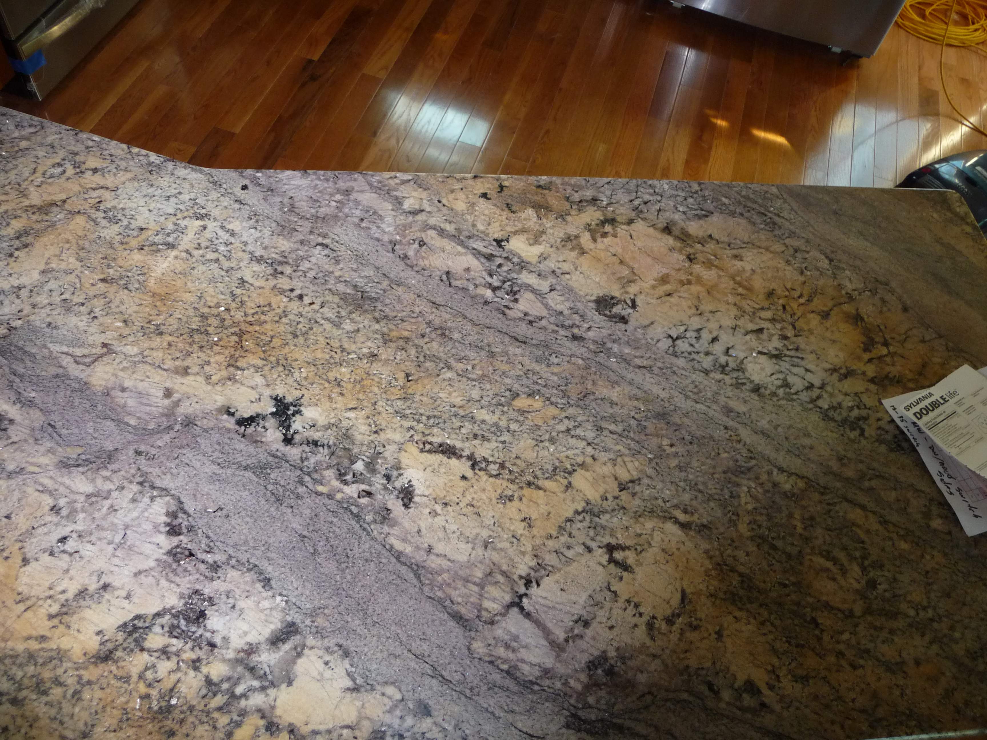

Lots going on but I have been too busy to take photos. All hardwood flooring is in. Kitchen cabinets, spacers, appliances are all in. Only a few electric circuits left to hook up. Granite countertops are in. All permanent lighting is finished. Toilets and vanities are in but still need to hook up the faucets.
P1030070.jpg P1030071.jpg P1030072.jpg P1030083.jpg P1030084.jpg P1030086.jpg P1030089.jpg P1030091.jpg P1030092.jpg
   / New Home Begins #587

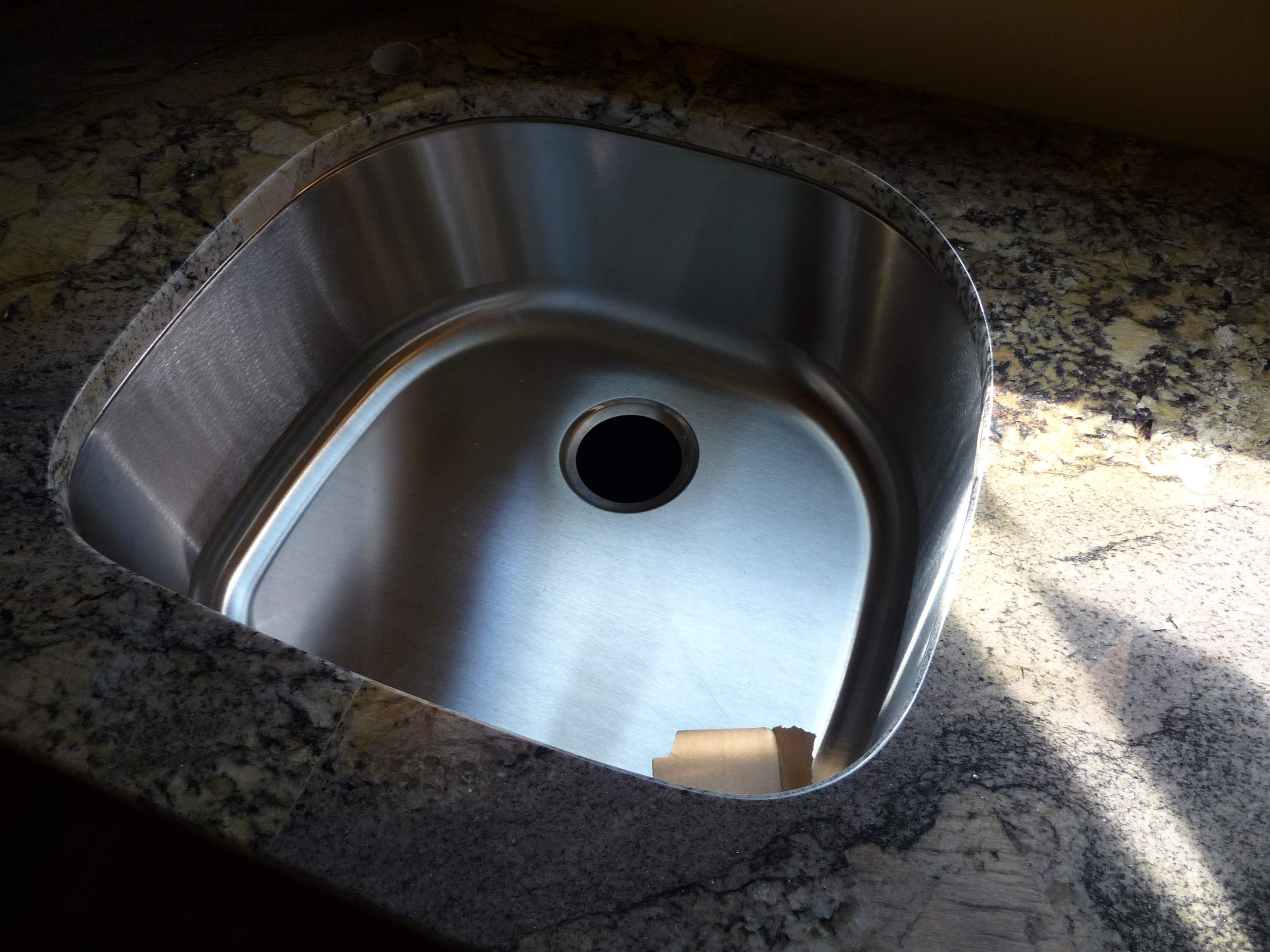

The granite is very cool. Tom, will you put a granite backsplash on also? If not, what will you use that won't clash with that granite? All the pieces are sure coming together nicely. I am a little surprised that you didn't opt for a double sink, but if you rinse and go straight to the dishwasher, a single sink may be plenty. It does leave you with more counter space.
   / New Home Begins
#588
Thanks! Yes, we will be putting in a backsplash after we get in and see what will work best. As for the double sink, there was no room. There is a 36" corner lazy susan, 2" spacer, 27" sink base, dishwasher then refrigerator. There was no way to work in a wider sink. We love the D sink too.

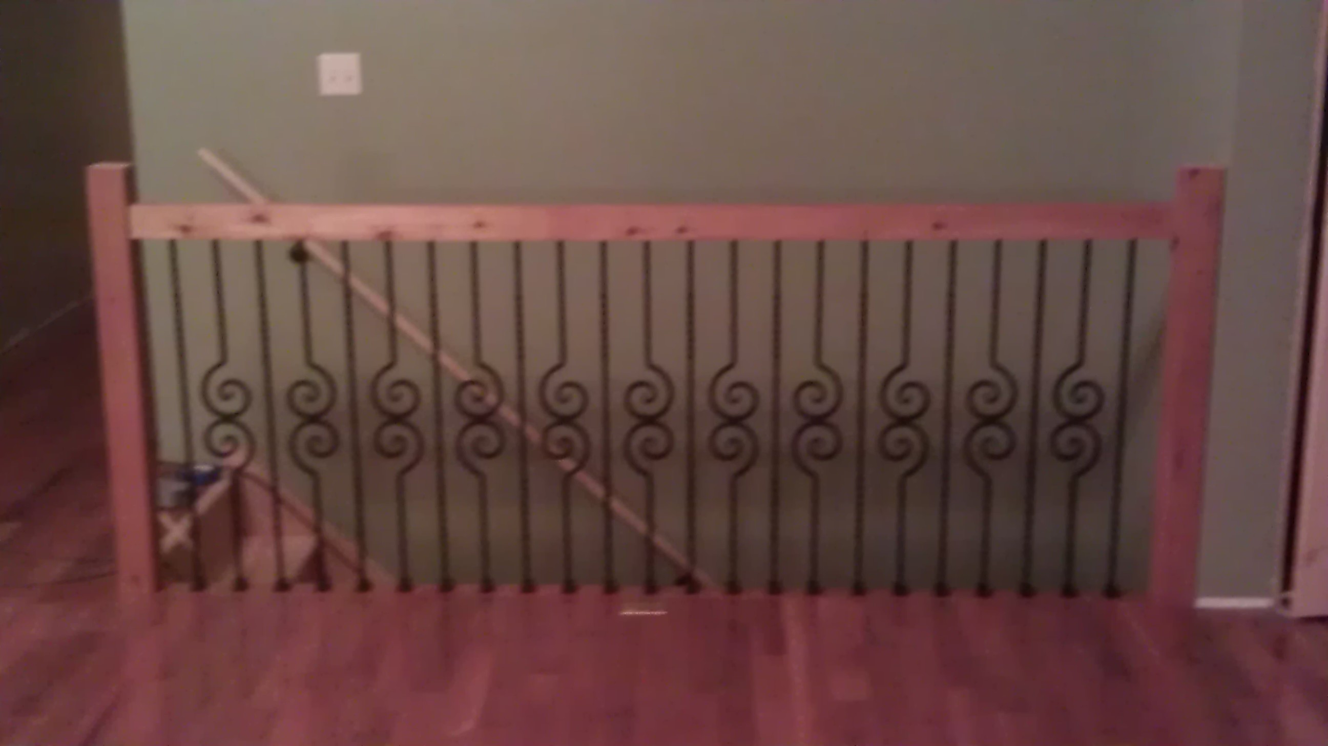

We built the railing protecting the stairs today. Cedar posts and rail, wrought iron balusters. Sorry for the poor quality pictures but that's the difference between a real camera and a smartphone.

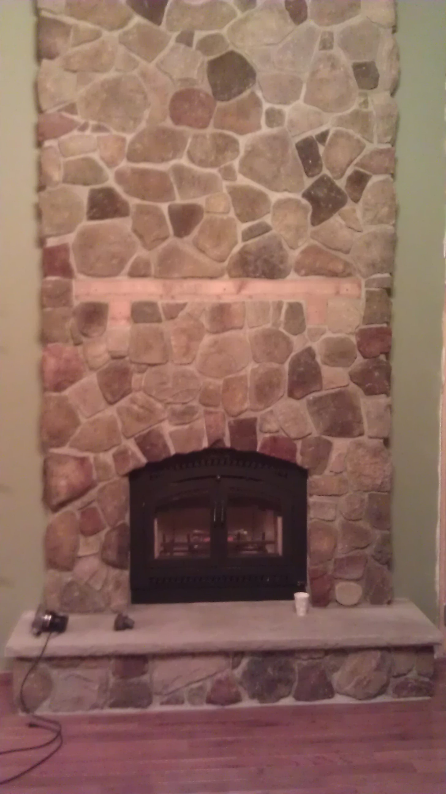

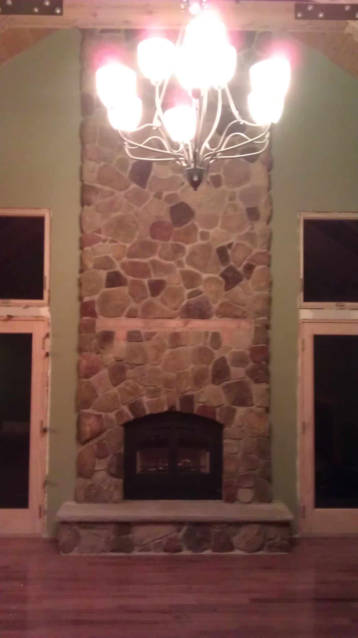

The masons have finished the fireplace. The wood in the wall is the placeholder for the real mantel that is not in yet. It will be 4" x 8" x 56" with some small corbels under it. Sorry for the tilted photo.
