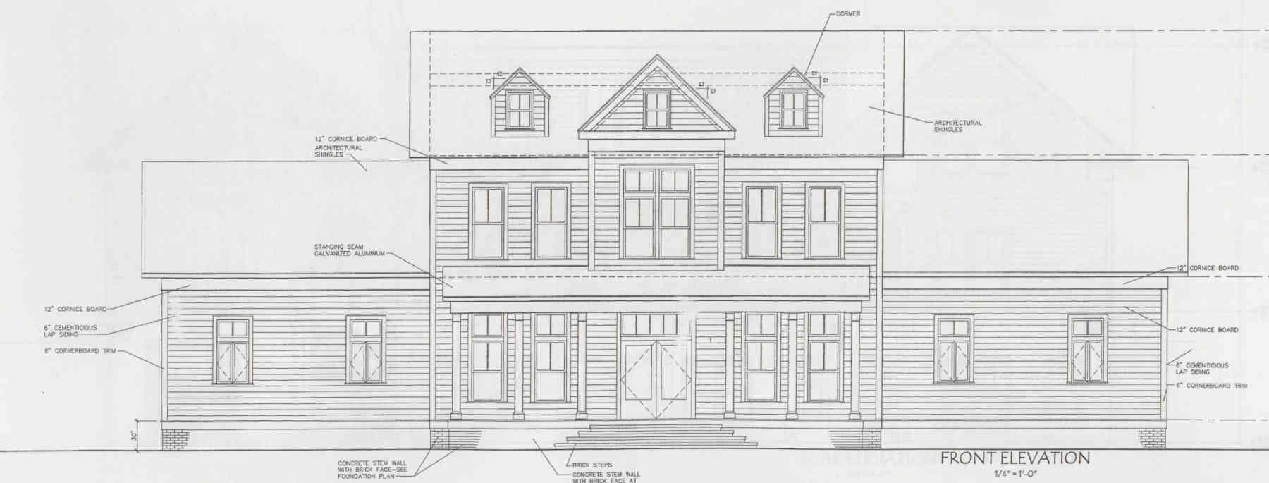

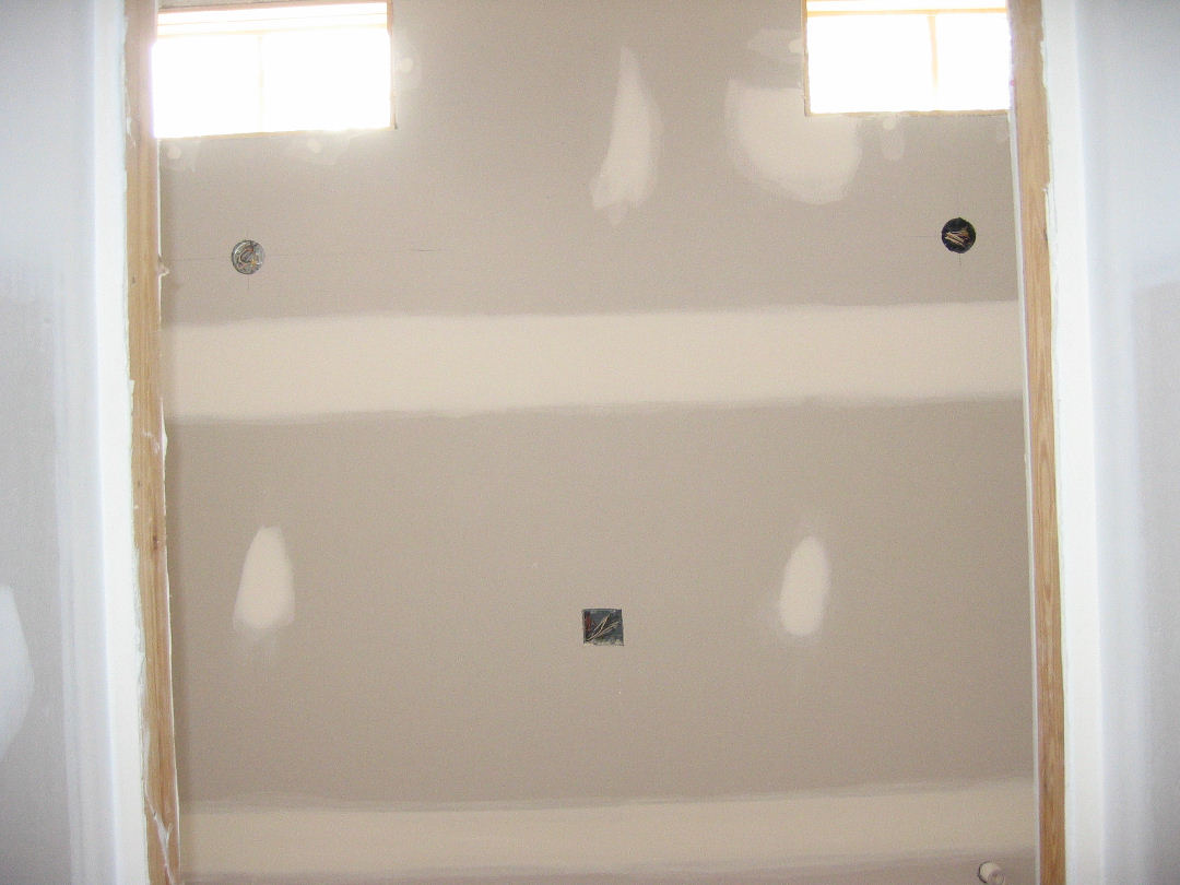

One week of construction has passed since my last photos. In that discussion, I told y'all about the problem with the ceiling height in the guest bedroom / bathroom on the second floor and that the framer's solution was to add a knee wall to raise the roof. I honestly don't think there was another reasonable alternative to solve the problem so we proceded with this "fix" to the poor design.
Well, I can't say that I'm happy with the result. It certainly accomplished our goal as far as the interior space is concerned. We now have living space in the guest room with ample ceiling height. The problem is the effect this has had on the exterior elevation of the front of the house.
This first attachment is a diagram of the front elevation, as the home was supposed to look. We told the architect that we were looking for a "farm house" appearance (whatever that might mean) and I think she achieved the general look we seeking. Sadly, the design could not accomodate the floor plan she included.
   / New Home Construction
#156

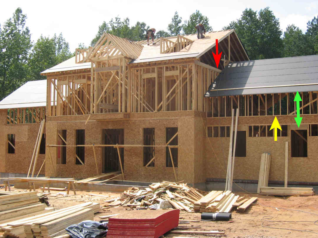

This photo shows the front as it stands today. The red arrow on the left shows where the peak of the roof on the right and left wings wre supposed to be. The yellow arrow shows where the level of the eaves were supposed to be.
We think that the character of the house has changed. To me its looking more like a colonial style (I'm not very knowledgable about various architectural styles so forgive me if my interpretation is off here) rather than a farm house. Now, that may be an insignificant issue to many (if not most) of you, but it is somewhat disappointing to us.
The real issue now, however, is not that the style seems different to us, but something just looks goofy. I think it is because the distance from the top of the windows on the main floor to the new level of the eaves is too great (depicted by the green arrow). Keep in mind that the house will be clad in Hardiplank siding. This just looks like too much bare siding with no visual interest. Maybe I'm being too picky, but it just doesn't look right to me.
I've discussed this with the builder. He will talk to the framer as soon as weather permits a return to work (don't yet know what effect the hurricane will have on our weather yet - it is looking better for us). If they can't come up with something to break up this expanse of siding, I guess the next step is to hire another architect to get some creative ideas.
It probably seems like I've done more complaining than anything in this thread. It is not my intent. Early on, it was suggested that I post the problems, mistakes etc. so that others may learn from them. I guess I'm just doin' a whole lotta teachin'.
We are very happy with our builder and the interior spaces (given the limitations of the design). It is ultimately going to be a very nice home (better than we deserve). I just hope the corrections of the architectural snafu's don't break the budget (more than it has already been broken).
If anyone has any suggestions for the front facade, I'm all ears. The things I've come up with thus far include additional windows, maybe some dormer-like bump-out things (like in the center section). But, these may just add to the goofiness or be impractical. I really have no clue. I will appreciate any input on this.
Note: the problems and arrows are depicted on the garage end due to the angle of the photo. The need for the addition of the knee wall came from problems on the opposite end of the house where the guest room is.

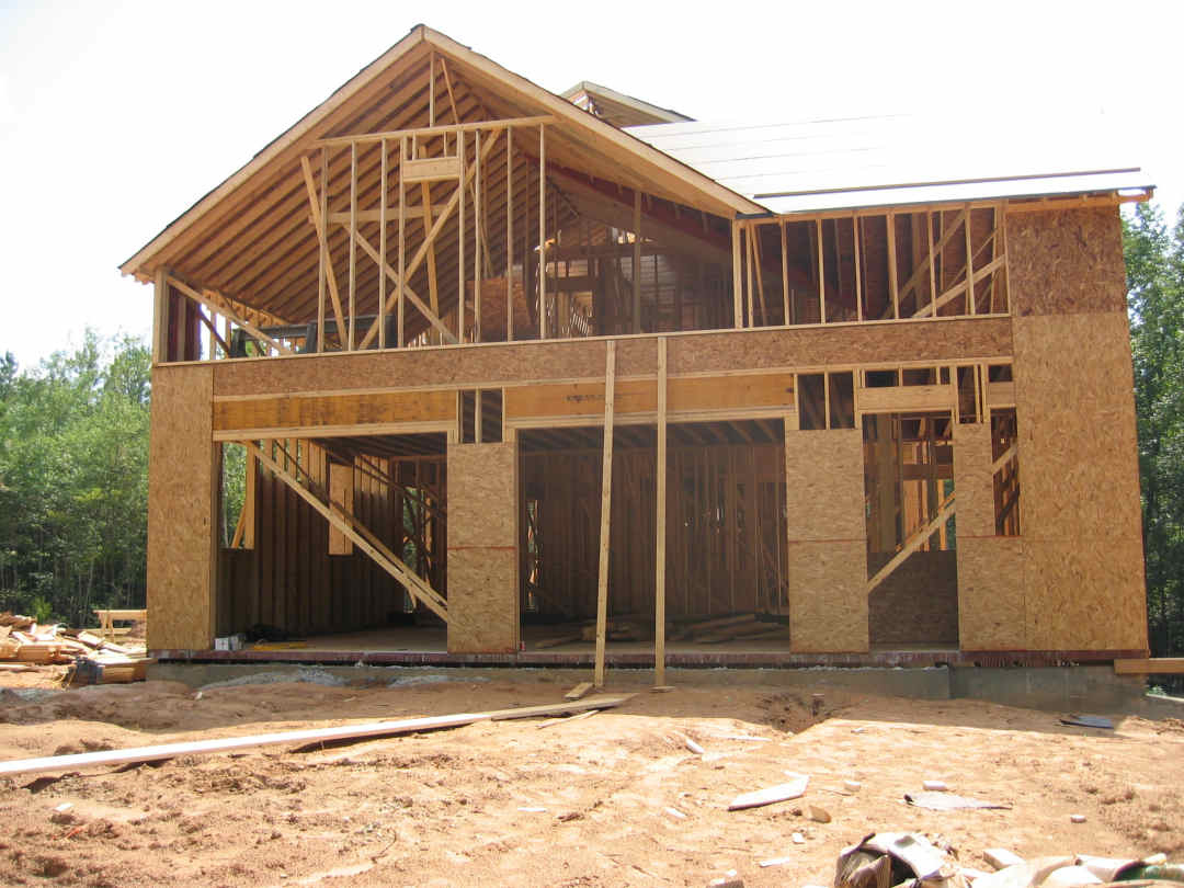

Here's my obligatory view from the garage end. As we really didn't need any more living space, this will be our unfinished attic (I think I mentioned that before). Now, I think one should recognize blessings whenever they occur. So, here is a positive consequence from the elevated roof (in addition to the fully functional guest room). A HUGE storage space in the attic. The framer had planned to add partition walls in this space to support the roof. I asked what it would take to leave the space open, to which he replied "big beams". I got the price for the beams from him yesterday and told him to "beam me up". So all of this space will be open for tons of storage and easily accessible from the second floor (just walk through a door - no pull-down steps or ladder to climb).
I think I mentioned earlier that I had hoped to put the air handler of the second floor in this space. The builder nixed this idea as it would reduce the efficiency of the unit being off to one end of the house like this. He says it need to be more centrally located. So, up in the attic (the real attic above the bedrooms on the second floor) it goes. Being totally ignorant about home building gives me freedom to ask rediculous questions. Every once and awhile, my requests are doable and it makes a positive change in the plan.

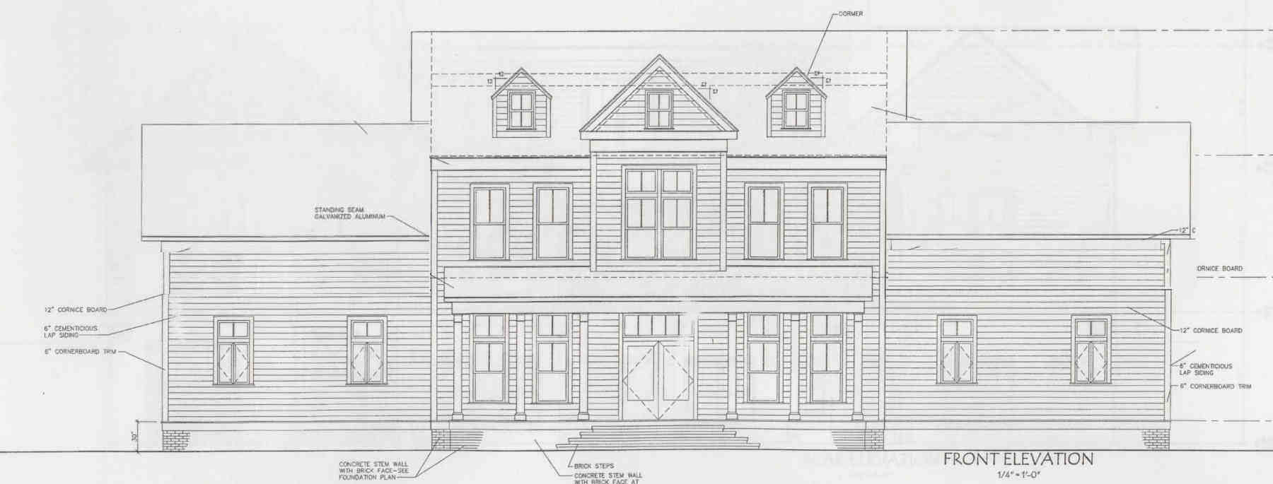

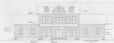

Not to belabor the point, but I've done a crude "artist's rendition" (and I use the term "artist" very loosely) on the front elevation to (a) see if my concerns are warranted and (b) maybe better illustrate to you folks what I've been blabbering about.
This attachment is a rough approximation of what i think we will end up with without any additional changes. I don't know, maybe it lends a lack of sophistication of design that would be found in a true farm house.
Any comments?
   / New Home Construction #159
My taste is all in my mouth, so you can take this with the proverbial grain of salt, but I think the "new" version you drew looks more like a Southern farmhouse than the architect's orginal plans. The blank areas make it appear to have very high ceilings on the first floor, which is kind of neat because behind that blank is actually the flooring for the second floor -- which is disguised because it doesn't look as if there is a second floor at that point. Kinda neat, actually. And, it looks as if you ever finished that "storage" area, you could hold square dances up there...
   / New Home Construction #160
Okeedon's got a pretty good eye. I might suggest that you consider carrying the porch across the front of the house further to each side. Either to the last window or between the middle of the two windows. This will help break up the height issue with the porch roof and give it more of a farm house feel. The other thing to look at might be the design of the columns. Your drawing suggests somwhat large stately square columns which is consistant with the colonial style. Narrower columns with a railing will soften up the front and give it a somewhat more country feel indicative of the farmhouse style.
This is a sample for illustrative purposes. In your case I would stop the porch as I had mentioned above.
Here is another sample.
The joys of construction.... /forums/images/graemlins/smirk.gif
Good luck with your project.
