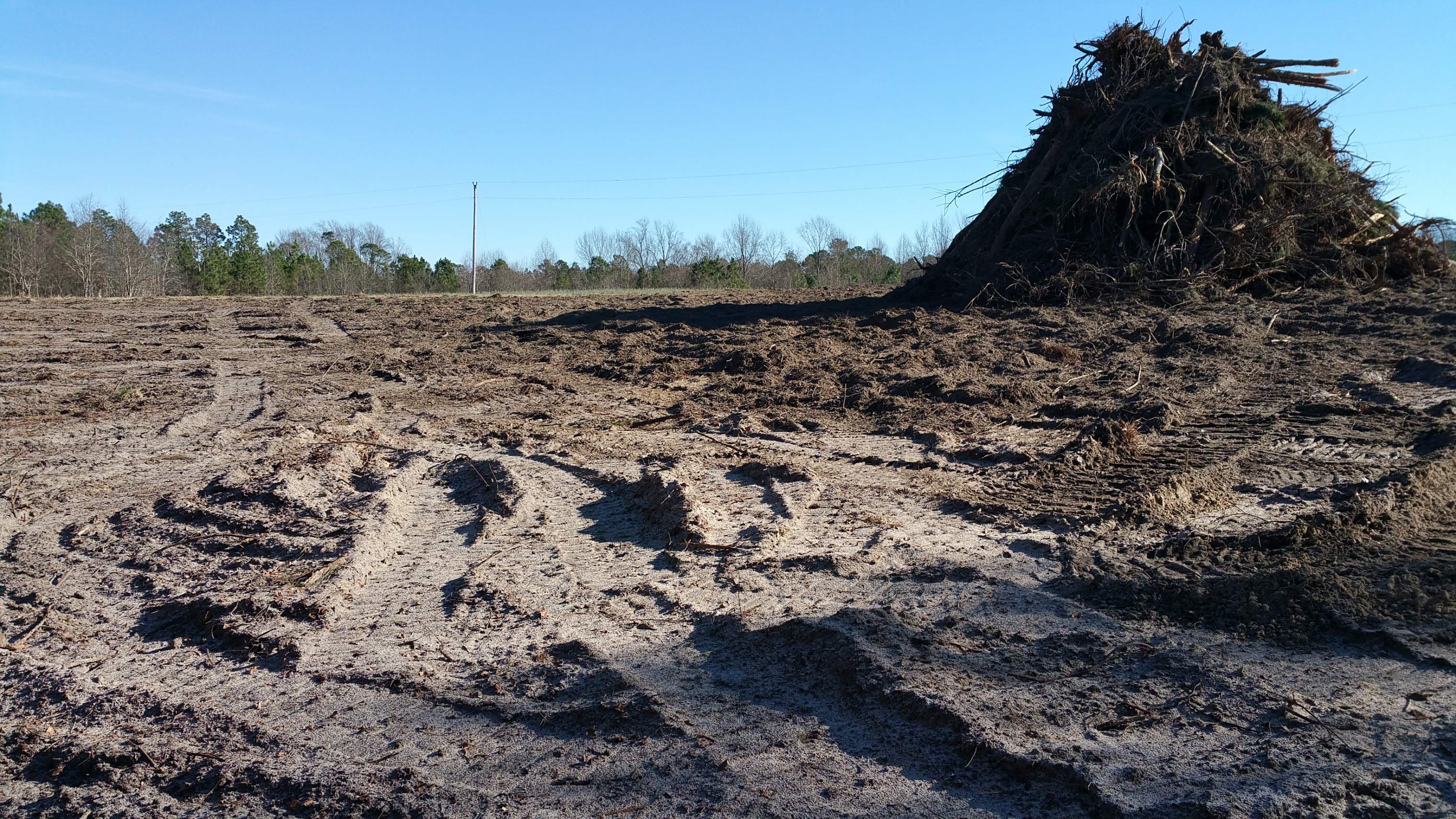

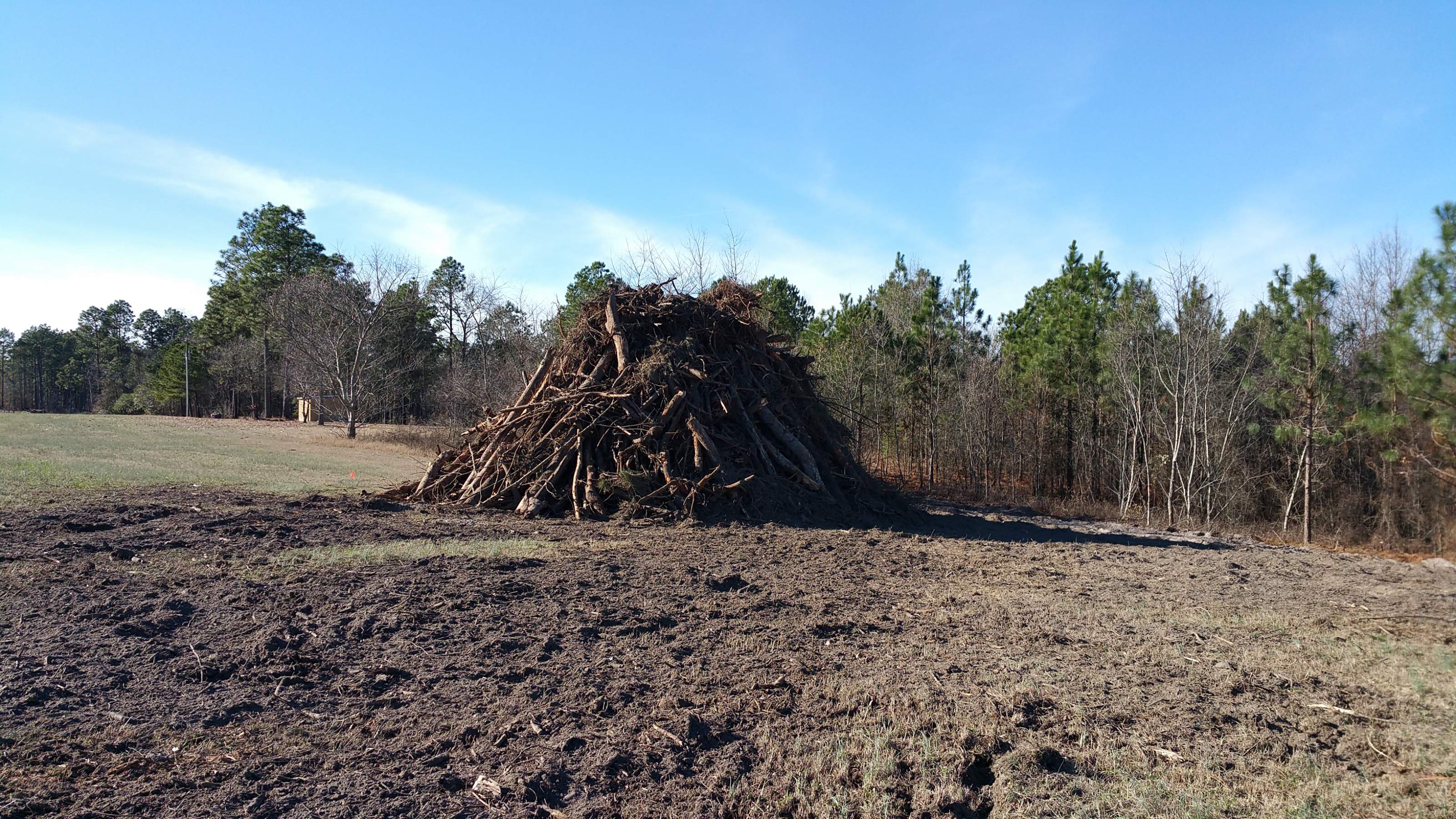

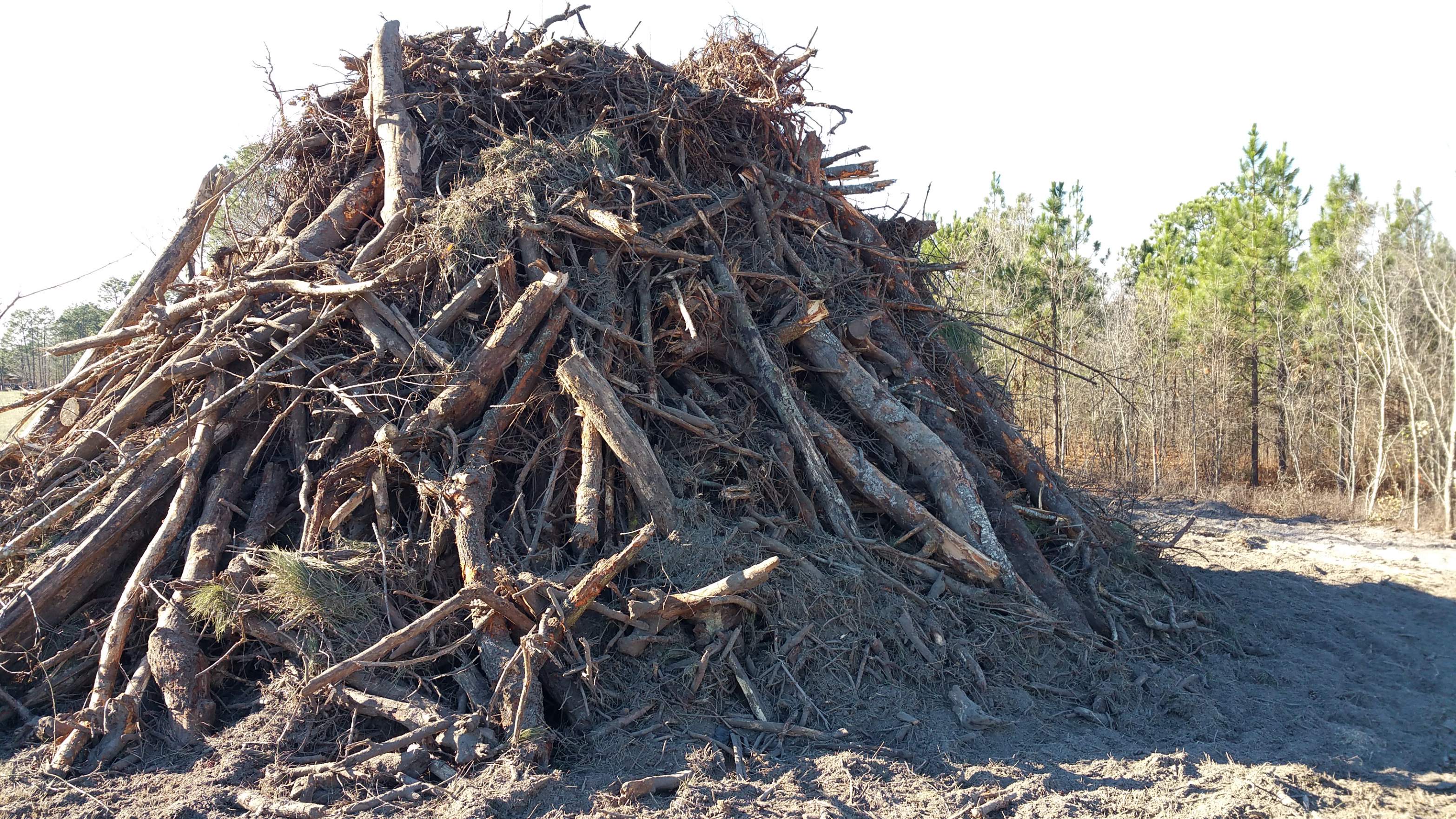

Minor progress - they got the burn pile ready to go. They did a pretty good job of stacking it all up!

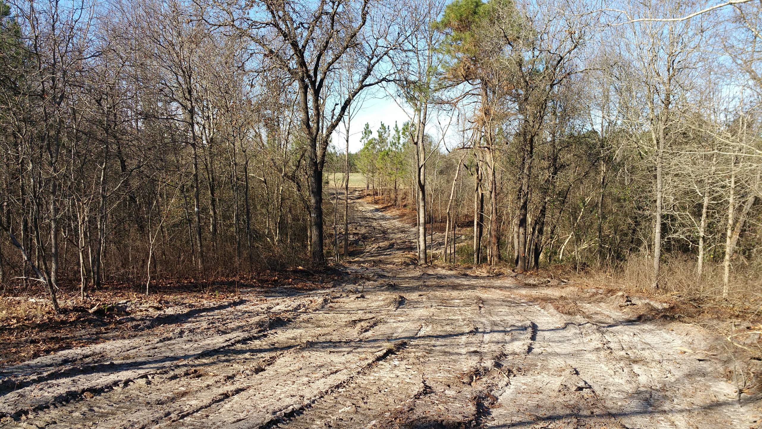

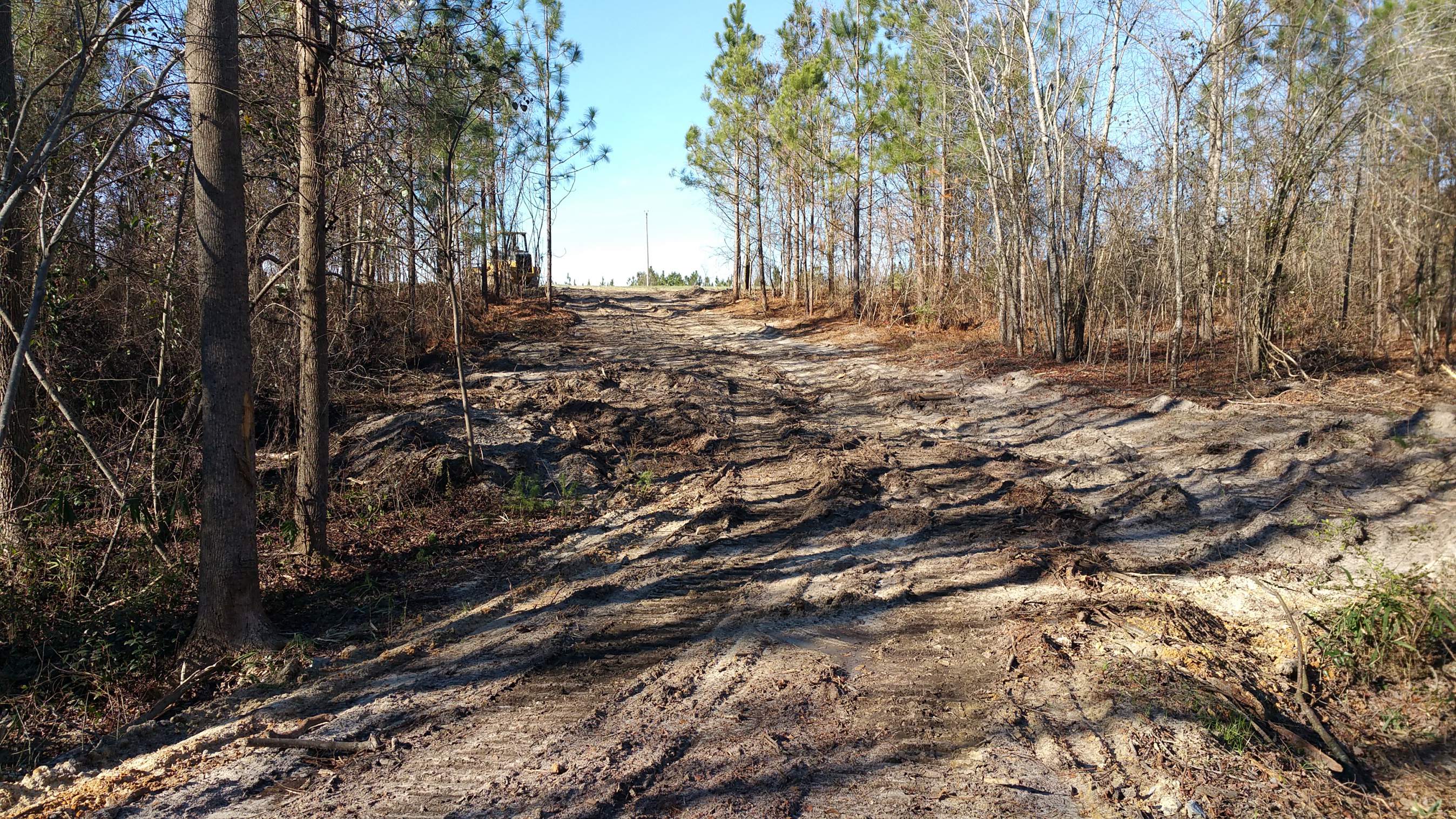

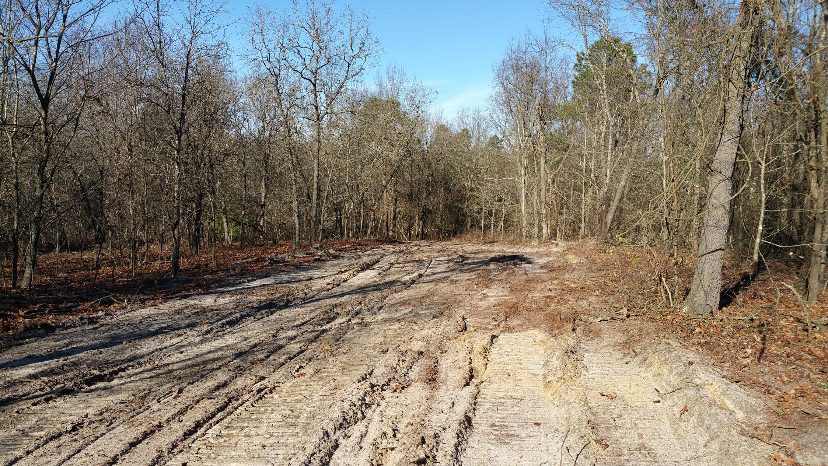

And a few pictures of the road - still a work in progress....

That's a nice looking burn pile!!! Something I can truly appreciate.
It looks like your driveway makes a little turn to go around a couple of trees as it comes up the hill. I've learned that no matter how much I like a particular tree, I never miss it when it's gone. I've made the mistake early on of trying to keep a tree and work around it only to have it die on my anyway, or be a never ending source of problems. Trees are wonderful if they are away from the house, all buildings, fences and roads.
If you do not have code for how wide your driveway has to be, ten feet is plenty to drive on. Honestly, 8 feet is all you will actually use, the rest is just a buffer for bad drivers. Then you will need another ten feet on both sides of your driveway for drainage. Figure five feet to the bottom of the ditch and another five feet going back up again to the tree line. At 30 feet, you are still on the minimum width. I think 50 feet is better!!!
Even when you clear back the trees, they never stop growing.
No matter how big you make your trenches, there will always be that storm that proves you didn't make them big enough. Maxxing out how much water you can handle today will always be something you appreciate when it's really nasty outside.
   / New House Build in the Country!!! #58
8 ft wide is not really enough. You want the drive wide enough to be able to put your tires on the entire width by changing from driving on the far right and far left and at every point between.
This requires a drive that is minimally 1.5 times the width of your vehicle.
   / New House Build in the Country!!! #59
Personally I like the turn then people can not look down the road and see the house.
   / New House Build in the Country!!! #60
My driveway is big enough to fit a 4 axle front loading trash truck down it. We can also fit a 53' semi truck if they cut across the lawn by the garage (or if we move the cars and they swing wide past the garage).
Wouldnt have it any other way.
