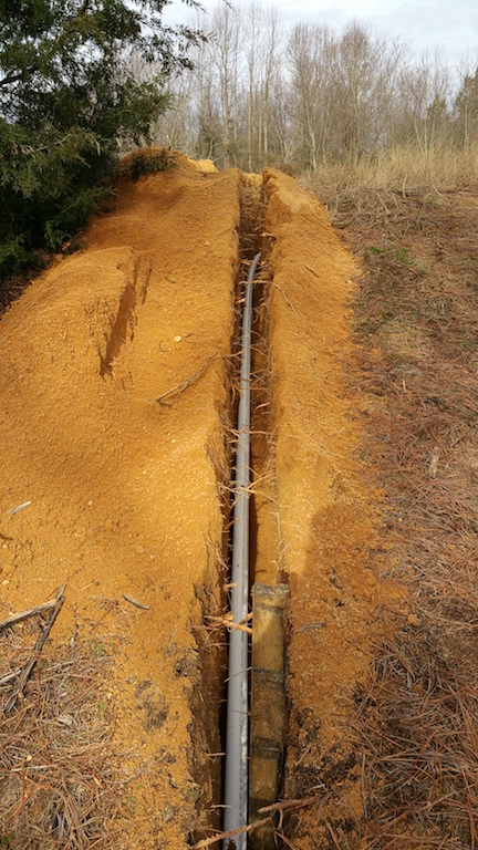

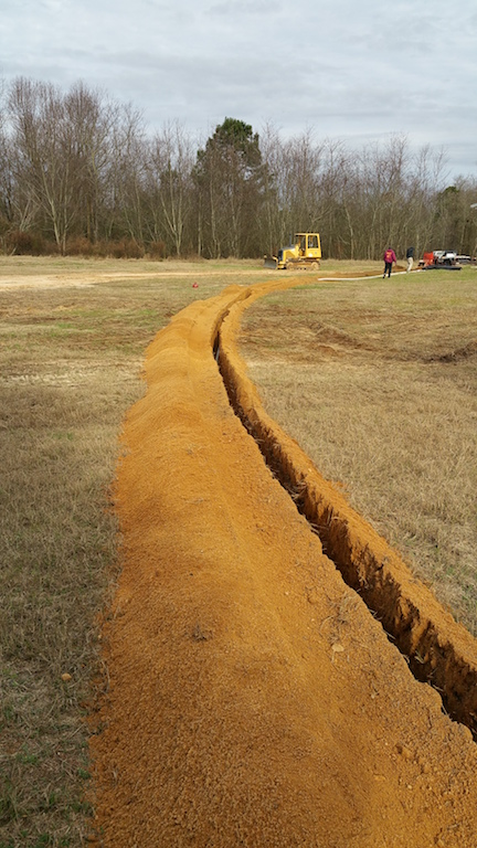

We are having them put in a few spigots along the run. They are also going to do 3 shut off valves along the run as well. My theory is that if the main ever bursts - we will be able to isolate the problem area easier. It should also make it easier to expand/adjust the system in the future.
I like the idea of dropping in some power line with the water. Does it need to go through conduit or can I just use direct bury wire? Is it just standard 12/2 wire that has a ground???

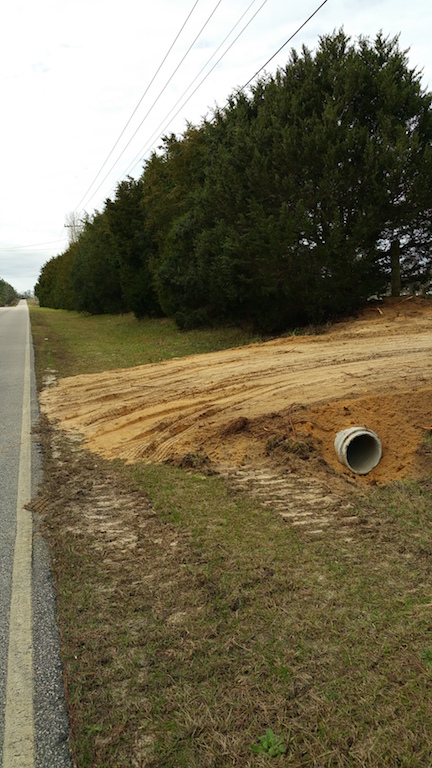

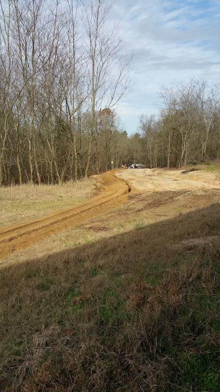

Its been an eventful few days. They are still working on the driveway/road, and today they got most of the water line installed. Here are some progress pics:
I would run 3/4" or 1" conduit and put your wire inside that. How far is it going If its a ways, it might be cheaper to get separate stranded wire and run that in the conduit.
I would not direct bury as then you have to dig it up if something breaks and you need new wire.

   / New House Build in the Country!!! #80
Not only would I burry the cable but you would be very wise to run 3 or 4 empty runs of conduit as well as one extra for water line while the trench is open. I ran a couple when they put my drive in and they have proved invaluable. Especially when the power company says " you will have to pay for us to bore shot a line in". Just walk out and show tell them to choose a run.
