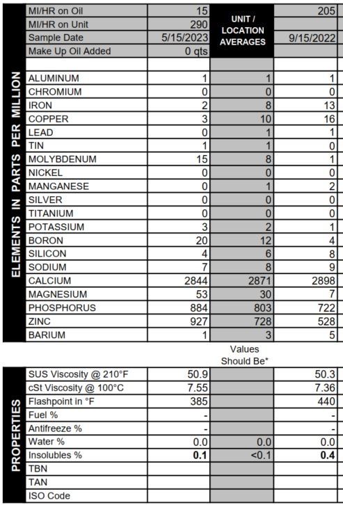

UPDATE
I’m not gonna say this is the most fun we’ve ever had with a new tractor😊.
To review:
We noticed at about 200 hours that the hydraulic oil on our new M62 looked less translucent than we were used to - did an oil change and it looked pretty awful (see previous pictures).
Sent it off for analysis (see attached) September of 2022 and it came back with the insoluble’s four times over the upper limit.
Kubota helpline was completely not helpful. Out-of-state dealer that we purchased it from also not helpful.
Did two complete changes of the hydraulic oil and filters ($600) and then sent the tractor to the nearby dealer for an “hydraulic washout” - $600 transport fee - when the tractor got to the dealer we found out that the washout would not be covered under warranty and would cost thousands of dollars.
Regional representative told dealer that this is normal for the hydraulic fluid in a new Kubota tractor.
Paid for another complete hydraulic oil and filter exchange. Now insoluble’s are just slightly above the recommended limit (see attached).
Blackstone is recommending another change of the hydraulic oil filters.
Questions?
Has anyone had a similar experience?
Any idea what’s going on - is this normal?
Should we change the hydraulic filters again?
Should we change the hydraulic oil again?
Thanks in advance for any advice.
Usually there is a narrative with the Blackstone result that gives an explanation for things that are out of range. When your insolubles were way high last year, did Blackstone give any explanation of what might cause that?

I don't see the problem. It looks to me like the change of fluid and filters did a good job.
Your original showed some sort of contamination, but apparently that has been dealt with. New tractors have a surprising amount of crud that has to be filtered out.
Nobody can evaluate the light metals below Boron that show high ppm without comparing to what is normal for that particular batch of oil. Those metals are all typical of the very high additive packages used in trans/hydraulic oil. Calcium is within 1% so no data there. The others show expected depletions. Kubota does not make their own branded UDT2 trans/hydrualic oil and they are aware that the various compounding companies they use do differ. So you need to include analysis of an unused sample of the exact container of UDT2 you put into the tractor if you want an accurate starting number for the additive chemicals.
Similar experience -well, I've not seen oil looking like that when I look at our M59 - which pretty much the same tractor but pre-tier4 emissions so we often run at high idle, not at high RPM. Because of the RPM difference I would expect that ours would have less entrained air than you show in your original photo.
I have seen similar cloudy trans/hydraulic oil in other machines. Cannot tell from your one picture last Oct. 2022 whether it was entrained air as microbubbles or actual particles or just what it is. It might even be from a small suction air leak. You might want to consider taking one photo right after warm sample is in the mason jar, and then again two days later after the mason jar sits quietly. Then again at a month.
To my eye, what I am seeing looks like as much air as anything else. Especially if that is a fresh sample. Let it set a few days and air will make it's way to the top and escape. Solid particles - even micro particles - will settle to the bottom in about a month. Water should stratify by then as well - although t the report doesn't show water. I don't know what water test Blackstone uses, but the the water test one used by many oil analysis companies was not very accurate.
Is there some particular thing that you don't like about the oil report?
At this point & given the oil report i would consider changing filters - simply because with that much reduction of insoluble solids the filters may be getting filled up.
The HST is the most sensitive system in the tractor & so it has a special super fine filter just for oil entering the HST. Because that is a common sump hydraulic system that HST fine filter also functions as a bypass filter to slowly super-filter all the entrained solids for all the oil. That might be an argument to replace it.
I would not change the oil unless doing so just for convenience.
Other than being worried like any new owner, how is the new tractor doing?

Please excuse the delay in responding - I truly appreciate hearing your thoughts and found them helpful and reassuring.
I guess I was mainly concerned because our previous tractors always had very clean looking hydraulic oil - so the appearance of this oil was a surprise.
As you read - I initially expected Kubota to be able to reassure me that this was normal. But unfortunately we have not been able to get any useful response from them. I specifically asked them if new tractors should have hydraulic fluid looking like this…
Just a reminder - we changed the hydraulic oil and filters three times, so I guess I was expecting the insoluble’s to drop even more.
Blackstone is simply recommending changing the filters again - which we will do.
We’re actually really pleased with the machine and its performance otherwise. We use it principally in our woodlot in Vermont and the extra reach of the oversized hoe is a big help. However, even with axle extenders we have to be a bit careful with the backhoe all the way off to the side as it tends to tip up the tractor. The only thing I would change in design would be to make larger stabilizers - similar to what we had on our Deere 110TLB.
The fit and finish on delivery was pretty disappointing - there were numerous problems like missing grease holes - and in the end the out-of-state dealership wouldn’t stand behind the machine. However, our local dealer engaged Kubota regional and made good on almost everything. For instance, they replaced the backhoe main boom because the welds were so poor. We had a new Kubota decades ago and my memory is that we had no problems whatsoever.
Again thanks a lot for your advice - I put a jar of the original dirty looking fluid into storage months ago - I’ll go find it and get back to you.
