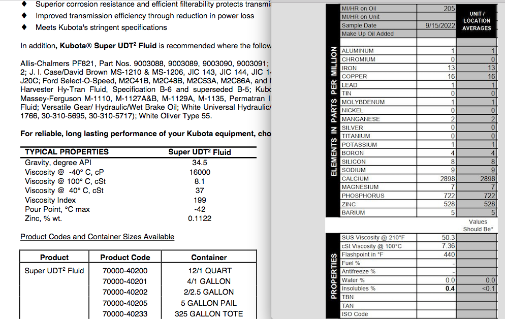

I am surprised that your hydraulic oil analysis found zero percent water in the tested sample given the oils appearance however the milky appearance could also be attributable to the high calcium suspended solids. Calcium is a lubricant in oils and also sacrificial item ( detergent ) as calcium is easily reacted with.
I am NOW suspecting you received an M62 that Kubota delivered without flushing or adequately flushing the hydraulic system, after assembly/ manufacturing, before delivery. you indicate you received tractor new from a dealer ( a dealer who clearly should be out of business given their refusal/ denial of a clear problem with newly delivered machine that is within warranty period).
Perhaps a letter and followup phone call to Kubota's regional representative is the your best action moving forward.
Below is comparison of Kubota SUDT spec to the OP test sample analysis. The zinc, at 0.1122 % weight and equivalent 1122ppm, and viscosity at 100'C in test are actually lower than spec.

My understanding is the tractor is made in Japan. Loader and backhoe made in the USA. Plus 3rd party suppliers for both. Makes for a lot possible sources for contamination? Calcium also a component in some grease.
Oil doesn’t analysis show excessive wear or operating issues. Changing it like you have your best option and continue to monitor.
Maybe a special break in additive addition to new machines? Anti rust/galling coating on new cylinders? New normal for new machines?
Don’t have the PM schedule in front of me but think that there is a HST filter change at 50 hours then every 200 hours? Hydraulic oil and filters change at 400hr intervals?
I would be alarmed too seeing this come out of my new machine. I don’t have experience of changing oil out of new machines either. Hopefully you will see normal, hard to see on a dip stick, clean oil from now on.

I think I am on board with Surshot--
The news is not all bad. The test on the oil did not show signs of excess metal.
What is unknown is the composition of the solids in the oil.
There is no way to know if water (and what ever is in it) has contaminated the oil. But the test also shows the water is not there now. But What was in it may still be.
Having the dealer flush and change the oil may put the problem to an end. ALSO try to talk with the mechanic about this so he knows what he is looking for --solving a problem, not just a oil change. Then talk with him to find want he saw came out.
