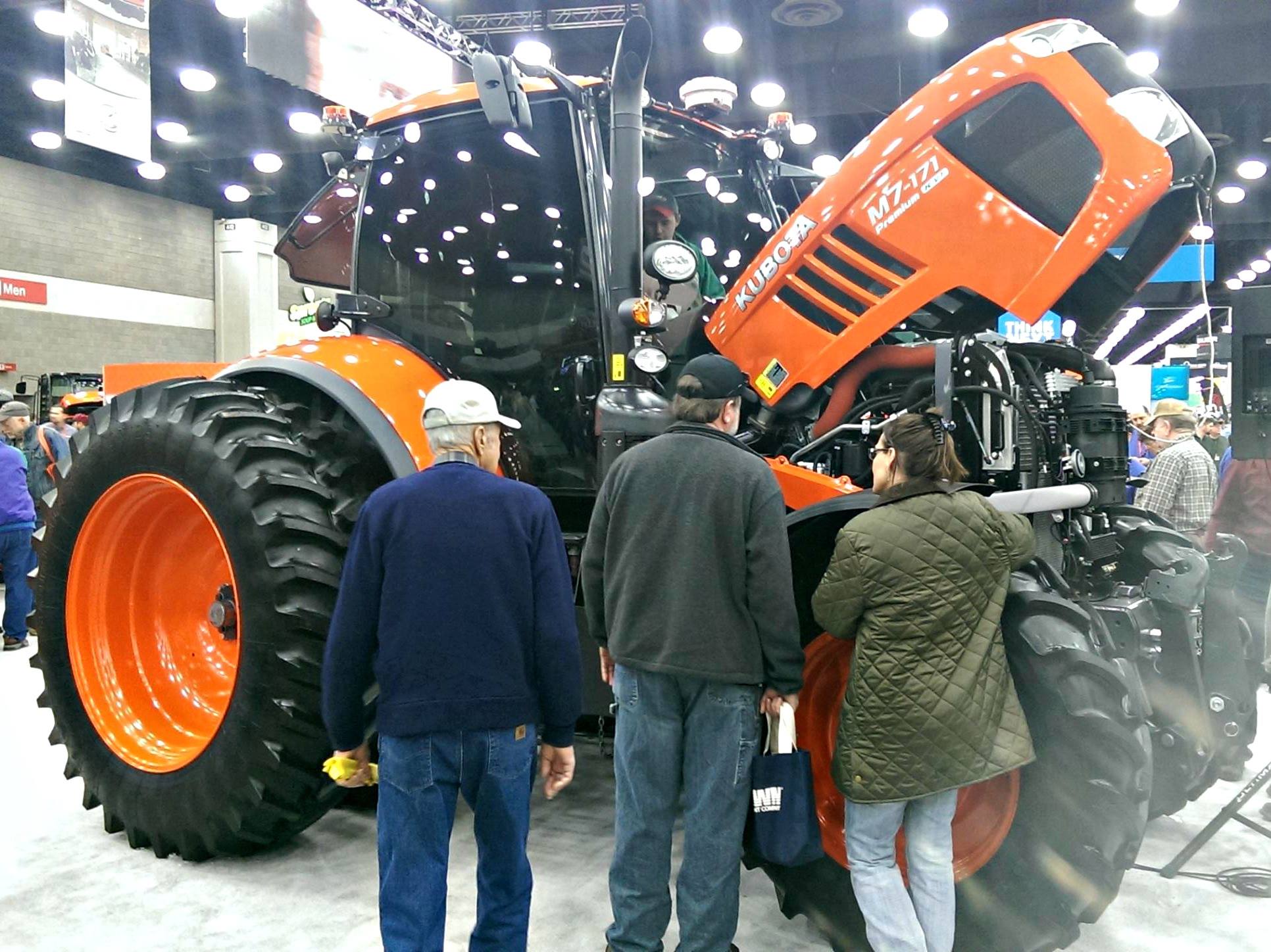

I saw one of these at the Louisville farm show this past Feb.
Was not impressed overall. The build quality and cab interior quality were second to none, however a 15,000lb machine with a tiny 4cyl engine pushing 170hp trying to turn MFWD and Duals (on the one that I saw) is ridiculous. The engine is way to small to be running a tractor like that. Serviceability looks like it will be hampered by all the Tier 4 stuffs under the hood (ie: the hood is cram packed with stuff). Axles looked rather small as well.
On the Case IH's that I sell, you get a 6.7L 6cyl engine on even the smaller 13,000lb tractors. I'm not saying the Kubota is a bad machine, but it just looks like they (Kubota) have not put in the correct size engine or heavy build that a tractor this size needs.

Farmers I know with the Tier 4 interim Deeres have had no problems but that is a small sample. Our Tier 2 built in Waterloo definitely has better build quality than our Tier 3 built in Mannheim but the only Tier 4s we have are Kubota. As for the M-171 engine being small, it actually has a lower output per liter than many others. It's 28 HP/liter vs 32 HP/liter for a New Holland M5.115 for example, a spec sheet I had handy. But those are relatively low power density engines compared to what the future will hold. Engines are based on simple physics. Additional cylinders create additional friction which is measured in lower efficiency. The basic engine I was testing when I retired created 44 HP/liter, cost less than the 6 cylinder Tier 3 engine it replaced, and reliability has been outstanding. Kubota is, however, getting away from their current designs which have a higher Kubota design content. The M7 for example switches from Kubota's own front axle to a Dana axle, and transmissions are Z-F. Electronics are based on their recent European acquisitions. The front 3-point hitch is from a European supplier - the name escapes me. There is not a lot of old Kubota in the tractors other than the engine and the Orange paint. As for FPS, the main source for CNH tractors - they have a combination of DEF and DPF engines in the line and due to several companies skirting the intent of the regulations, Euro Stage V is in the works to insure all engines will have DPFs by 2020. If that translates to USA time will tell.
