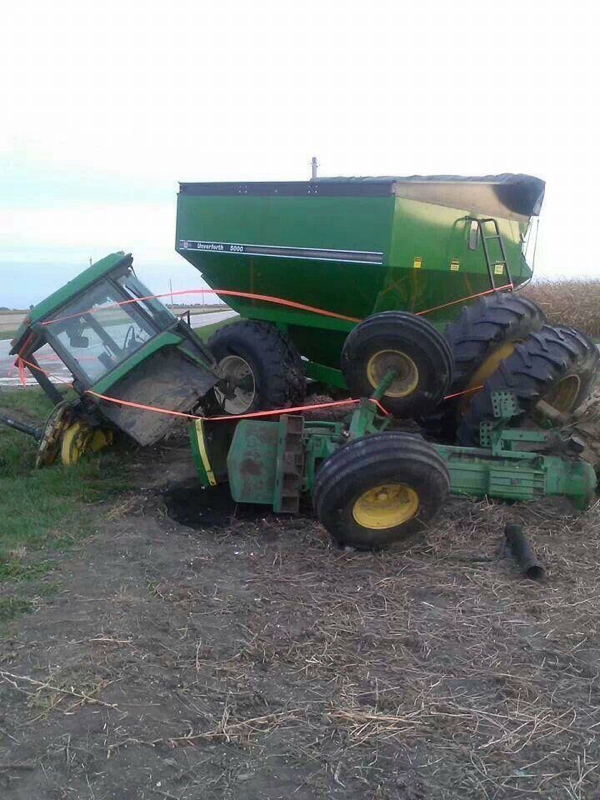

As far as Kubota being a puny frame, we have never had a Kubota disassemble like this. My avatar is actually the first time I stuck our 7720. Notice it's hardly sunk in but still immobile.
   / New Kubota M7 Series #102
Wow that's a hot mess right there! )0:
Did it tear itself apart?
What the Wild, Wild World of Sports happened to that thing? Never seen anything quite like that.
