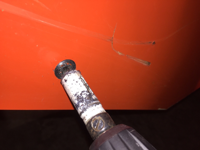

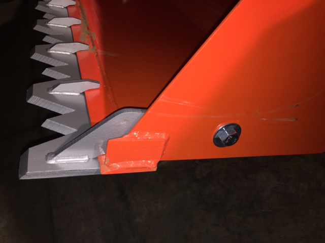

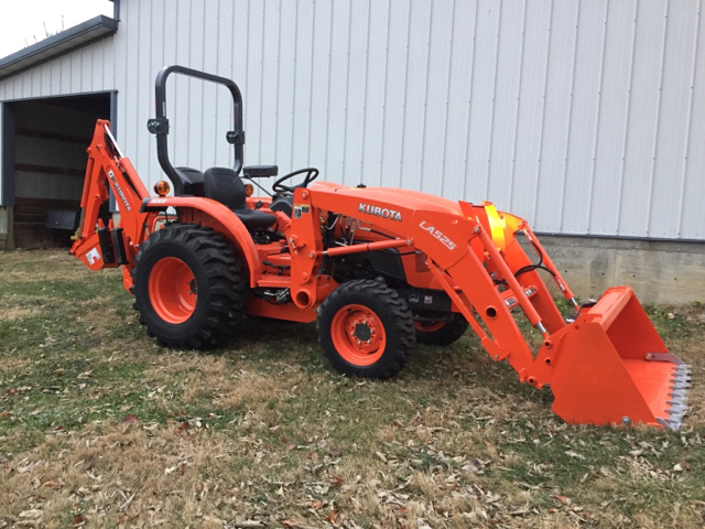

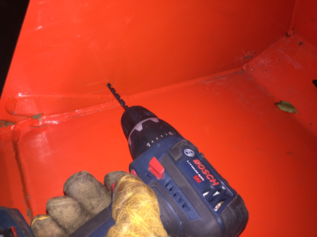

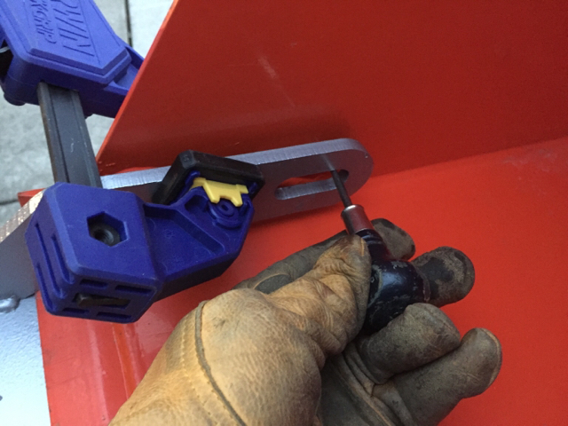

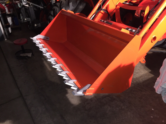

That tooth bar looks sick!
I have heard a ton of talk about the piranha lately.
I wonder if the mounting holes on the side need drilled or come standard. I'm not too familiar with Kubota buckets, my bucket has the holes along the cutting edge.
The bucket has to be drilled. It's not bad at all. I use a hole saw. I'll attach a few pics.
The toothbar works great. It's similar to a serrated knife. Cuts into dirt like butter and makes the loader much easier to control. Also it works great when ripping out saplings and brush. The teeth bites and rips saplings out by roots. It also works well when back dragging. Many toothbars don't work well when back dragging.
