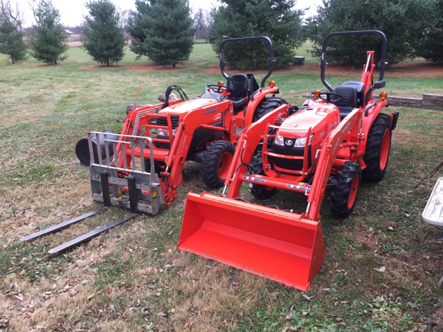

Well I just got a new L2501 with front loader and backhoe. The engine seems really loud! The exhaust has a metallic rattle sound to it. My L3830 is much quieter sounding.
Using a dosimeter app on my phone I measured around 92 db at 1700 RPM. My L3830 is running around 90 db. The L2501 has a harsh exhaust note like a hammer hitting an anvil.
I'm curious if anyone else thinks their L2501, L3301, or L3901 is loud. I'm planning to drive another L2501 at dealer when I head down
there.
One thing to note. The tractor has off-road diesel in it. Not sure if that would make it run louder or not.
I've attached a pic of my two Kubota since we all like pics!

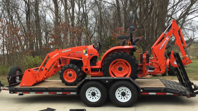

Well it's loaded up and ready to head back to dealership. Thank you for everyone's help and advice on my new tractor. I hate to return it but I can't deal with the noise and diesel smell. Hopefully the L3301 will be much better.
